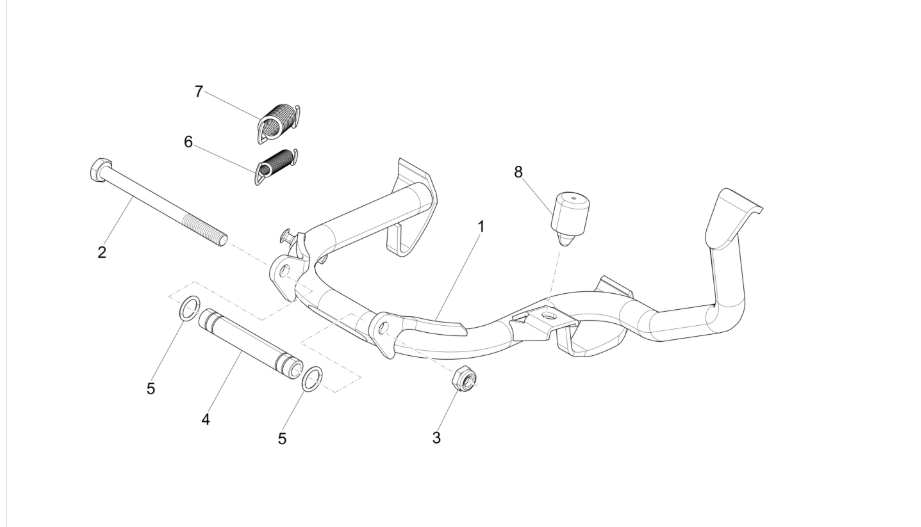

Had the same problem until I greased the centre stand pivot bolt - made a huge difference.

The bolt itself doesn't need any grease but the sleeve (piece of pipe) that is the actual pivot point, and the part which is turning inside the engine block. These tend to seize without proper maintenance.
Part #4 [/img]

So how does one grease the bushing?

In short, pull the center stand, pop out the bushing, clean off the crud and grease, reassemble.
Getting the springs off is a right PITA, however. If you don't lubricate routinely, the bushing will corrode and you'll spend hours trying to figure out how to get it out of there.
Pretty sure the Wiki has a manual for your bike that should cover it....

I'll grease all of the appropriate moving bits once I contrive a way to raise it sufficiently off the ground.
