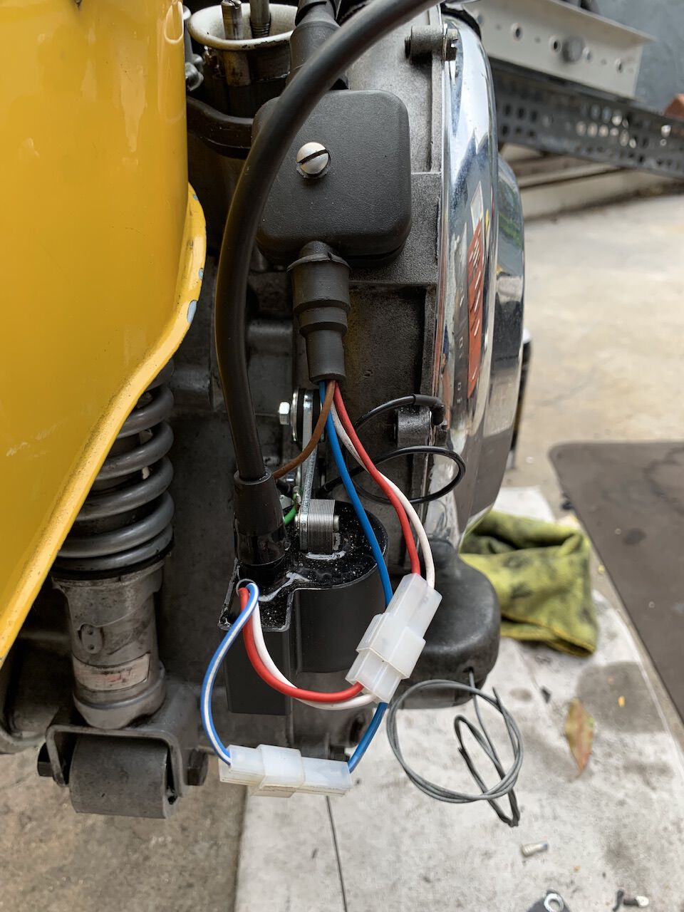

I replace those plastic connectors with 2 pin waterproof connectors now. Those connectors seem just wrong for that area subject to weather.
Also, make sure brown is connected 100% to both the motor and the plate, ie no interference to case ground from rubber buffers. That's one of the main issues I've read with the Vape, which are very few. A tether wire to a flywheel cover bolt will do it.
And M3 ring terminals for the junction box, as C'man mentioned.

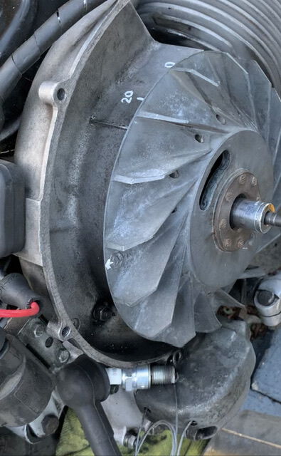

Ray, the stand's a champ. Lifting the engine from the stand into the bike was a piece of cake. Going the other direction would be dicey. Easier to just drop it.
I tried to make SIP's blade connectors work. I really did. Got a new P style junction box (which, naturally didn't quite fit and had to be modified), snipped off all my ring connectors, crimped and heat shrunk new blades. Looked ugly and nothing fit. Total freaking waste of time. Went back to the original box and rings.
Got a tether ground to the flywheel cover.
All I can say is this better be worth the effort.
Waterproof connectors to the CDI is a good idea but not gonna fuss with it. I'm so done crimping wire. Might squirt a little silicone in the terminal.

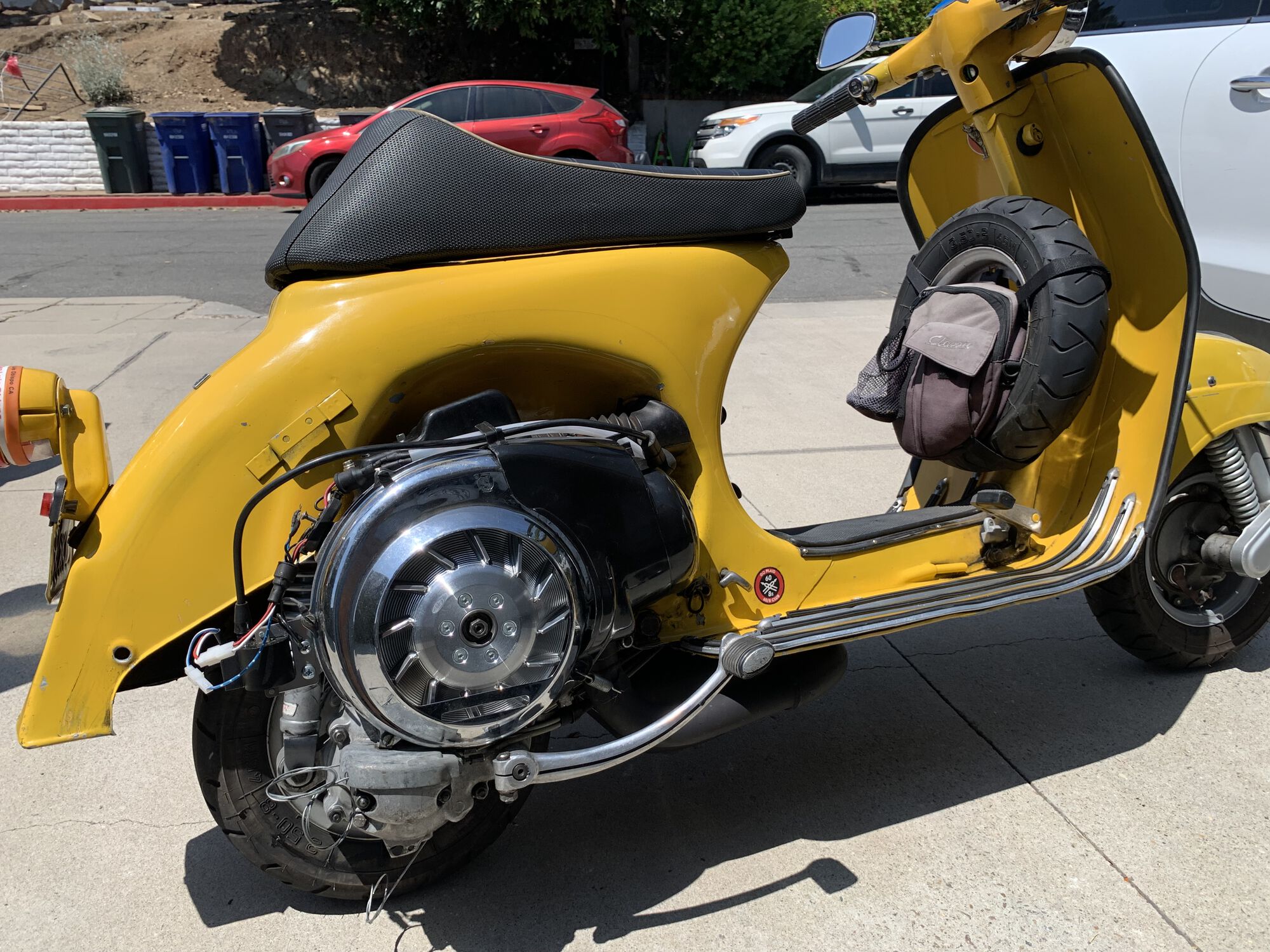

After a marathon textfest yesterday with CM1 and CM2 to chase down some no-start gremlins (leaky carb and bad spark plug), ol yeller finally popped off and is up and running. Thx amigos.
Starts easy and idles steady. Still need to wire up the lights.
Based on a couple of short rides up and down the hill, the Stelvio has good power down low. Got a Polini-ish feel to it.
let the jetting fun begin

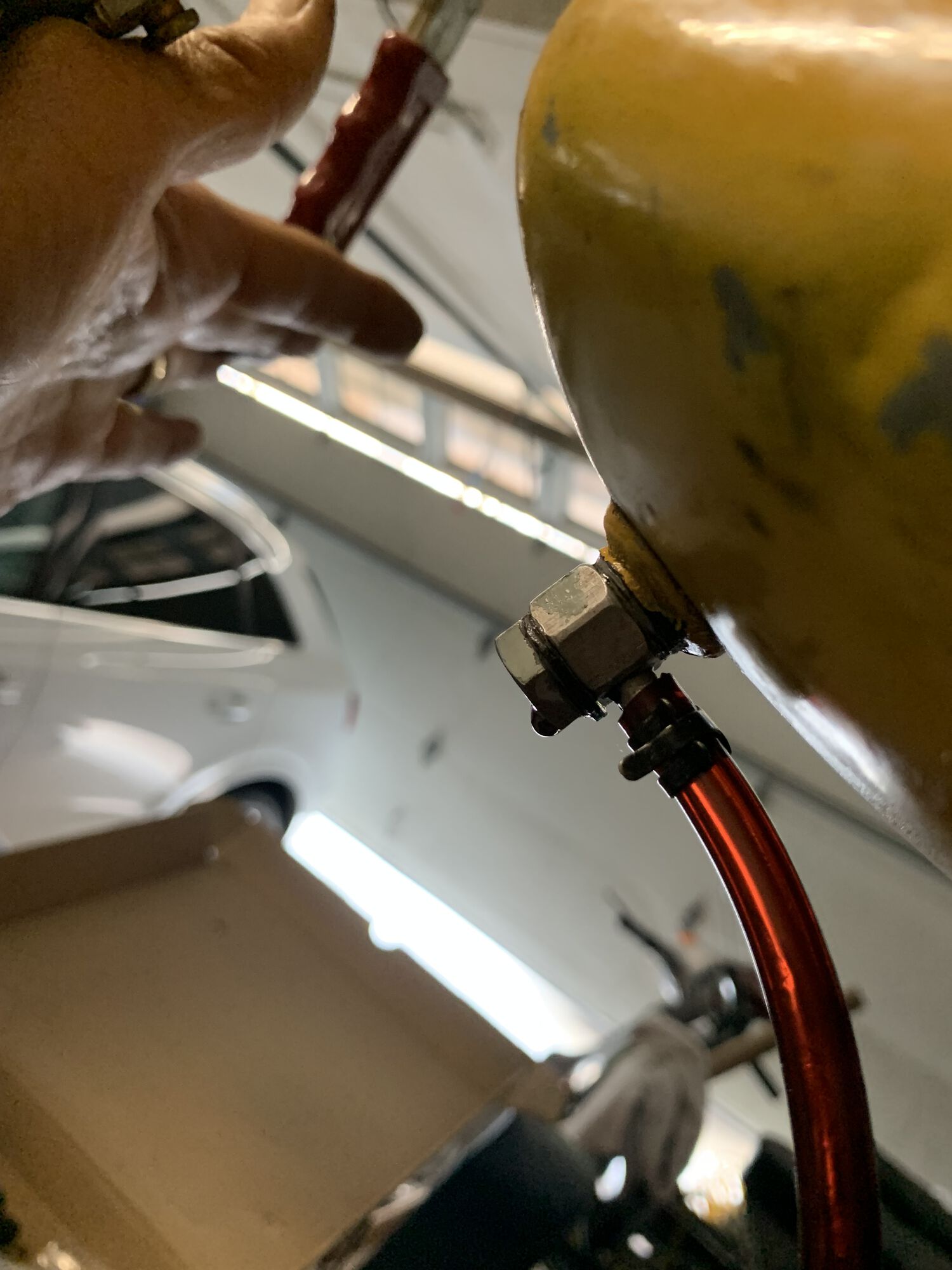

After repeated fiddling with with the oil tank fitting, I finally managed to succeed in making the drip worse than it was.
Going to try something new. Stand by.

Tried copper … but apparently left out a crucial step.
Apart from the drip, the Stelvio with the longstroke + super gearing is a joy. Loads of pull. Runs up hills without breaking a sweat.

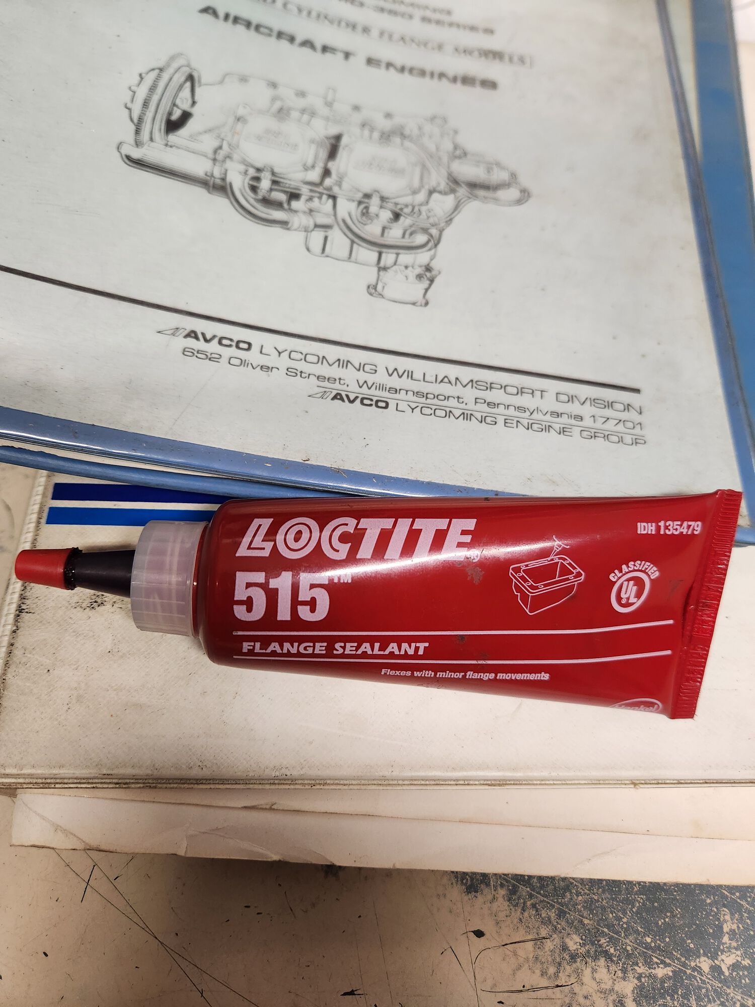

I've had pretty good success with this goo in addition to the sealing washers on leaks like that.

Thx Rob, I'll swoop some up. Still have a couple more ideas to try.

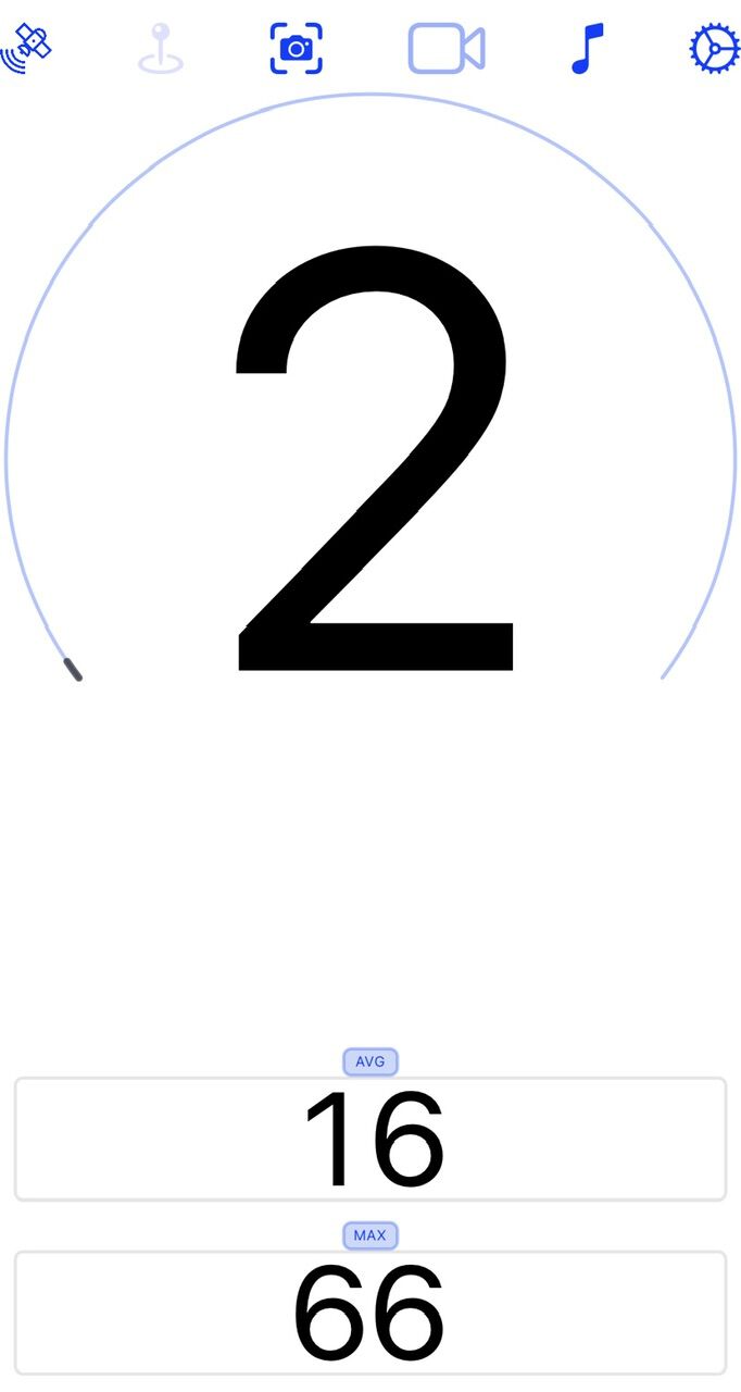

SoCalGuy wrote:
the real test will be if if it can do distances.
This is what I always try to jet for. When you get on a stretch of road that you pretty much keep it WOT for five miles, after 15 minutes of running fast to begin with. If it stays under 300F, I call it good. Razz emoticon

yup, good rule of thumb. these engines should be able to run a flat stretch WOT all day long at a steady temp. cylinder and head temps should drop when the engine's not under full load.
i think a lot of folks forget that the engine needs to be thoroughly heat soaked to really button down the jetting.
Rikko - i run a sensor under the plug. the copper ring replaces the ring on the spark plug. if there's a difference in protrusion it's negligible.

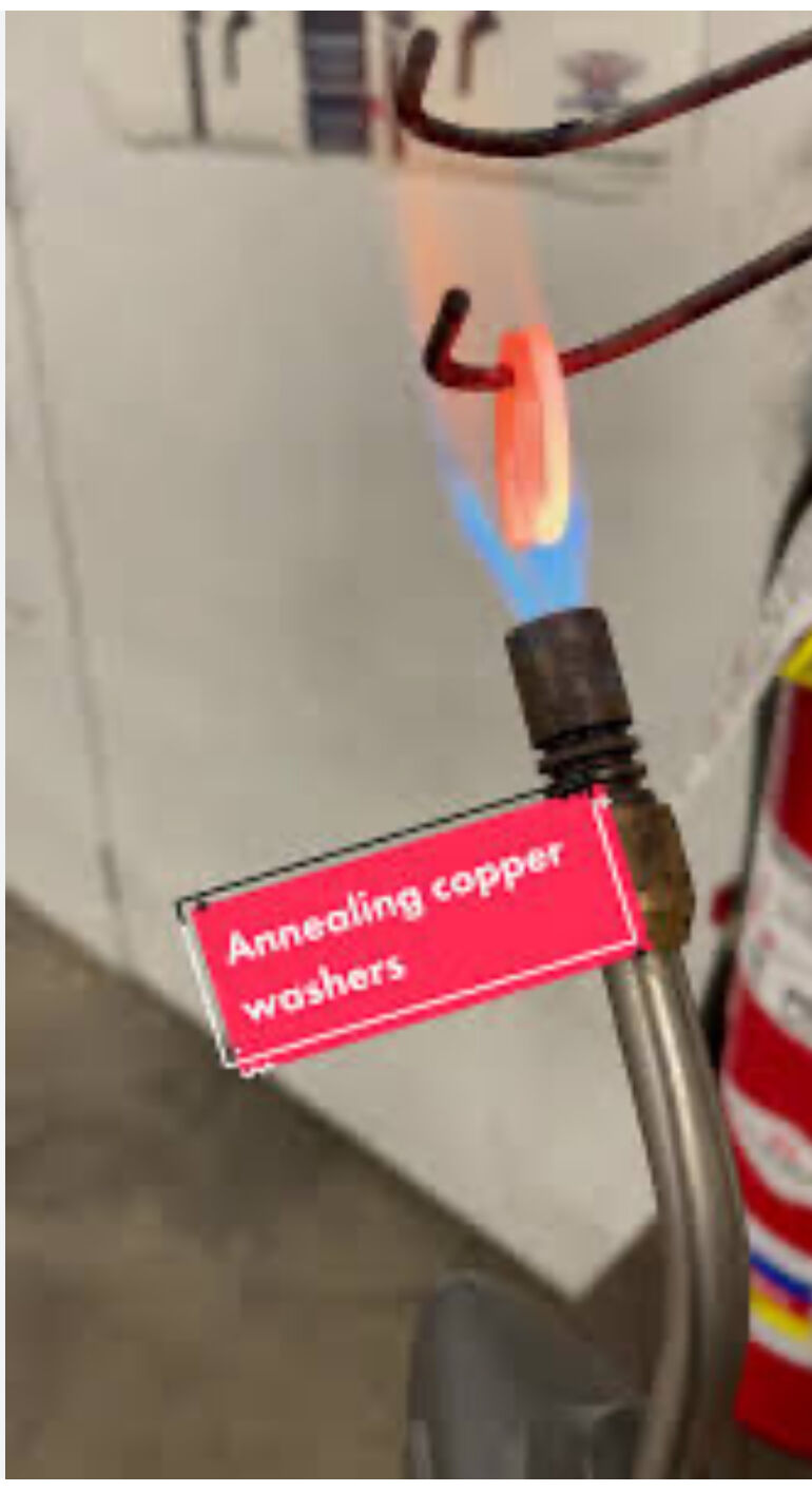

We did some 'spermenting with SoCals leak to halt it.
Word on the street is: it worked.
When I say we, I mean us and Grok.
For fun, we asked AI to help us solve the pesky leak.
We described the issue (70's Vespa oil reservoir), and asked for best approach.
Grocks answer was kinda interesting. Suggested that, yes, we should use copper washers rather than use composite ones - but then… it added a twist.
It suggested Mike anneal the copper washers to soften them.
Now maybe you guys all do this as a matter of course, but I've never heard of it. I mean it makes sense - but it just wasn't on the radar.
So Mike tried the process it suggested - or something like it (?) and…
Voila. Leak stopped.
I don't know if AI is going to take my job, but it might help me stop some stuff from leaking!

None of us had ever heard of 'annealing' (heating) copper washers to make them more malleable - and seal better - until Ned asked his AI friend Grok …

metadaddy: I use a free GPS /speedometer app called Sp33dy. I like it for its simplicity. Nice big bold read out.

You normally only need to anneal copper sealing washers if you're reusing old ones in a different place, new ones are supplied ready to use.

You normally only need to anneal copper sealing washers if your reusing old ones in a different place, new ones are supplied ready to use.
Common where I come from, as well.
I was skeptical, but damn if it didn't work.
Huh. Learn summpin' new every day.
66! Congrats... getting close to 70 over 8's!
(May need to make a new batch of stickers.)
Lemme know when you get those printed and I'll go do a fresh 70 on 8"s run to earn it.

Grok noted: sneaking used copper washers was a known thing in the fix it world (also hadn't heard of that), but suggested we try it with new washers.
The idea is: they work harden as you tighten them up.
In any event, new or used, it's an interesting trick for the tool belt should u need it.

Pretty sure it'll do 70. The stars aligned on this build.
Needless to say, the speed runs are for testing only.
The older i get the less interested i am in going crazy fast on this little thing. the suspension is stiff as a board and every bump goes right up through the frame, seat and headset. it doesn't absorb anything. it's a hoot in the twisties, but a pretty wild ride going fast on surface streets.
Anyhow … big thx to all who chimed in, followed along and assisted getting yellow back up and running.
Time to start planing another road trip!
