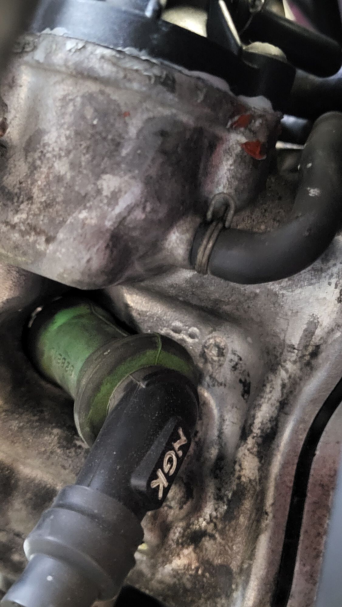

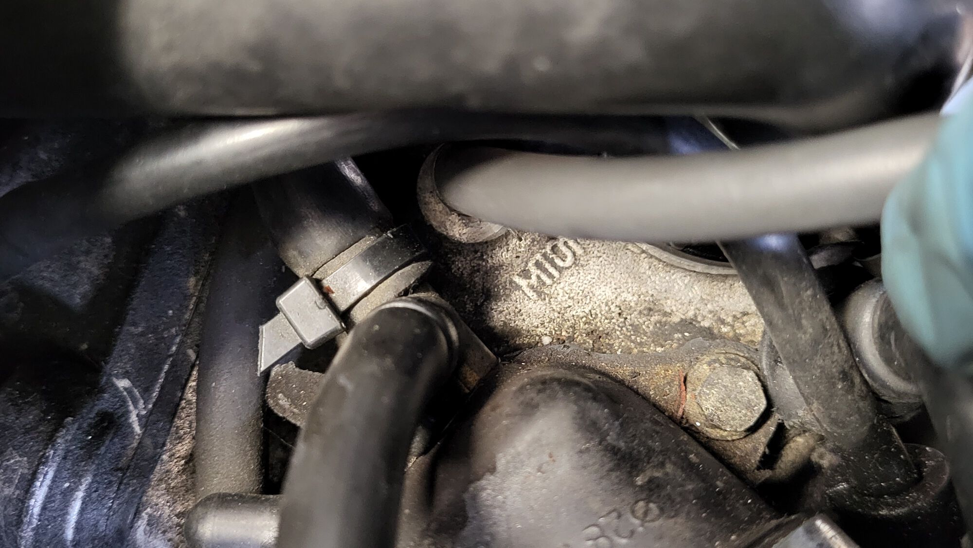

My BV250 is dripping coolant from the engine area. It's not any of the primary hose connections. It's not from the coolant/oil pump at all. The only other possibility I can think of is that it's from the tubing to and from the carb heater, that bypasses the thermostat. I want to bypass the bypass, cutting the heater out of the system, by connecting a tube from one connection to the other.
I know that the coolant returns to the system, above the thermostat, through a nipple on the thermostat housing (cover). What I don't know is where the tubing starts, before the thermostat. I've isolated two different tubes that could be it, but without taking the carb off and tracing the lines I can't be sure which it is.
The first photo is of the upper surface of the head, between the thermostat housing and the intake manifold. There's a small rubber tube that attaches to a nipple there.
The second photo is of the housing cast into the side of the head that creates a chamber for the thermostat to sit in. There's a tube that attaches there, in the photo just above the spark plug wire.

I'm surprised no one had a comment about this, but today I decided to completely strip off the plastic and see if I could trace the hoses and figure it all out. The hose coming off the lower thermostat body seemed like the most logical source for heated coolant quickly after a cold start, and the nipple on the side of the plastic thermostat housing the logical place for a spot after the thermostat where the warm coolant would return to the system, so I connected them with a hose. The other nipple on the top of the head I can't explain, but I capped it off. Filled the coolant, hooked up the battery and started it for a few seconds. Nothing bad happened, so I started it again and it ran fine and didn't do anything weird, and so far has not leaked any coolant. Maybe it's fixed?
