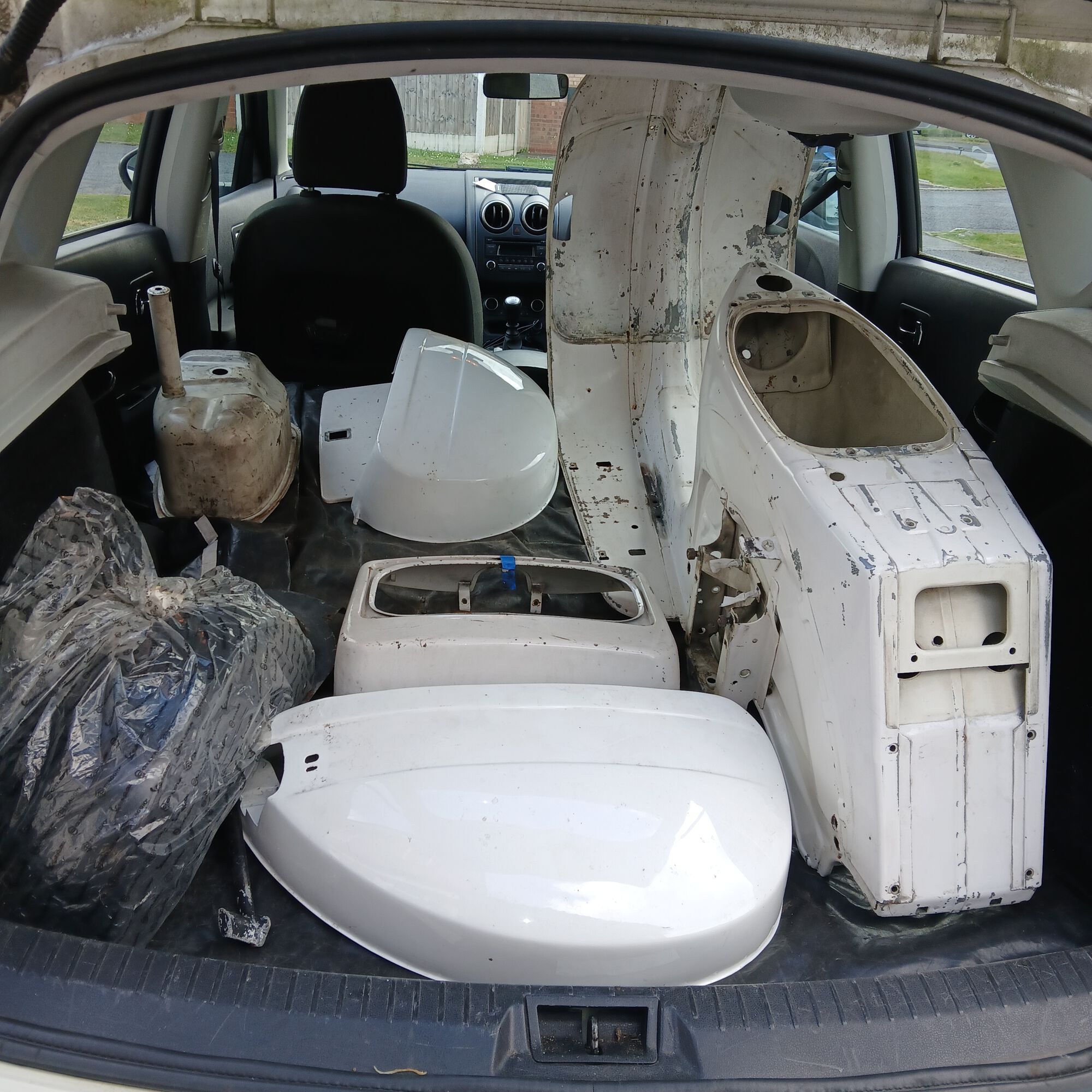

Salutations everyone,
its been a long while since i posted a project on here, work and life balance have met a par when i can finally do so
I obtained this a few years ago and am in the process of stripping to rebuild and recommission. I would say "Restore", but that seems to be an over used and abused term these days and can cover anything being done... so I am choosing the terms Rebuild and Recommission
Plans are as follows.
*Replace the existing paint and damaged bodywork with as close to an original as i can using powder-coat and replacement panels.
*Rebuild the engine
*Recommission the electric start
*Add front disk brake
*Restore functionality to rev counter
not a lot from the sound of it, but plenty to keep me occupied for a while. I will add some photos of progress as i develops and have some to share already
I dont know much about this scooter model other than it existed. no idea of numbers produced etc etc... so if anyone can shed any light on it, i will gladly absorb whatever you can tell me about it

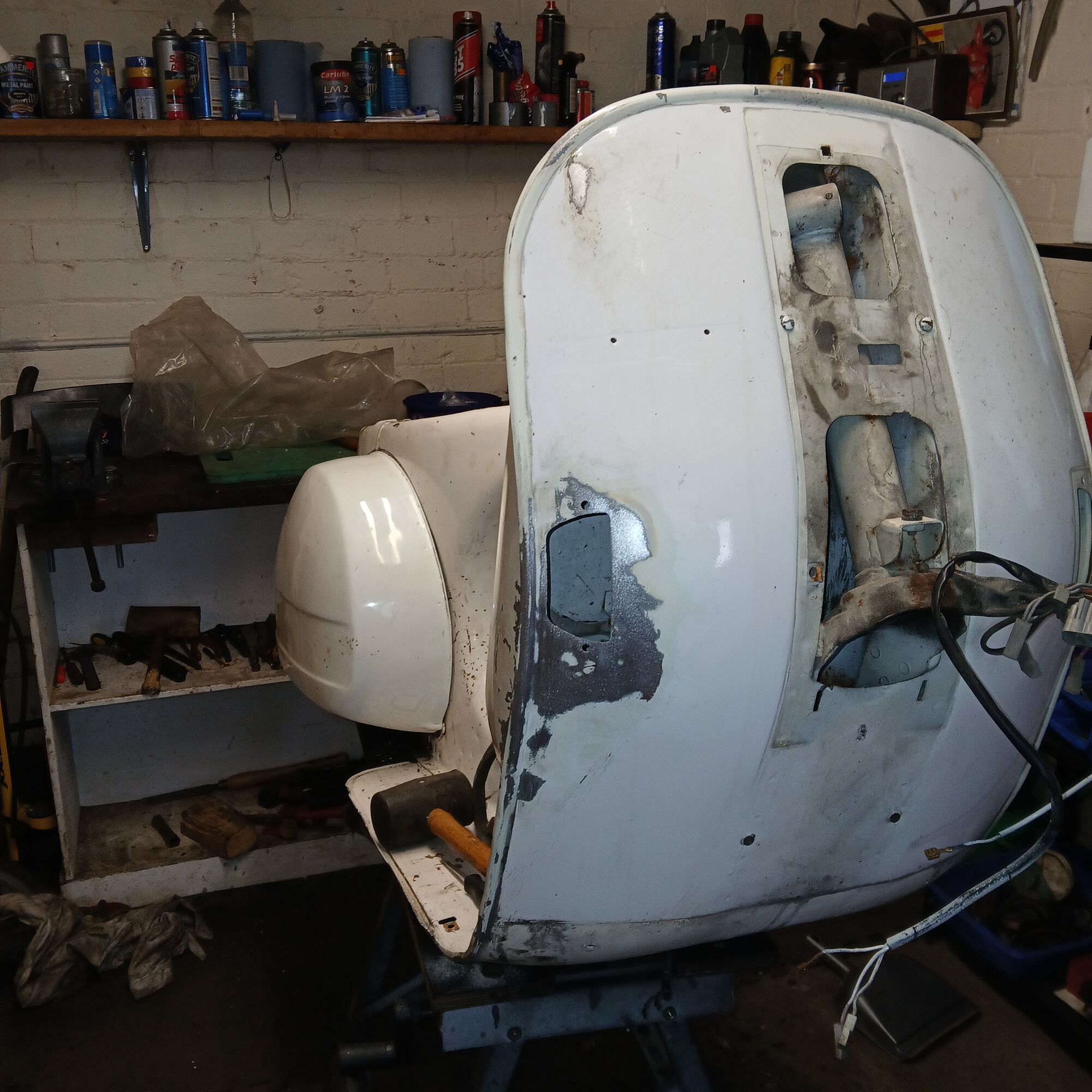

here are some photos so far..... we all know if there arent photos, it never happened

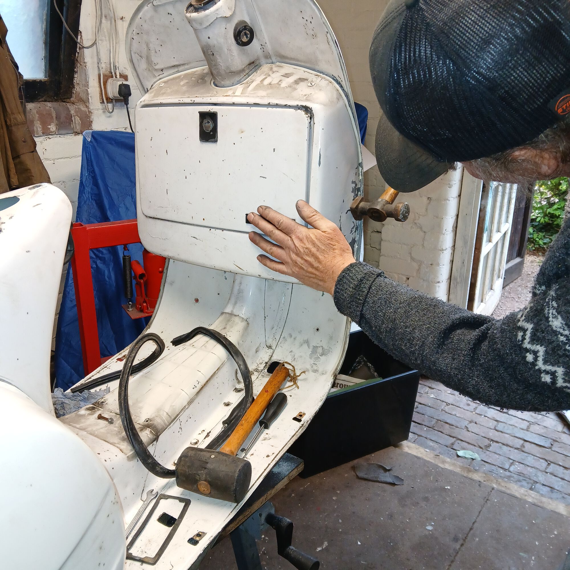

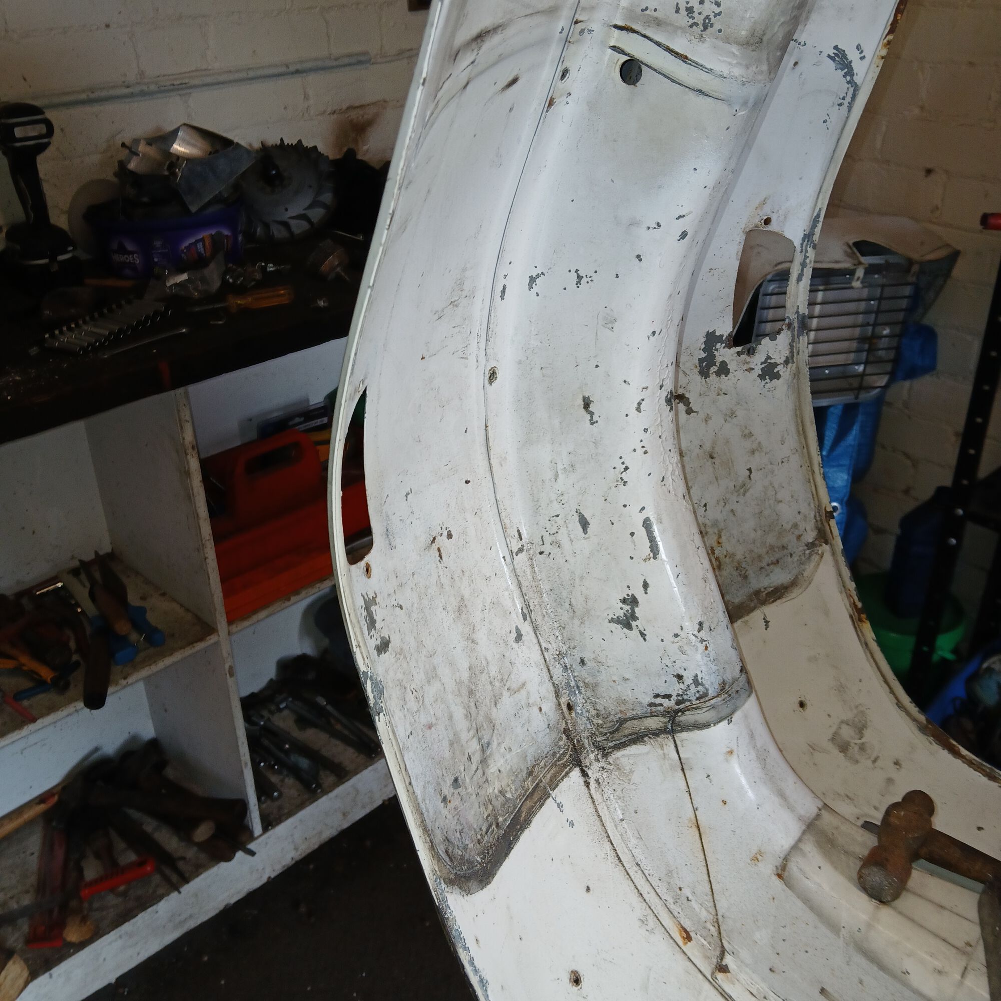

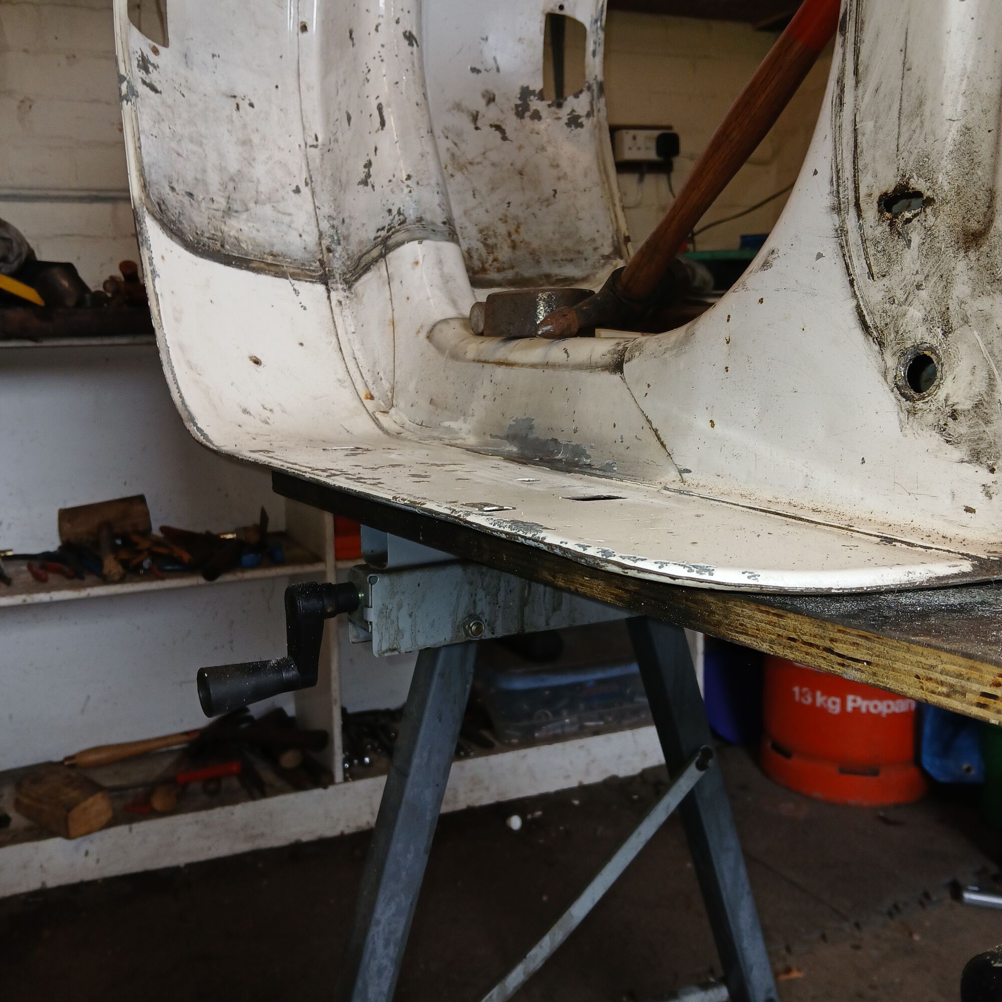

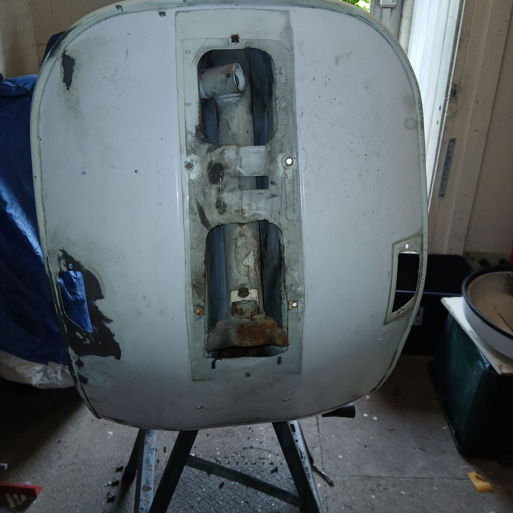

Beating it back into shape

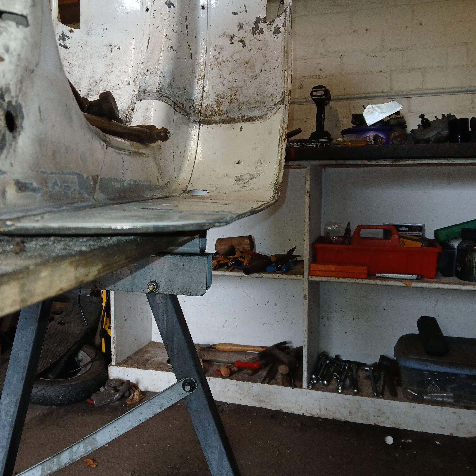

Front Legshields straightened out with hammer and dolly
Floor straightened with hammer and dolly to make it more like a floor and not a wavey sea
other side done too
other side done too
left side straighened
right side straightened
front view now its beaten to a reasonable shape

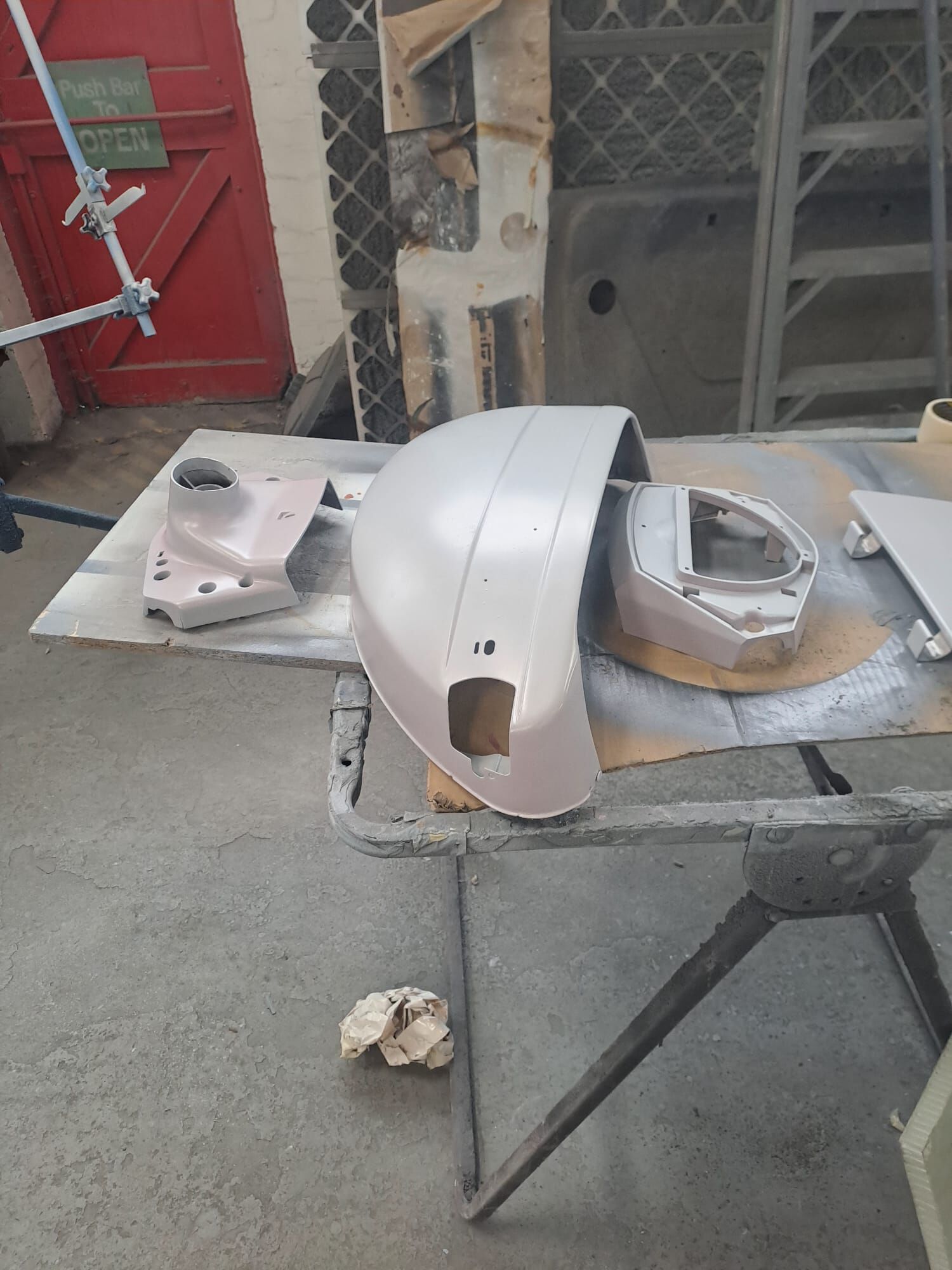

Stripped washed and off to the powder coaters for colour  RAL9001

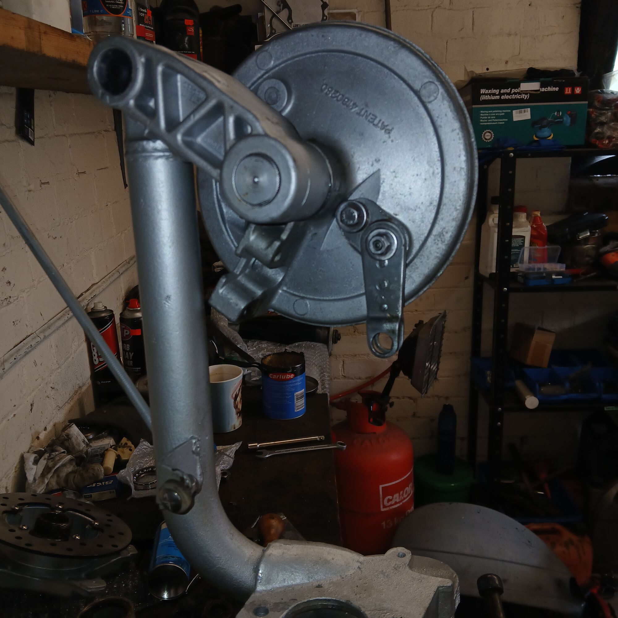

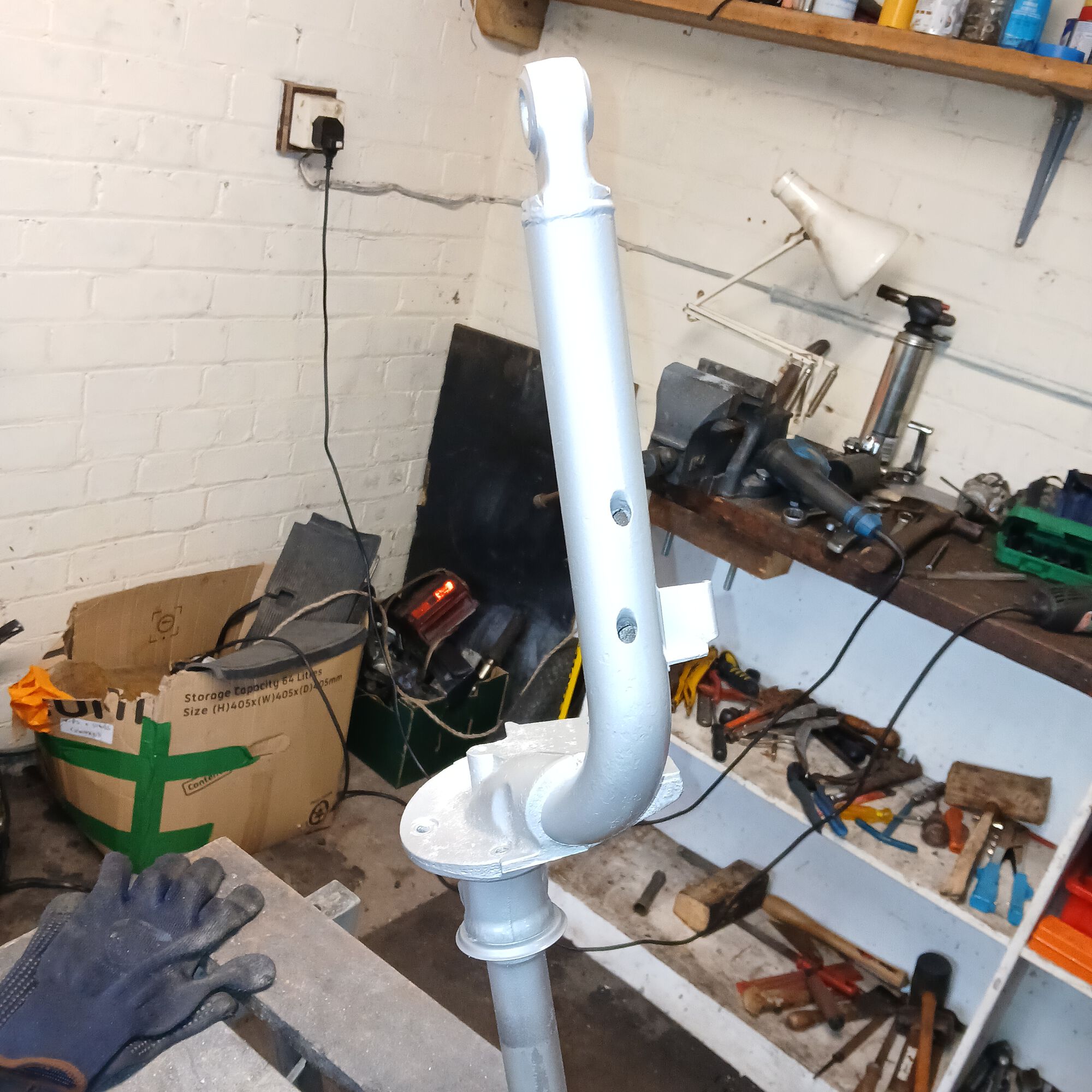

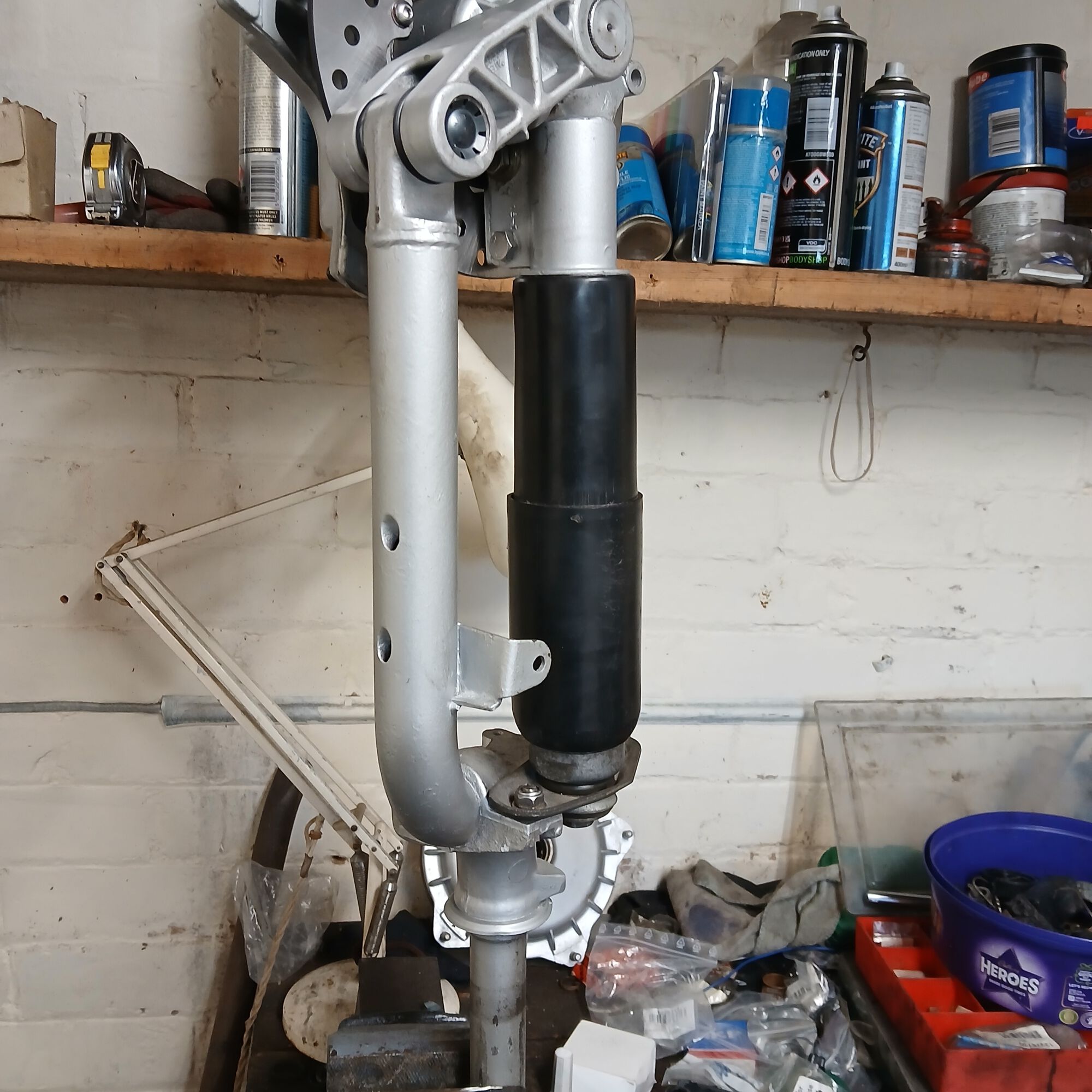

Did some work on the forks, first off was to check for straight and true so out came the digital level. There is 0.1 degree of variance across the length of the leg. So I'm calling that good enough.
I found it quite surprising that it was this good, I've checked against brand new forks from a PX in my stock and they are 0.3 degrees of variance
Got out the press and removed the pivot pin on the front fork and proceeded to wire brush off coats and coats of paint. Found a relatively good match for the silver on the fork leg and applied that.
I have a new wishbone arm to go on it as the bearings and hub spindle were not up to scratch on the existing one and I didn't want to spend the time pressing a new pin into the old wishbone, bit of a pain in the *** I find when it comes to ensuring the protruding length is sufficient to match the hub/backplate before re assembly.
Just enough paint to alow little details like casting logos to be see
Fork leg in its first coat of paint

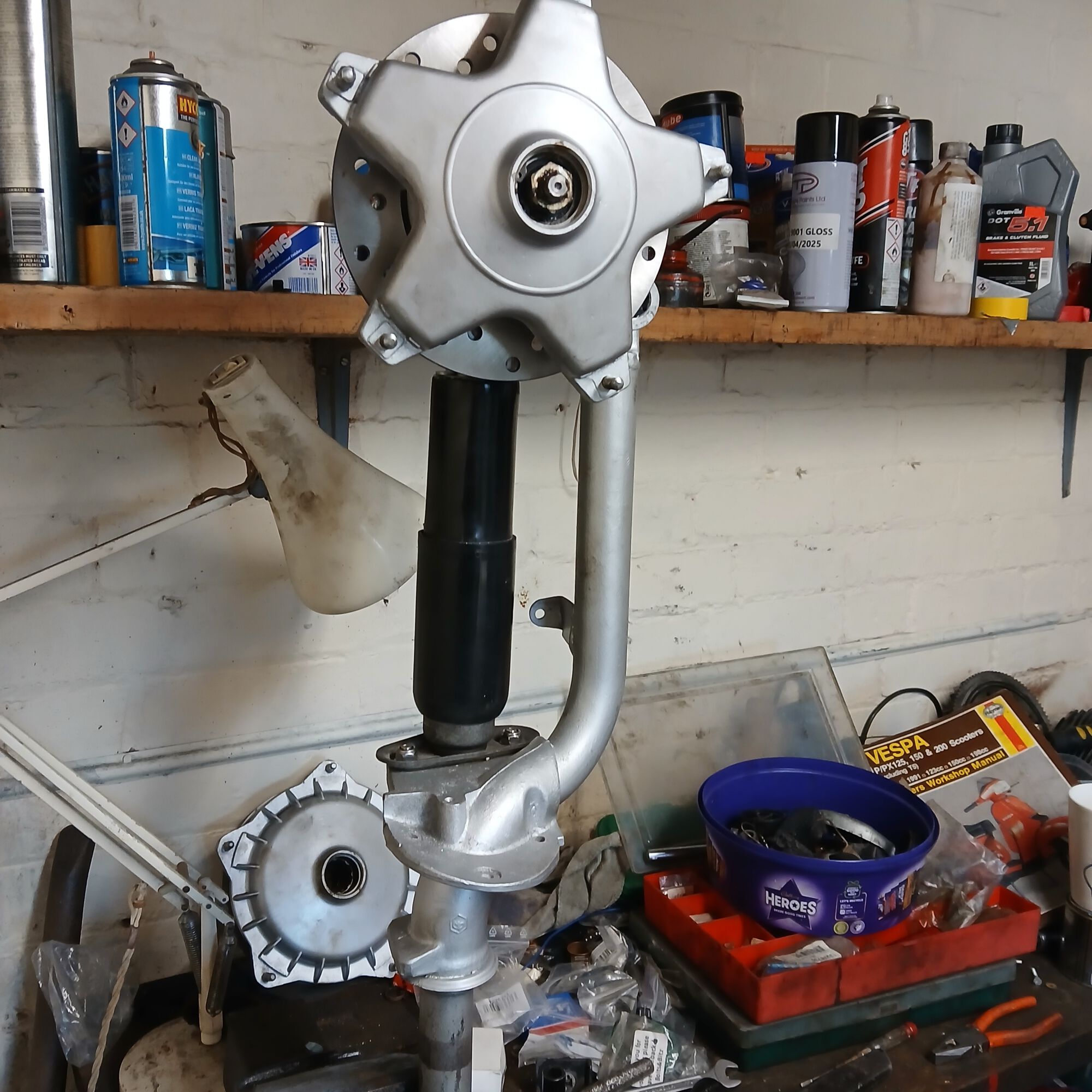

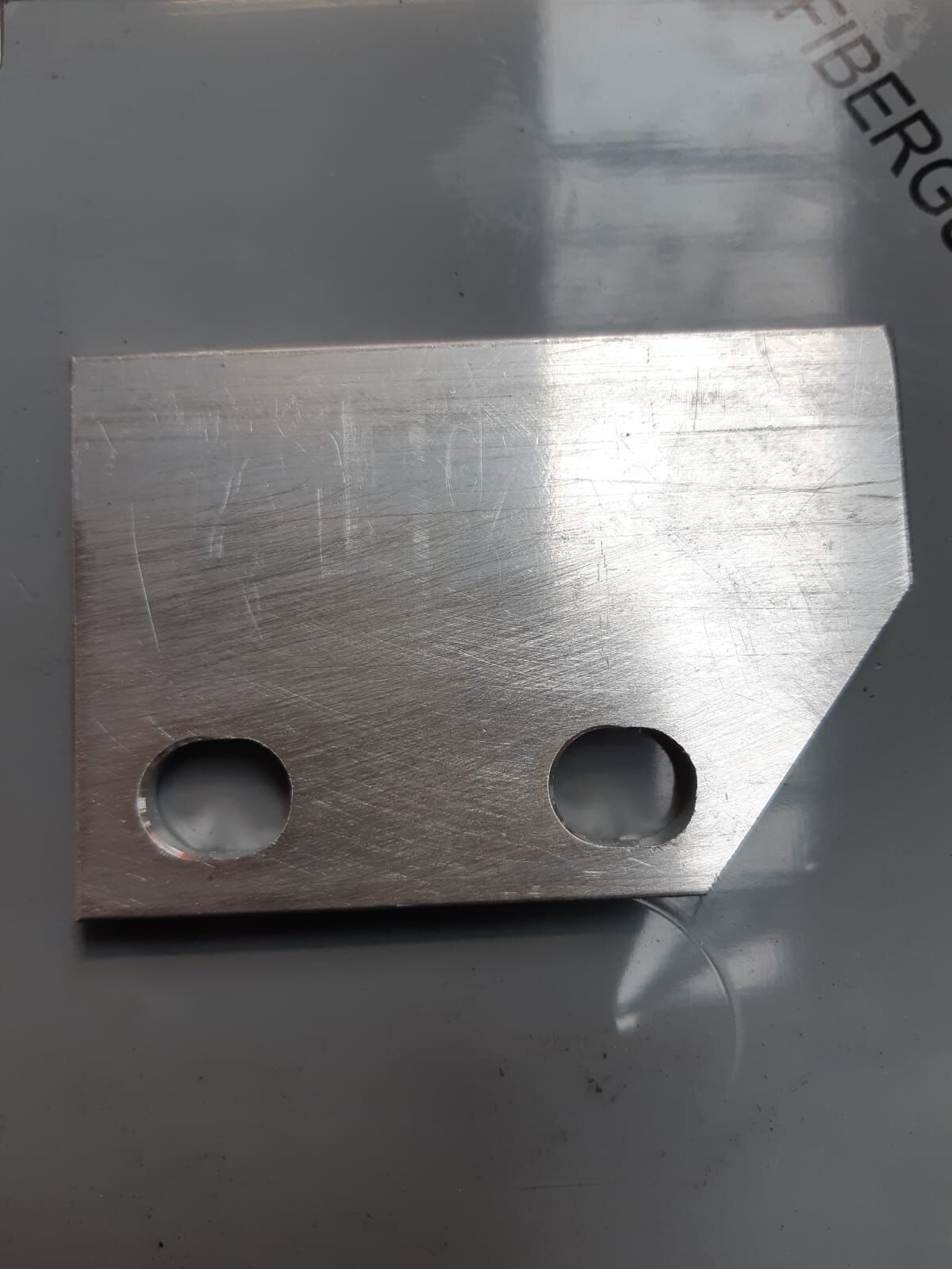

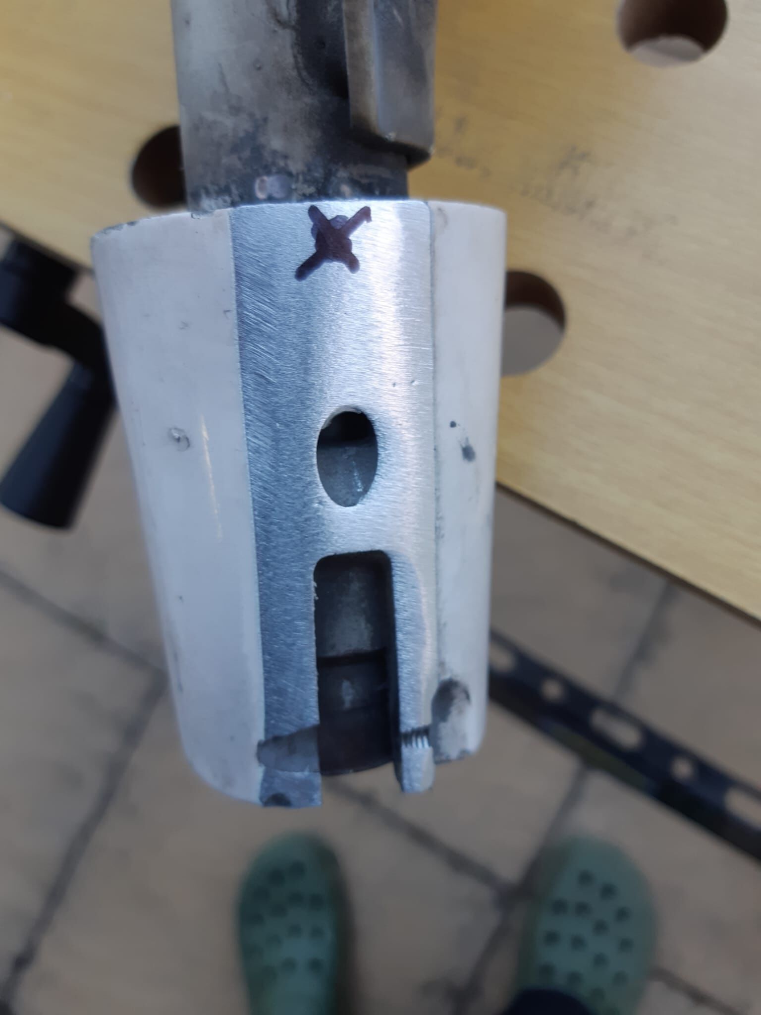

Next up is the modification to the handlebars to add hydraulic front disc
I've gone for the round hub as opposed to the star hub as I think it blends into the aesthetic better
@gravelrash2004 avatar
P Series / LML / Motovespa
Posts: 1629
Location: UK
Posts: 1629
Location: UK

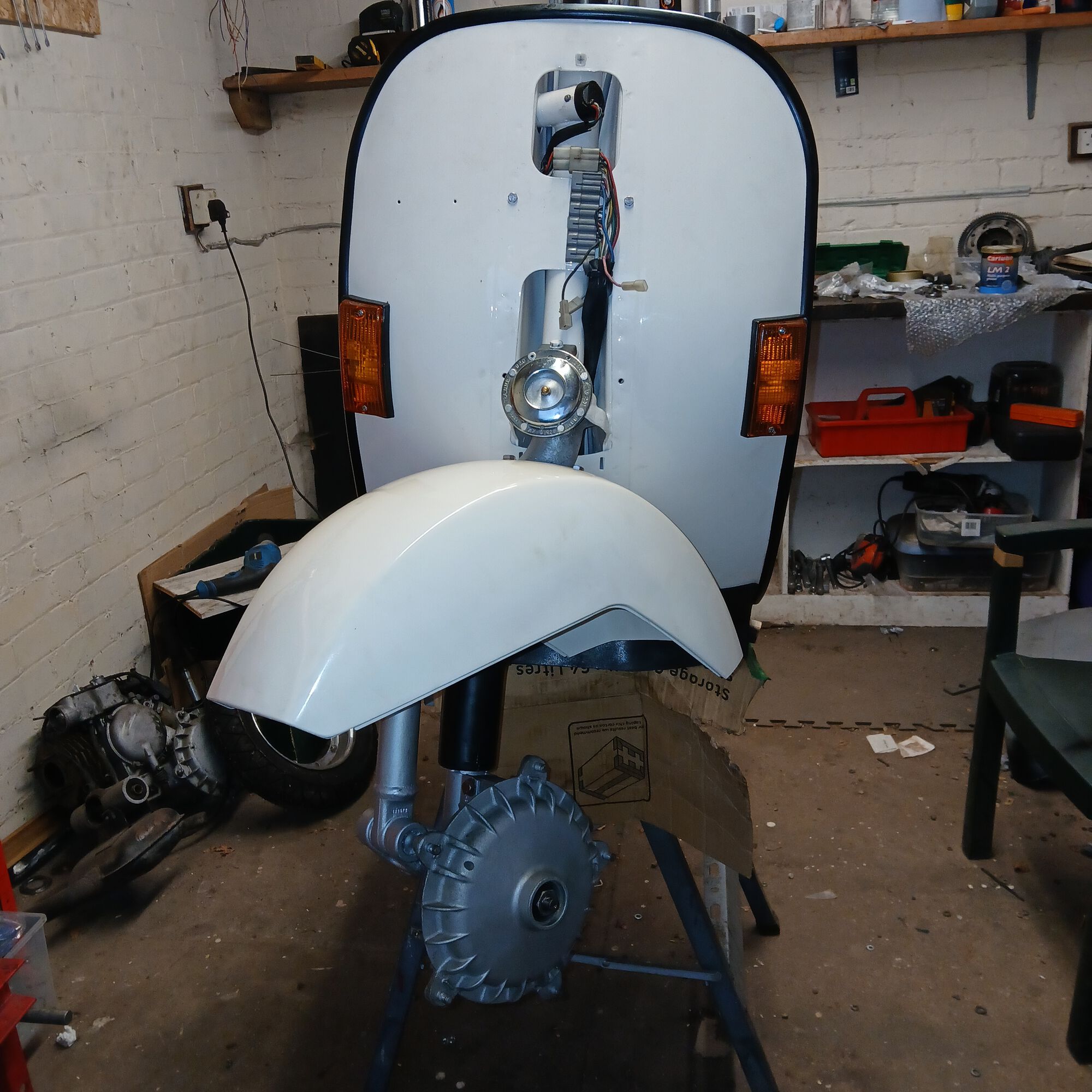

Excess to requirement aluminium removed, Plate fabricated and the Finished item
Grinder time :)
Grinder time :)
Plate ready to attach
Attached and ready to modify the plastics at a later time

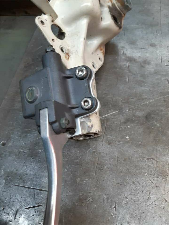

parallelogramerist
Posts: 6228
parallelogramerist
Posts: 6228
I also added a master cylinder mount to my T5's handlebar. Disc brakes was definitely an upgrade!
Great to hear someone else does this too! I thought long and hard about it as I'm planning on running a stock engine with a box pipe. I unned and ahhh about it then decided that if a car pulls up fast in front of me I want to NOT run into the back of them. Any suggestions on disk or pads to utilise? Or is stock sufficient for this?
FYI I run a disk on my P2 and it's tuned, but I feel it needs more stopping power also

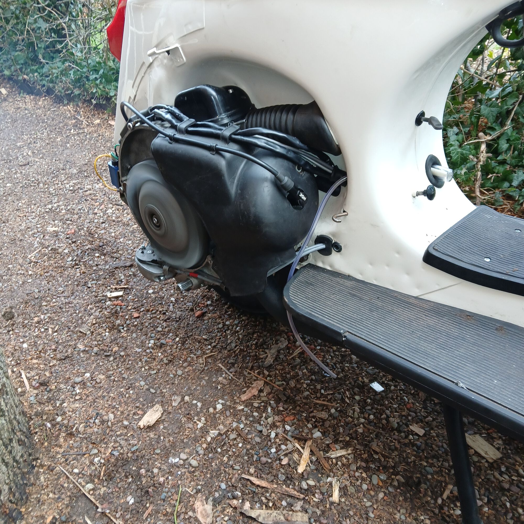

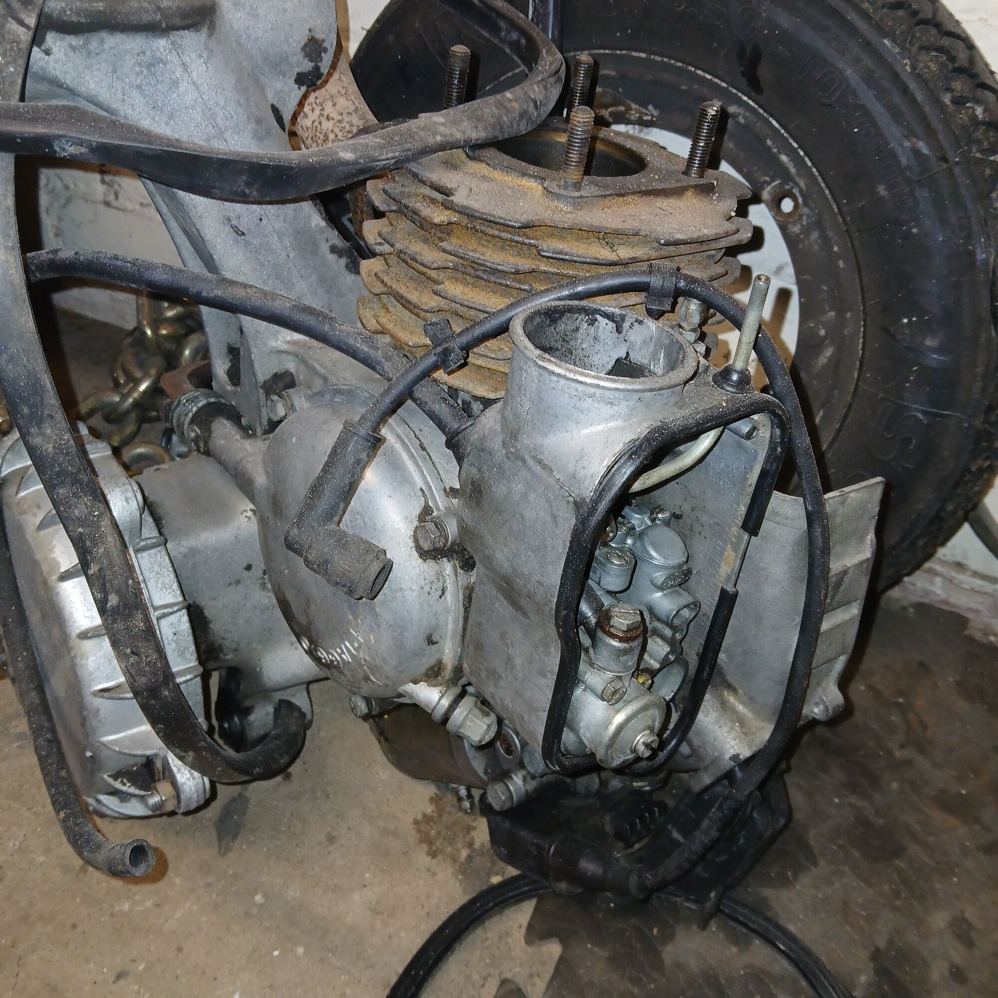

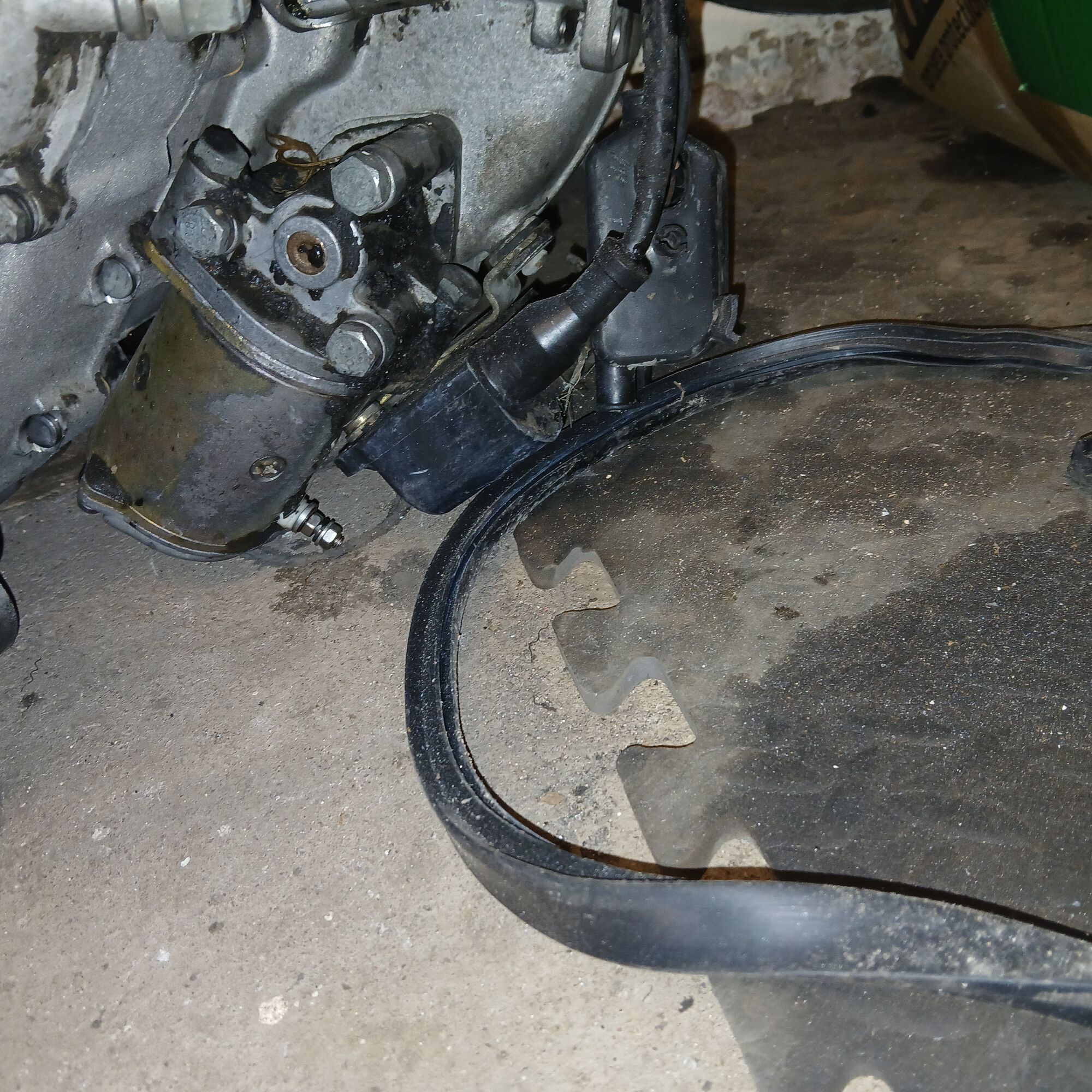

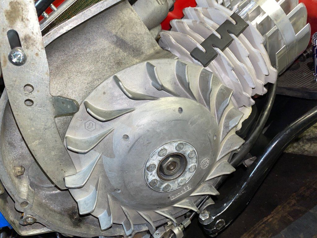

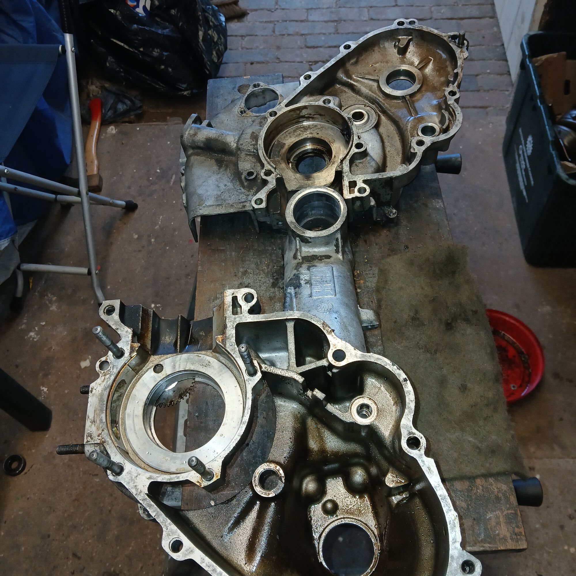

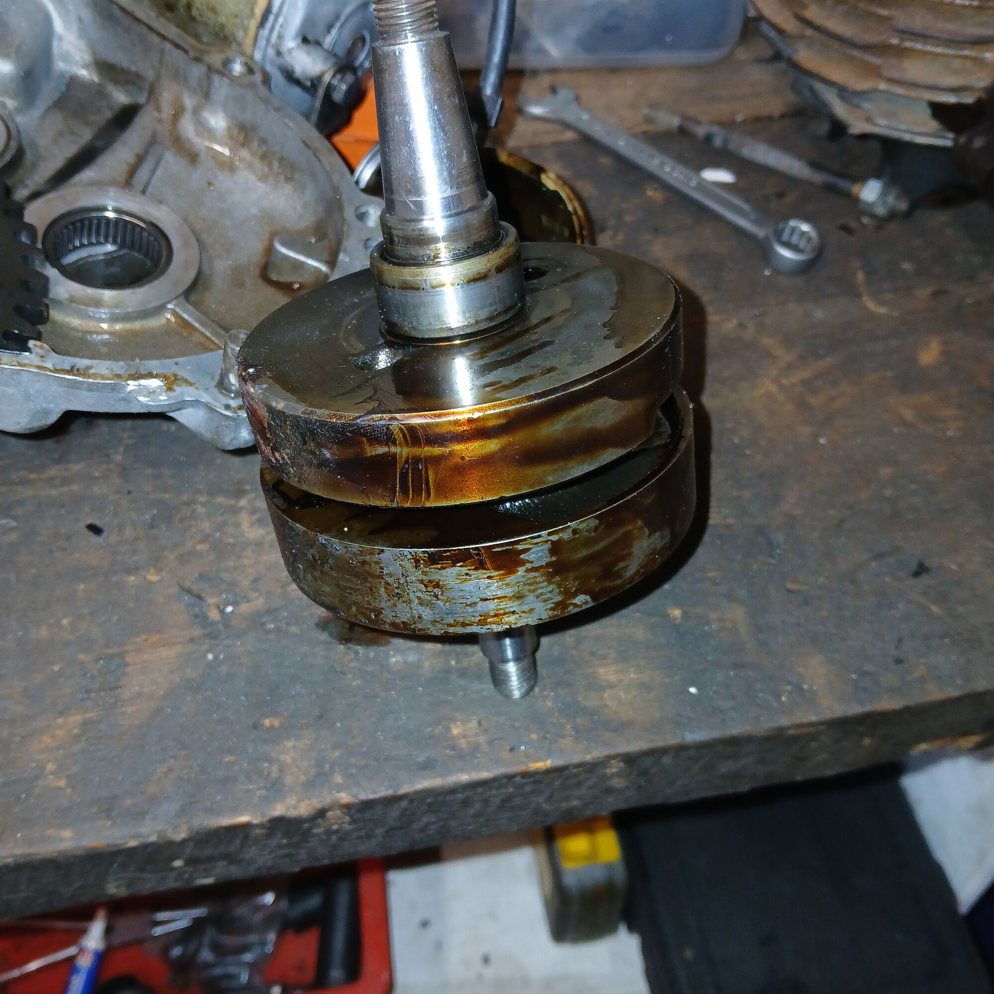

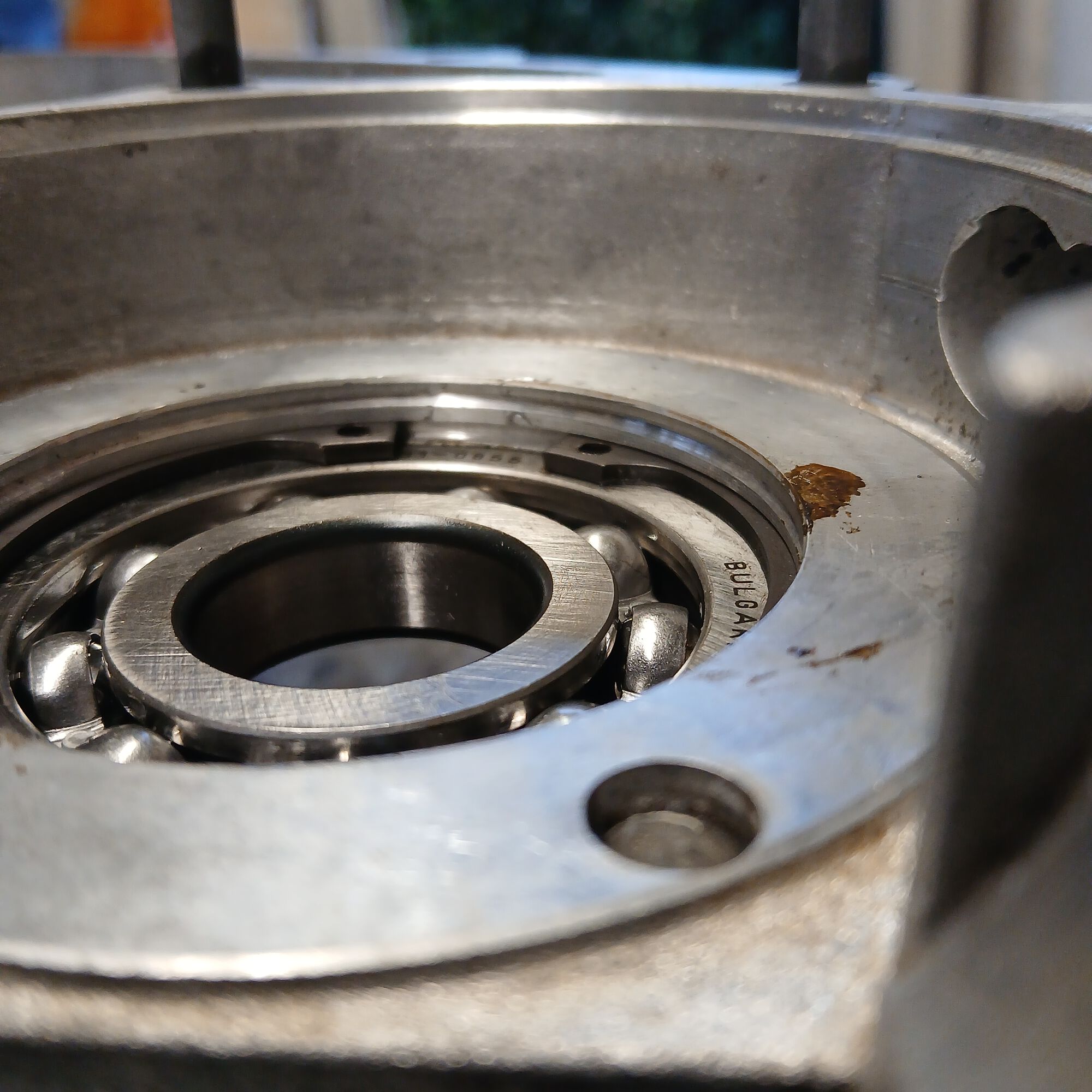

Oh unhappy moment!!!
I picked the engine up to start dismantling it and the crank is locked solid... not sure at this time if it's the piston seized into the polini barrel or something else... I will have to dismantle and split the casings to get the crank out
Everything else was going so well.....

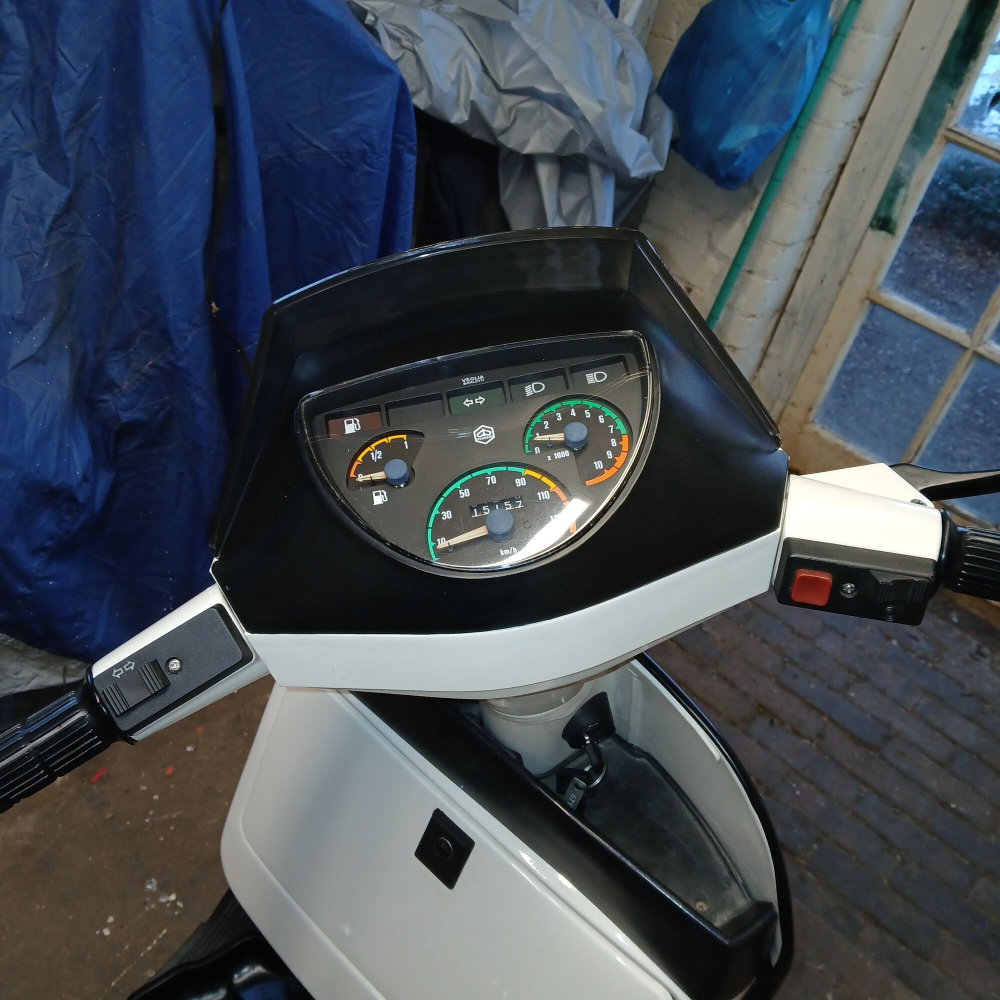

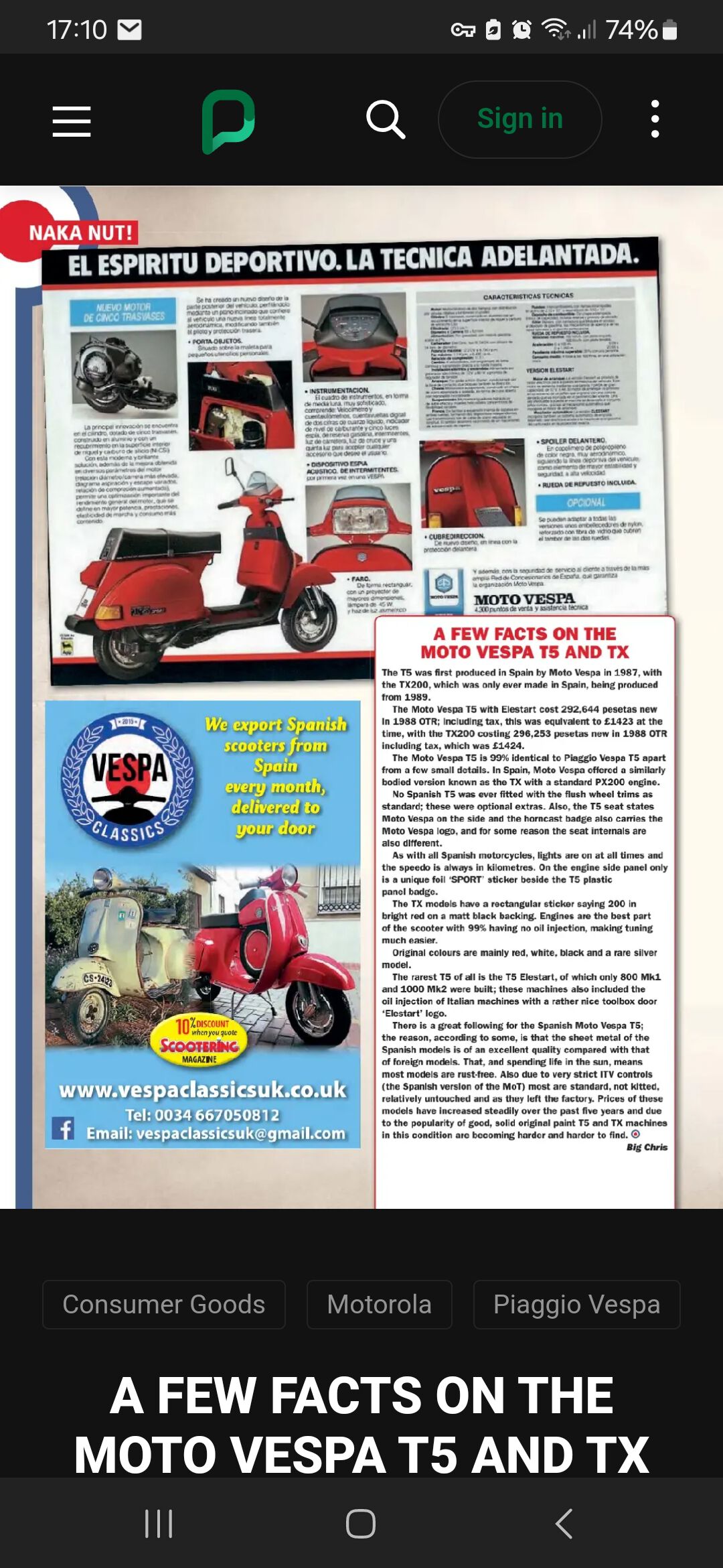

It is a T5 or actually a TX200 ?
Posts: 1629
Location: UK
Posts: 1629
Location: UK

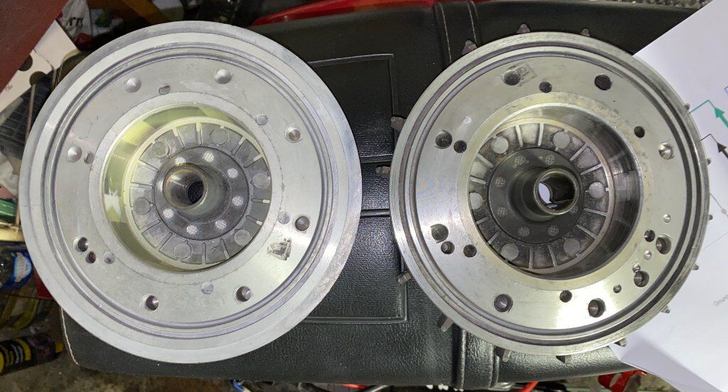

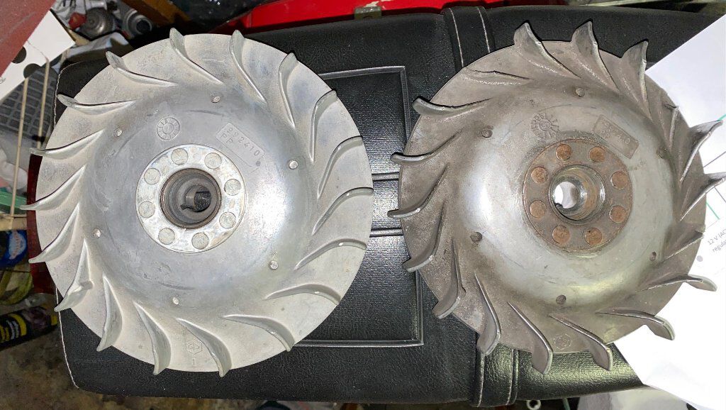

Genuine bonfire Elecrric start T5
I will he going to the workshop later if you want me to post any photos?
Posts: 1629
Location: UK
Posts: 1629
Location: UK
Couple of photos to show it's a T5 electric start and not a TX
Polini 152 barrel

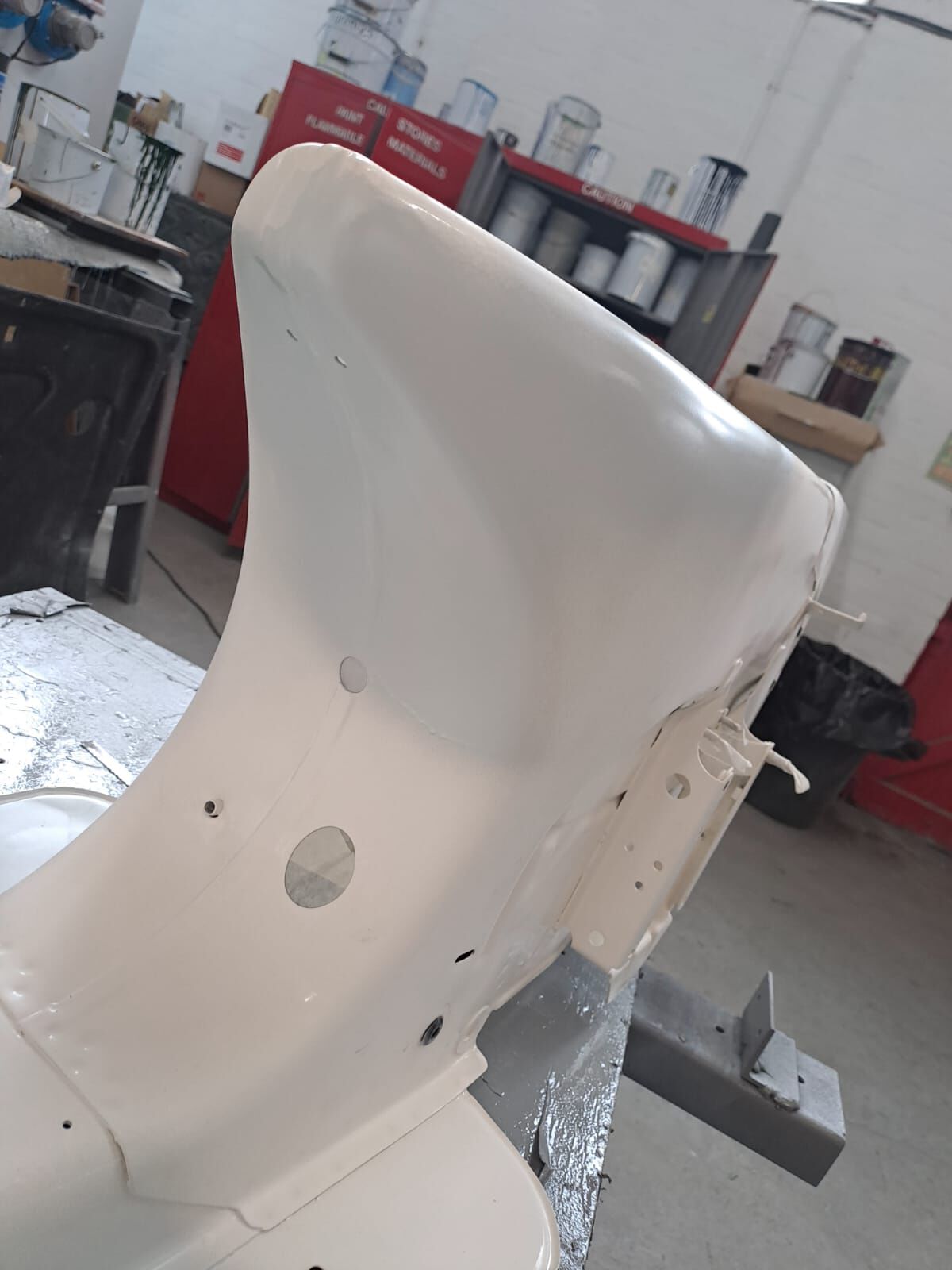

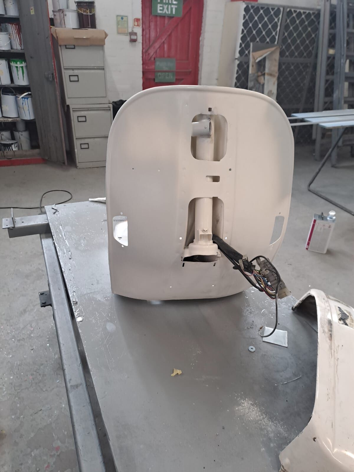

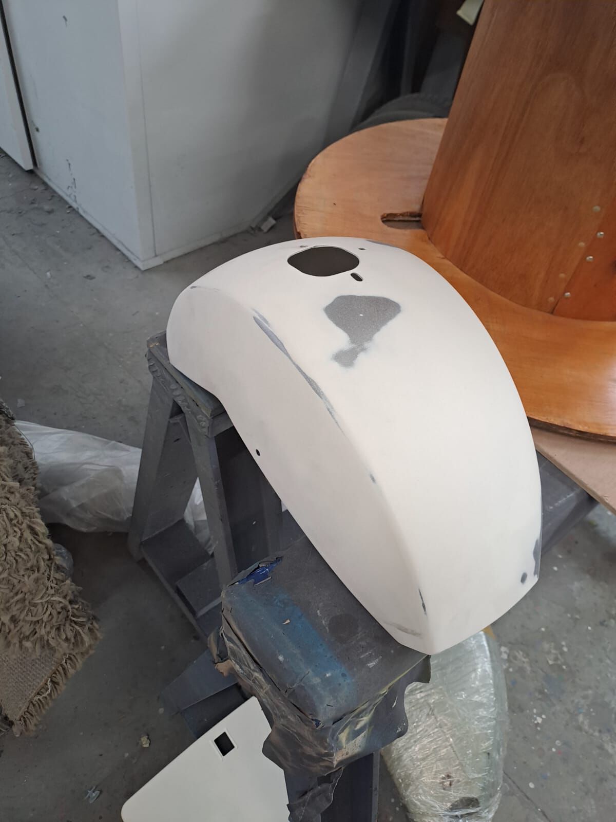

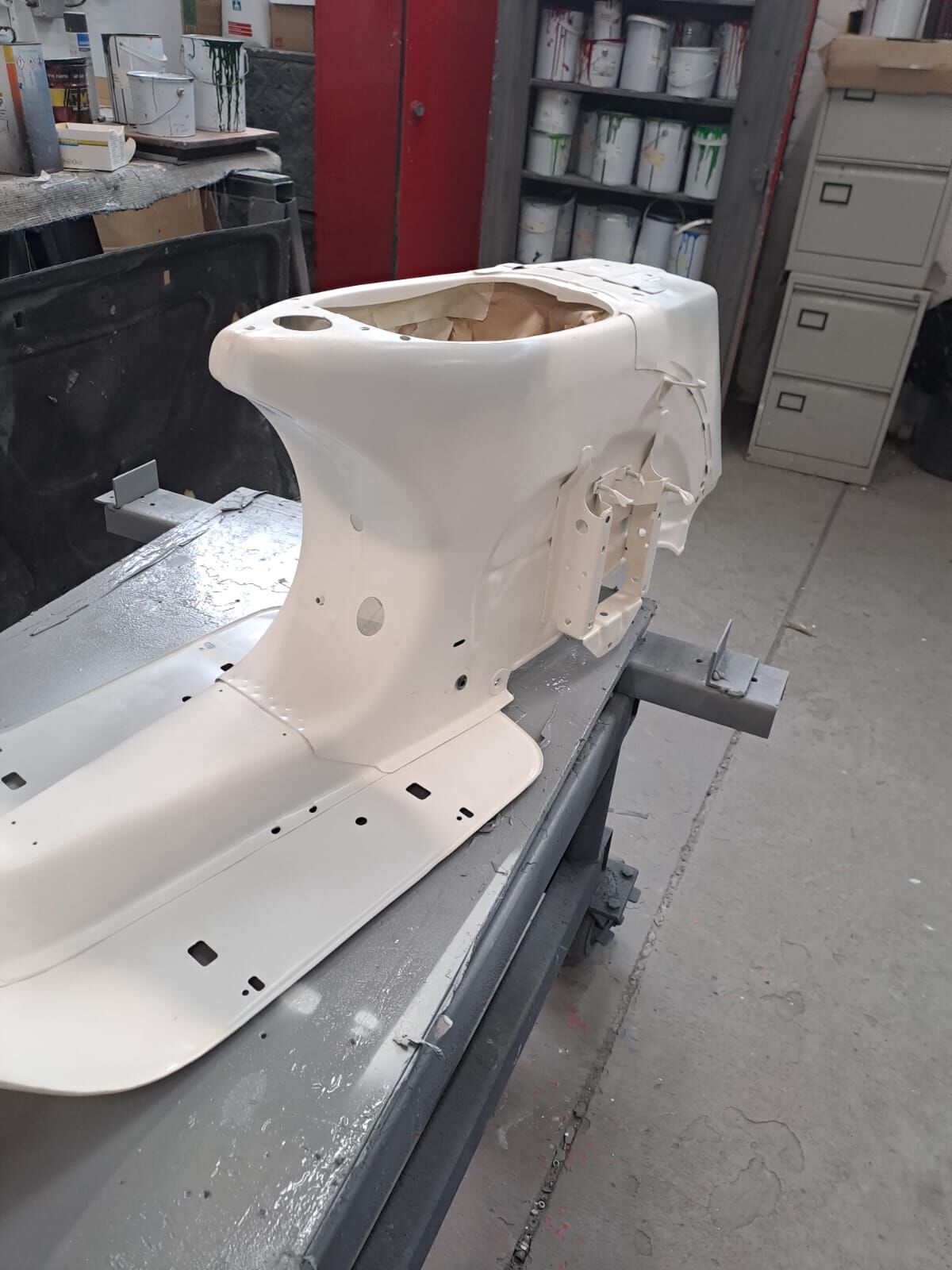

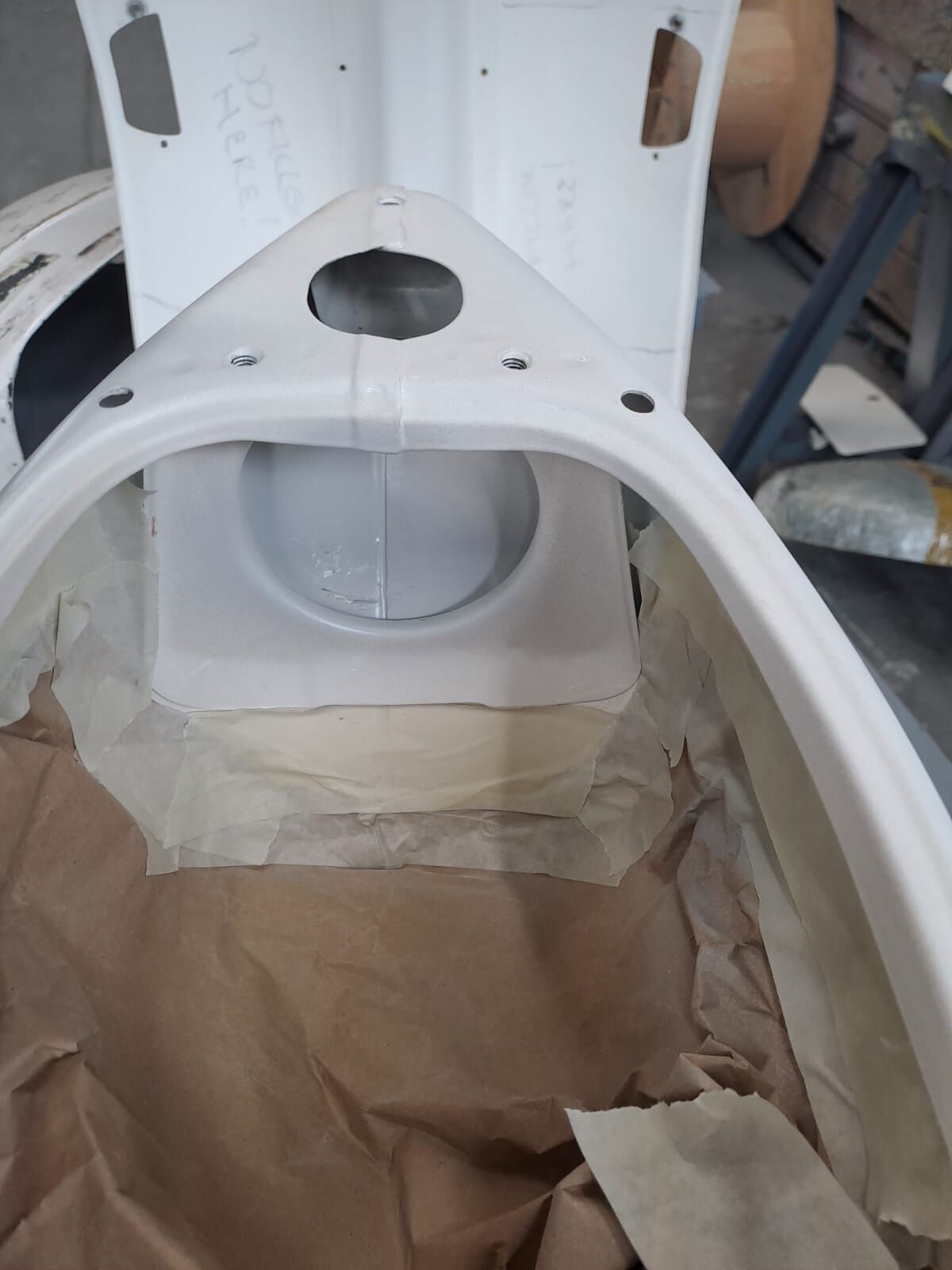

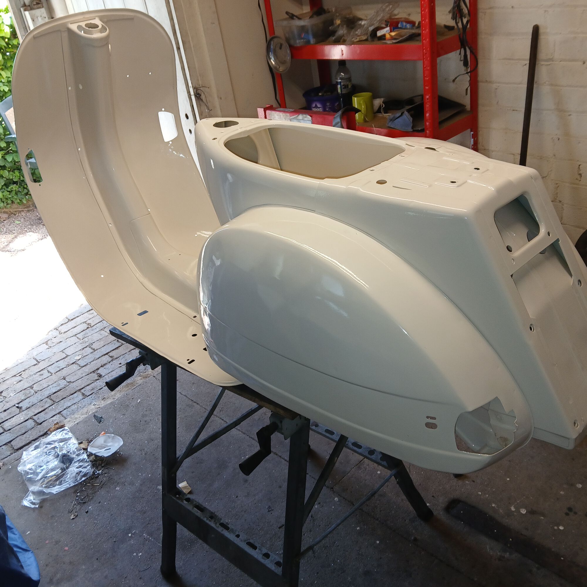

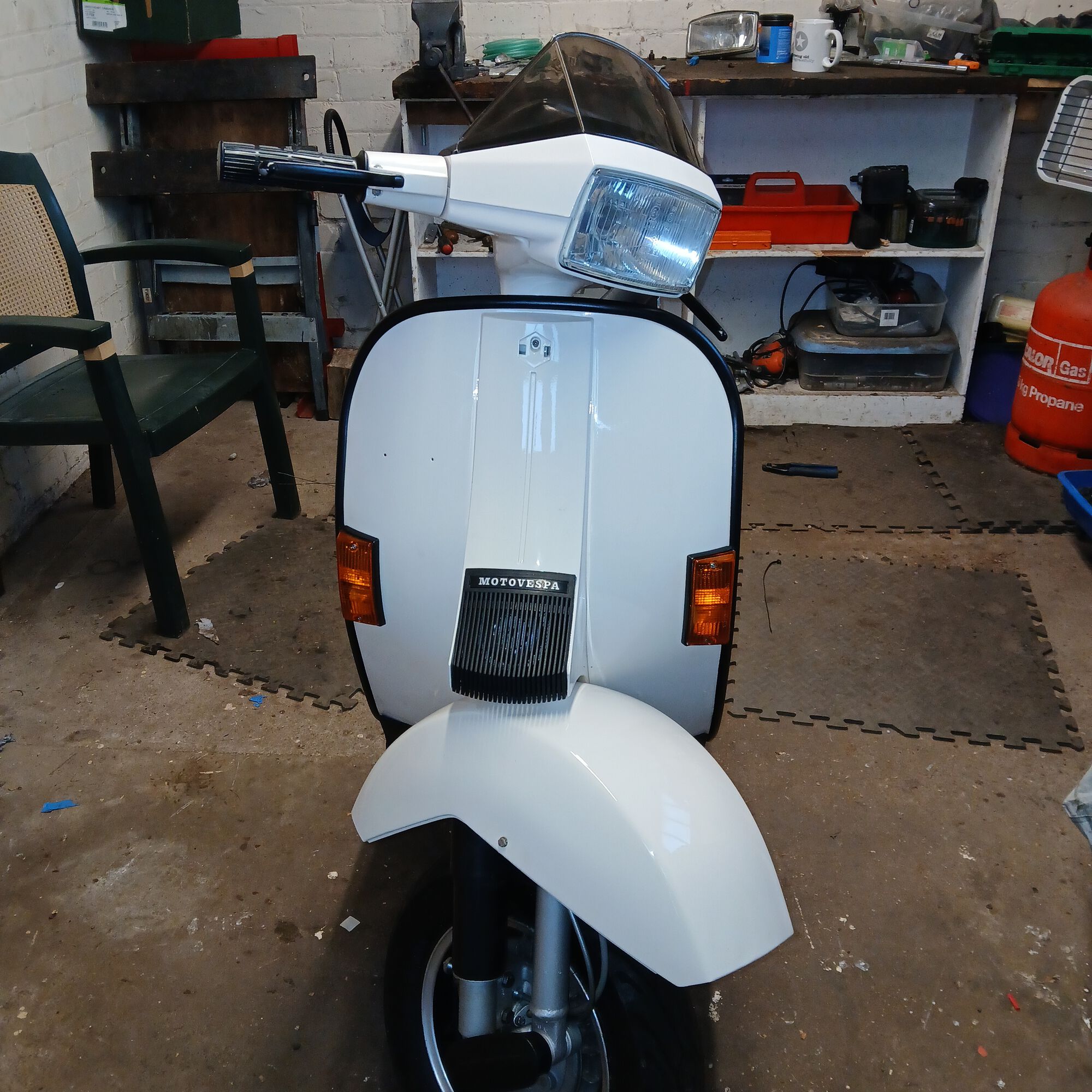

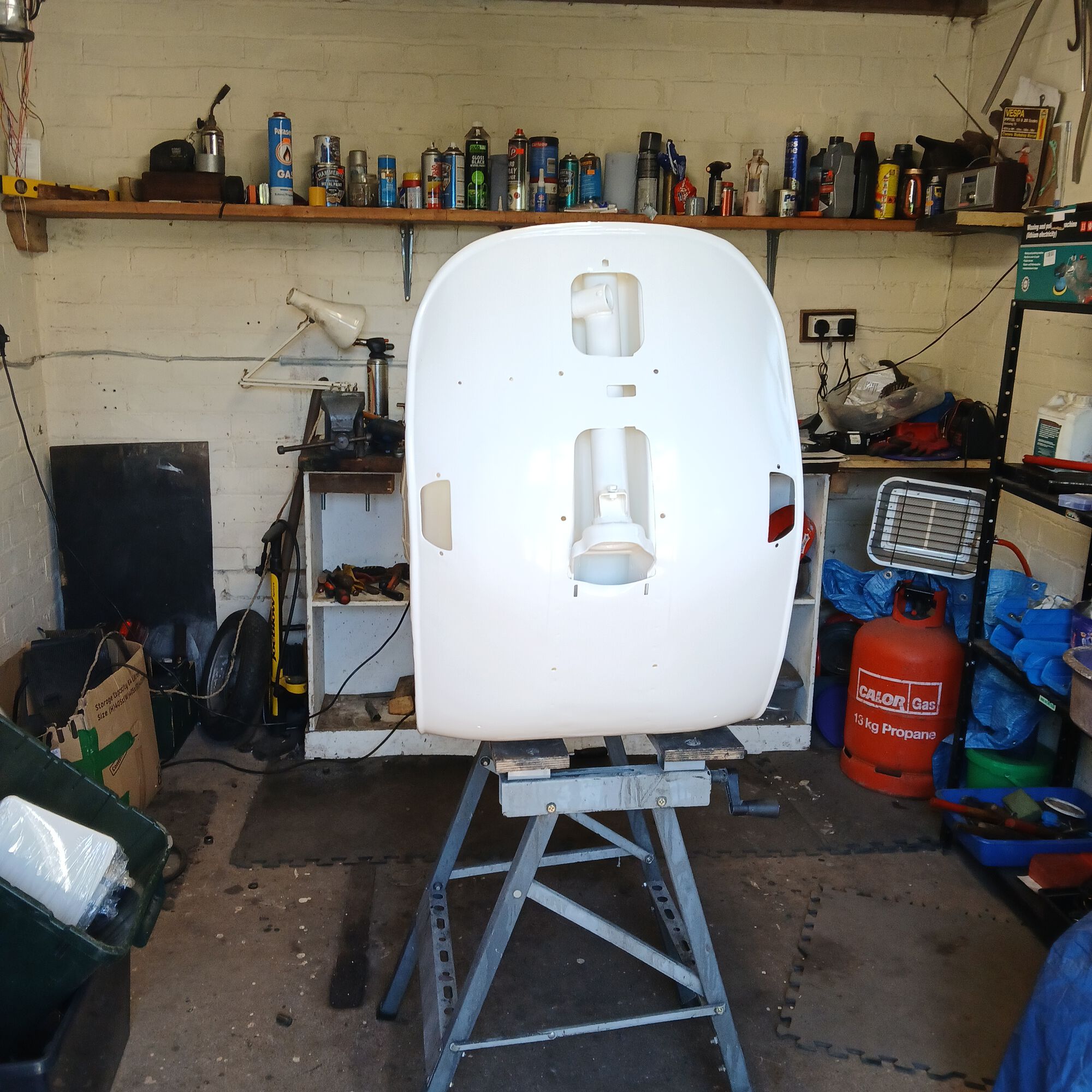

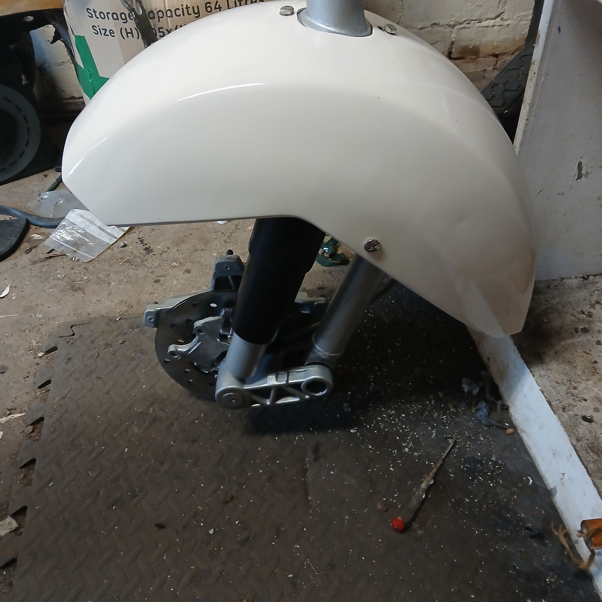

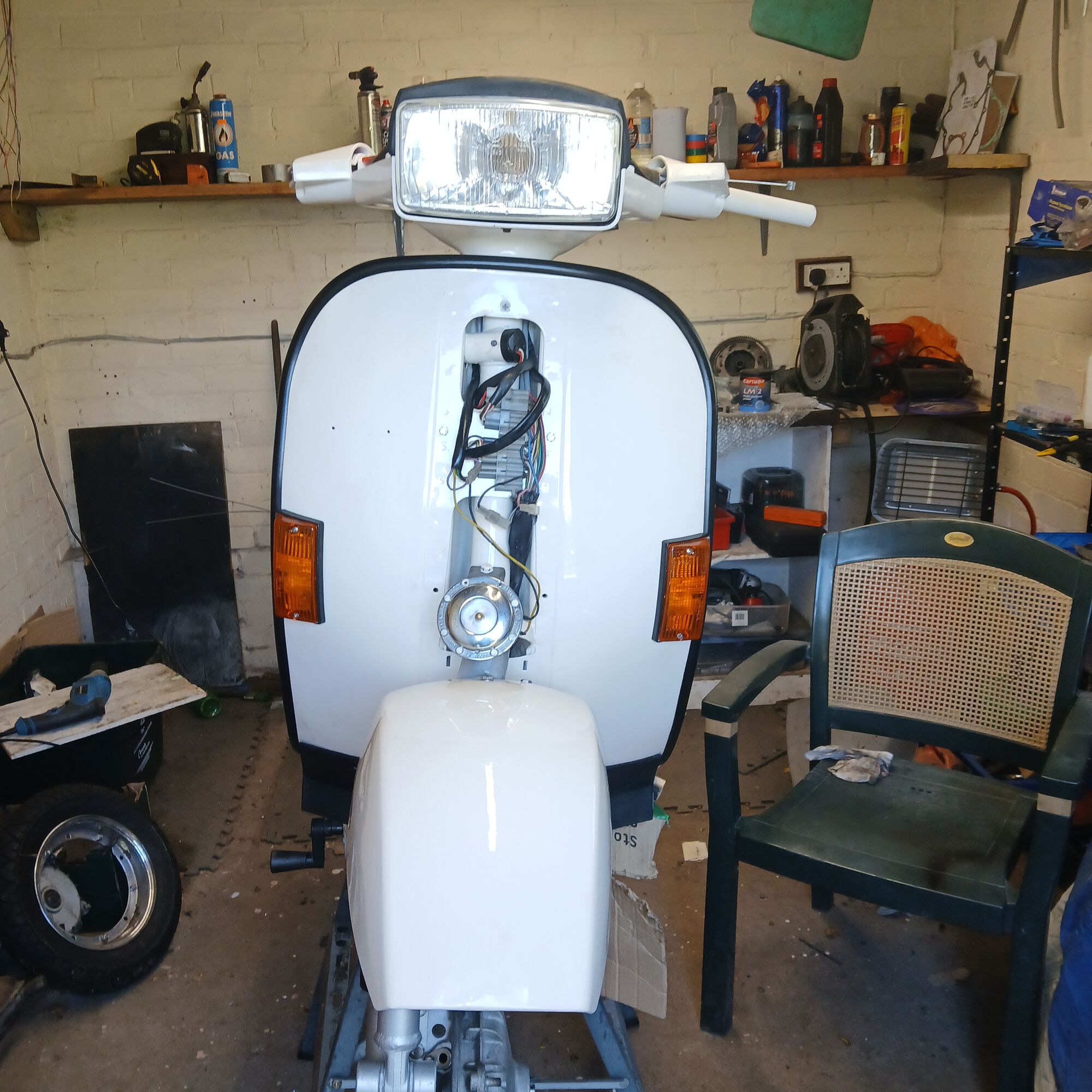

Received a call this morning from the Powder Coating Place.
Toddled over to collect it and it looks a nice finish, I have deliberately and will deliberately leave some of the minor dings in place that are still visible. Th3se to me help show the age of the vehicle and some of it's history is still intact for all to see... Plus it also makes it plainly obvious that it's not all filler or as I think it's termed in America "Bondo"
It looks very white in these photos, it's actually a subtle cream colour- as close to the original paint u could find in a powder coat finish
Zoom in and you will see some panel deviation I have deliberately ledt
Nice side view
Nice side view

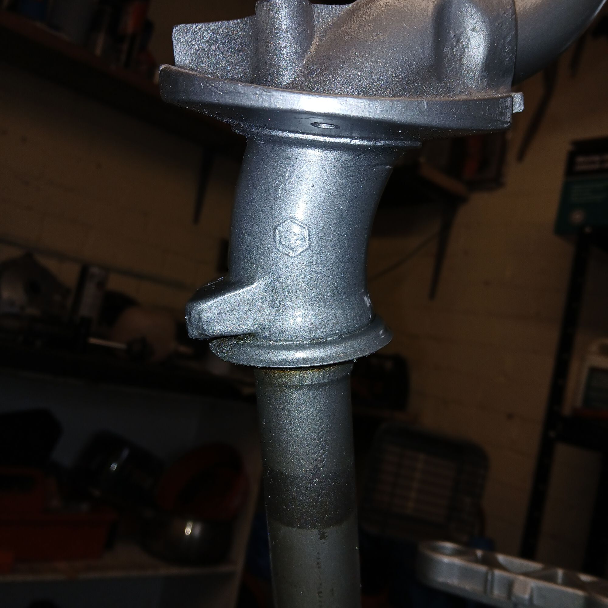

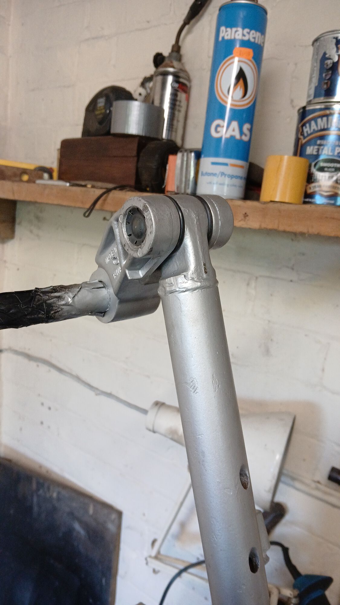

Had a bit of a wrestling match with the fitting of the pivot pin, but it's nearly there... just need to finish of seating the locking tabs in and I can call that job finished
Plus added a J Hancock to the frame for any future owner to ponder over
Nearly there with the new pin

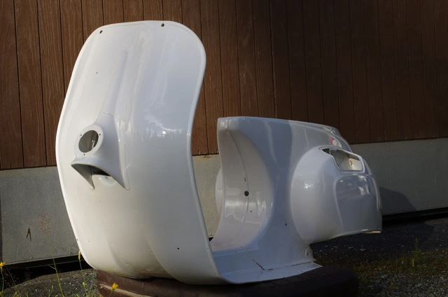

Reminds me of this moment I got my hands on freshly powder coated primmy frame. Just realized this was 13 years ago

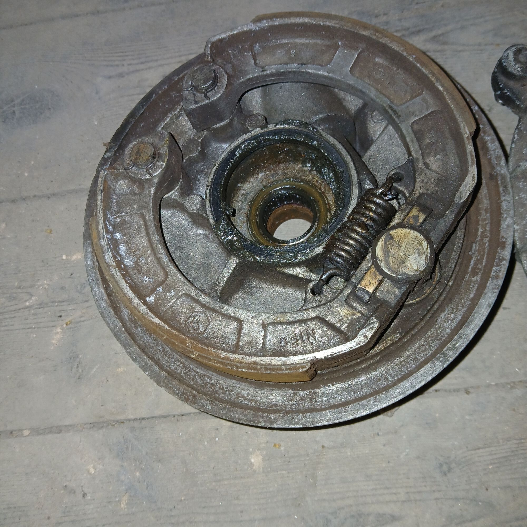

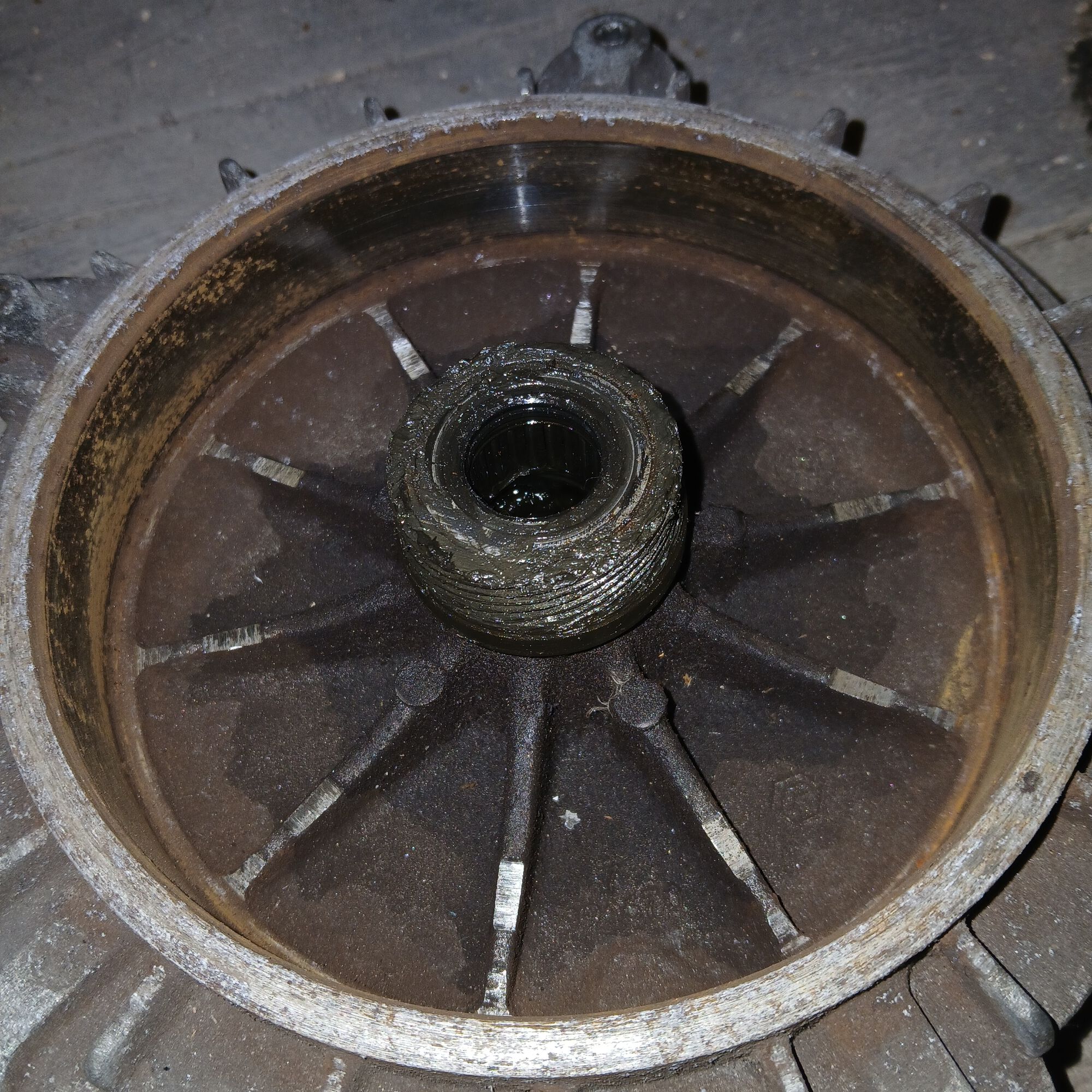

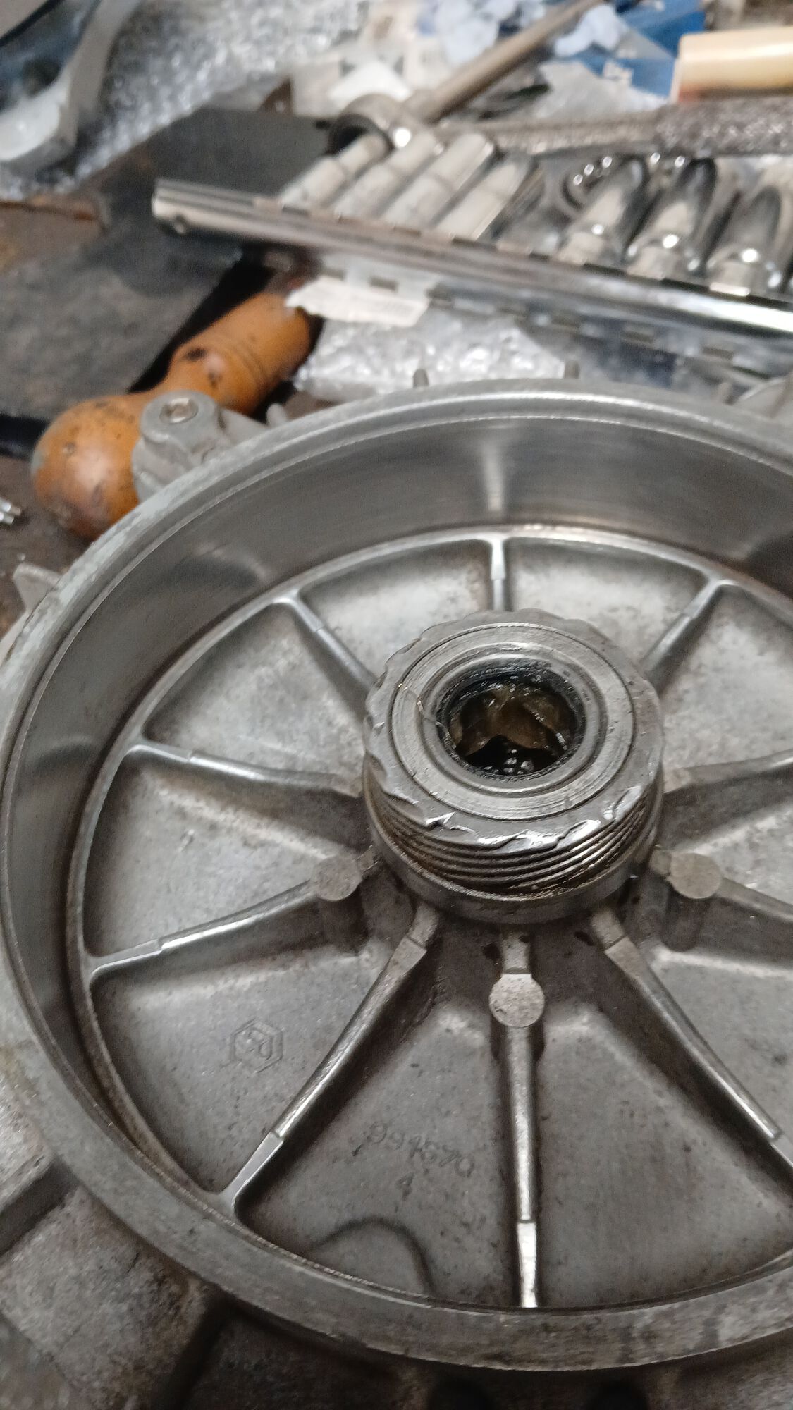

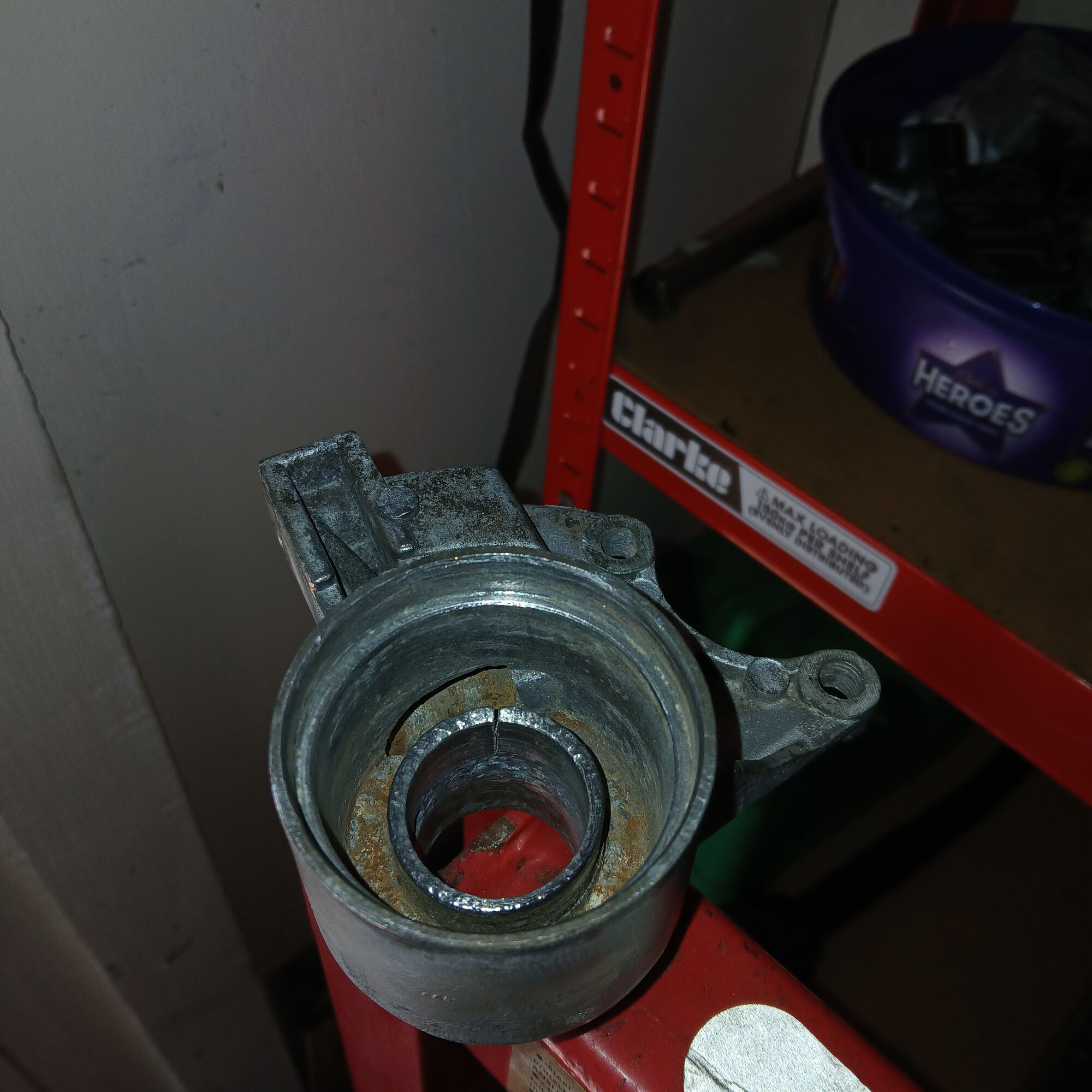

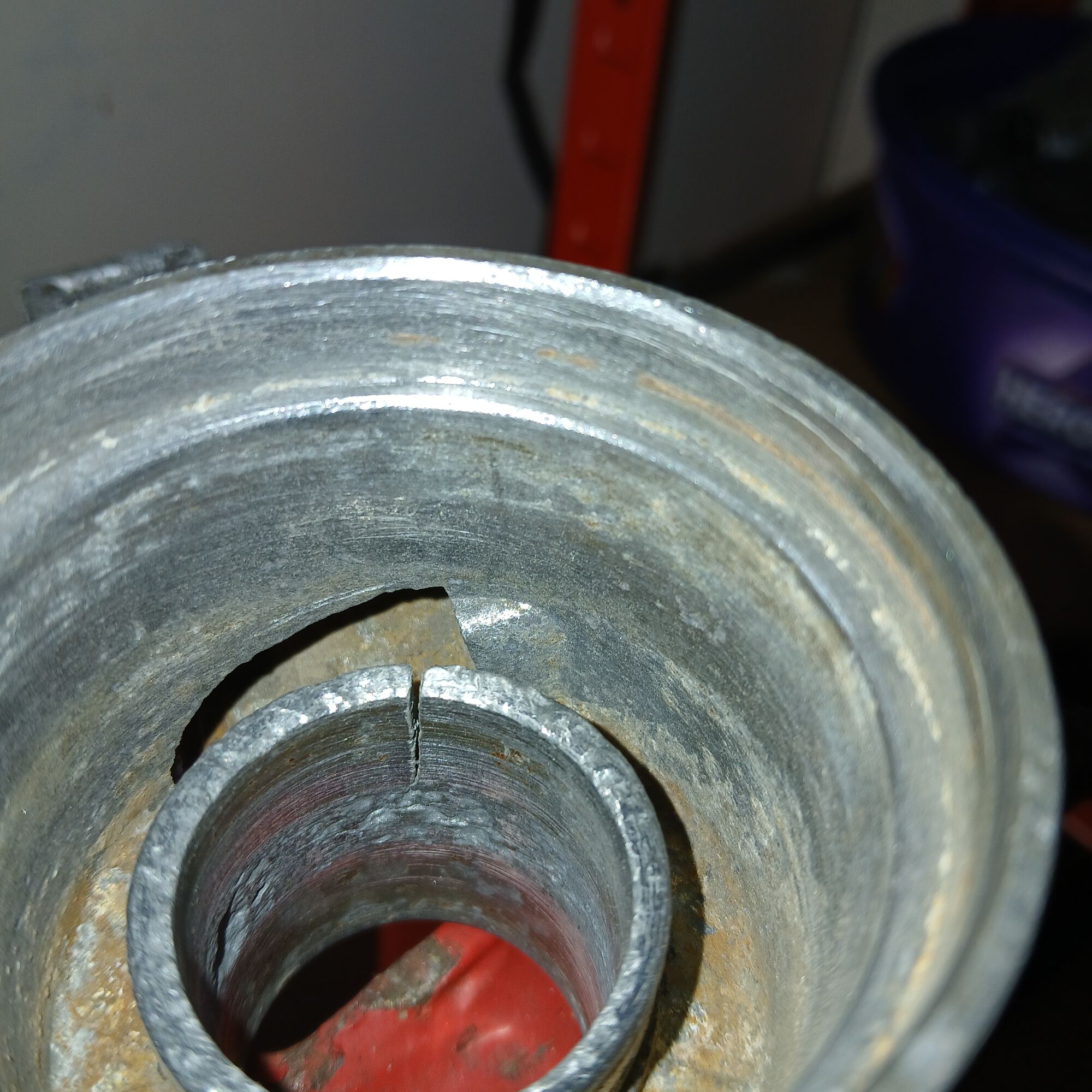

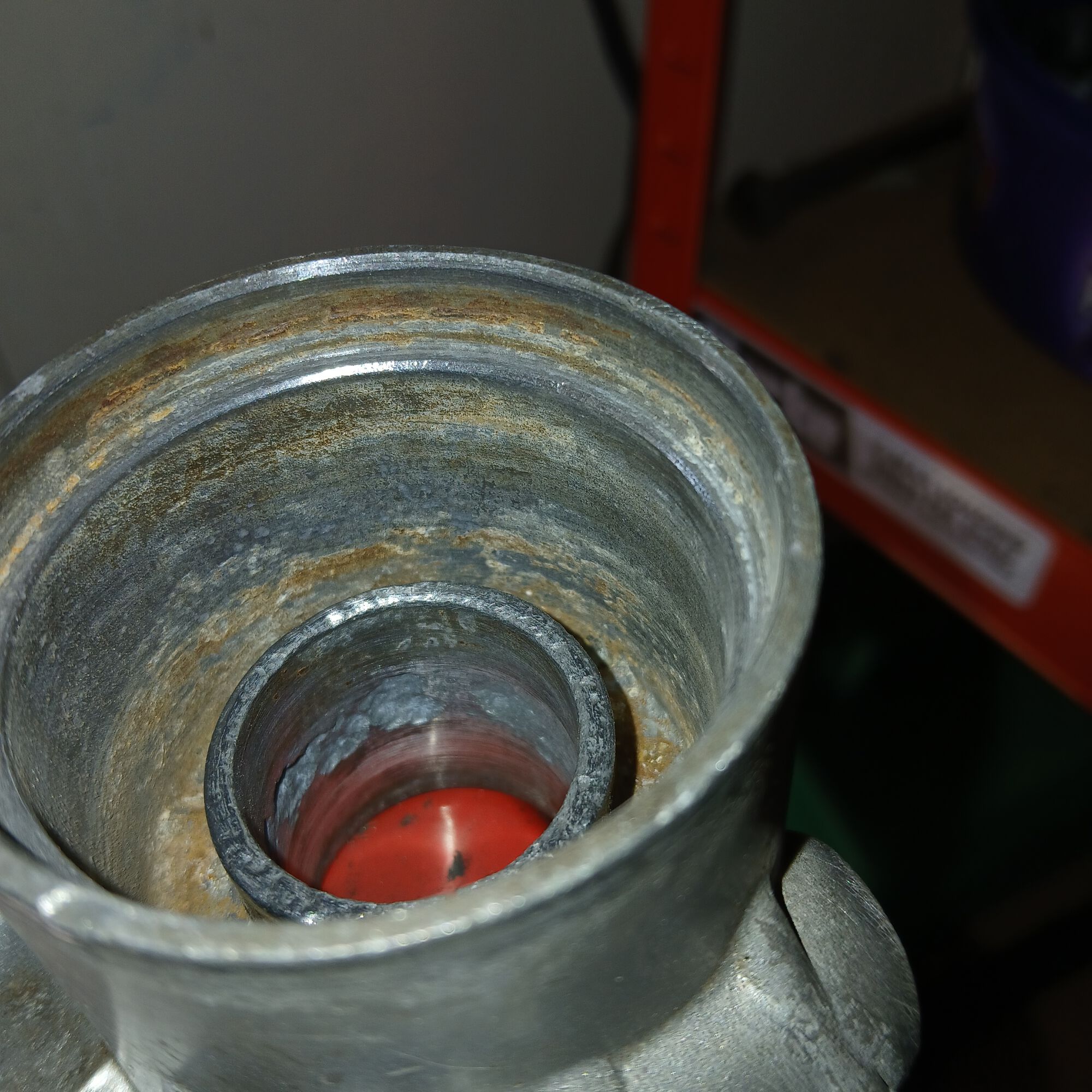

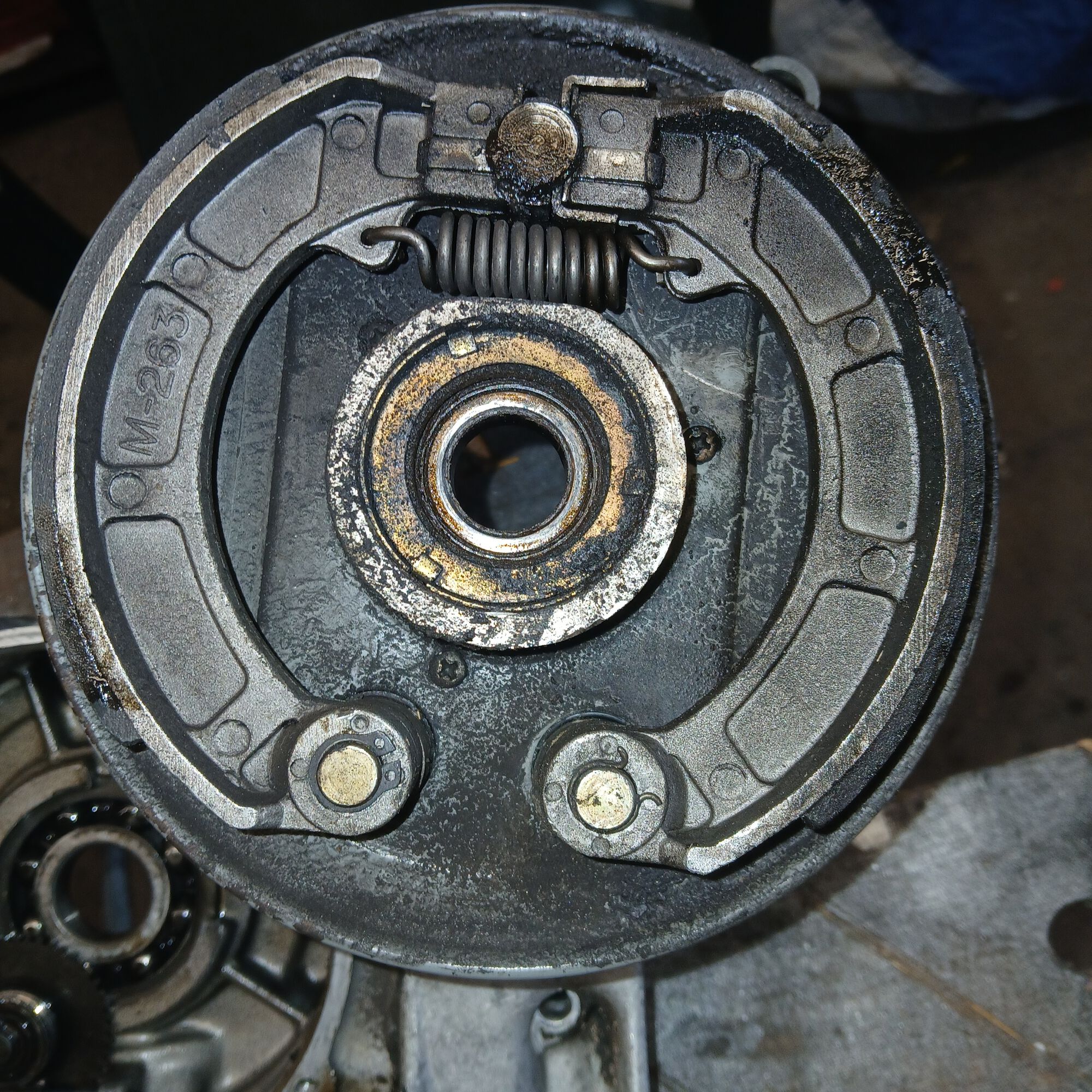

Cleaned the front hub and carrier for the disk today as I am prepping to add new bearings and seals....
I'm so glad I did, it was a fatal accident waiting to happen+!+
Photos attached as they speak for themselves
Spotted this.....
Spotted this.....
Only fit for the scrap yard now...
Very poor... almost through to the other side these divets

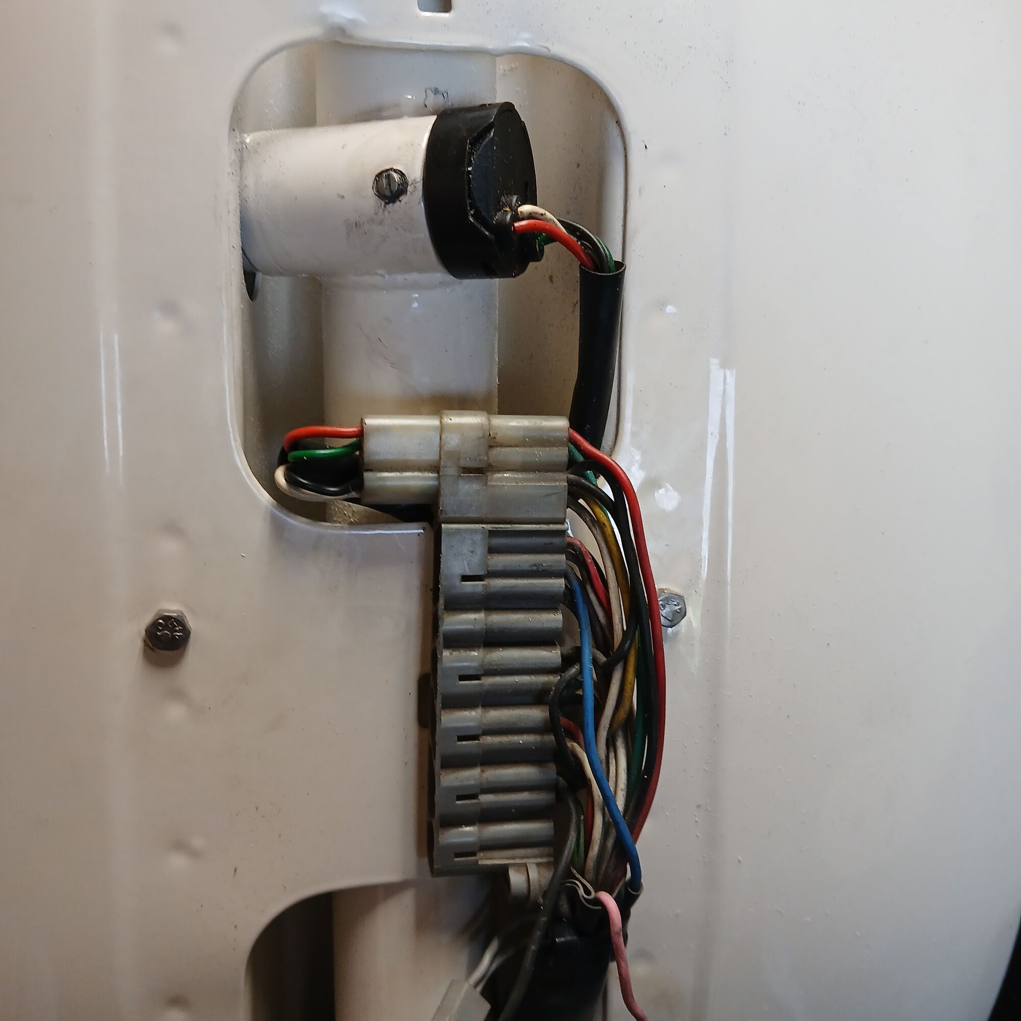

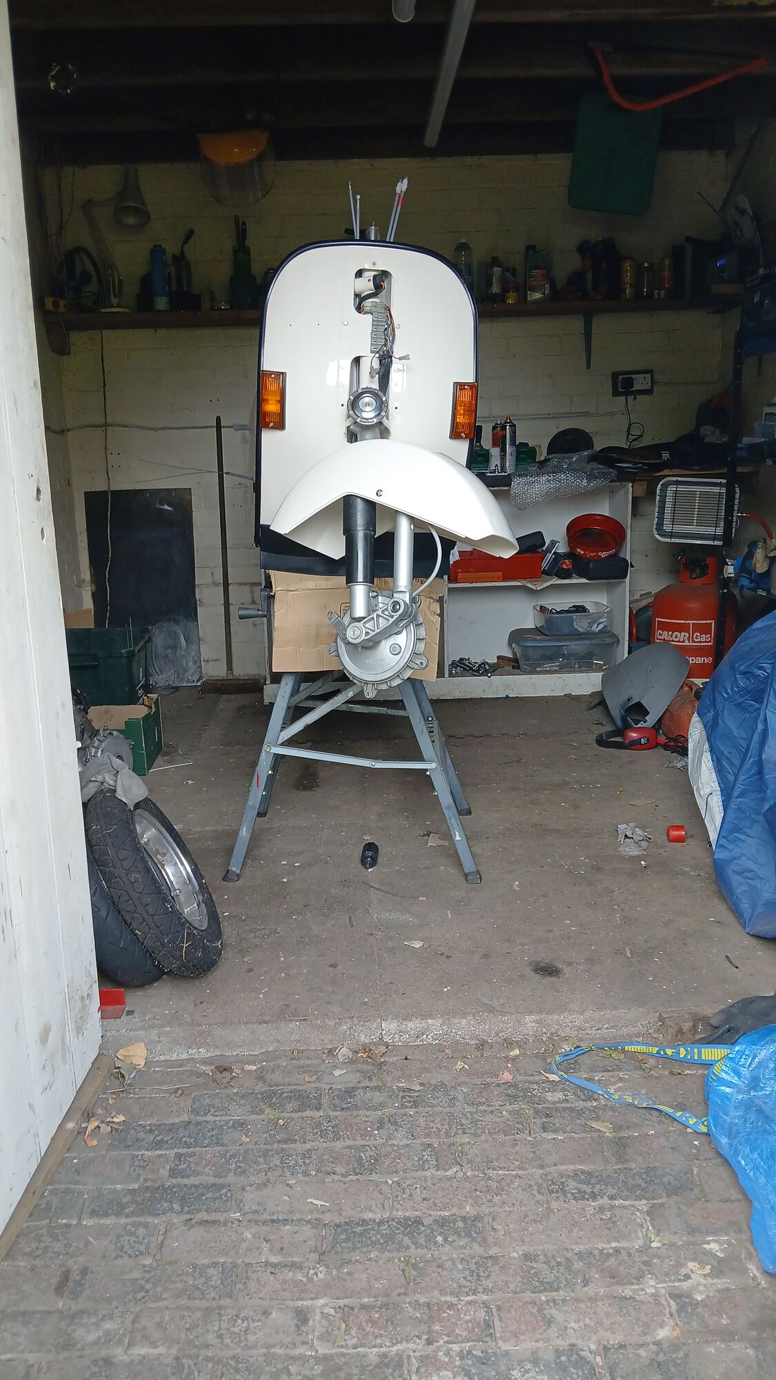

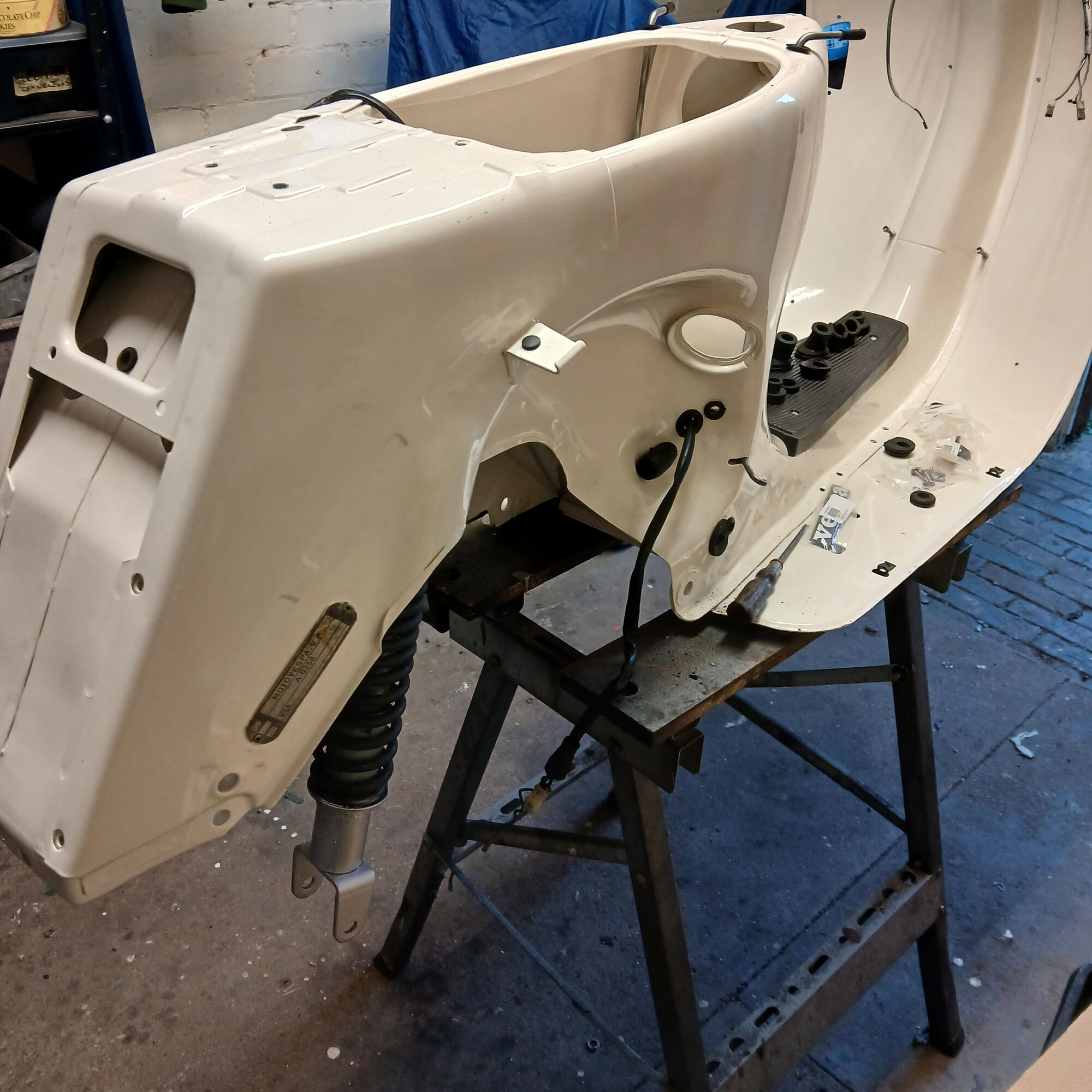

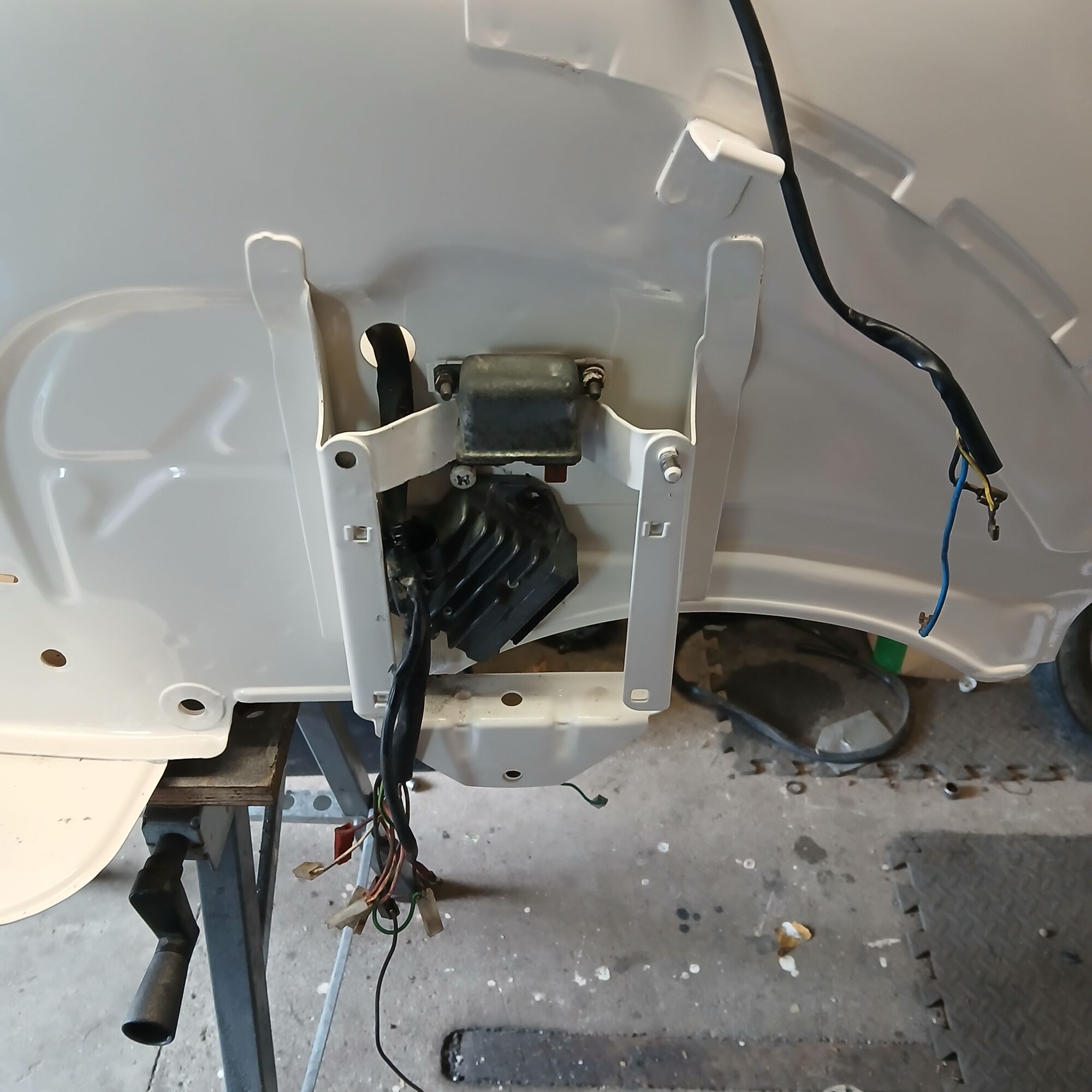

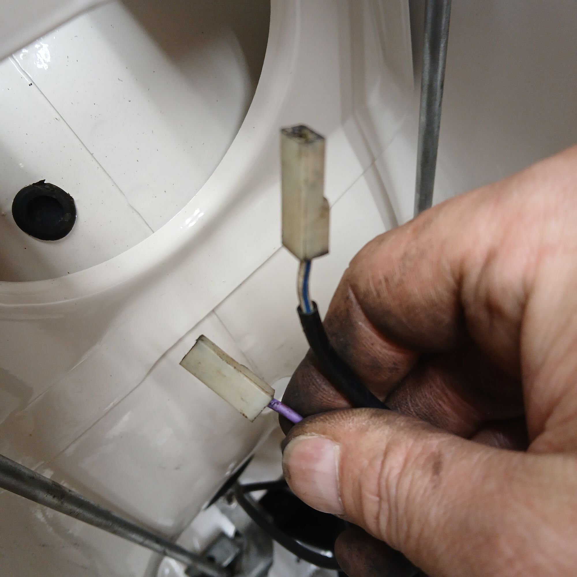

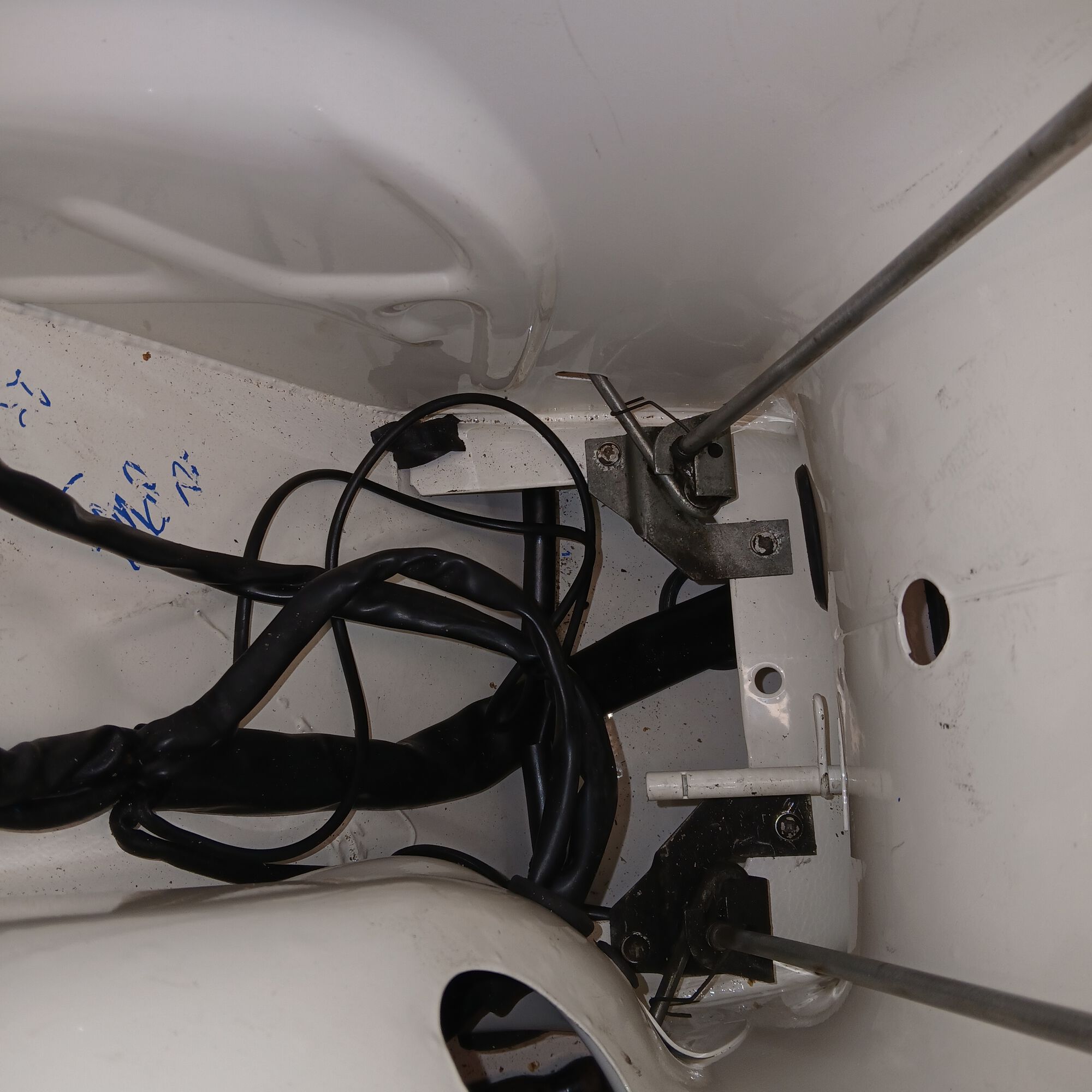

Not much to post about today, I cleaned up the front and back shockers and gave them a flick of paint - the front disk hub too.. I ended up swapping for a star hub as opposed to tbe full round disk hub. That was also damaged. Used parts always carry a risk and this was an unlucky purchase. Thankfully I had spare setup so on that went.
Fed the wiring loom through also and called it a day
Post progress will be a little bit slower for a while as I wait for parts to land in the post

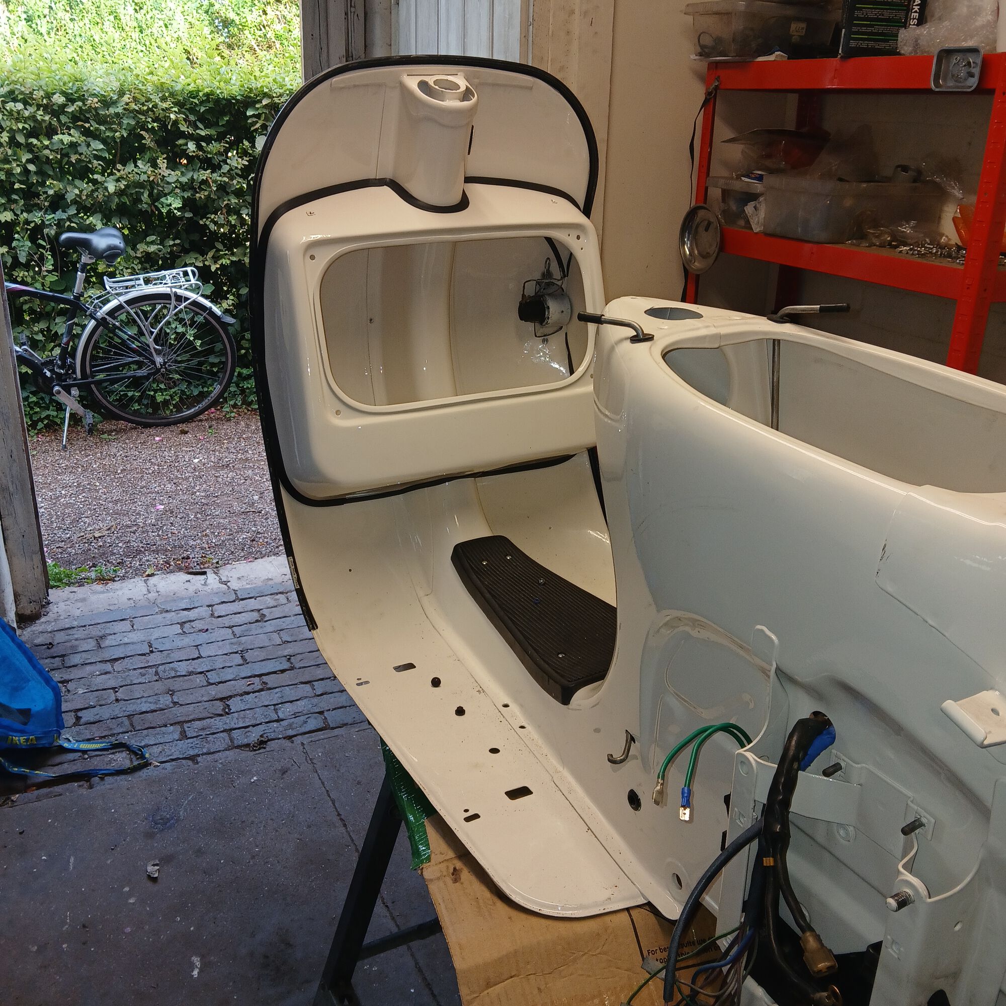

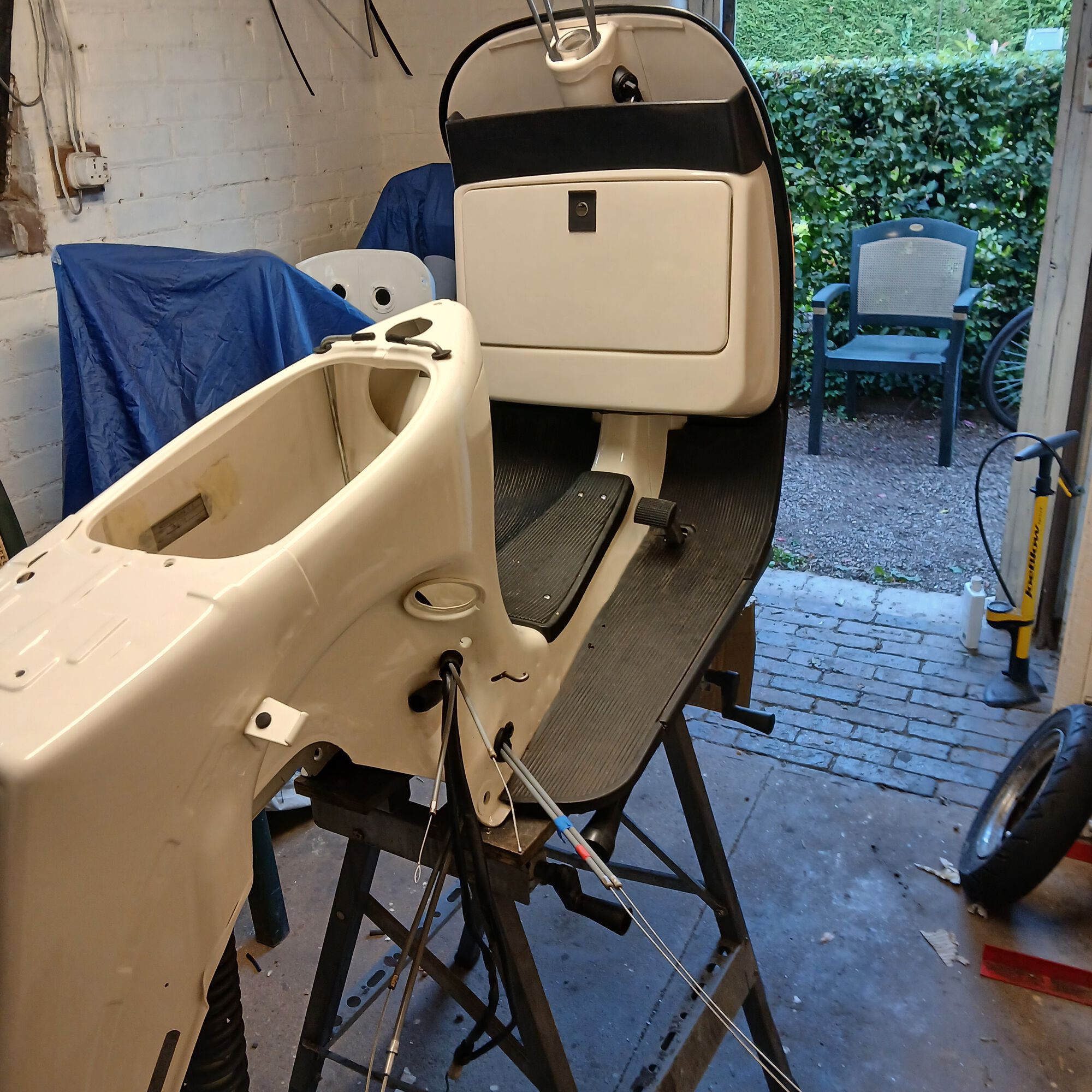

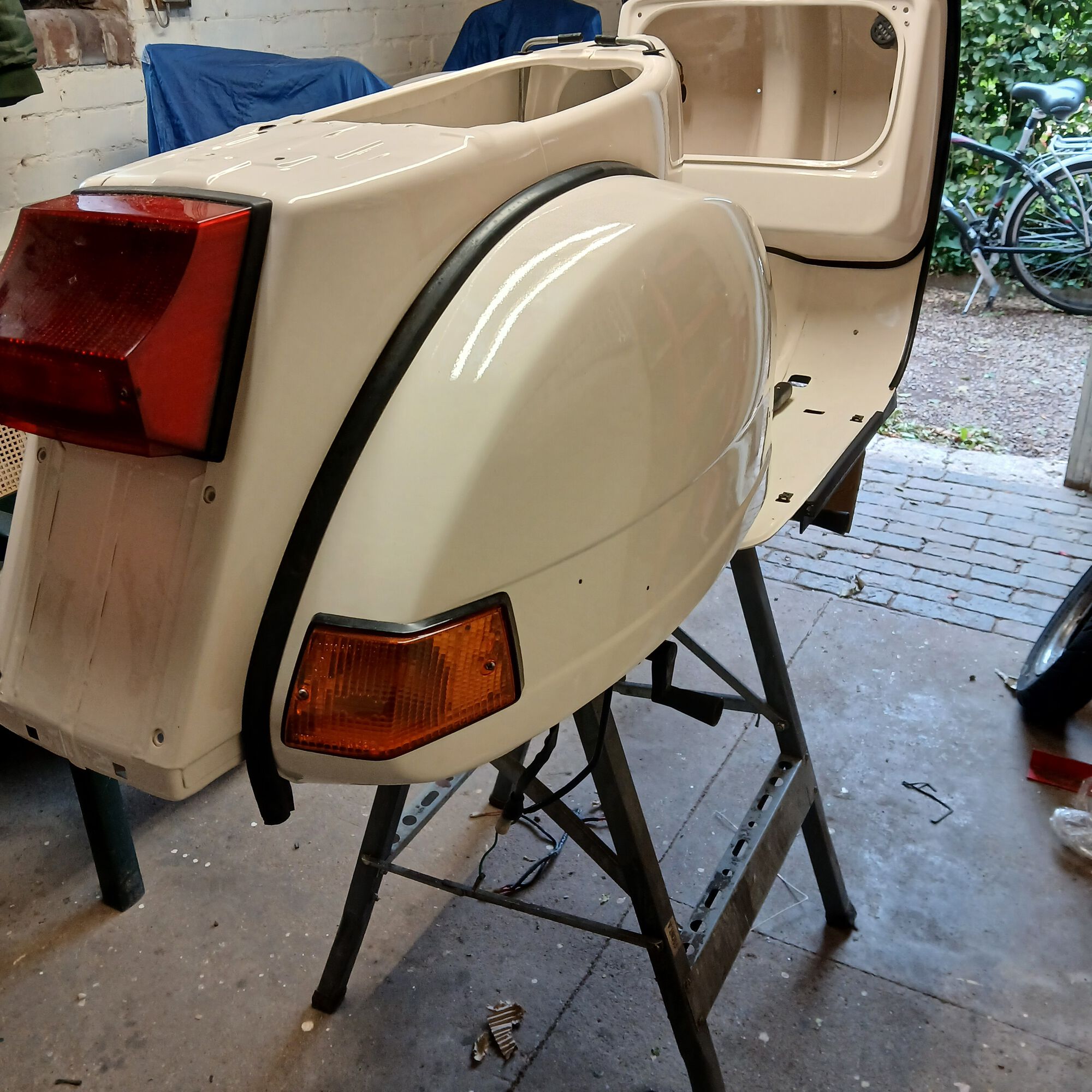

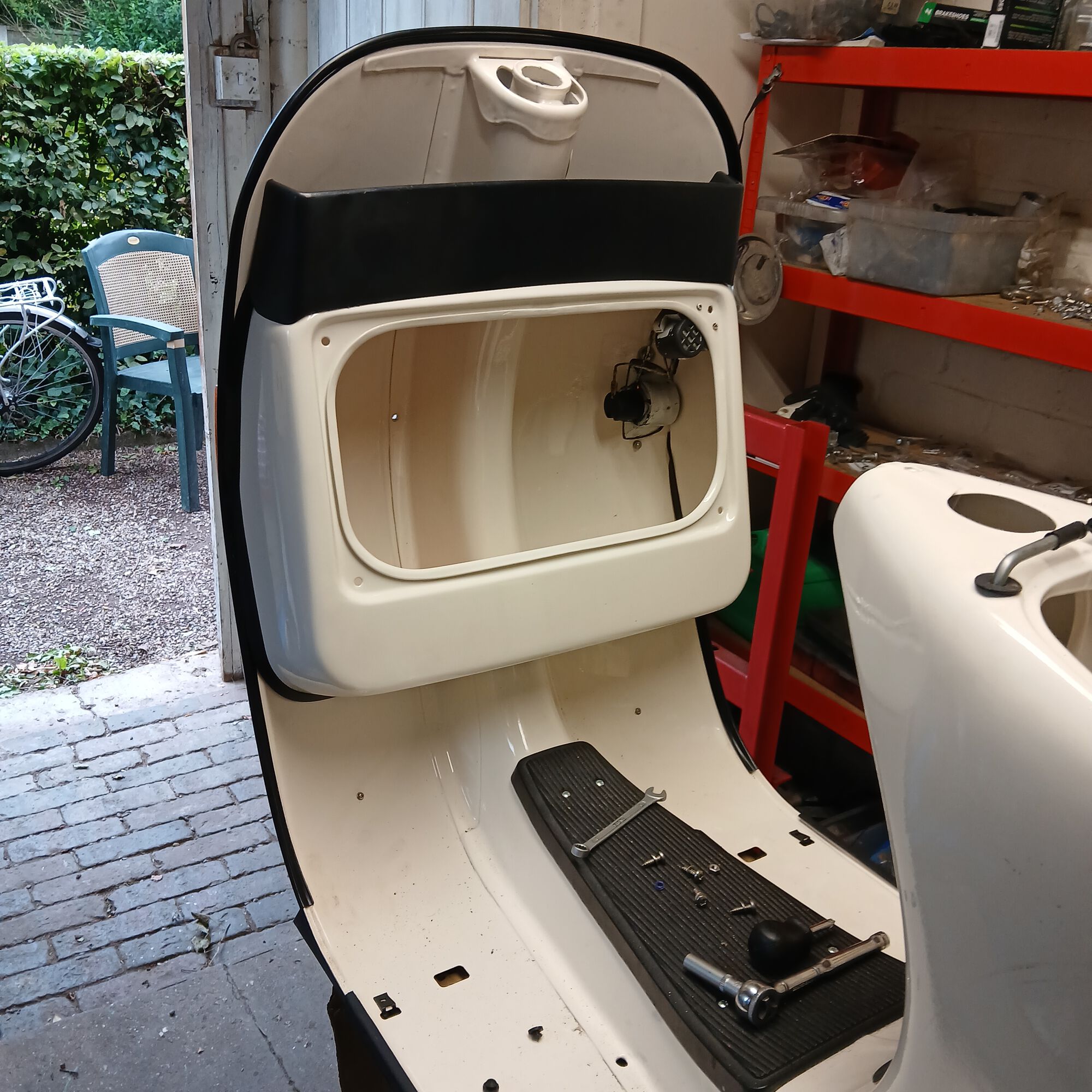

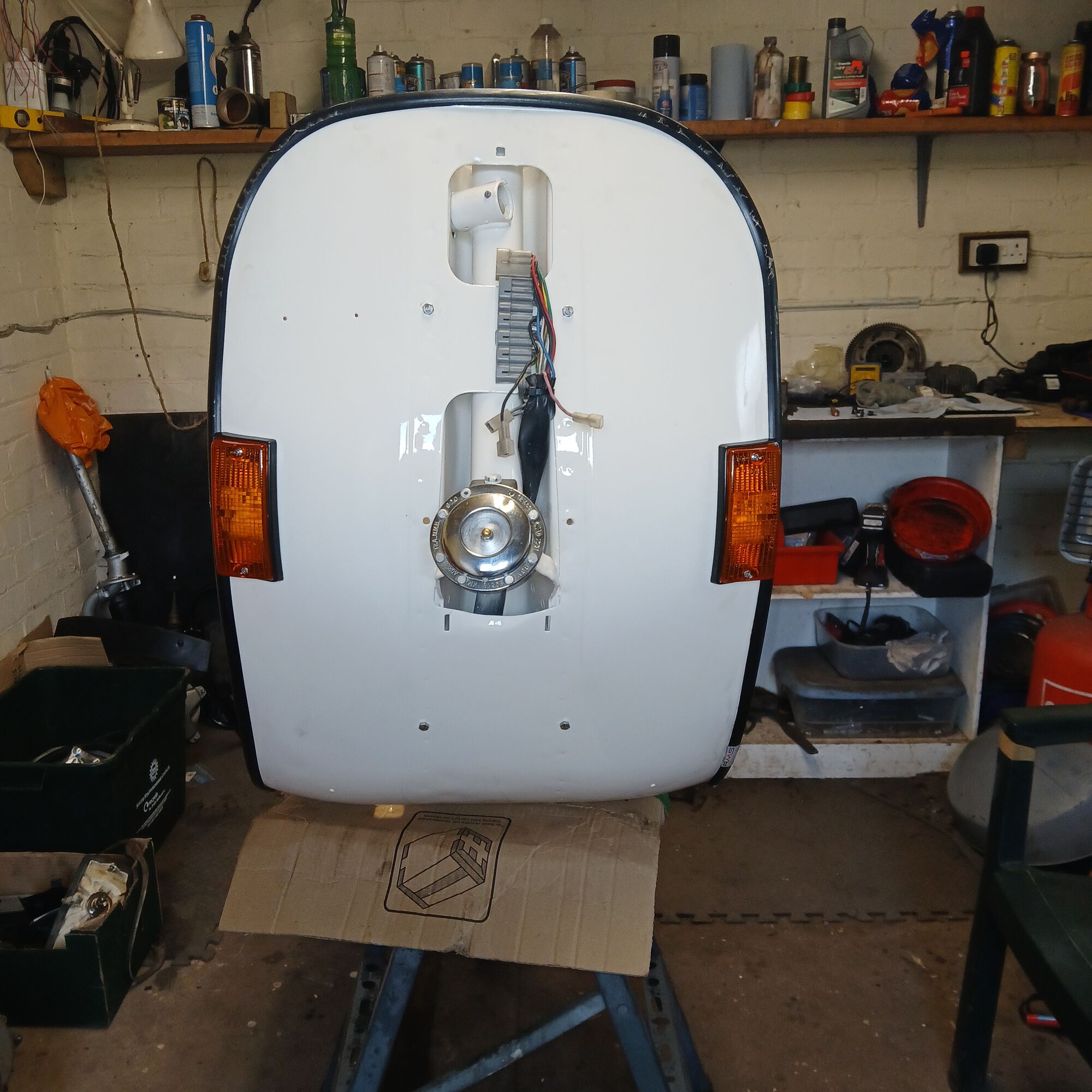

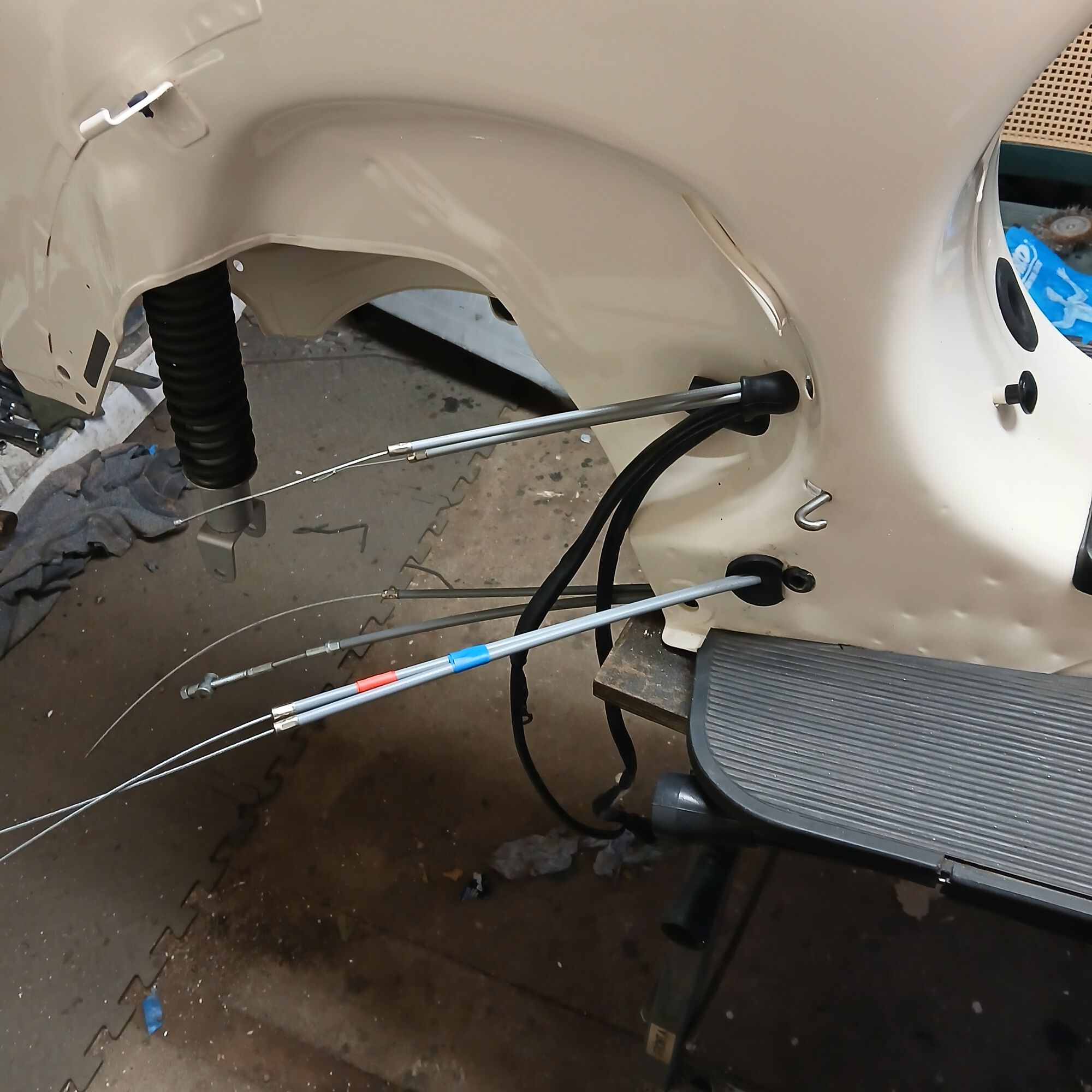

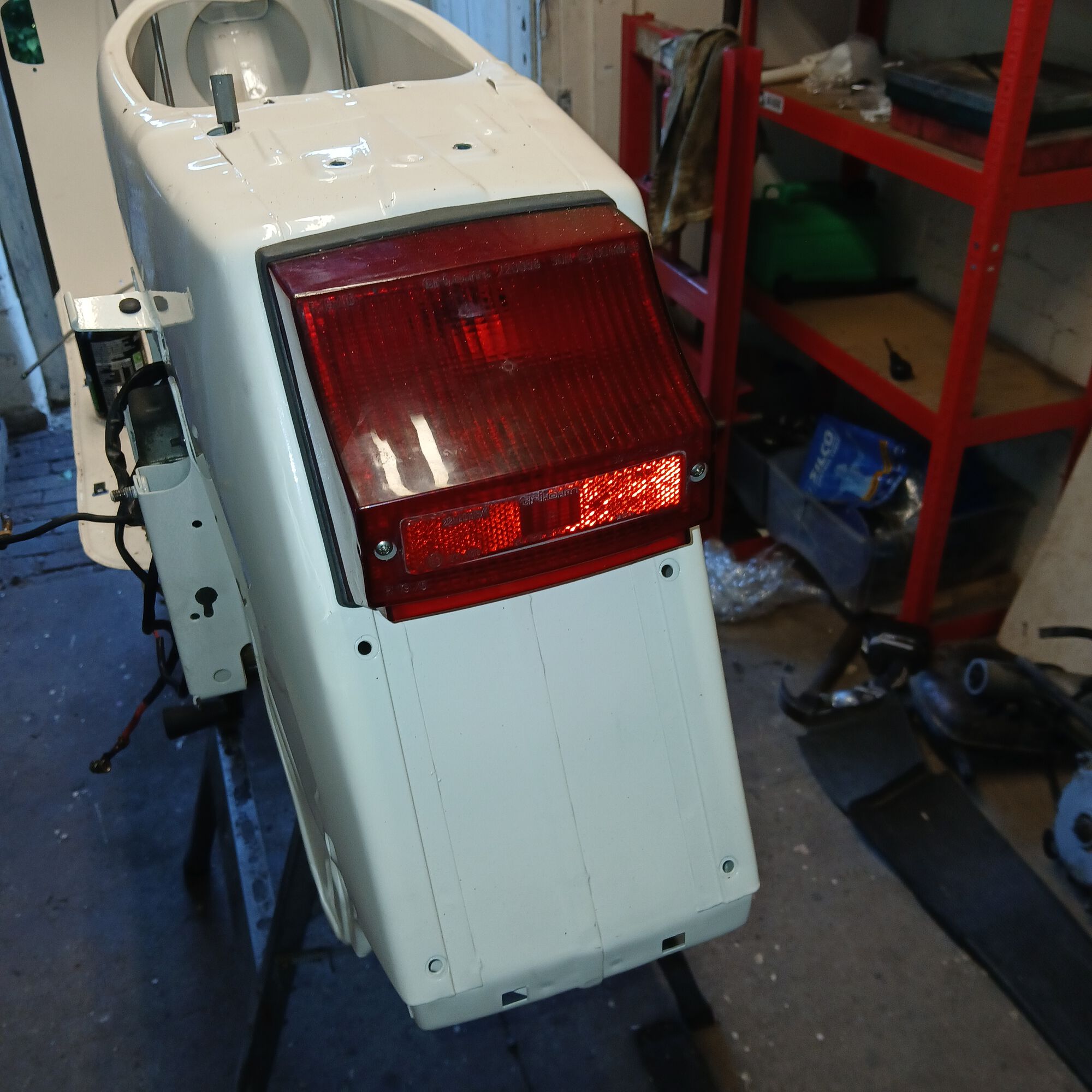

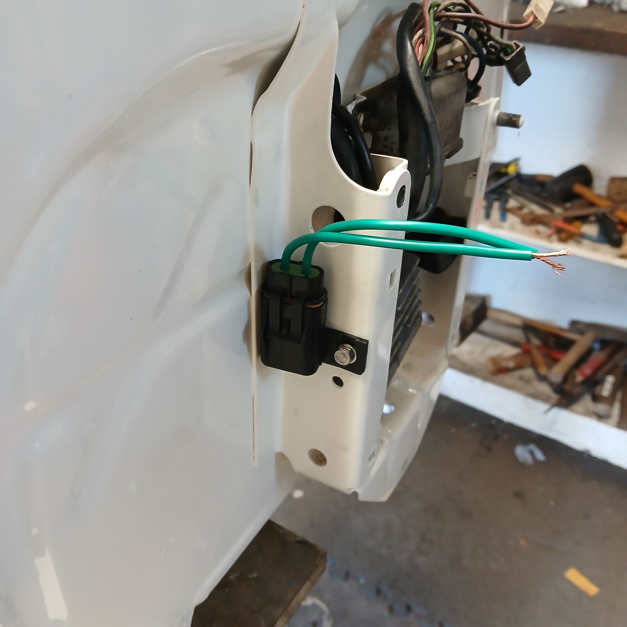

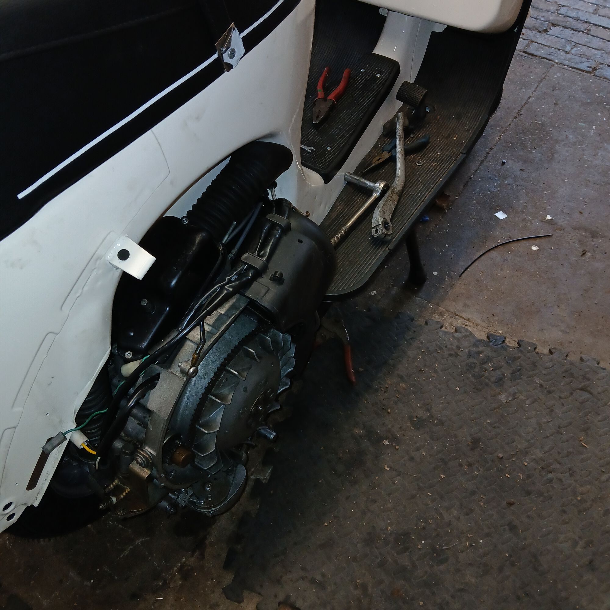

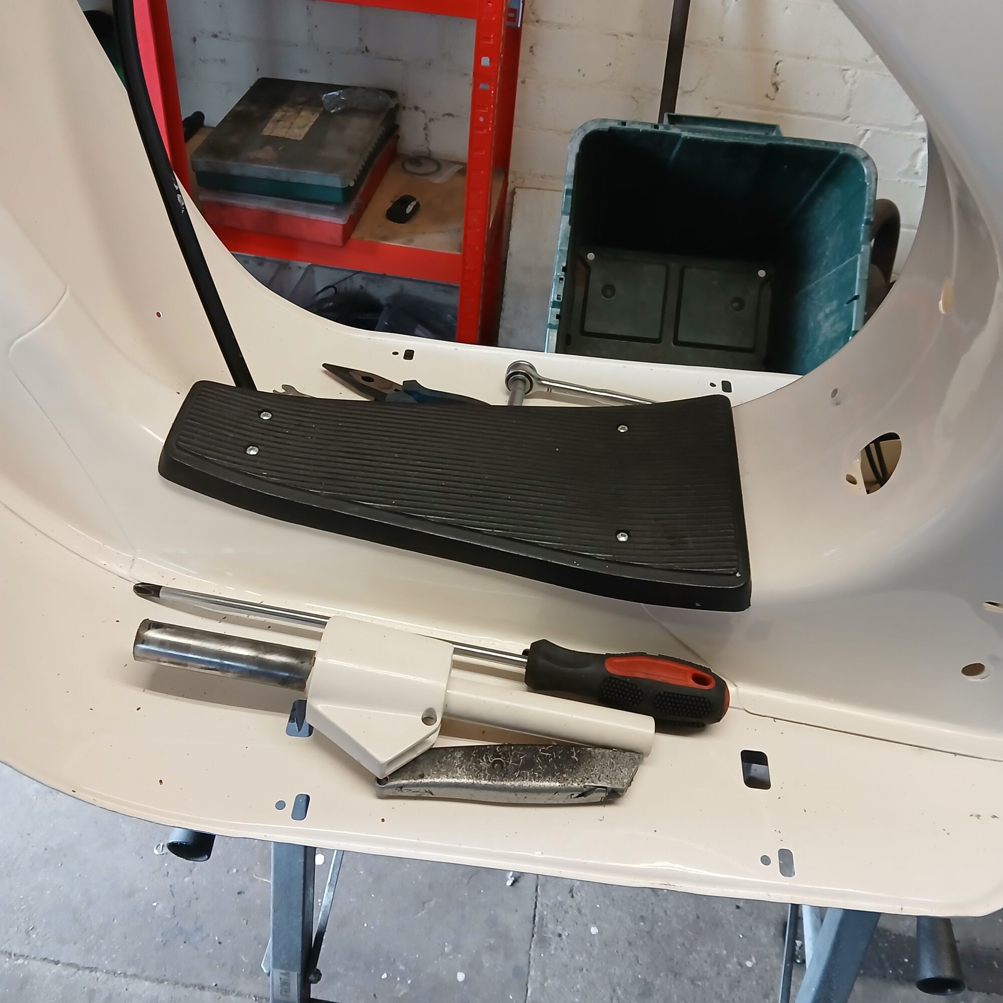

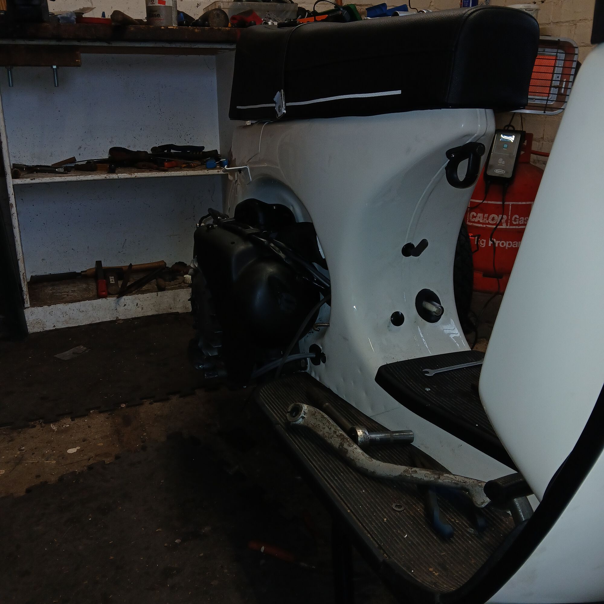

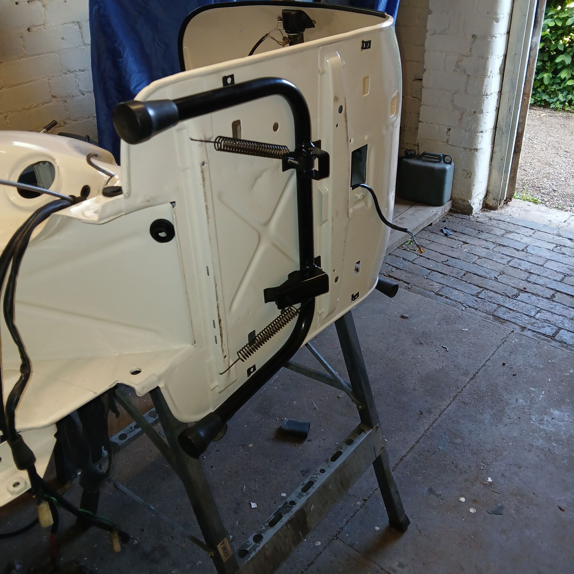

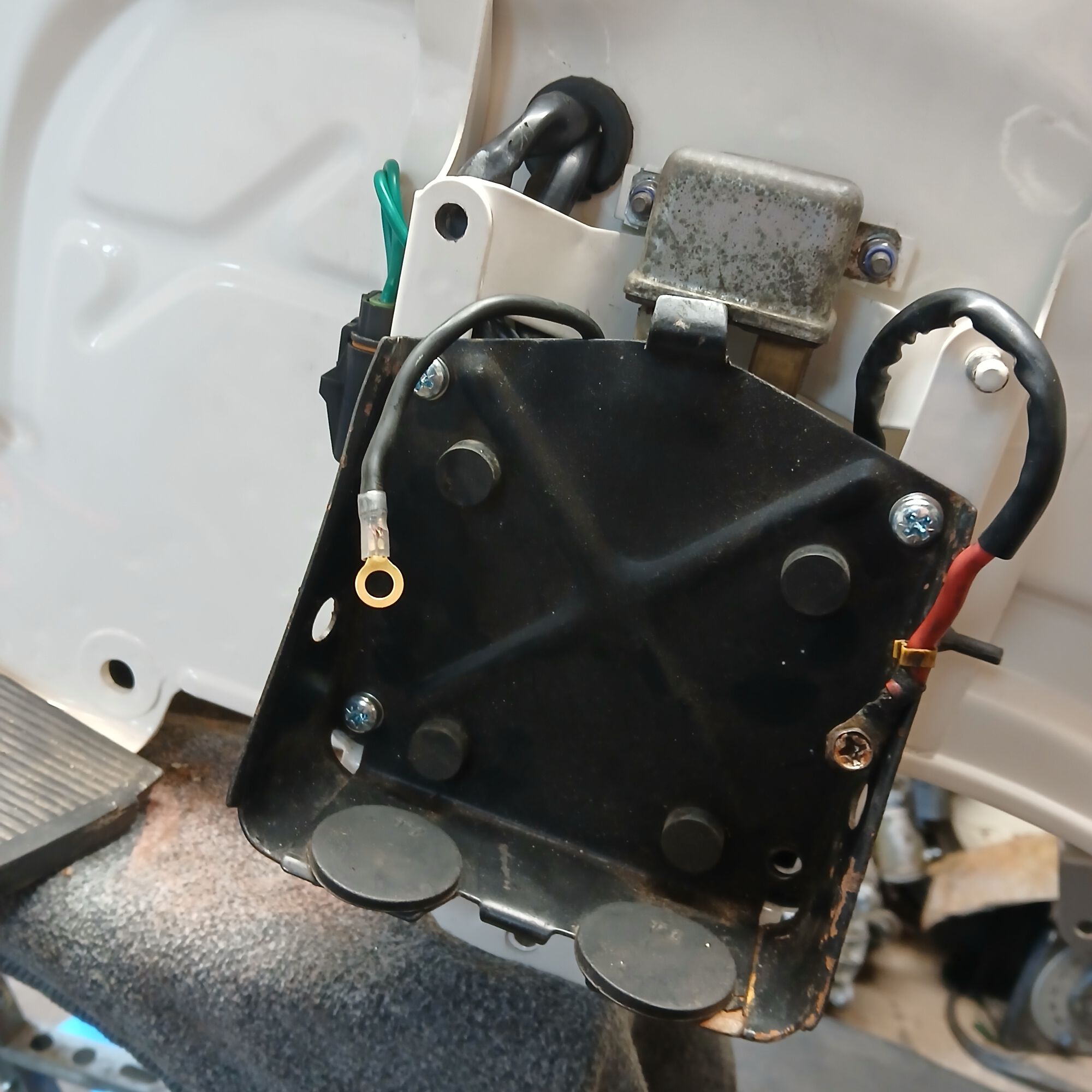

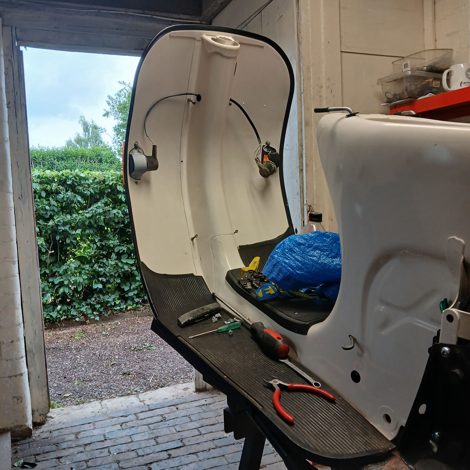

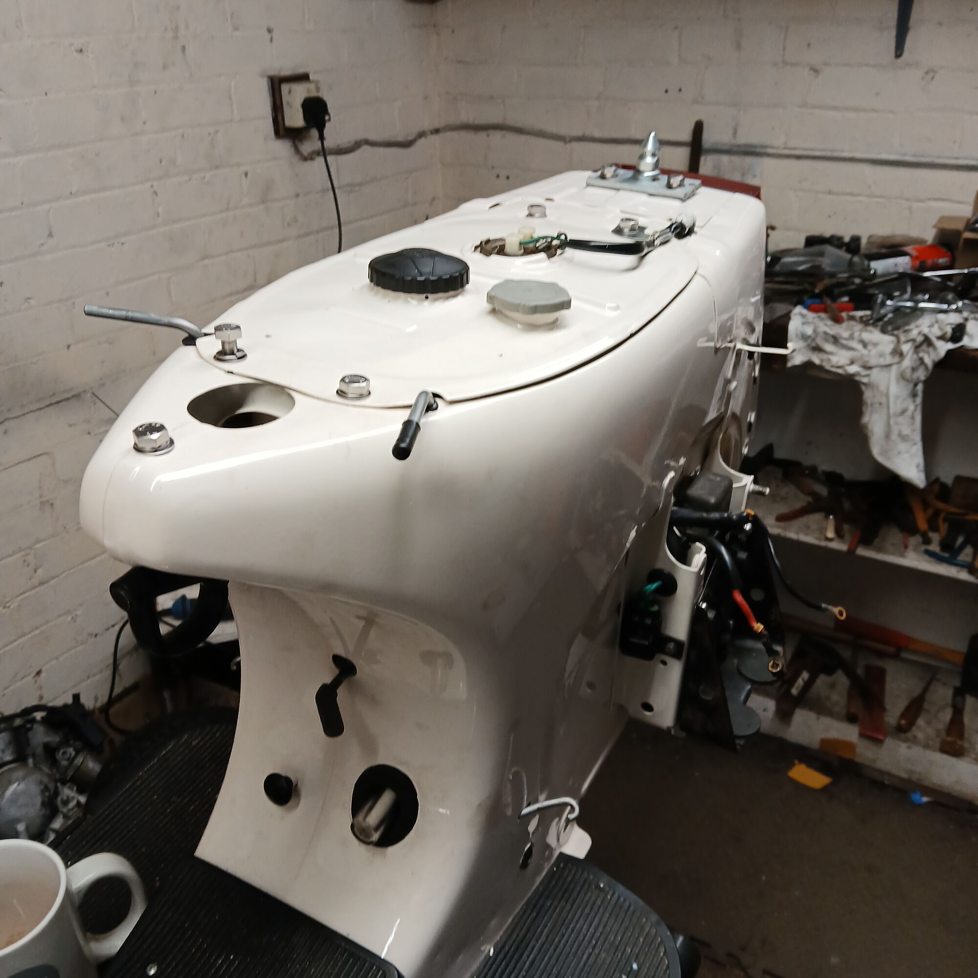

Progress update.
I rummaged around my stock if nuts and bolts and found enough stainless fasteners to ready the legshield for the toolbox, routed tne wiring loom into the frame and added some of the electrical components back in while i wait for the rubber grommets to arrive
Fitted the centre mat too.
The fasteners for the electrics will be replaced with oxide and paint free kit when it lands.
Reusing existing components as they are functional
Somewhere to lay the tools while I work

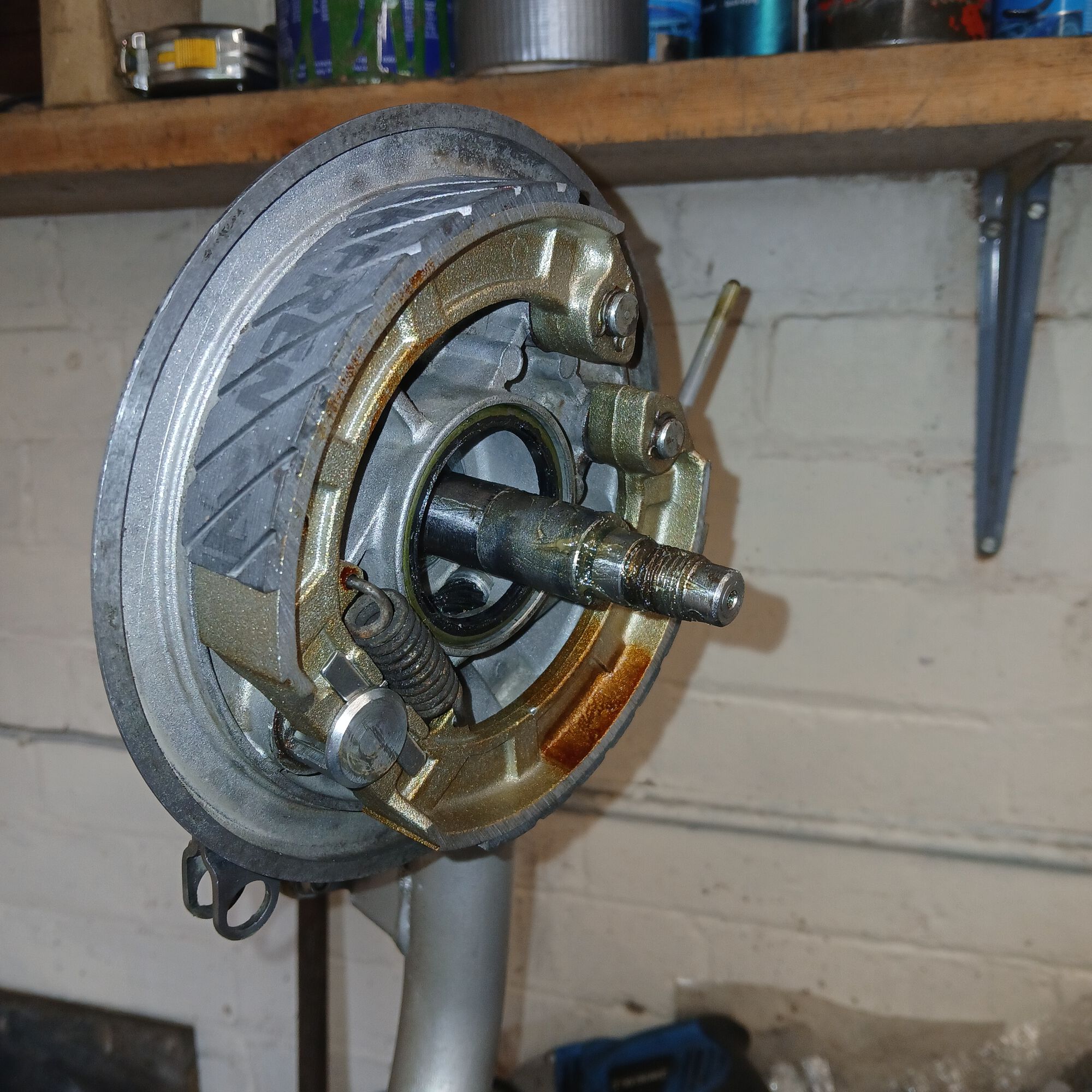

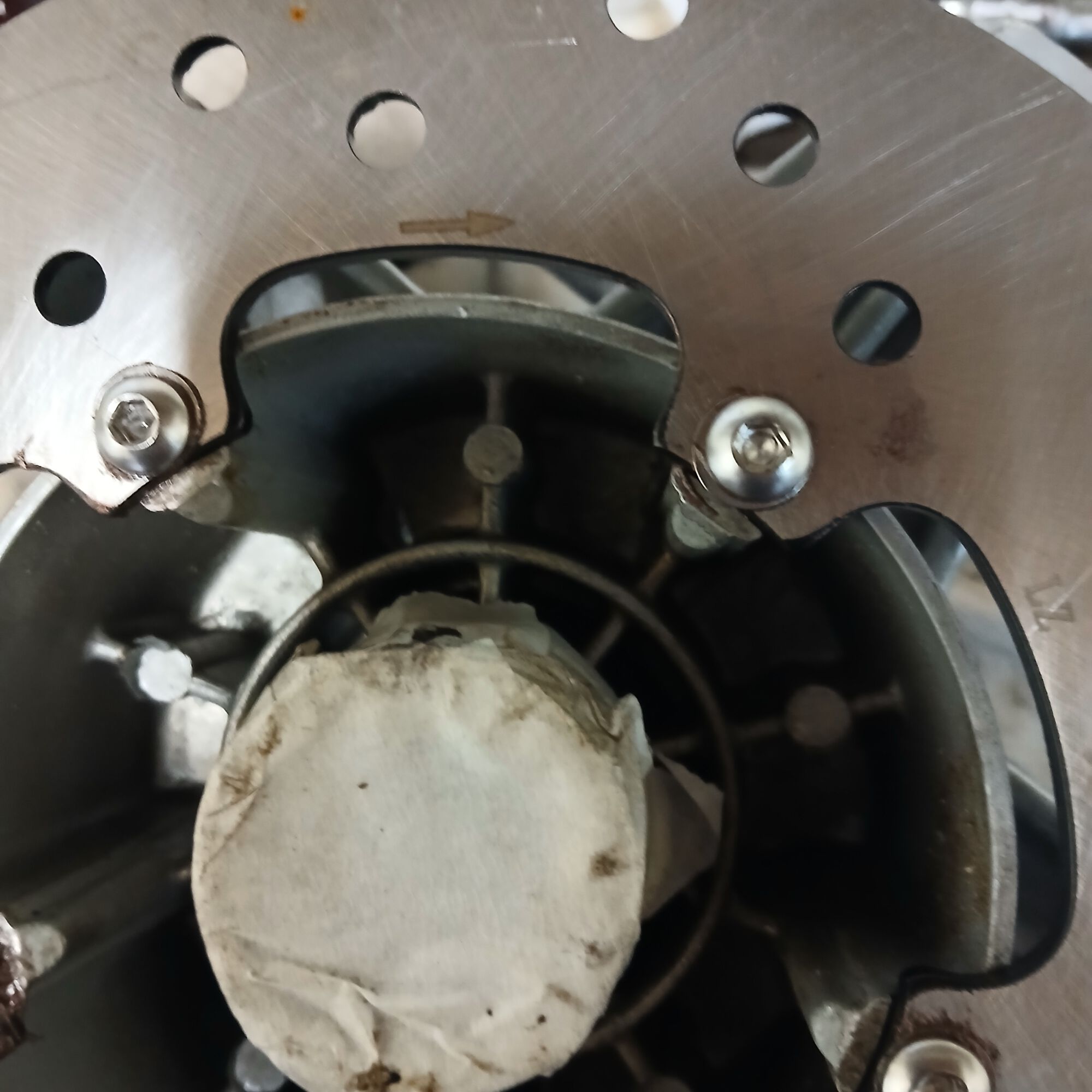

Found a new.old stock Disc for the front hub and installed that today, making sure I put the rotation arrow in the right direction
I'll probably start on the engine properly next week as I have been pondering options for it.
Lovely new old stock item I've been sat on for so long I forgot about it and almost bought another
Nearly missed the rotation arrow direction!

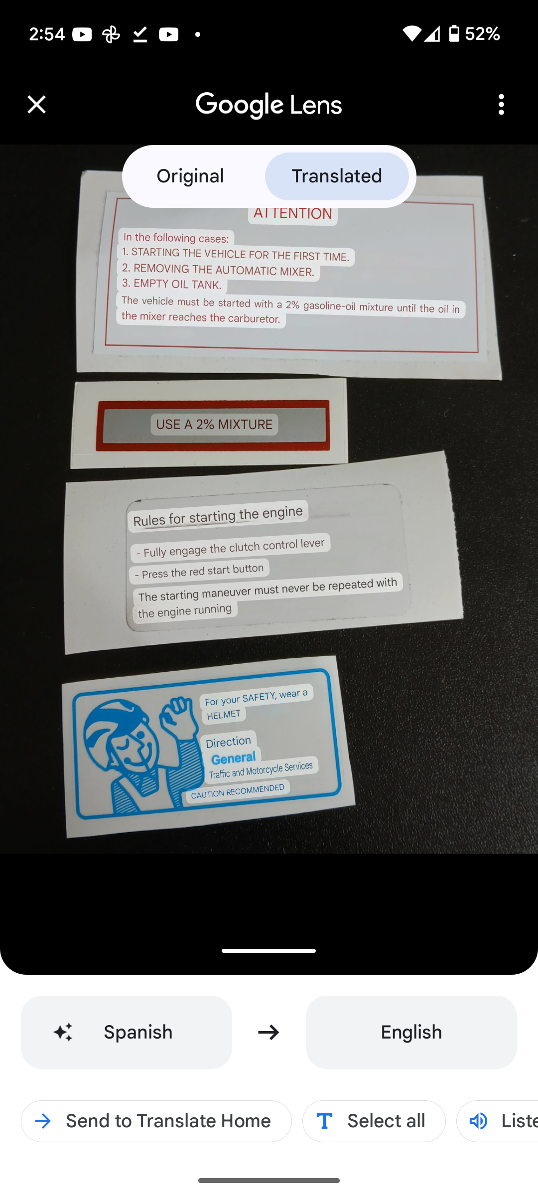

Can anyone here translate these to Englisj please?
With the translation I can work out then where they go.
Thanks in Advance
I'm lost!
I'm lost!

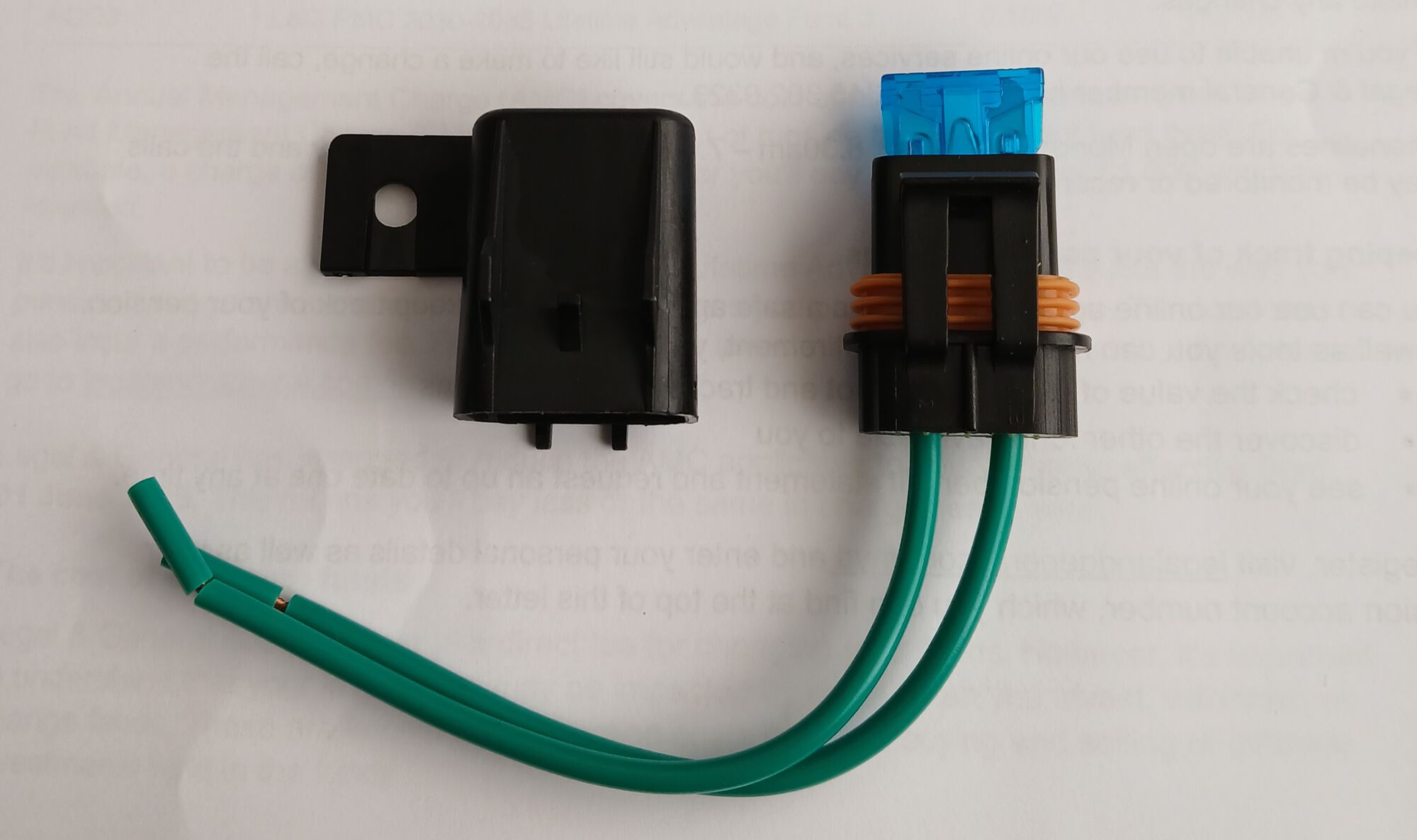

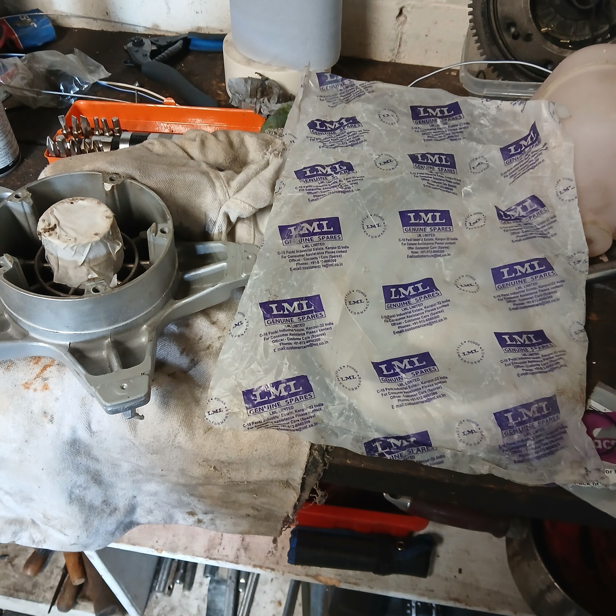

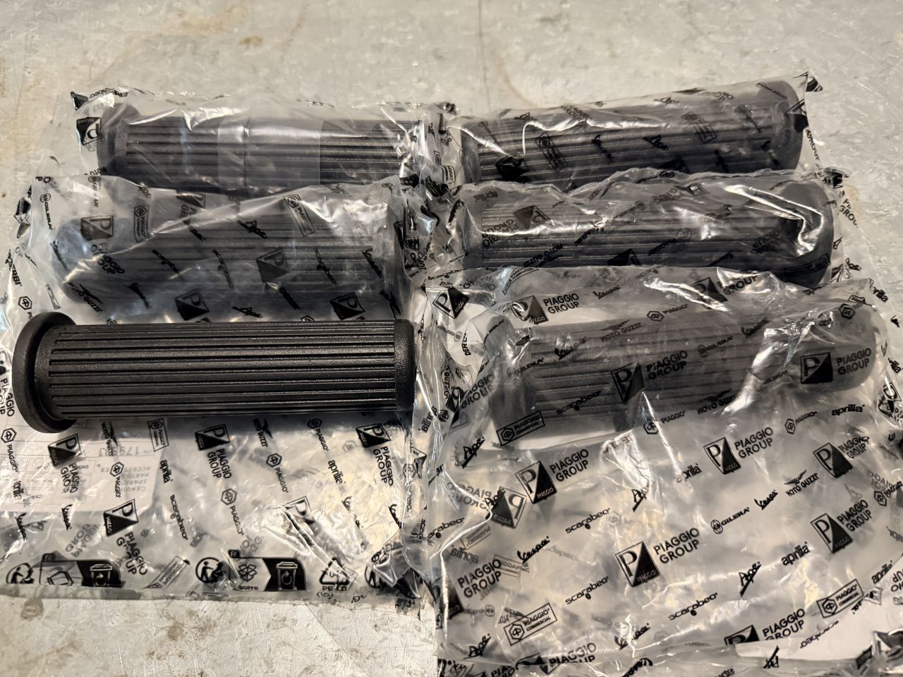

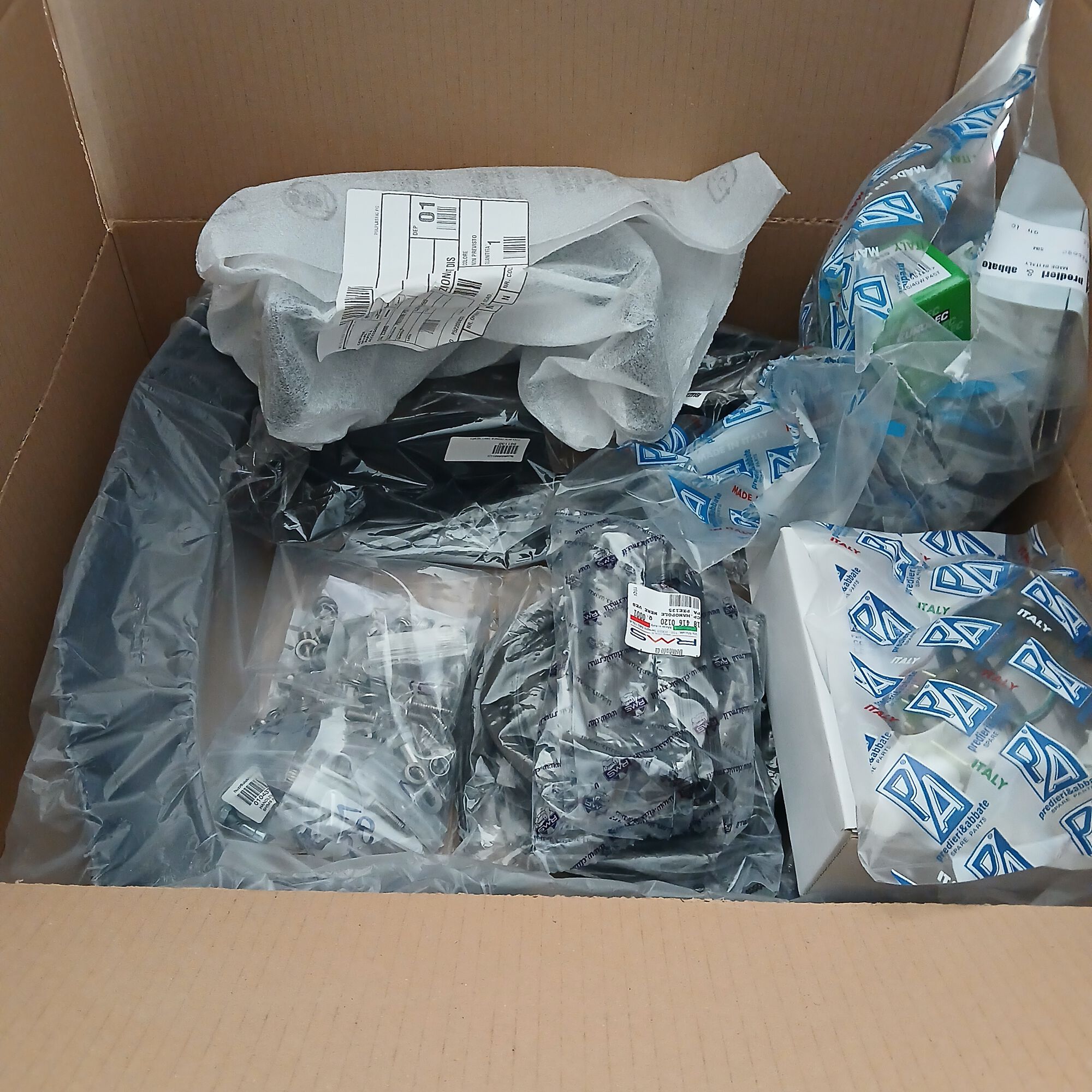

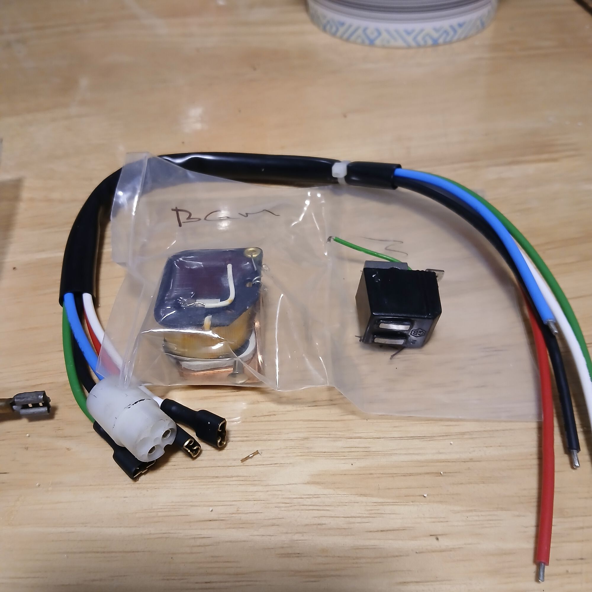

OH HAPPY DAY!
a box full of rubbers, plastics nuts and bolts and fiel sender landed....
I can start making progress again 😀
Box of Goodies
Box of Goodies
@az_slynch avatar
Posts: 2078
Location: Tucson, AZ
@az_slynch avatar
Posts: 2078
Took the pic and ran it though Google Translate:
Hope it helps.
Hope it helps.
Thankyou! Truly appreciated

Little b8t more progress today. Started putting tne forks back together.
Put the original shocks back in the frame with new rubbers - after checking they were OK.
Added a few rubbers and plastic bits - bought a load or repro rubber parts and they are way way to hard... so I went rummaging and found old ones that are "good enough"
Artistic fork photo
Artistic fork photo
Can anyone see the stainless steel fixings
Frame goodness
Frame goodness

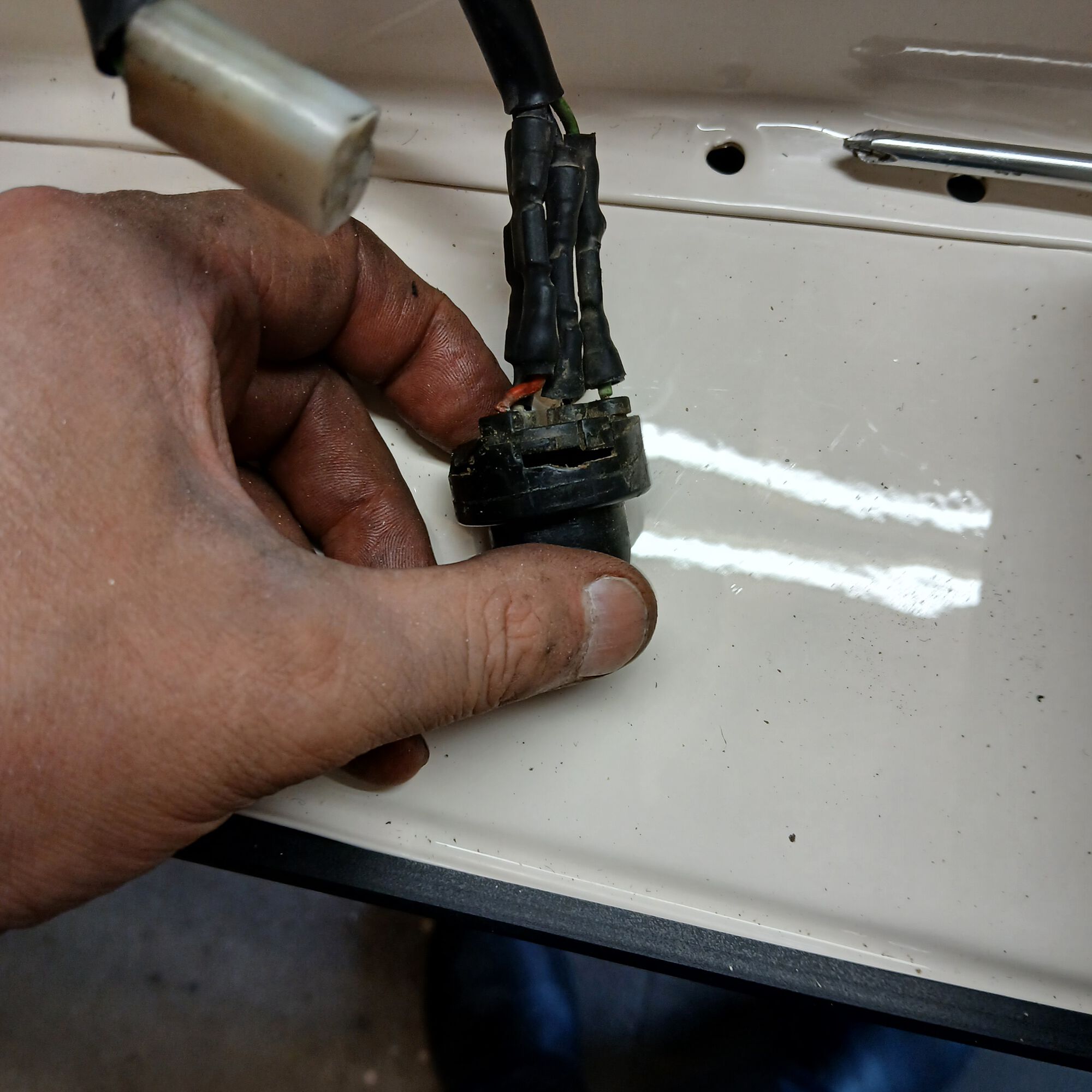

After ordering a few different types if fuse holder to replace the broken unobtanium one. I can now look to install it. I should also hopefully be able to use the existing mounting holes too. So if I can it's a double bonus
Looks to be good for.what I need.
Posts: 10121
Posts: 10121
Huh! I never realized that the square butt on a T5 was an add on to a regular P frame. Have I got that right? You're doing some nice work here. Clap emoticon
Jet Eye Master
Posts: 5381
Location: London UK
Jet Eye Master
Posts: 5381
Location: London UK
Like 1980's shoulder pads but welded on
Posts: 1629
Location: UK
Posts: 1629
Location: UK
You are entirely correct sir. The square tail is an added extra to a pretty much standard EFL frame
Your positive comment is greatly appreciated. Your own work is superb

I was tempted one time to buy a stripped and rotten T5 just to migrate the tail piece to a spare LML frame I had and build it up with the soares I have.... that would have wound the Purists up a treat over here in the UK

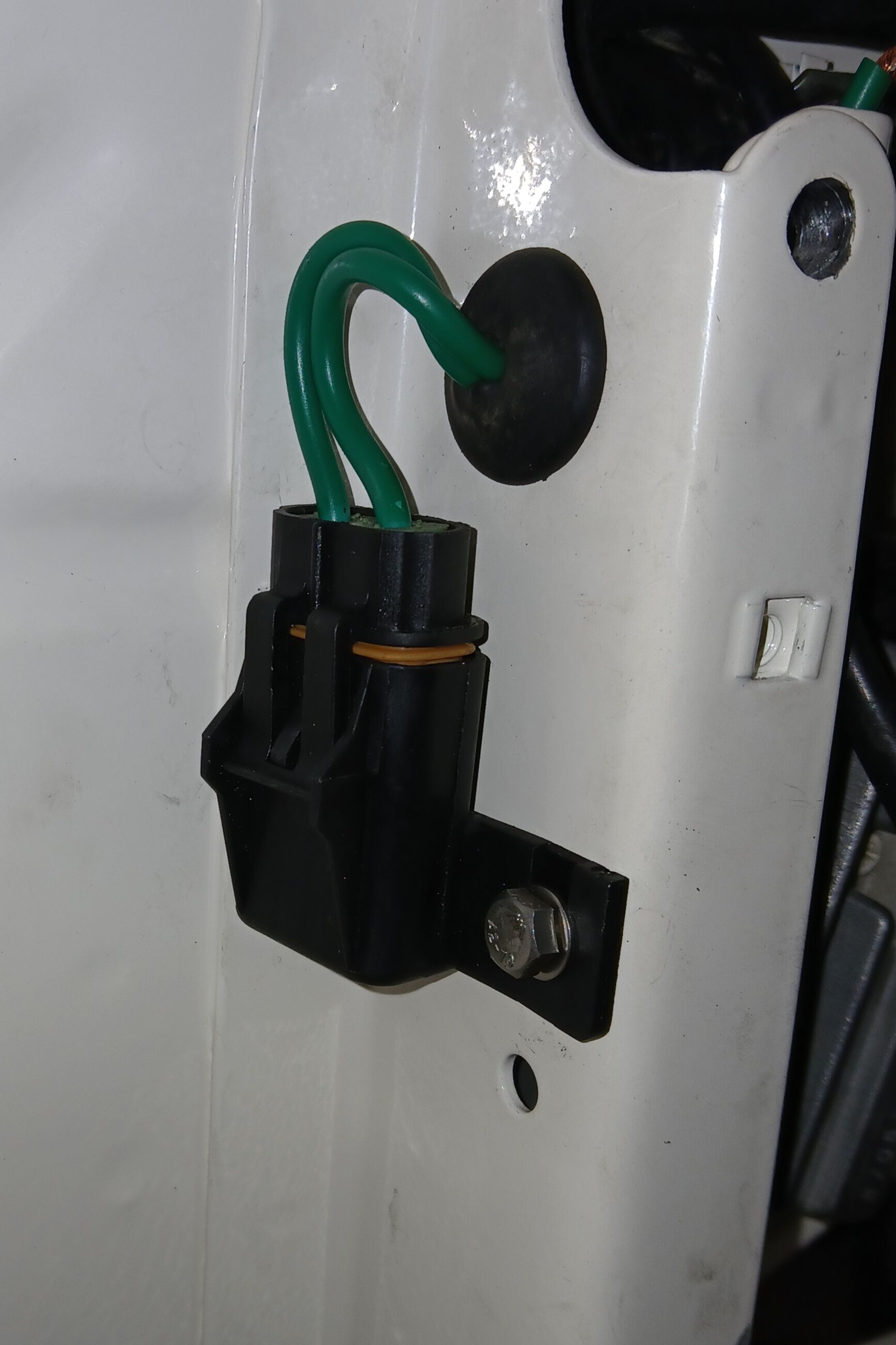

Replacement fuse holder mounted I need to find a grommet for that hole or could leave it....
Ta da
Ta da

So..... i have shot myself in the foot.
The photos and notes o took of the indicator wires corrupted and I'm stuck pondering my next move.
Indicator wires on the front are coloured
Left = blur
Right = Brown
At tne side panel end they are coloured
Purple and white with a blue stripes.
Can anyone tell me which one of the rear ondicators is for which side?? I worked out the front ones easily enough based on the little squeaker being placed on the right side..
Help!
Rear Wires
Rear Wires
Gromet o,clock
Gromet o,clock
@safis avatar
Posts: 5410
@safis avatar
Posts: 5410
Check this out. Most connections would be the same…
http://scooterhelp.com/electrics/wiring/VSX1T.6KZS.5KZG.mit.Standlicht.pdf
Posts: 1629
Location: UK
Posts: 1629
Location: UK
Thankyou Safis! You saved me a real headache.

As for the fuse holder, here's the cheapest one I found...
https://www.ebay.com/itm/355200448242
Posts: 1629
Location: UK
Posts: 1629
Location: UK
Can I PM you around this the seller won't post to UK. It's the exact one I need!+

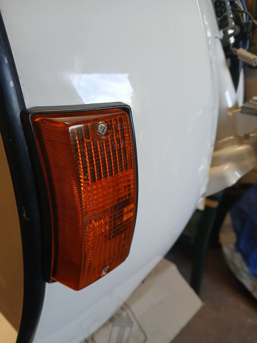

Well the last week was a busy one doing work and stuff for HrH
Spent a bit of time in the workshop and connected the indicators following the link to the diagram I was kindly provided in the thread.
Did the rear light, horn and started to clean up the indicator housing
Will be in the shop tomorrow for a sorting the brake light switches for a mate and then get on with some more fun stuff
Tail light fitted
Tail light fitted
Indicators connected and shrouds added

A few small jobs done today
Fitted relevant terminal connectors to the replacement fuse holder
New copper terminal on the battery connector and some indicator fixing
Terminal fixed and electrickery hidden awag
Front mudguard and thread the speedo cable through
New lenses on the Blinking lights and some odds
