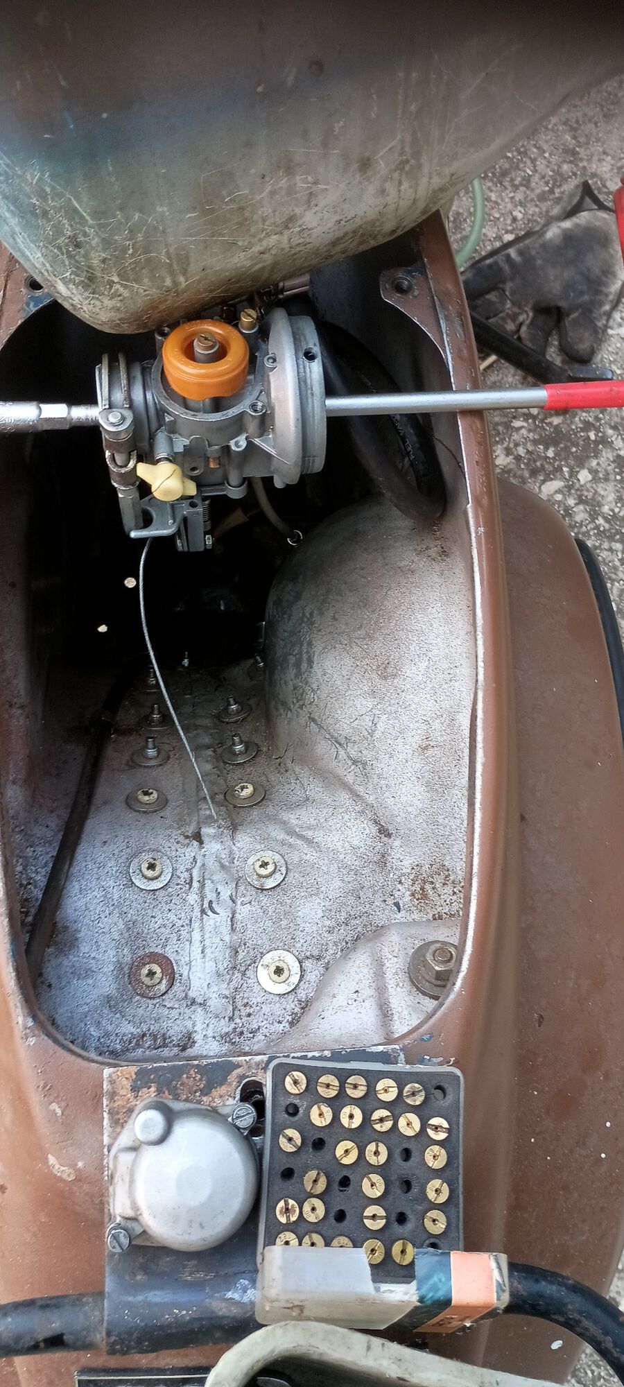

The motor build, pretty tame & mostly stock parts.

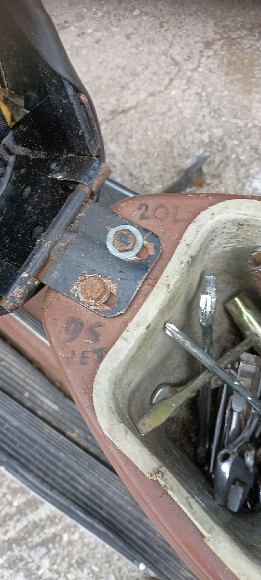

Looks like I thought the jetting would seem so whacky that I wrote it down to show it was intentional

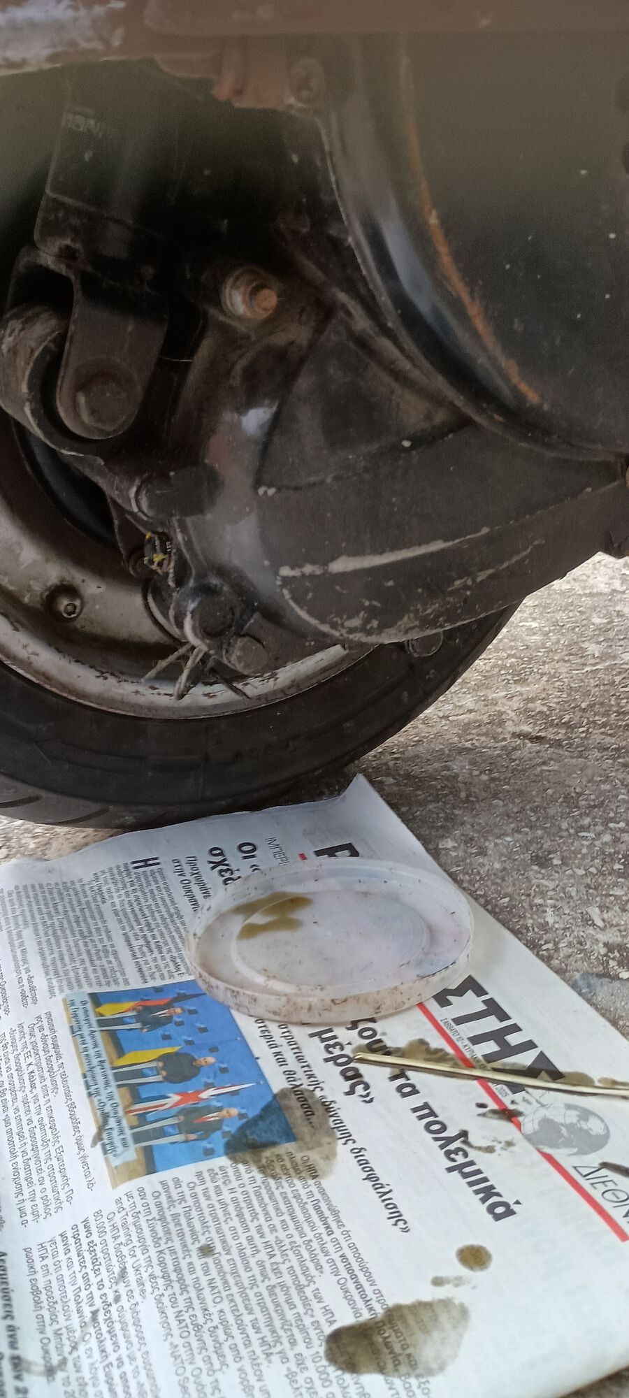

Cracked the drain plug and oil came out(phew!) and stuck a piece of straw in the fill hole which showed plenty of oil.
