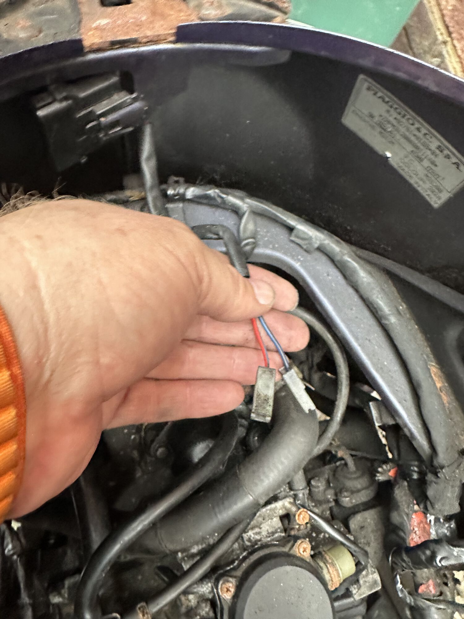

is this an earth ground

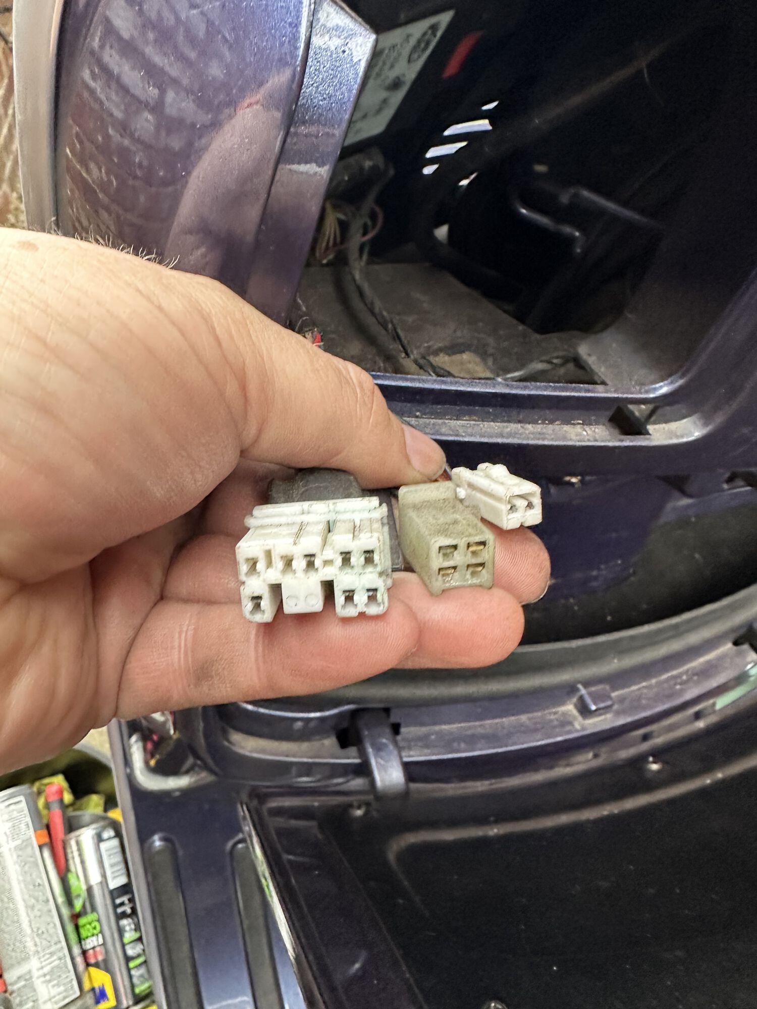

found these under the seat any idea what they are for

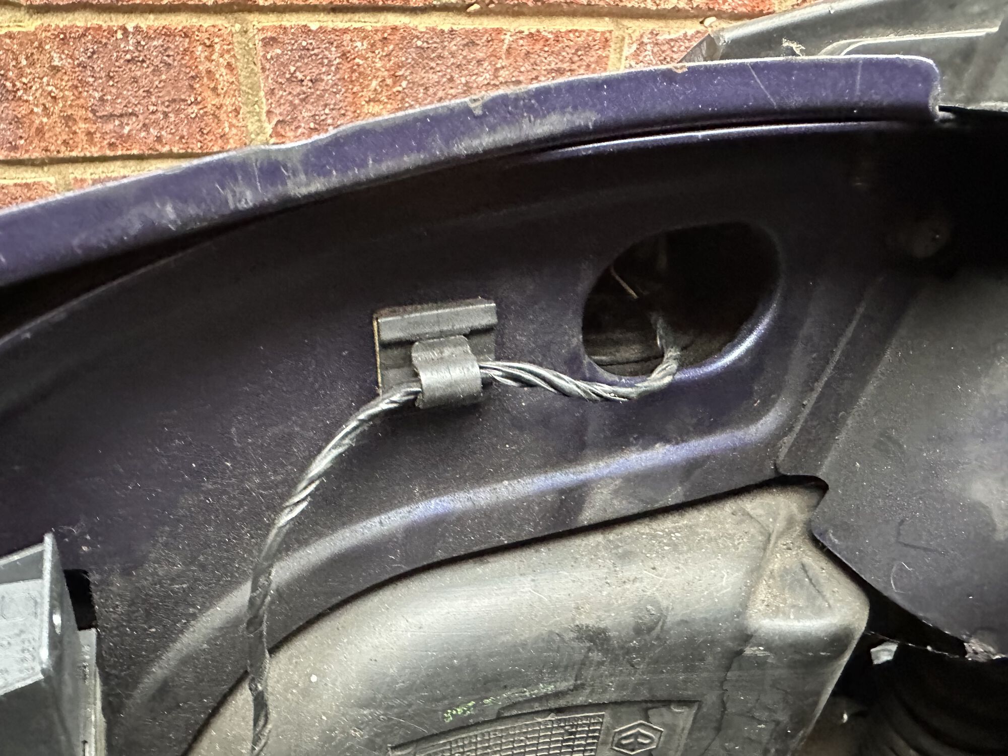

and i found these behind the panel
think ive been sold a donkey to be honest the splash guard that goes over the rear wheel is not fitted so water has been spraying up in to the engine bay so god knows what issues its caused
any idea what they connect to ??

I have such connectors in the closet as well, they are related to the expansion of the electric accessories (alarm). Also, I don't have them involved. Do you miss the fuse cabinet? It should be on the displayed side of the cabinet .

Just take off, clean and replace all the wires related to the starter motor. Battery to relay, relay to starter motor, battery to frame. That's six connections to be cleaned and tightened with a smear of some dielectric grease.
Still lazy? Do a voltage drop test across each of those three segments in turn while trying to start.
