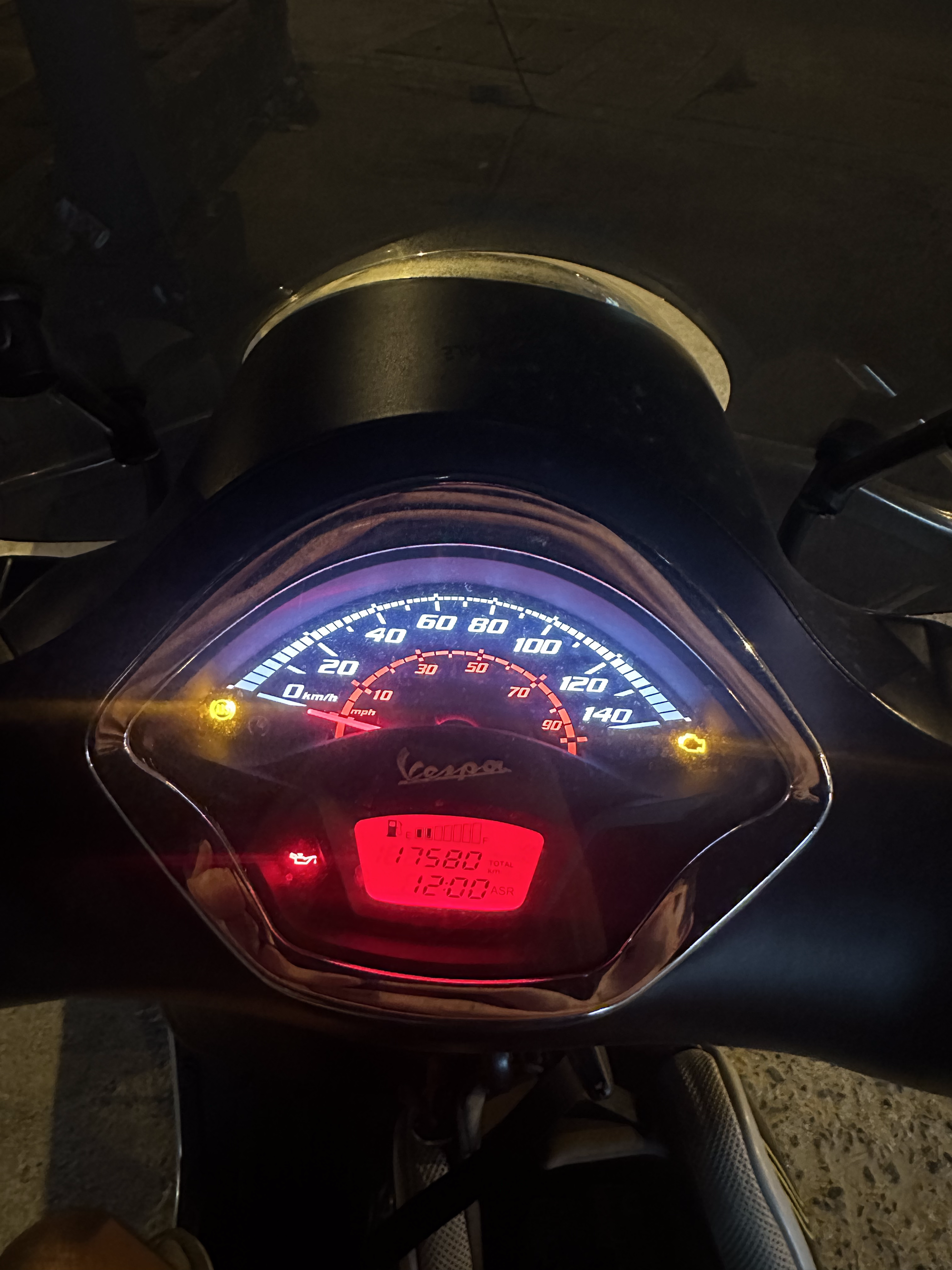

Here's what happens when the problem occurs:
The ABS light turns on.
The speedometer goes crazy (drops to 0, then back to the correct speed).
Sometimes the engine warning light appears.
Then the engine stalls — sometimes I can restart it while still rolling, but often I have to stop completely and it takes many tries to restart.

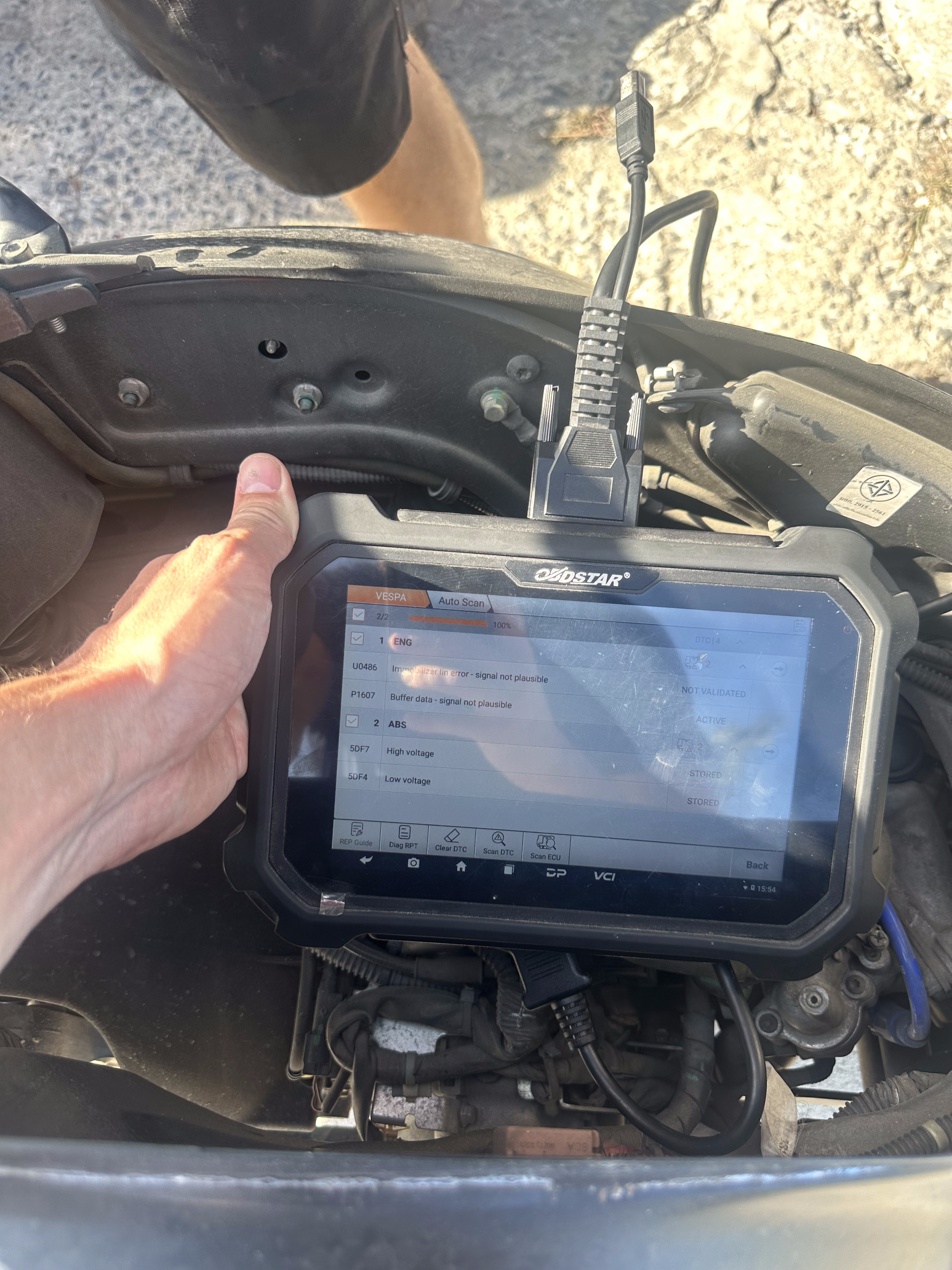

I went to my mechanic, and we connected a diagnostic tool to check the fault codes. The codes showed:
Buffer data full
ABS high voltage / low voltage
We cleared the faults, but the issue immediately came back.

Warning lights
Warning lights
Faults code
Faults code

Drazen says the ABS light which is separate from the ASR indicator and the ABS light is only connected to the ABS controller whereas the ASR is code inside the ECU. So definitely a problem with the abs sensors at the wheels or the wiring from them to the abs controller.
The one of the most common causes of this problem is an incorrect gap between the sensor and the slotted tone ring on the wheel. This gap should be approx 0.5-1.5mm. Another common cause is a bent tone wheel causing the gap to not be within tolerance all the way around.
A bad battery could also cause it. Although Im assuming since the sensor was replaced that the battery might also have been checked by the mechanic at the same time.
So step one is to check that gap on BOTH front and rear. Use washers to adjust the gap. While checking the gap spin the wheel checking this gap all the way around.
Also using a diag tool to check the individual speed values when spinning the front wheel (lift the front of the bike) and separately the rear wheel.
