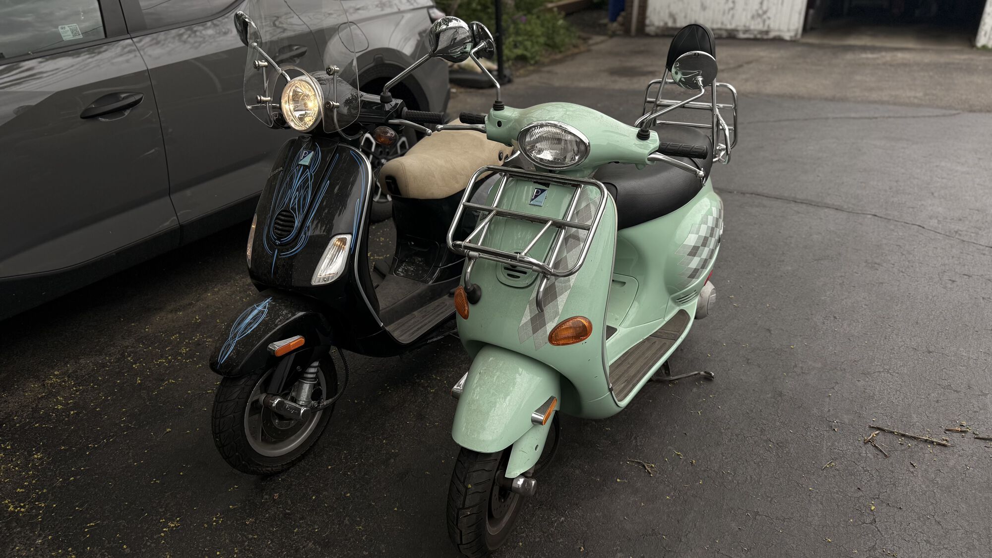

OK guys, bought these two darlings, a '01 ET4 and '07 LX 150, about 9 months ago and they're riding well but every single start requires a jump. They were sluggish when I made the purchases... who would replace a dyng battery before selling, right?
These Yuasa YB9-B Batteries are, I assume, old and now toast.
The MB9U is raved about here so probably just going to have two shipped.
Any suggestions for battery tender? Probably just gonna cycle them through every month whether riding regularly or not.
Is it worthwhile (or possible or advisable) to get away from sealed lead-acid? Like Lithium or otherwise? I'm assuming on an old scoot that shipped with a lead battery, it's gonna use lead batteries all the way to the grave.
Thanks!
Photo of the darling couple
