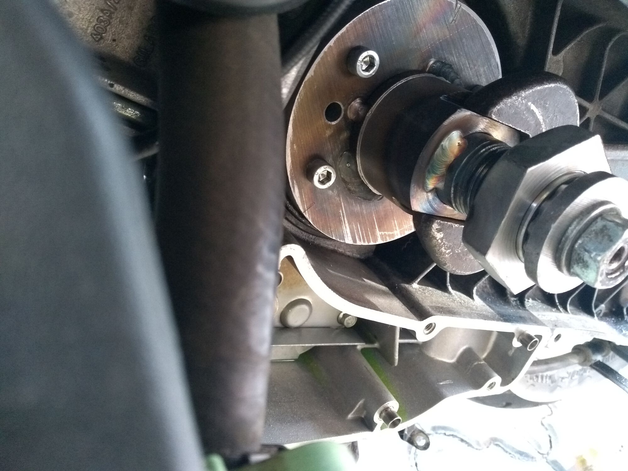

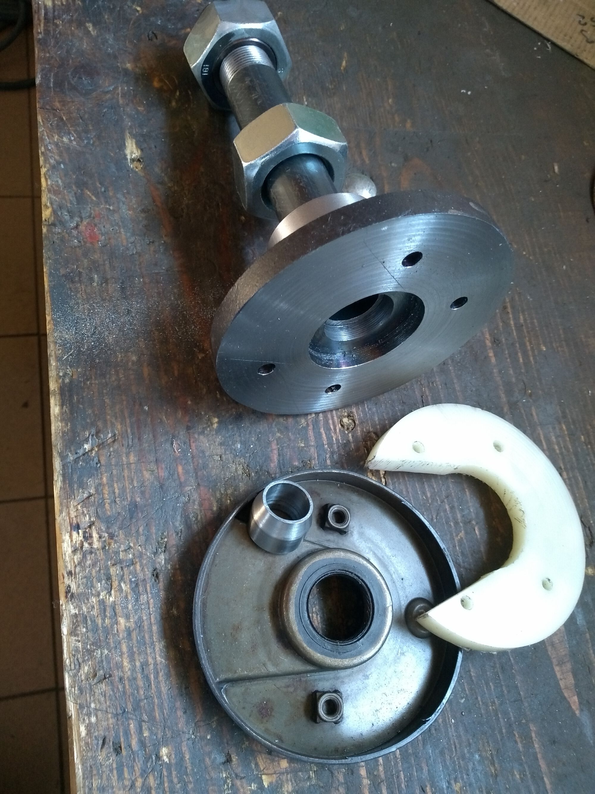

I'm preparing to install the timing cover. I damaged it while removing the old cover. That's why I'm making a tool that will help me take it off and put it back in place. Not finished yet, I'll report back when the mission is complete.

In action.

Looks pretty robust! Nice work solutioning that seal installation; the factory tool is pricey unless one can put it to regular use!
