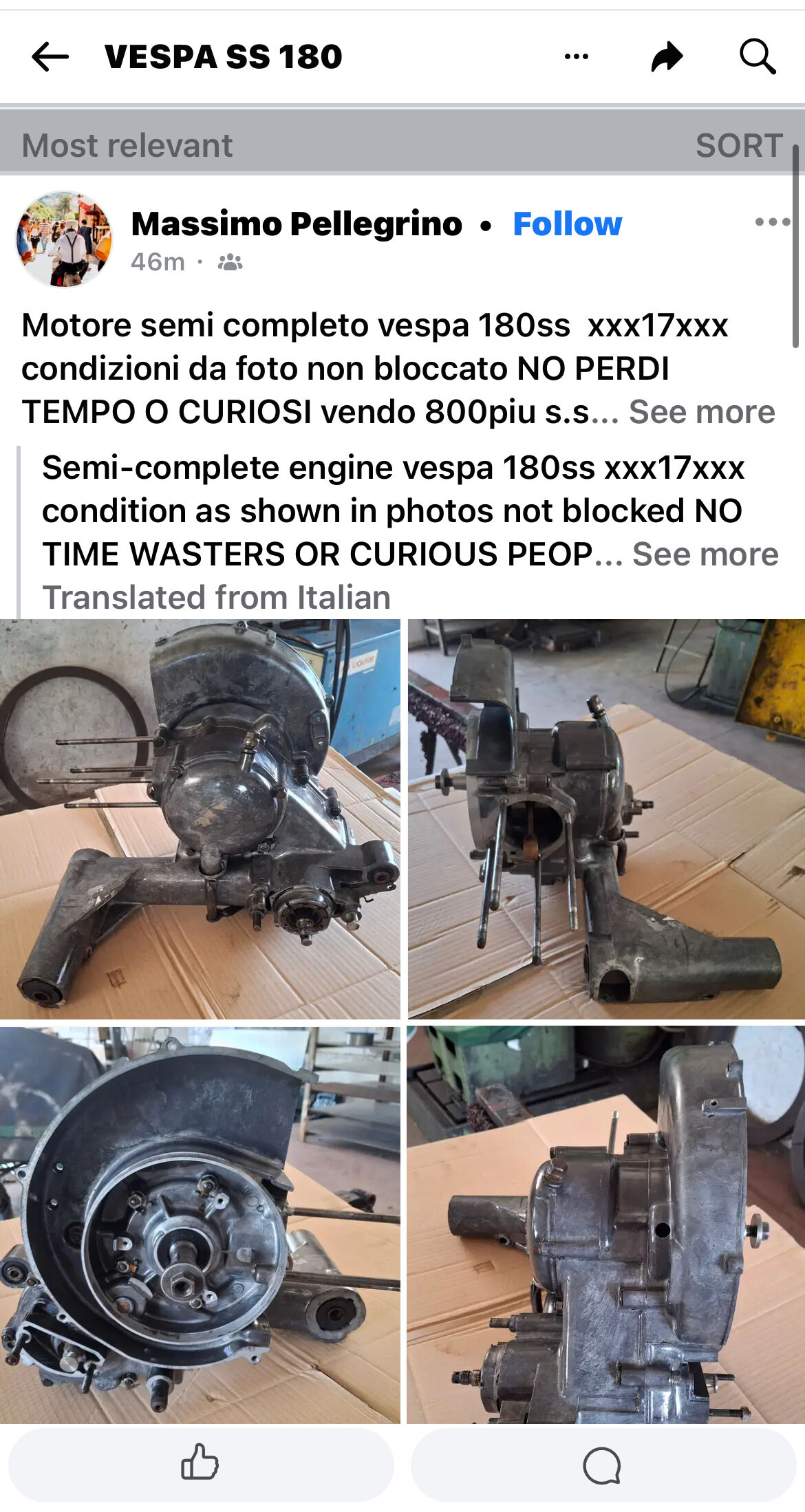

As SS180's are more common in Europe I think you could find a reliable shop in the UK (Swiss Tony's, Disco Dez, etc), or one in Italy, and have them be on the hunt for you?
You could also post in the FB SS180 group but be wary of scammers and dubious replies.
https://www.facebook.com/groups/356147511111516

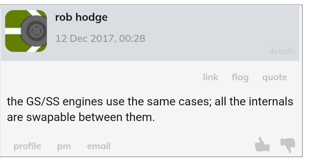

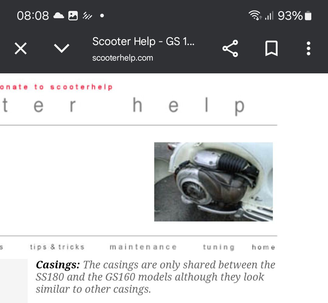

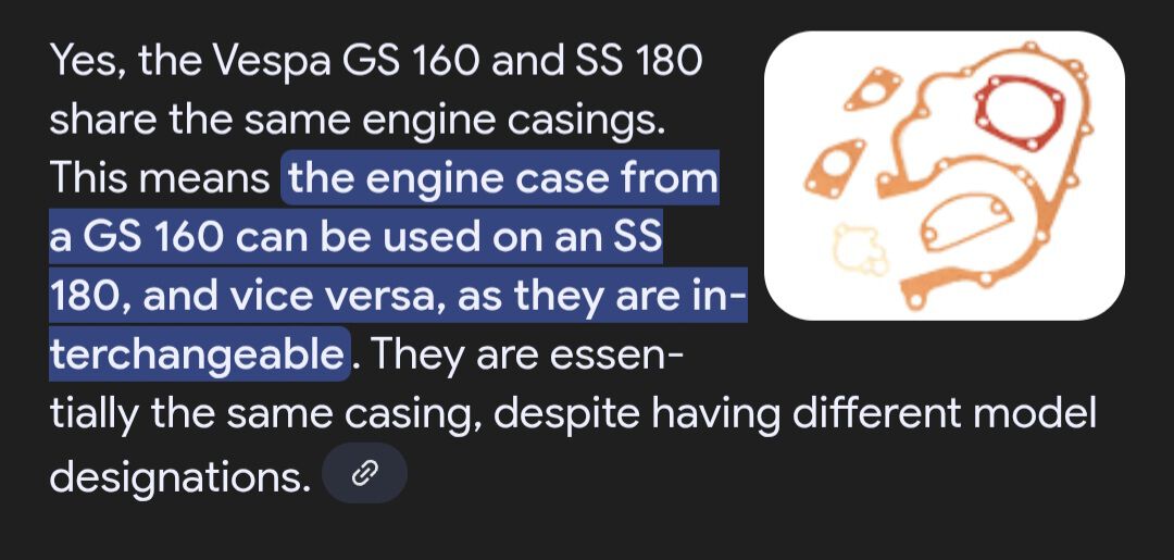

So even though some people say the SS180 and GS160 engine cases are the same, they are actually not? Or they are?
Does anybody know? I expect bearings and anciliaires to be different but the cases look the same.
I am trying to find Vespa part numbers to confirm.

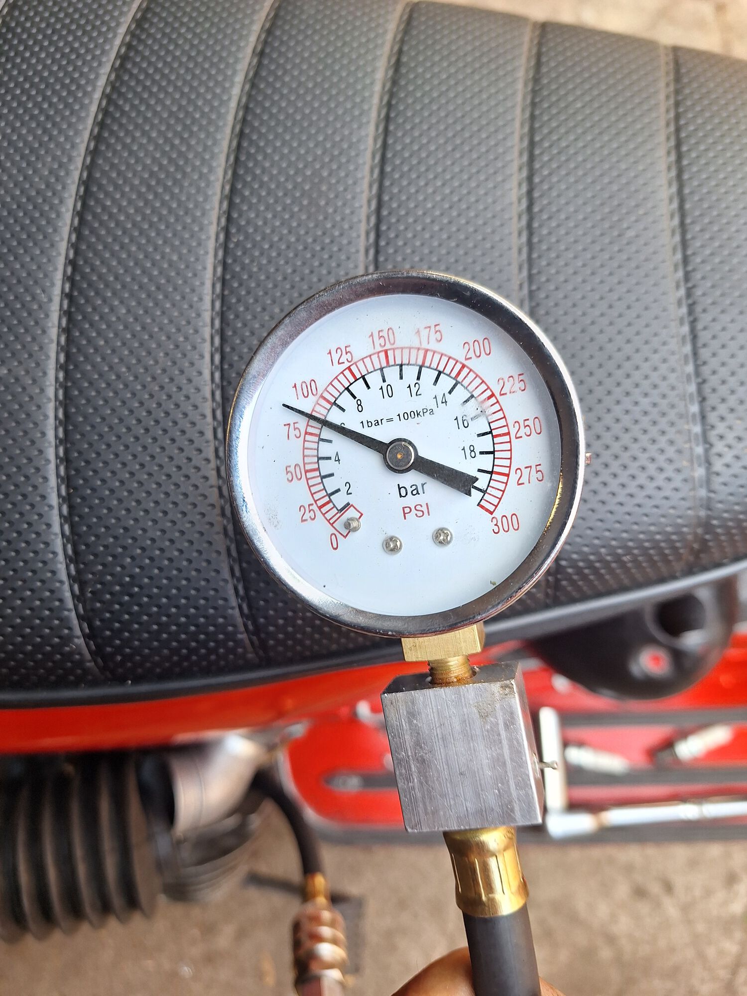

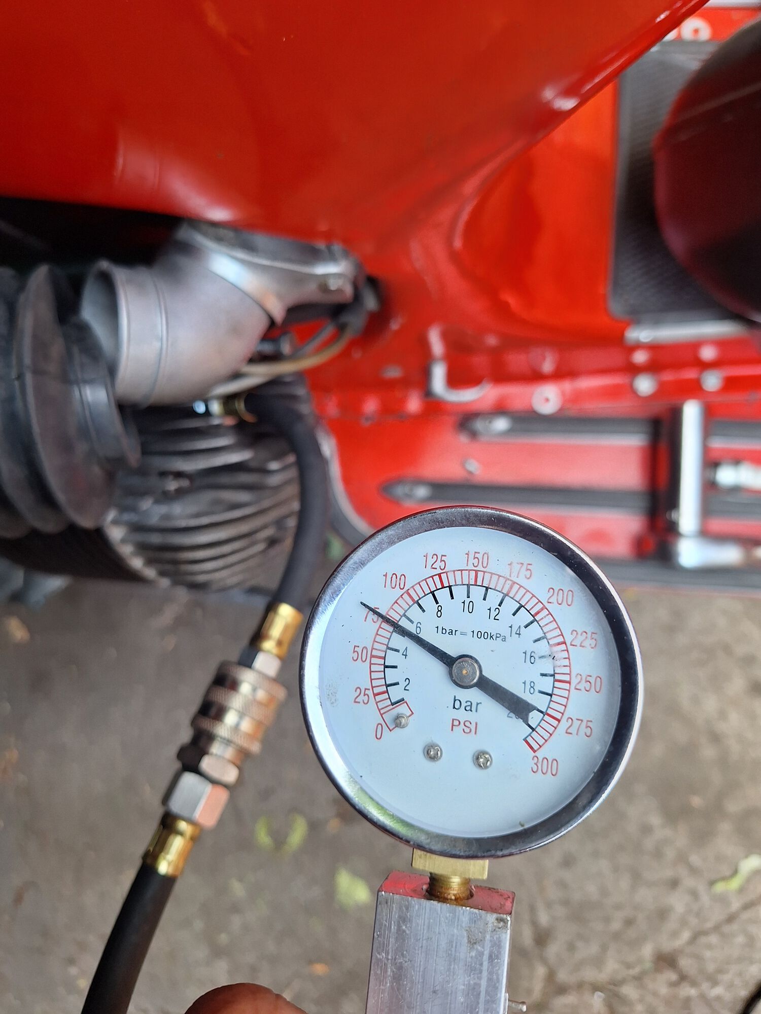

Compression test with no oil 75. With oil about 85 - using thin multi purpose oil.
About five kicks gets it to its max.
Working on the air leak testing kit and will do that next.

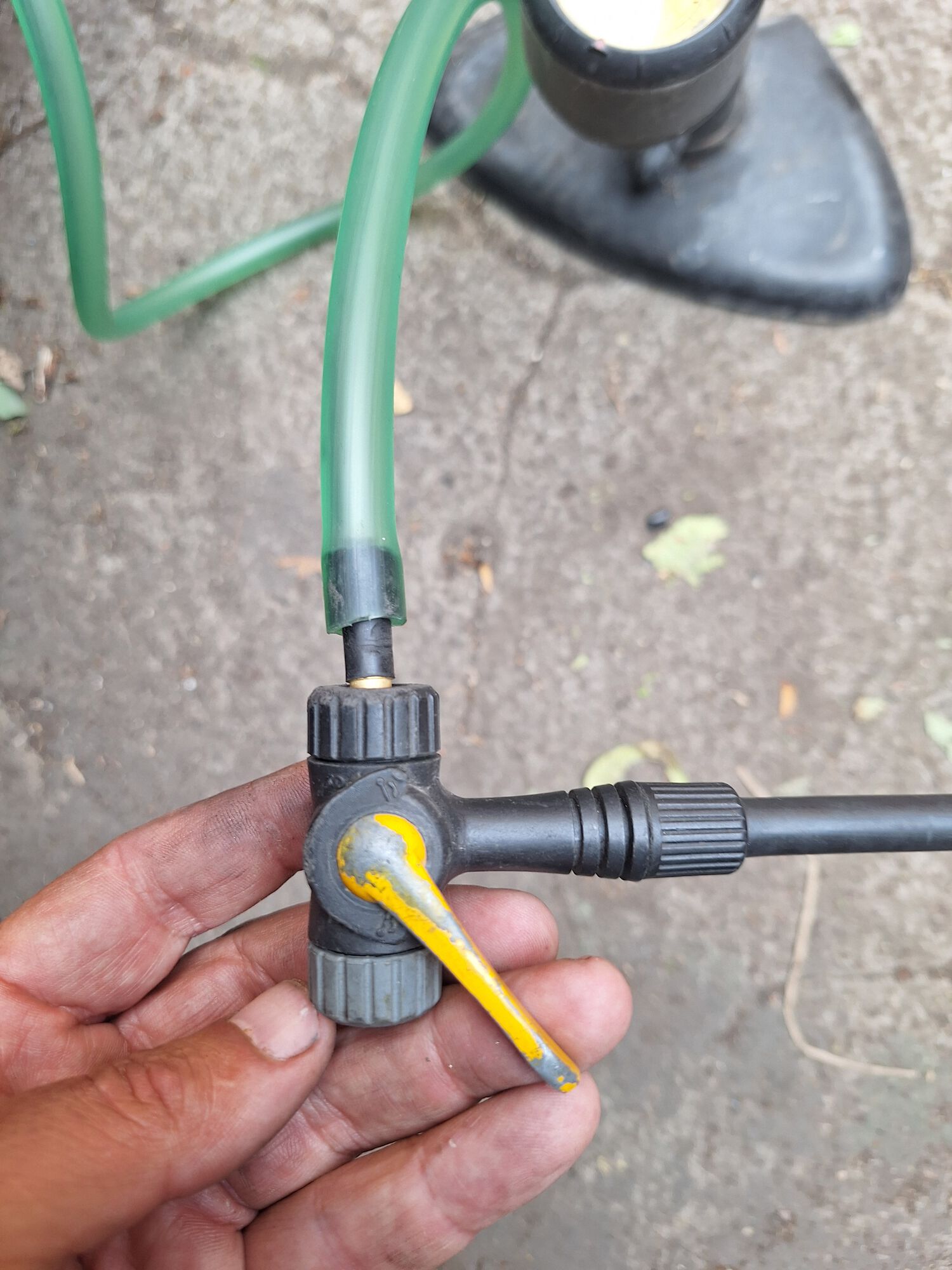

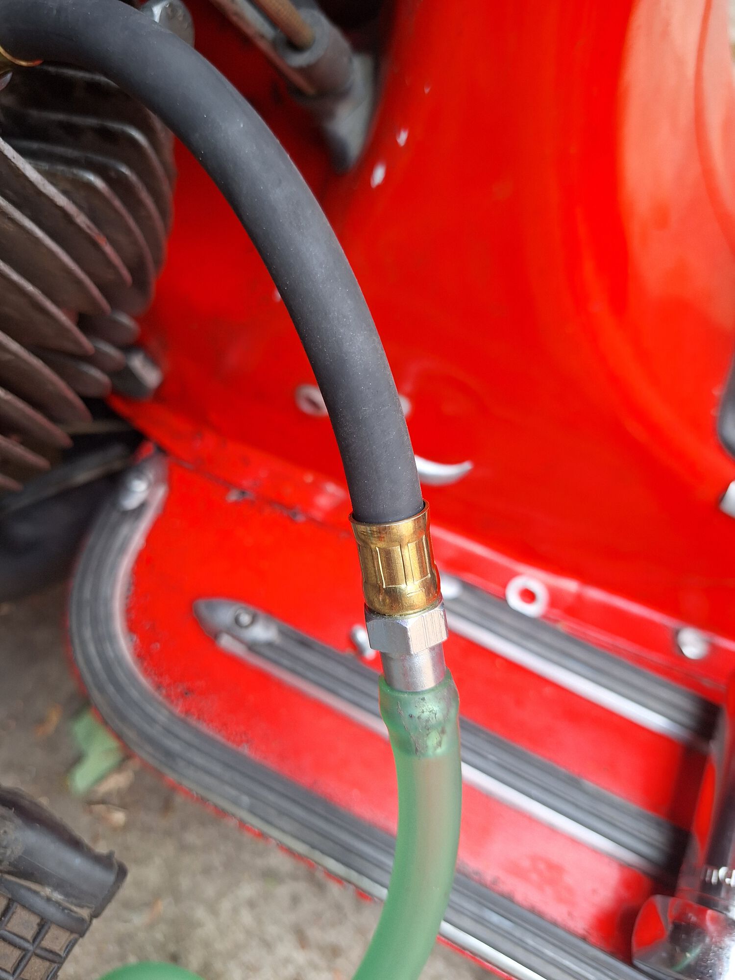

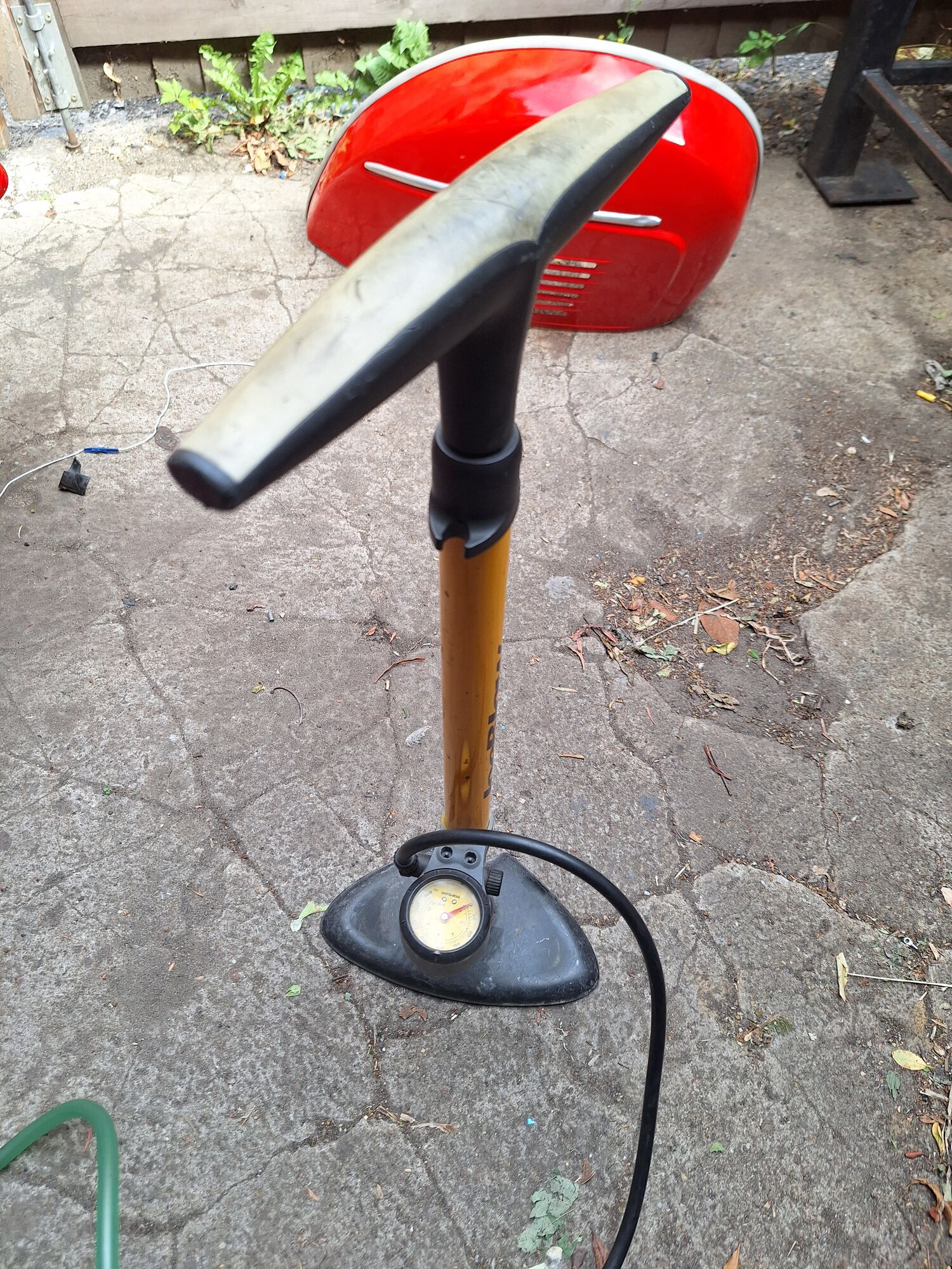

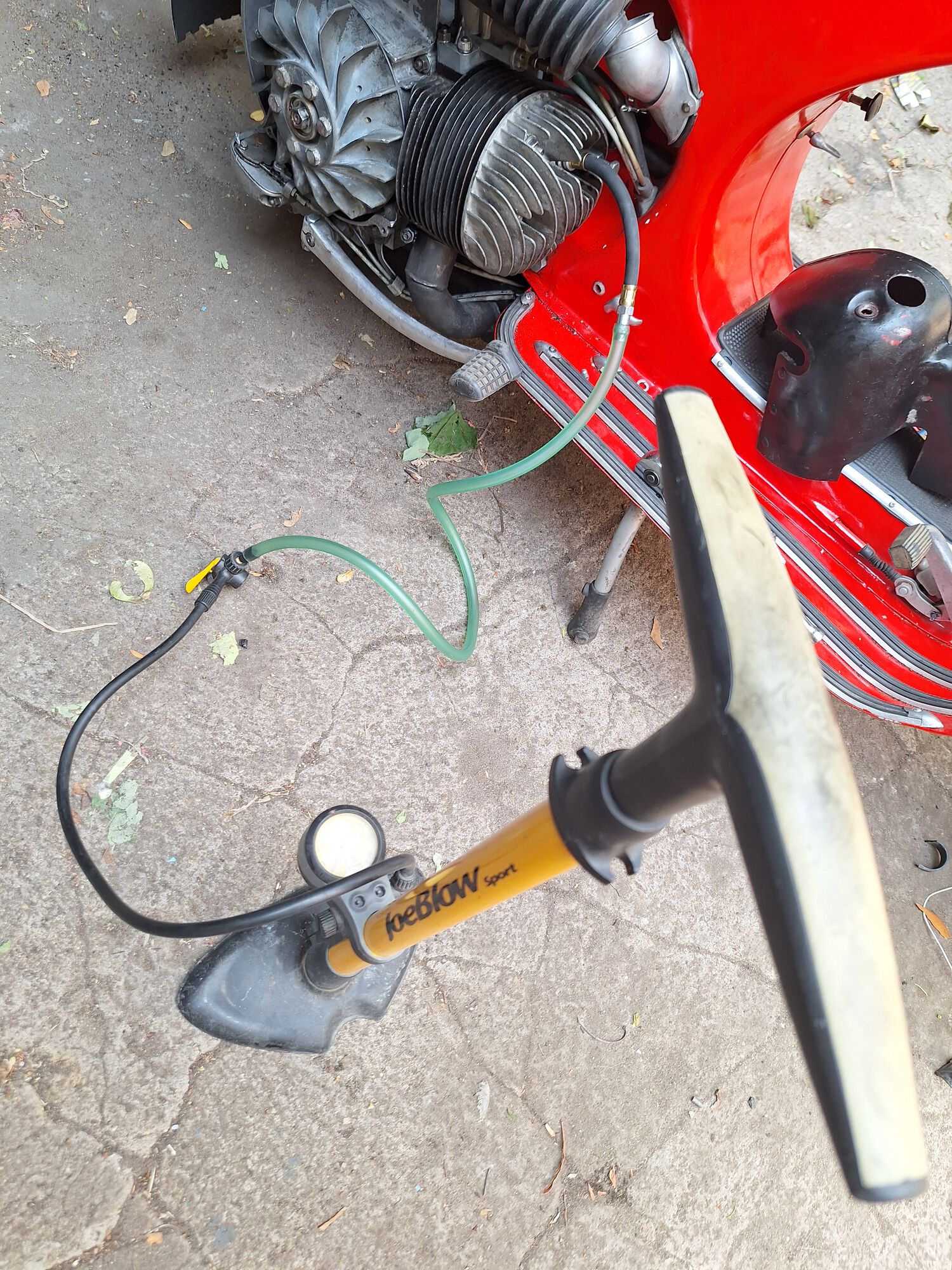

Leak test part one...
How thin is thin multi purpose oil? The point is to make sure it seals, so it has to be thick enough to do that. Otherwise it's going to run past and not have much effect.

When you are doing a compression test, does your gauge have a schraeder valve installed? These small engine don't move a lot of air and you need to minimize the length of the hose to the gauge and have a schraeder valve installed in your test rig otherwise you can get questionable compression readings. Process: (1) Warm engine, if possible. (2) WOT. (3) 5-10 good kicks.
At 7.7:1 compression your SS180 should be seeing about 113 psi (7.7 x 14.7), if all is well.

Thanks for all the back and forth. Have done a leak test and have very minor leaks in the gasket under the carb. Not sure how significant this is.
Pretty sure there are no other leaks.

It's significant. Any little leak will make it impossible to jet and will get worse over time.
[/quote] Pretty sure there are no other leaks. [/quote]
That's good.
[/quote] So with an engine that seems not to leak but low compression at the spark plug end of the cylinder I think the rings may be the issue. [/quote]
Your engine does leak. Fix that. Engine needs to hold 6psi for at least 15mins with no air loss. Once you've got that settled then move on to the next problem.

75psi no oil. 115psi with gear oil.
Time for new rings?

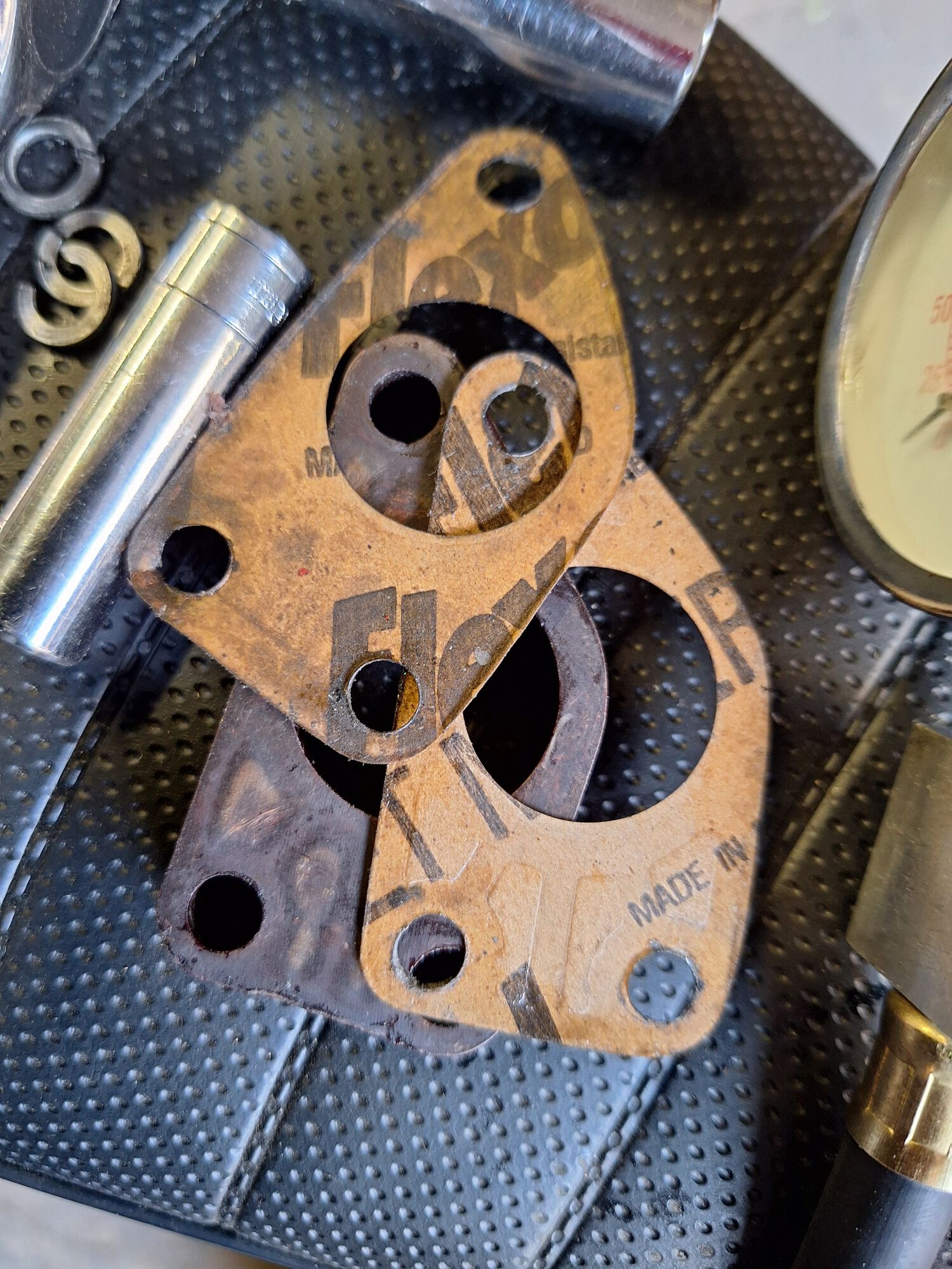

OK, think we are close. Repositioned the rubber block under the carb spacer. Very very slow leak. I don't want to take the engine apart if I don't have to so my thinking is to change the rings, see if have better compression and if the bike will start.
Have used a stethoscope and can't detect any air escaping from listening to the case. No soapy bubbles from the carb gasket or cylinder gasket.
