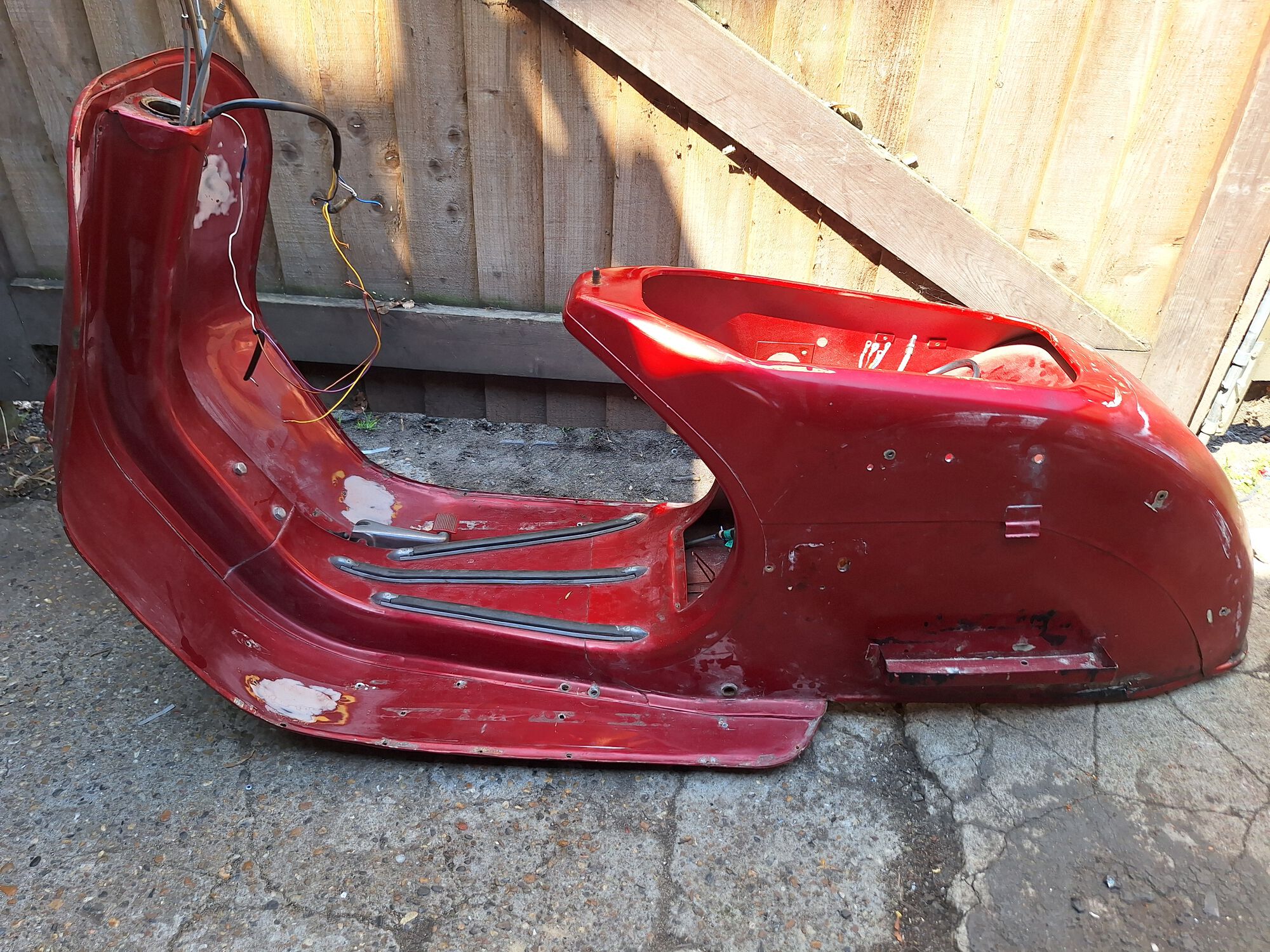

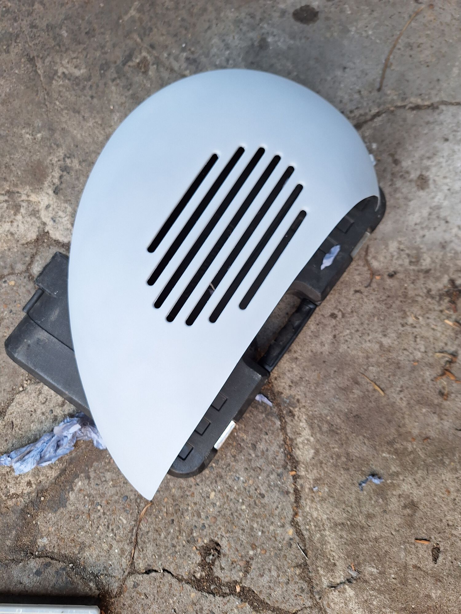

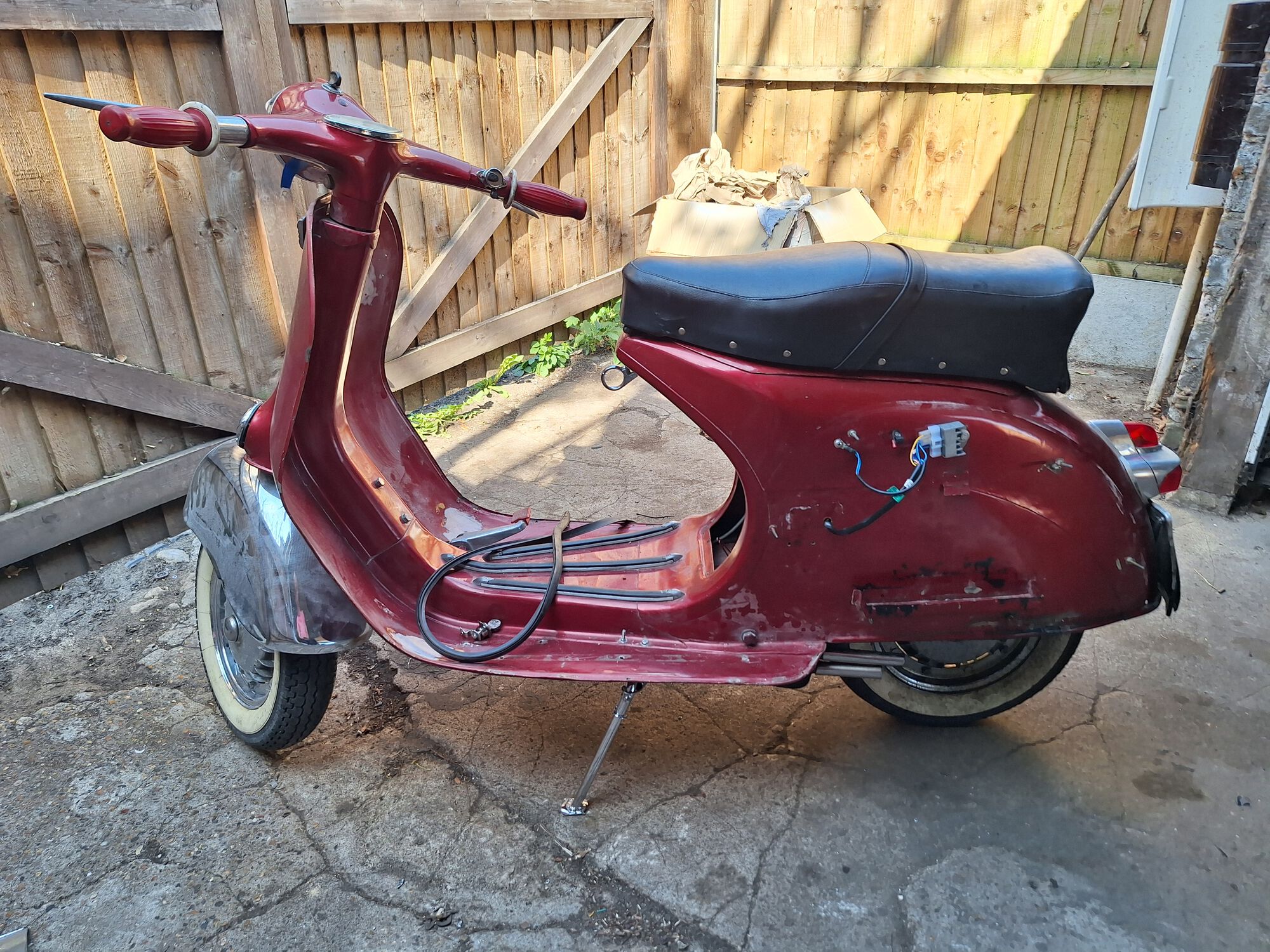

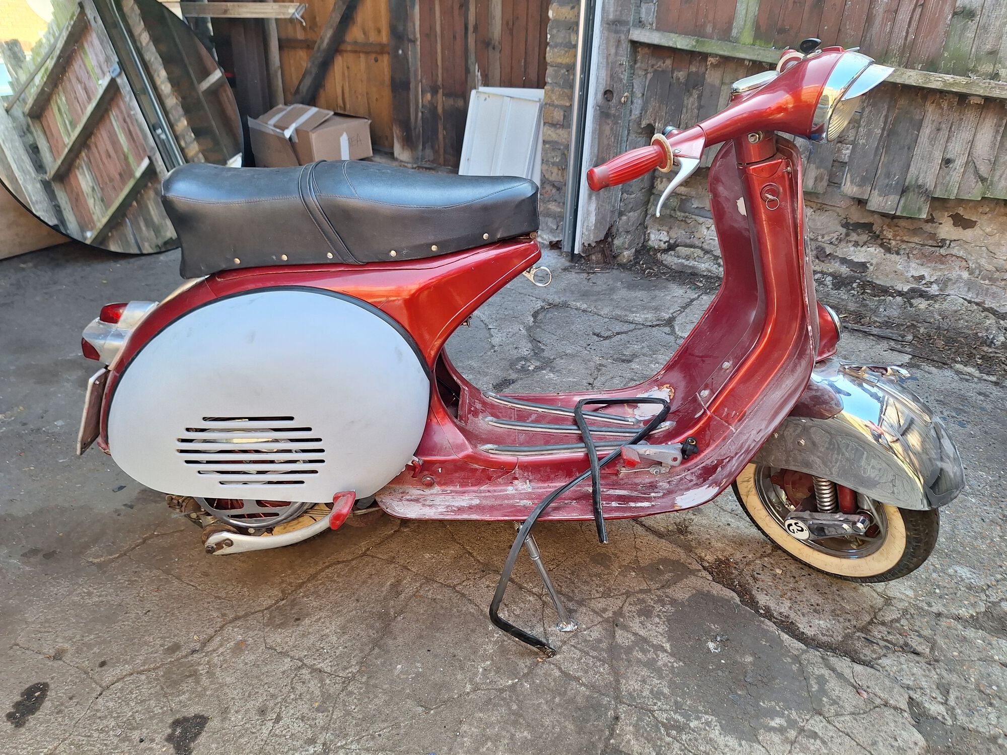

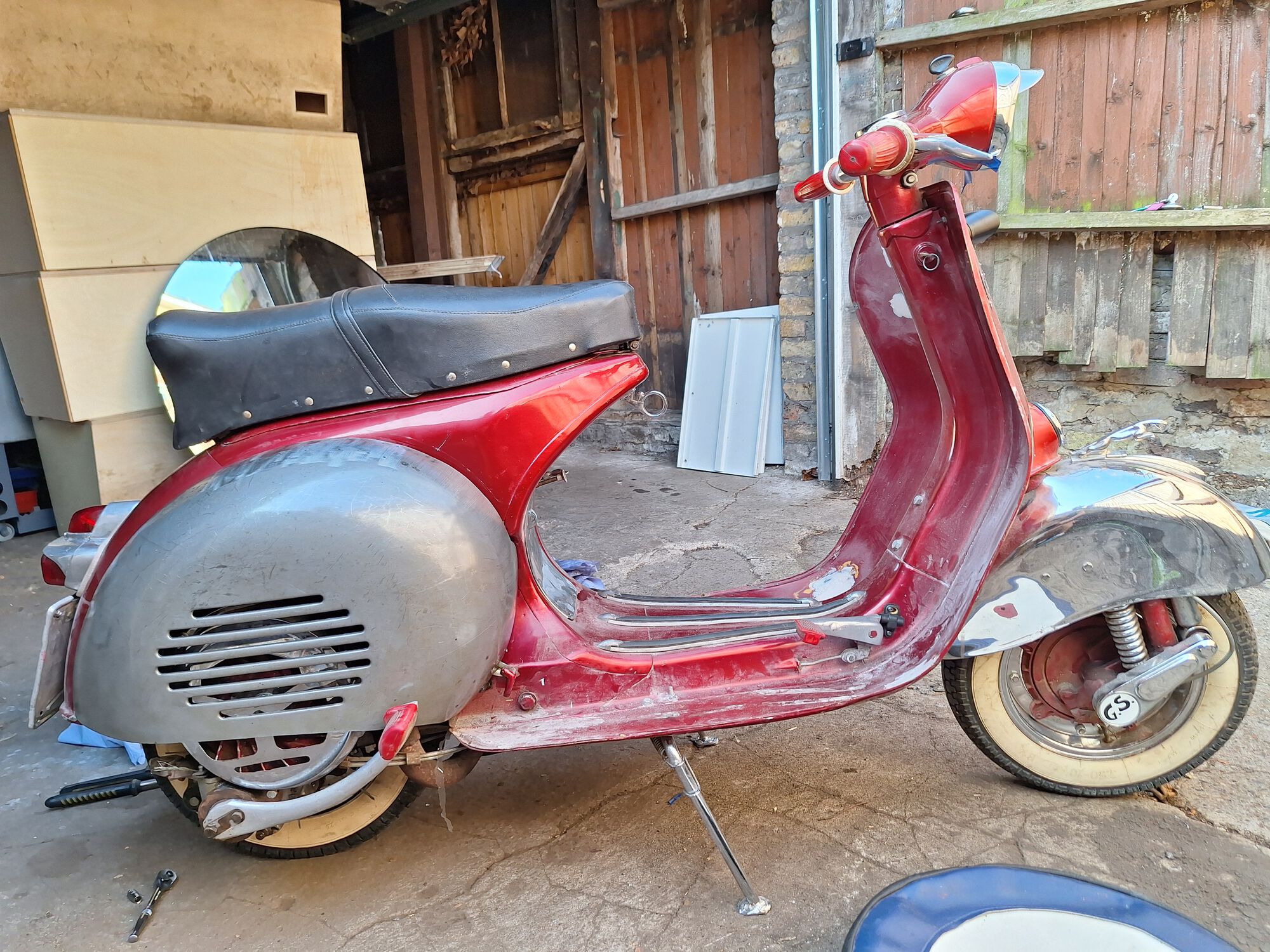

I have this crappy GS150 and some panels and a mudguard. It should really be the original silver colour which means I need to strip it and filler some holes, sand some bits and take it to a paint shop. Any motivation from this forum welcome and does anybody know a modern paint code that I can give to the local auto paint shop.

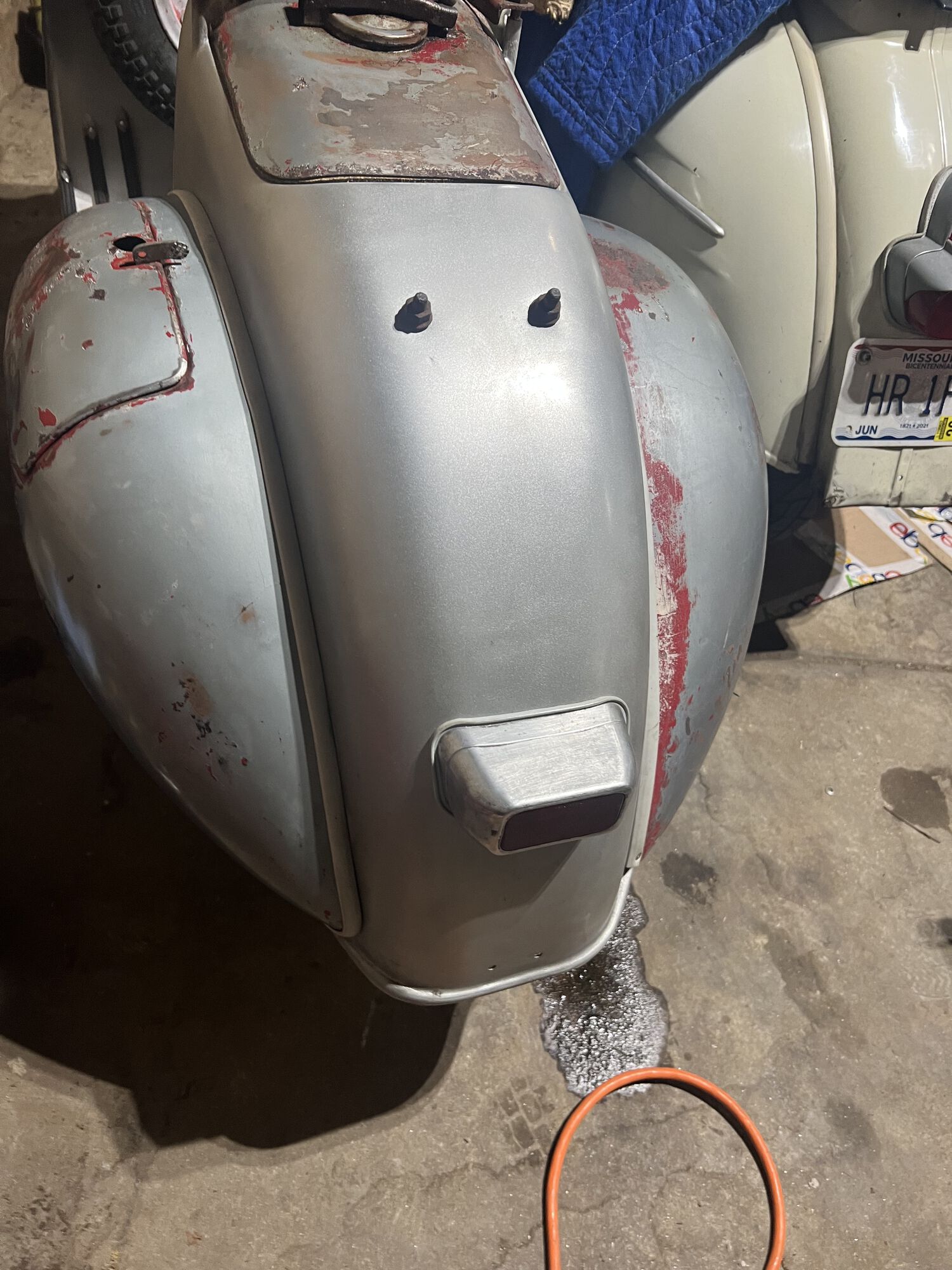

I used this paint on my VB1 frame. Brought a cowl and head set in and they came up with this paint as a match. It's far from perfect, but so are my body and paint skills. I like the color and I was happy with the way the paint sprayed.

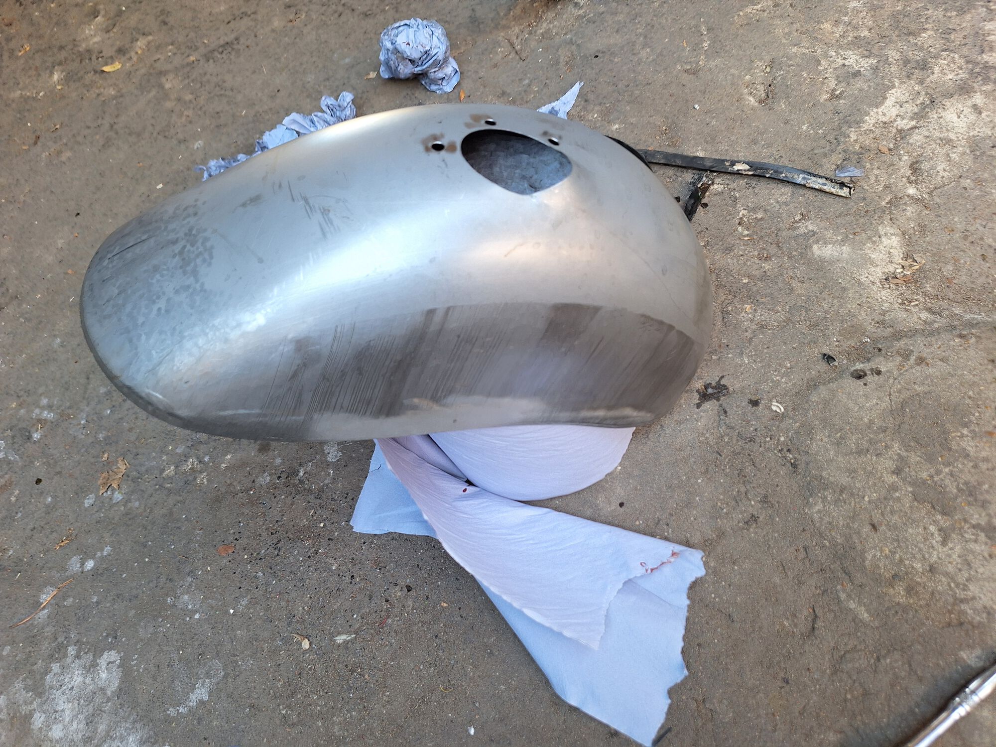

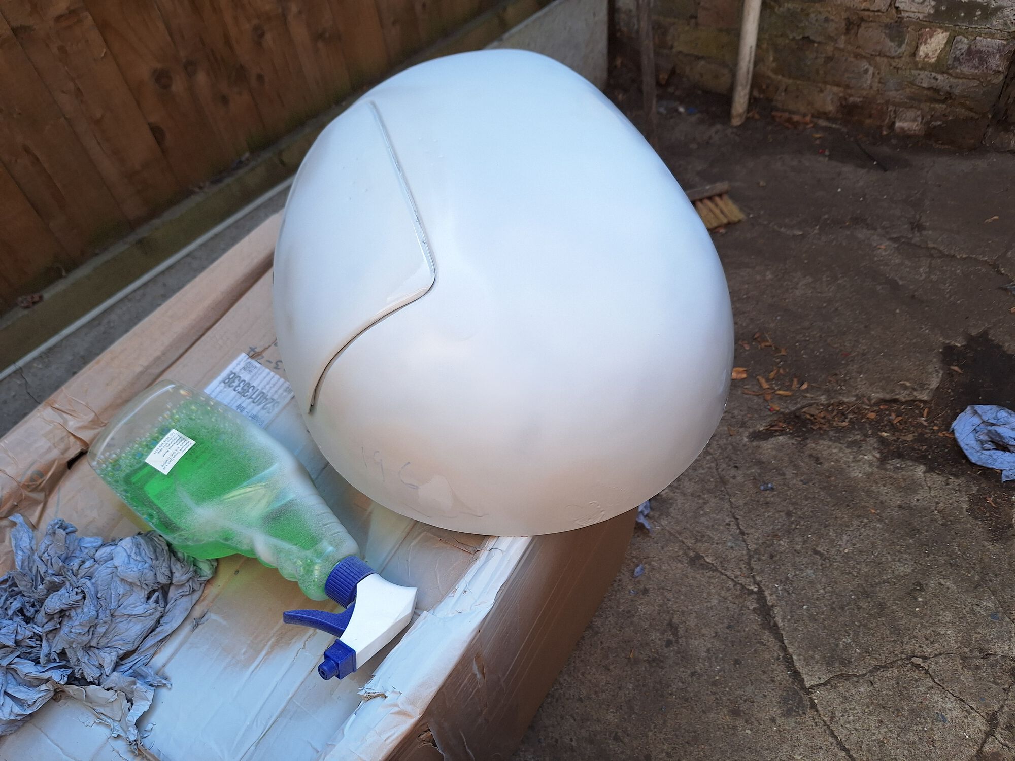

Stripped it this morning (mostly)

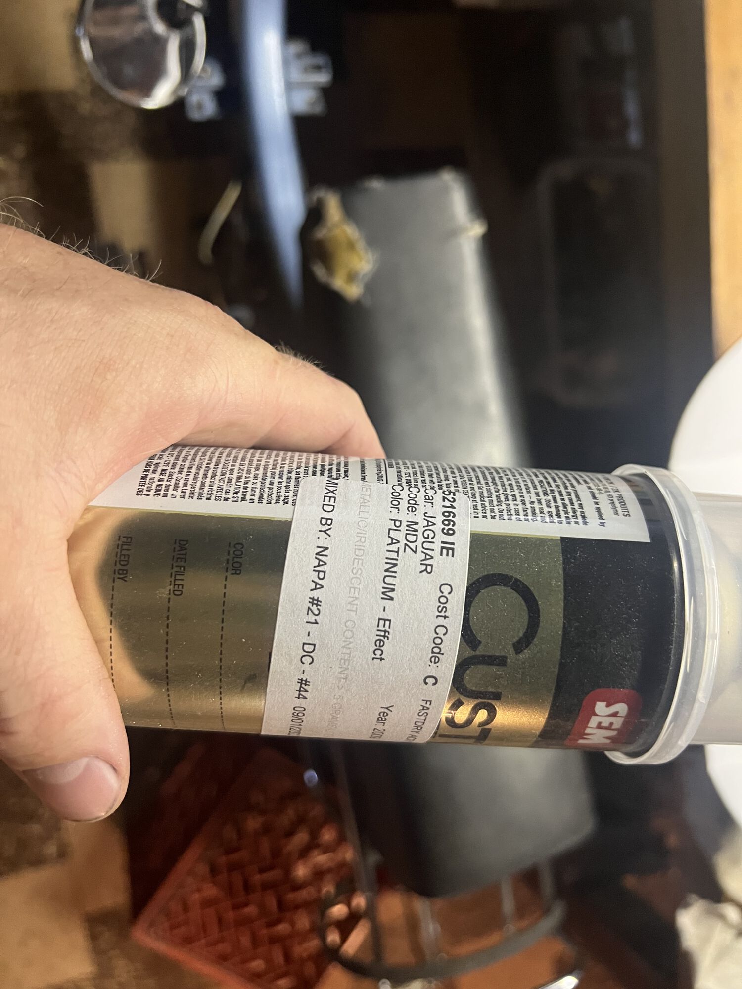

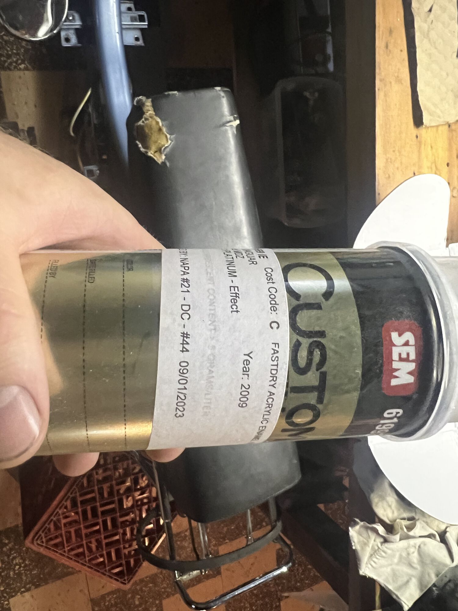

Hey Declan,
I have just done a bit of research. The paint code Jaguar MDZ looks like a good choice. Have you painted the whole bike with it? If so how many cans and what quantity did you use? Also did you use a clear lacquer on top?

I only painted the frame. I had to weld in a new floor and I was stripping the leg shield and rear of the frame on a warm day and the stripper ate down to bare metal really fast. I had done everything else inside with more controlled temperatures.
I probably used 4-6 cans of paint. I used good quality primer as well. I used single stage without a clearcoat. If I was doing it again I probably would have used a clearcoat over the top. I am just going to keep it waxed up. Already had some gas drip on the paint and things held up nicely.
The SEM spray cans spray really nice, it is really hard to have runs. They spray better than a lot of cheap paint guns. Clean-up is easier. My compressor really isn't big enough to run a sprayer. If I was painting a lot I would invest in equipment, but it's something I try to avoid.
