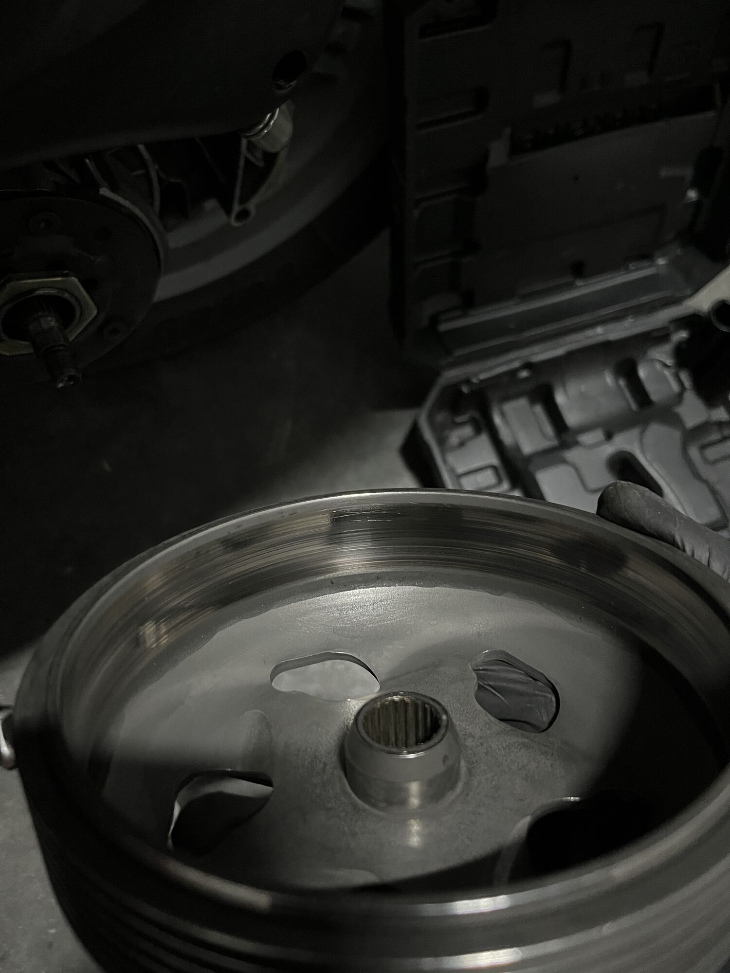

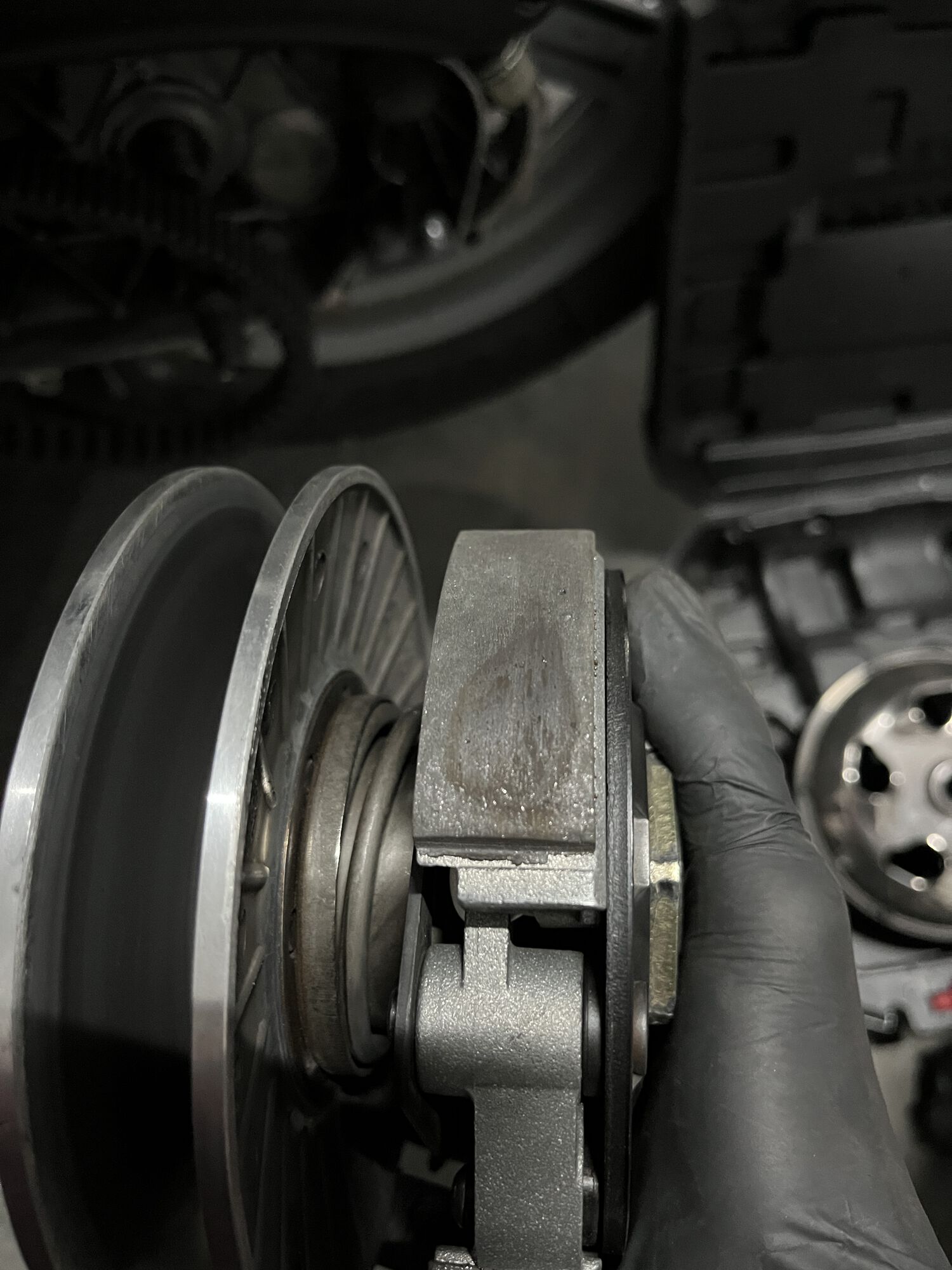

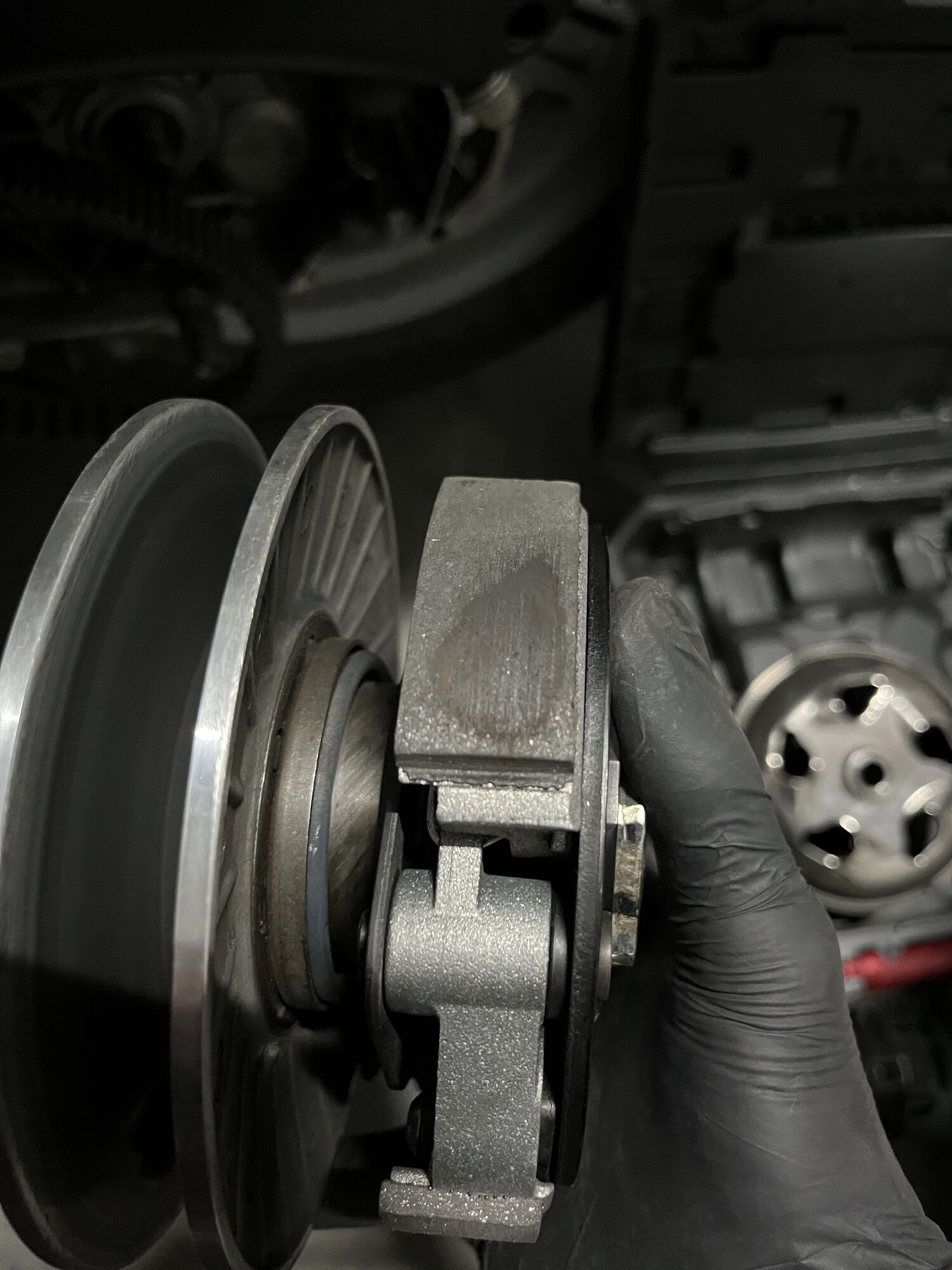

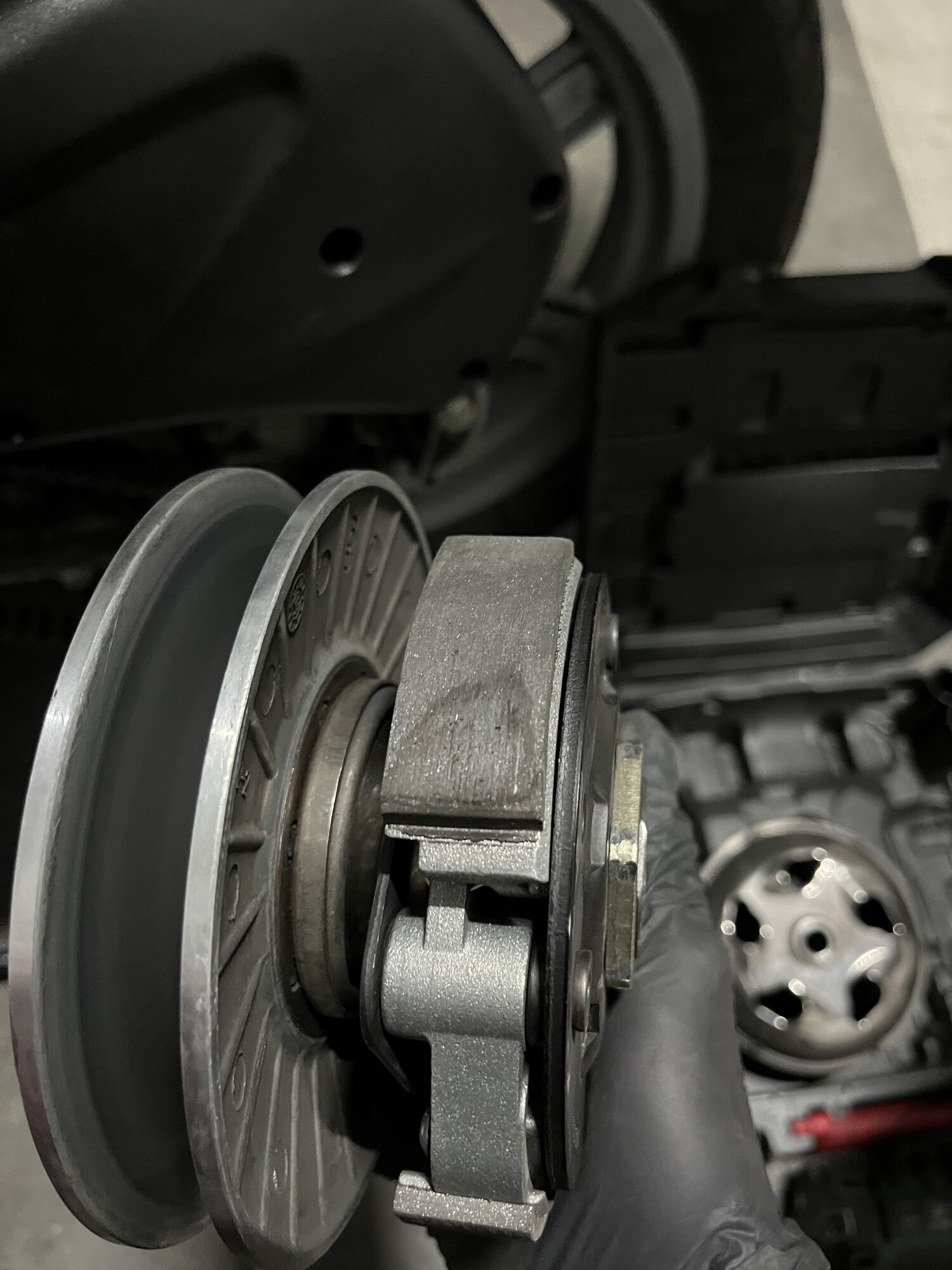

The wear on those clutch pads seems very uneven. You might look at replacing the clutch springs and contra spring?
There is also a Torsion controller available that is pretty cheap, but effective in helping clutch engagement. It work as a cap on the contra spring to reduce friction, helping with smoother clutch engagement.
https://scooterpartsco.com/gts-250-drive-and-transmission-c-3637_3642_3780/malossi-torsion-controller-for-vespa-piaggio-150300-p-523.html
Is that a new clutch bell as well. It might be out of round causing some of your issues as well. You should check the runout on the inside the bell.

last time i sanded the clutch pad i hurried and made them round. today i did it again and now are flat .

i highly doubt the issue it's the clutch bell, i have 3 of them. two of them are runner less than 2000km.

It looks that one clutch shoe engages first. The faying surface of the shoes must be the same. Your variator is also malossi?
