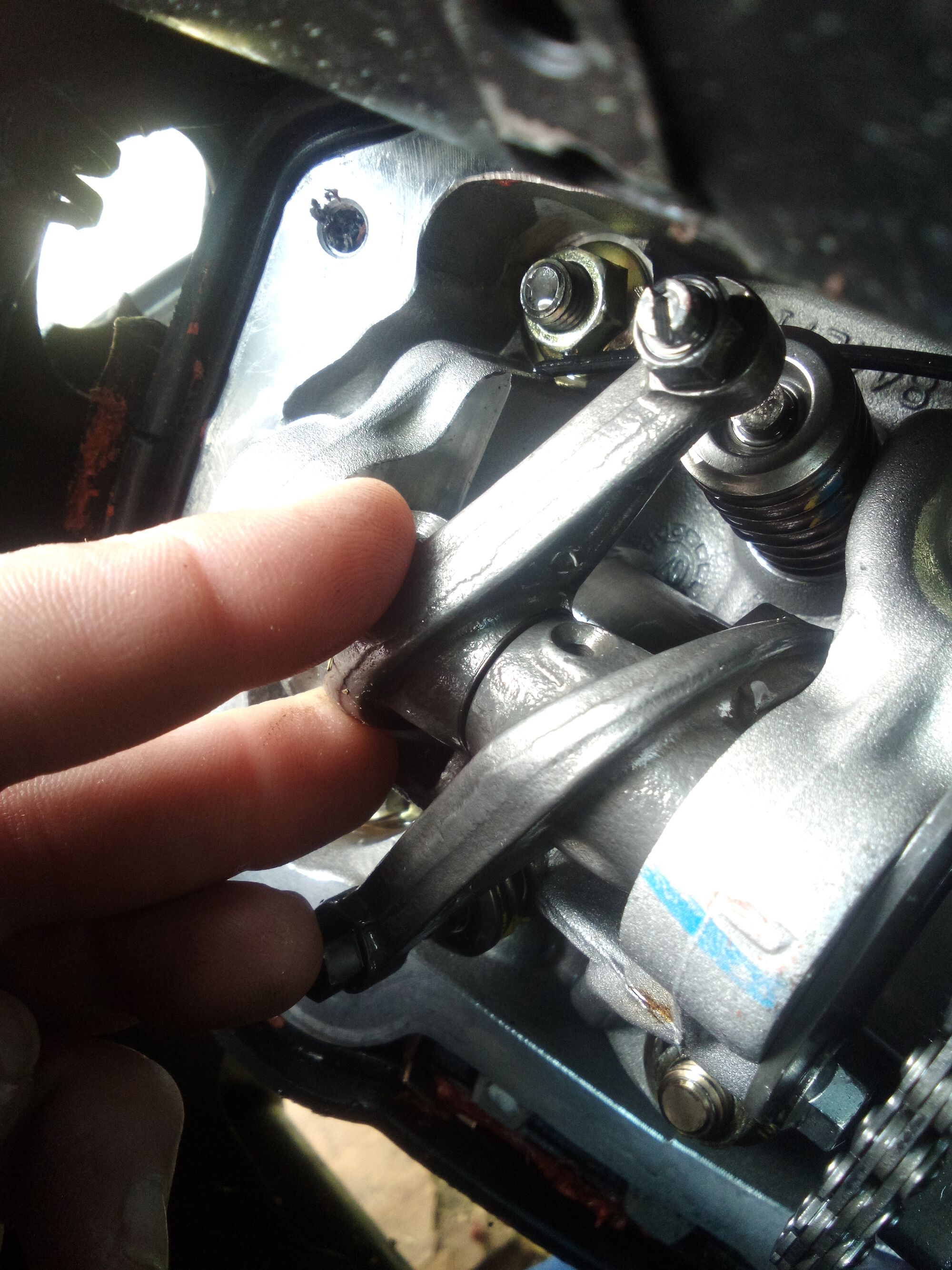

Ok so found it !! It's the upper rocker arm it's just freeing popping around it's not attached properly or something ..there's no tension on it at all to adjust or anything ...however I can't see how to fix it or how it came undone ...what holds it on there ?? Or did it come undone and flip out of place ?? ..I dunno but here's a pic
Wtf loose rocker arm

Maybe it is my eyes but is the tappet screw end broken off, cannot see it in photo
similar to one below, maybe not correct model
https://www.scooterwest.com/adjuster-screw-for-valve-tappet-vespa-484654.html

A photo of the cam end of the rocker arm would be informative - if that's all there and alive and well then you have a valve stuck open, probably jammed into the piston.
The head has to come off at the very least.

Unless that adjustment screw is broken (I've never seen a broken one) or if it is turned out way too far (not sure what it is supposed to look like on that model) then you have a dropped valve, meaning the valve stem is stuck in the valve guide, and the valve spring is not strong enough to close it. If the LX150 is an interference engine, then there is a good chance the valve has contacted the piston. However, if it turns over, and you don't hear any unusual noises, and if it still has compression, maybe not.
A dropped valve is not uncommon on an engine that has sat for a long time without being moved. Engines need to be moved fairly often. If you have access to a borescope, you can stick it into the spark plug hole and see if the valve is in fact open. You can also check the top of the piston to see if there is any damage. If not, try to push and pull on the valve and see if you can get it to move.
If it is a stuck valve, and if you got lucky and it didn't smash the piston, I would recommend removing the head, inspecting everything, replacing any parts that are damaged or worn, and definitely replacing the valve stem seals.

Did you find the broken piece?

The broken piece ended up being the little nut type thing on the end of the adjustment screw that pears on the valve spring...I replaced it w a nut that fits the adjustment screw till I can get a whole new screw ..have to order it id imagine from where I live ...I had it together but on way to work it came undone again ...I'm waiting on side of road currently for rescue

I'm having trouble understanding what broke. I don't see an adjuster or locknut missing in your photo.
And if a nut or other piece came off in the head, then I'm really surprised you were able to replace with your own hardware and that it ran again (even briefly)!

So it was the other end of the tappet screw, needs to be changed
