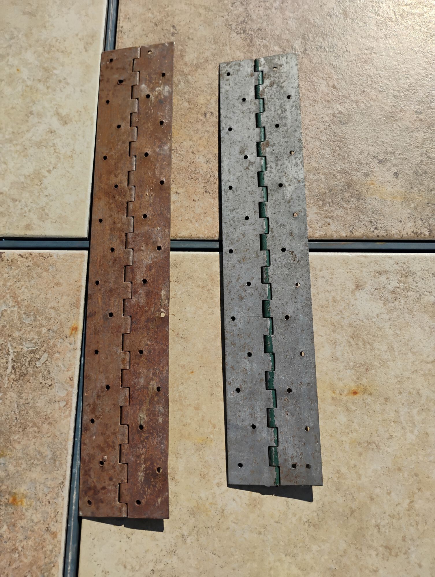

We talked about this method into some topics but I can see some people are struggling or don't know this recipe.
This is easy to make, and very cheap compared to specialized products :
I'm using it for quite a while and this is VERY effective.
Voilà

I've made this - we already had the ingredients in the house - it works fantastic and seems to last a lot longer than evapo-rust.
Thanks for sharing this ColinBelgium!

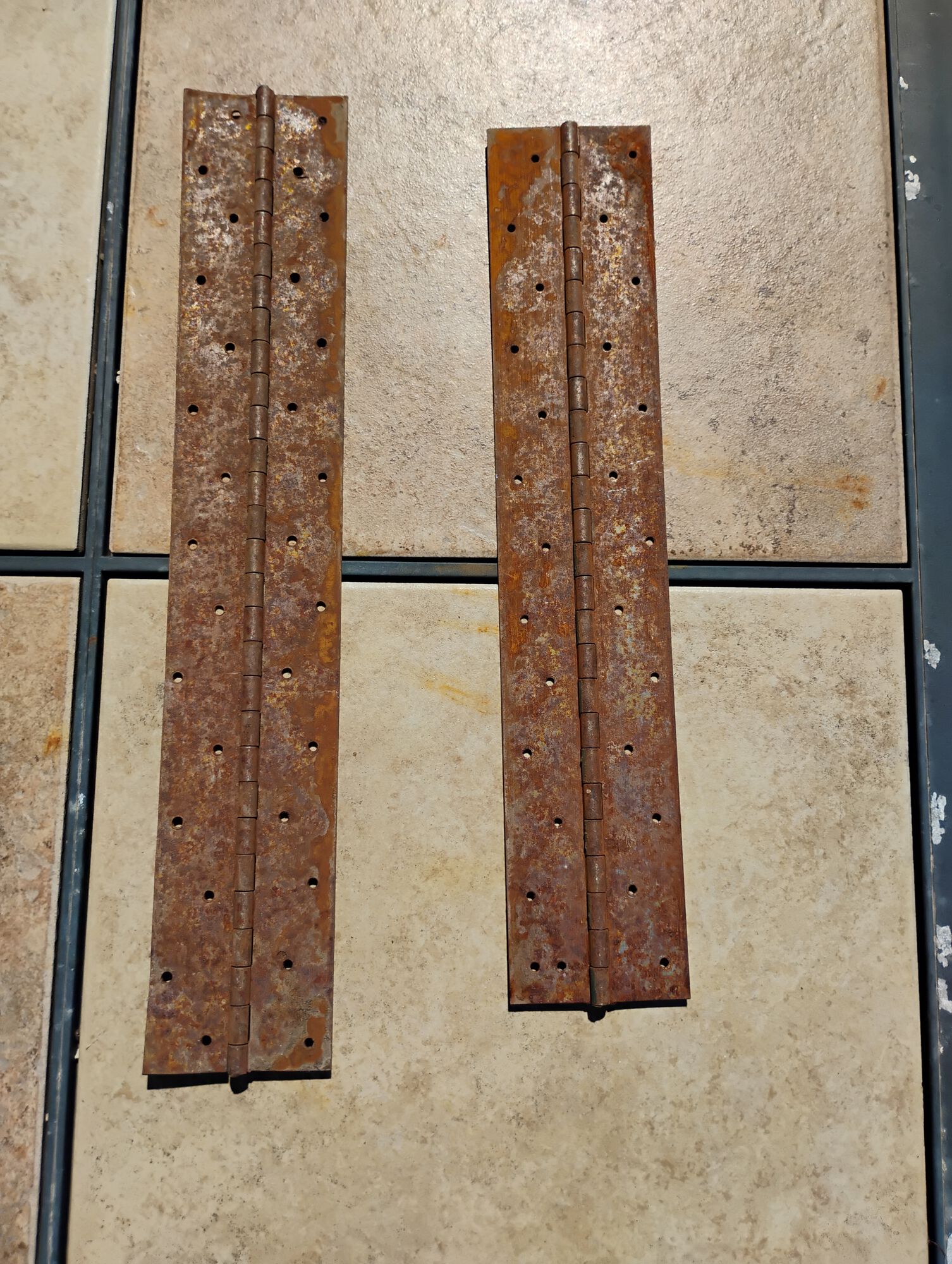

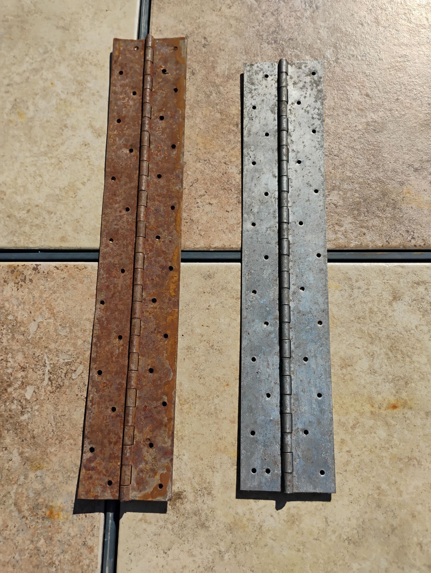

After one hour in the juice.
Wow.
Evaporust can bite me.
