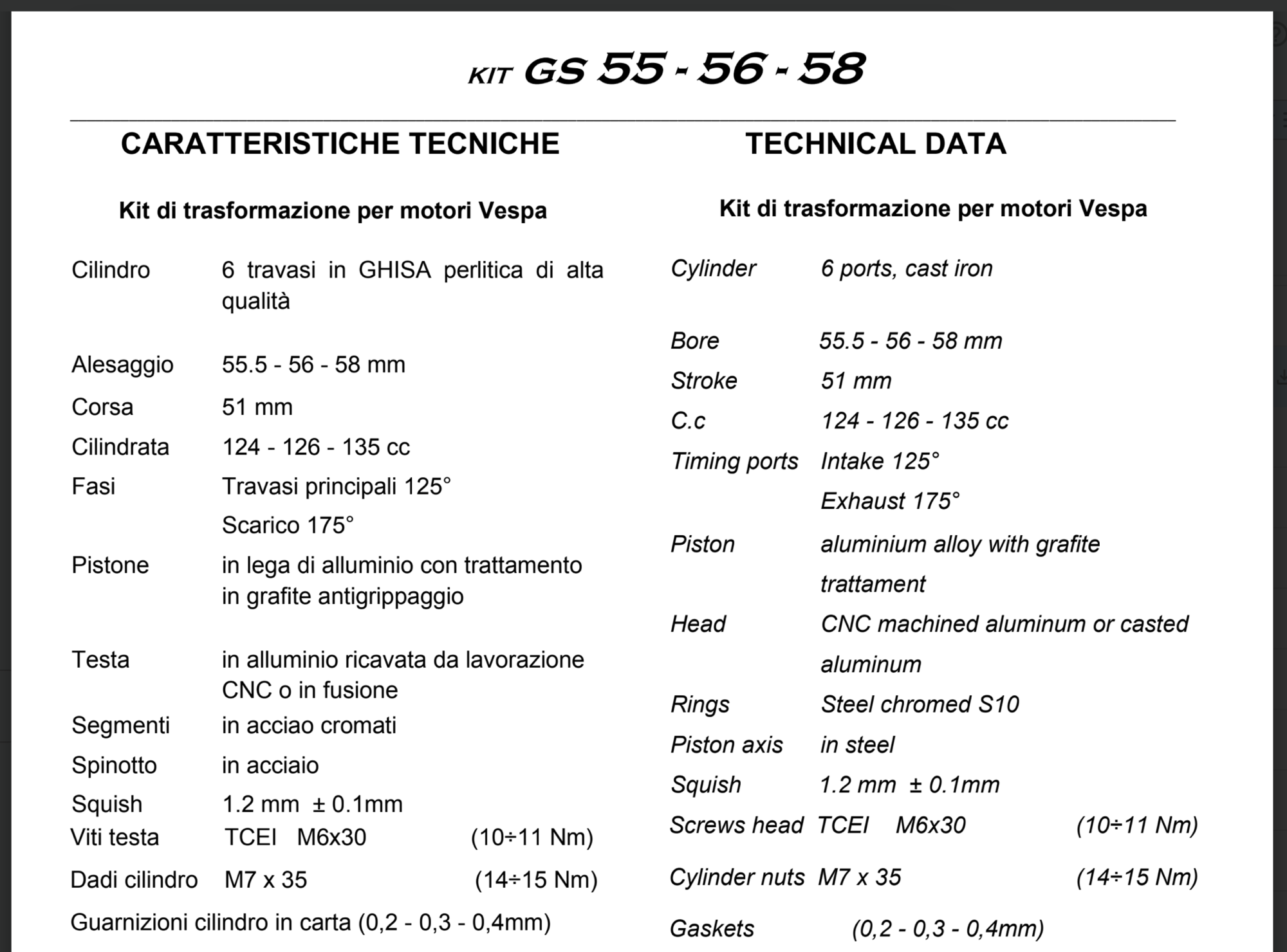

I can't seem to find any info on this kit at all, I need some information such as what torque spec for the 8 nuts, do piston rings need a specific presentation? (Trapezoidal?)

As with all kits, one should check the ring gsp is correct for the postpn being used. There is a formula for working it out. I'll have a look for it and post it here.
Torque spec on the bolts. Use the appropriate spec for the size of thread. The vespa manual has it listed for M8 and M7 cylinder... 200cc and 125cc respectively

The 4 hex bolts are M6 and the standard 4 nuts are m7
Do it to the spec of the M6 so you don't strip them with the M7 torque.

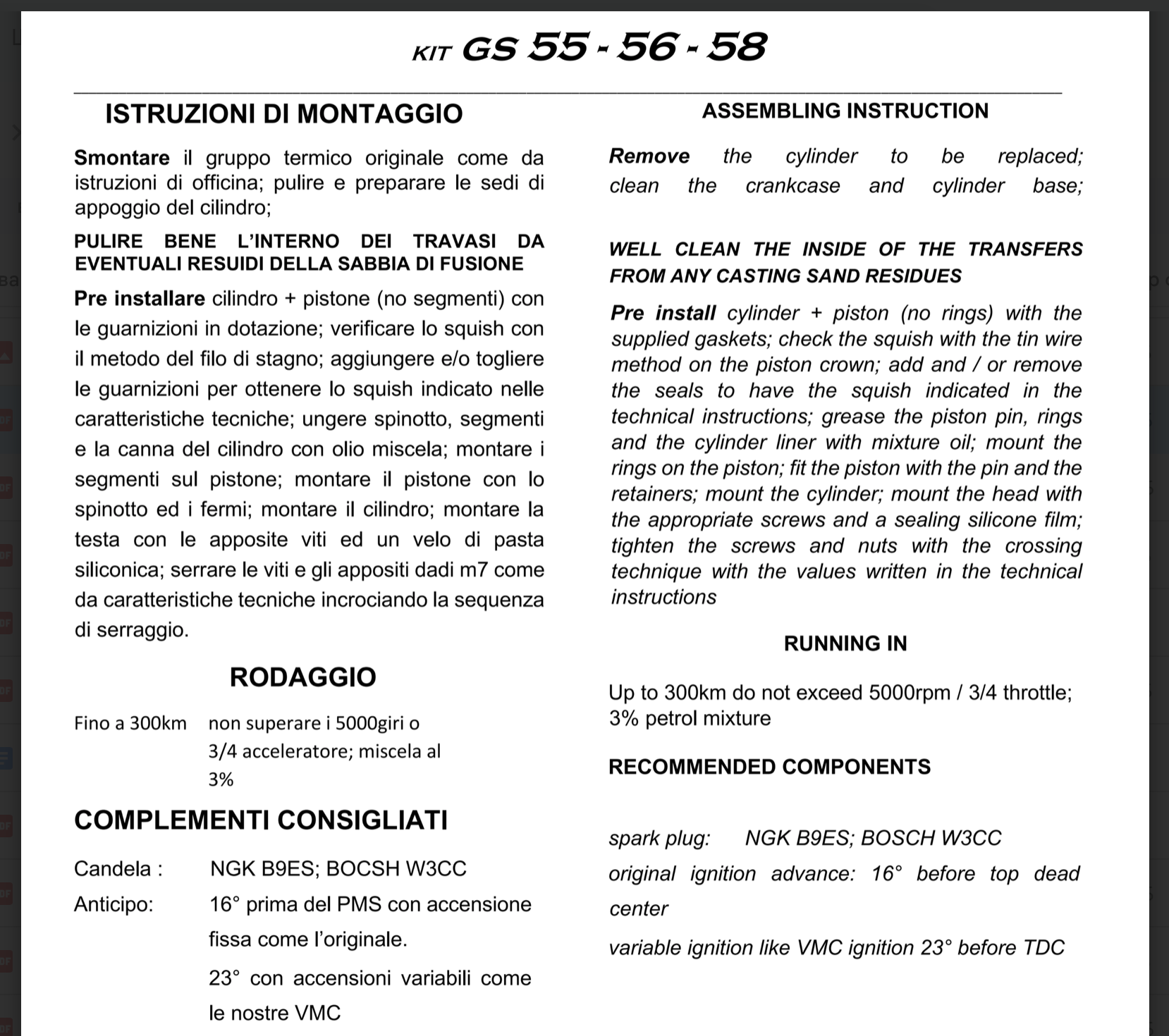

Couple questions, Do you run the 3% fuel mixture when running in or all the time, or simply the usual 2%. Also I assume as it doesn't mention anything about setting ring gaps it is all to spec already? When you test the squish, do you torque everything down to spec? Sip states the recommended ignition timing is 18 BTDC unlike the 16 in the manual
@roland87 avatar
Posts: 1793
Location: Ukraine. Kyiv.
@roland87 avatar
Posts: 1793
3% for the running in. Then 2%.
From 0.2 mm to 0.3 mm is ok for ring gap. It is worth to check. On my VMC GS 125cc kit wrong rings(from 135cc) was in the box and I need to file them to fit
Yes.
Lucawasps wrote:
Sip states the recommended ignition timing is 18 BTDC unlike the 16 in the manual.
I have 18° with my SIP kit.

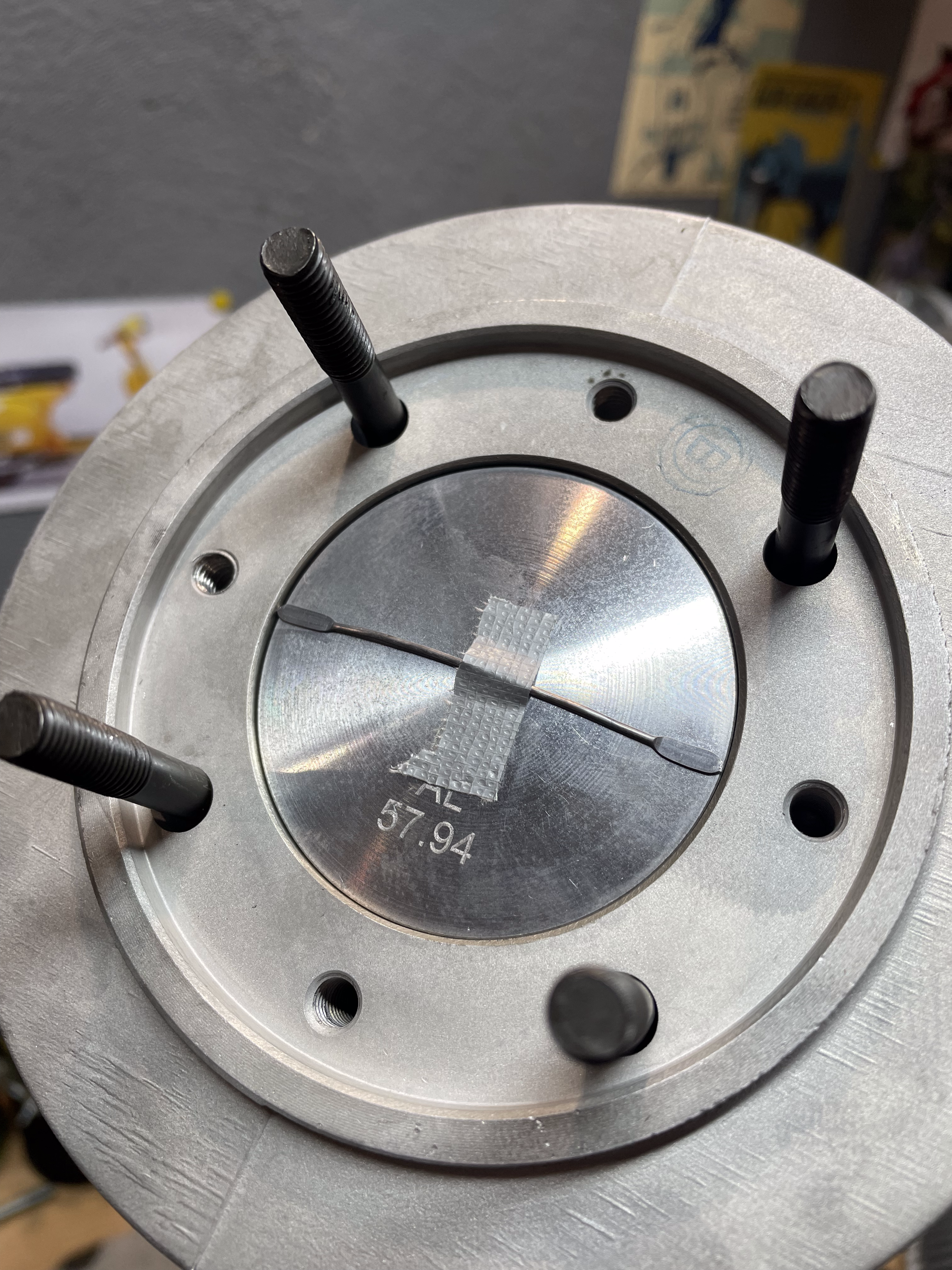

Roland can I confirm the squish is 1.2mm from the edge of the piston and head? Also do you need any locking washers for the head fastening, none are provided. Is silicone needed for head gasket?

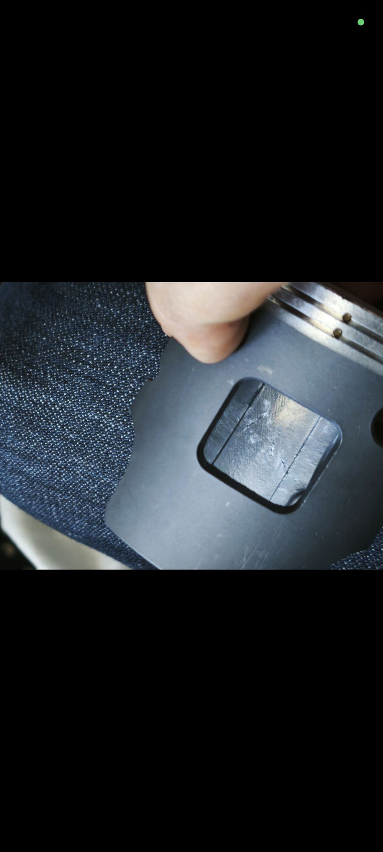

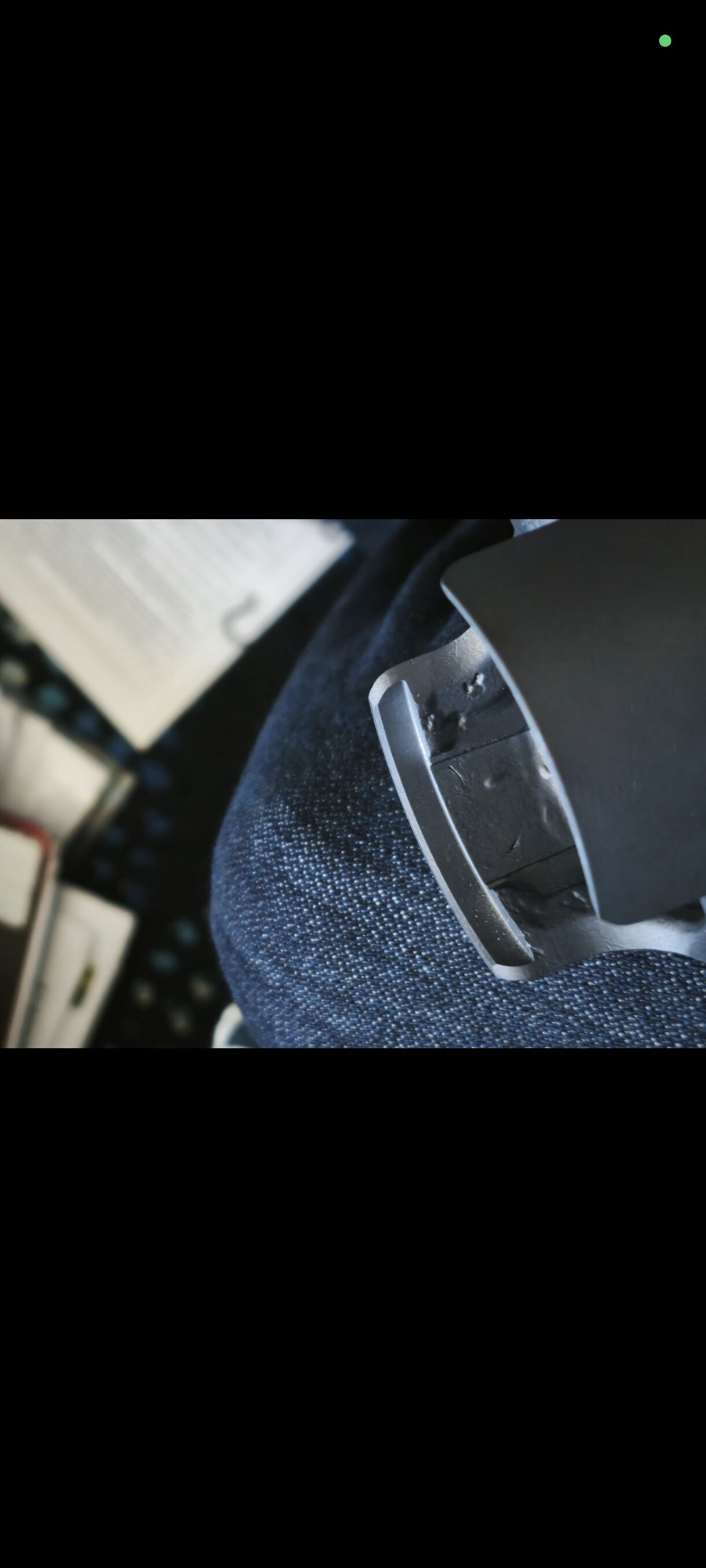

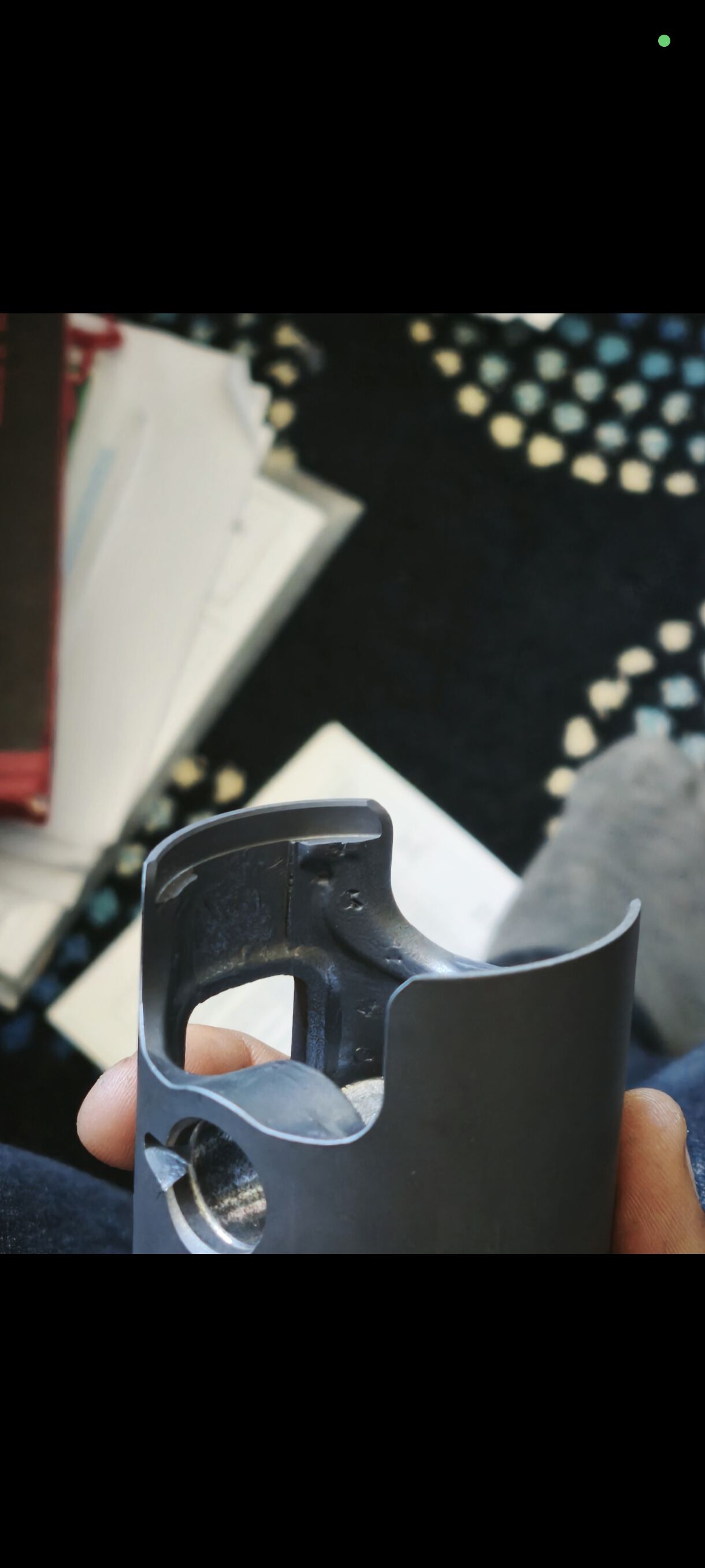

I have just noticed the cylinder included does have some imperfections on the inside of the sleeve, it does not show up on the outside but doesn't look nice , did your come looking like this?

Looks to me like there was either some grit or similar in the mould or it was a trapped air bubble when cooling down.
I don't see it being much of an issue either way.
If it really grates on you and you are not happy to run it, get in touch with whoever sold it to you and ask them to send a replacement - checked before despatch

It does look like manufacturing damage and goes quite deep considering thickness of skirt
Send it back if its deep... surface isn't really a problem

To be honest, I don't remember what my piston looked like, but it seemed fine. I wish I would have noticed something unusual.
I only have these photos, and looking through the intake port, everything looks fine.
And I already done on it 3000+ km without any problems.

They are definitely casting imperfections, thus shouldn't get worse from heat and pressure but I'll see if I can get replacement anyway, I'm in no rush as I'm getting my frame reinforced
