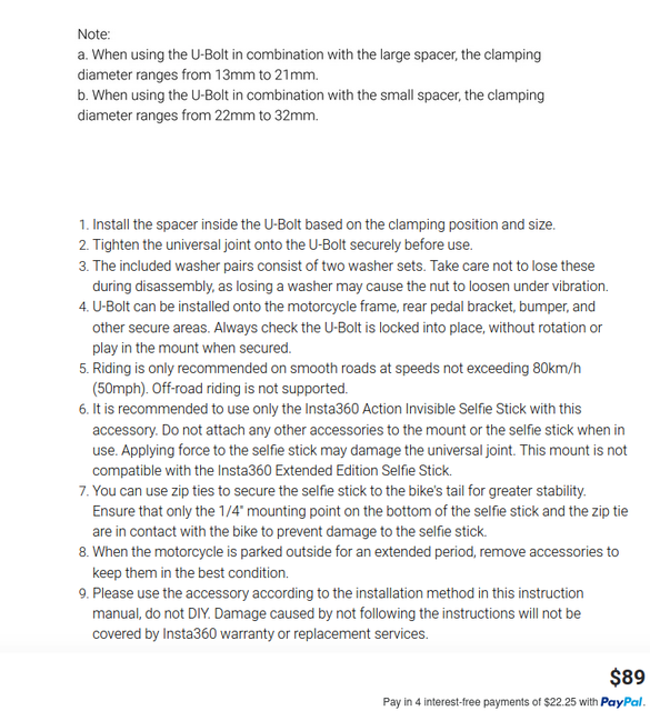

Something simple like in link below, just put it on rear handrail, obviously you will need the stick with the U bolt.
https://store.insta360.com/product/motorcycle-ubolt-mount

When you mount your camera, please make sure you use two different mounting points (in other words, to prevent the stick from rotating you'll need two clamps, but if you use both clamps on the same mounting point, your set up will not be stable). This is important if you plan on using a selfie stick because any bumps may (and will) cause the entire unit to move/rotate, creating a hazard to the camera and to you (when you're being distracted by the set up as it starts to move). I learned the hard way--luckily my camera (Insta360 X4) didn't actually start dragging onto the ground, but if I didn't pull over, it was just a matter of time before it did. If you have crash bars on your Vespa (like I do), it will help with mounting points, otherwise the mirror stalk or the rear grab bar would be your only decent options. If you don't plan on using your selfie stick, then the two mounting points aren't as important, but if you do, please remember that the two clamps holding the stick are on different points.
