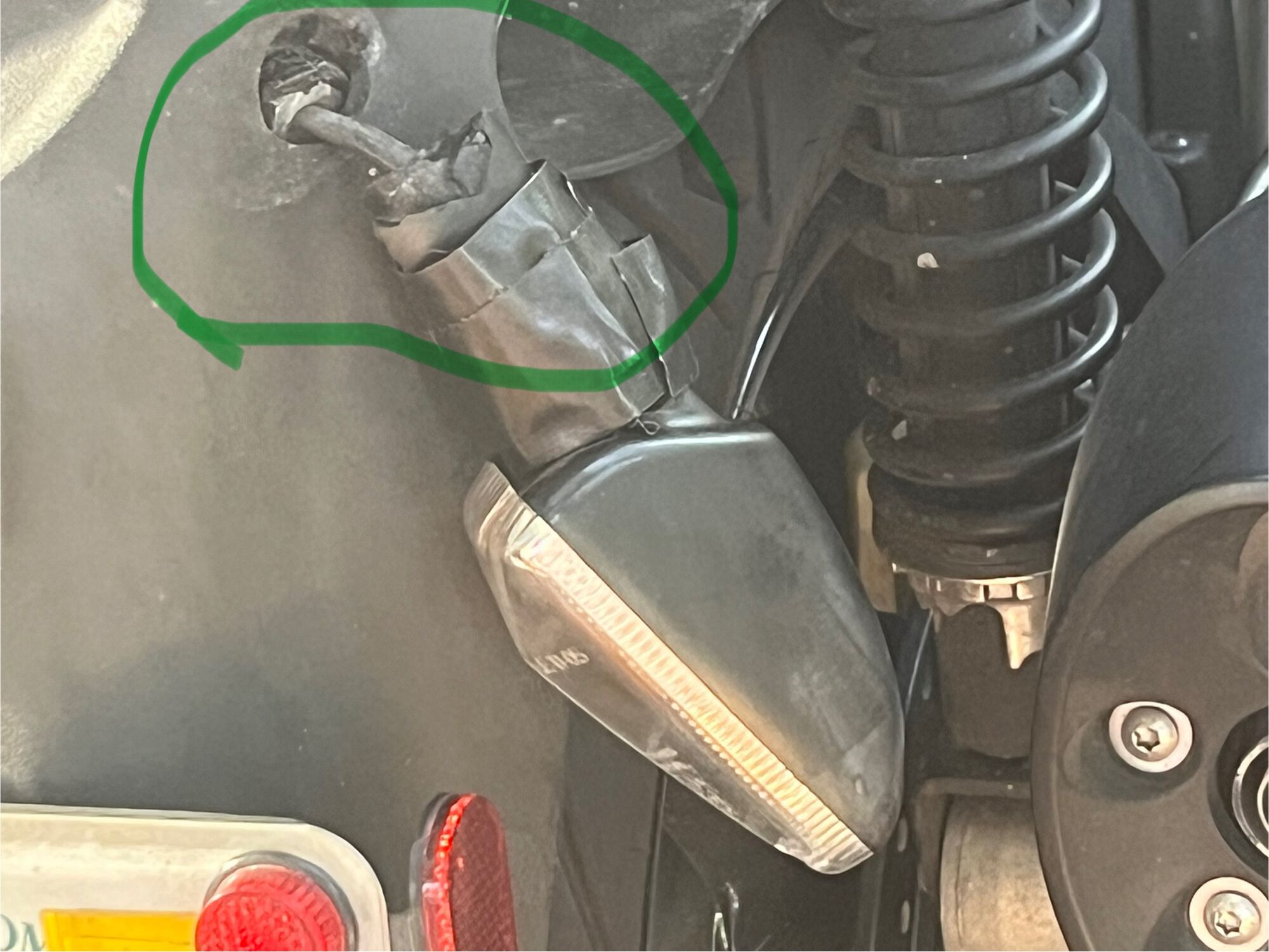

Rear signal on a Bv350.
Not much surface area to glue or use J-B Weld. Appreciate any ideas

Probably need to use a plastic sleeve (bushing) with a flange on it that can be glued.
Someone with a 3D printer and Fusion 360 or sketchup could design a piece that would slide into the signal and have flange to mount on the body.

plastic welding with mesh screen

Small metal 90 degree bracket and some glue.

Or just buy a new light assembly, ~$20 from Piaggio.
Part number 643064 left side, 643065 right.
