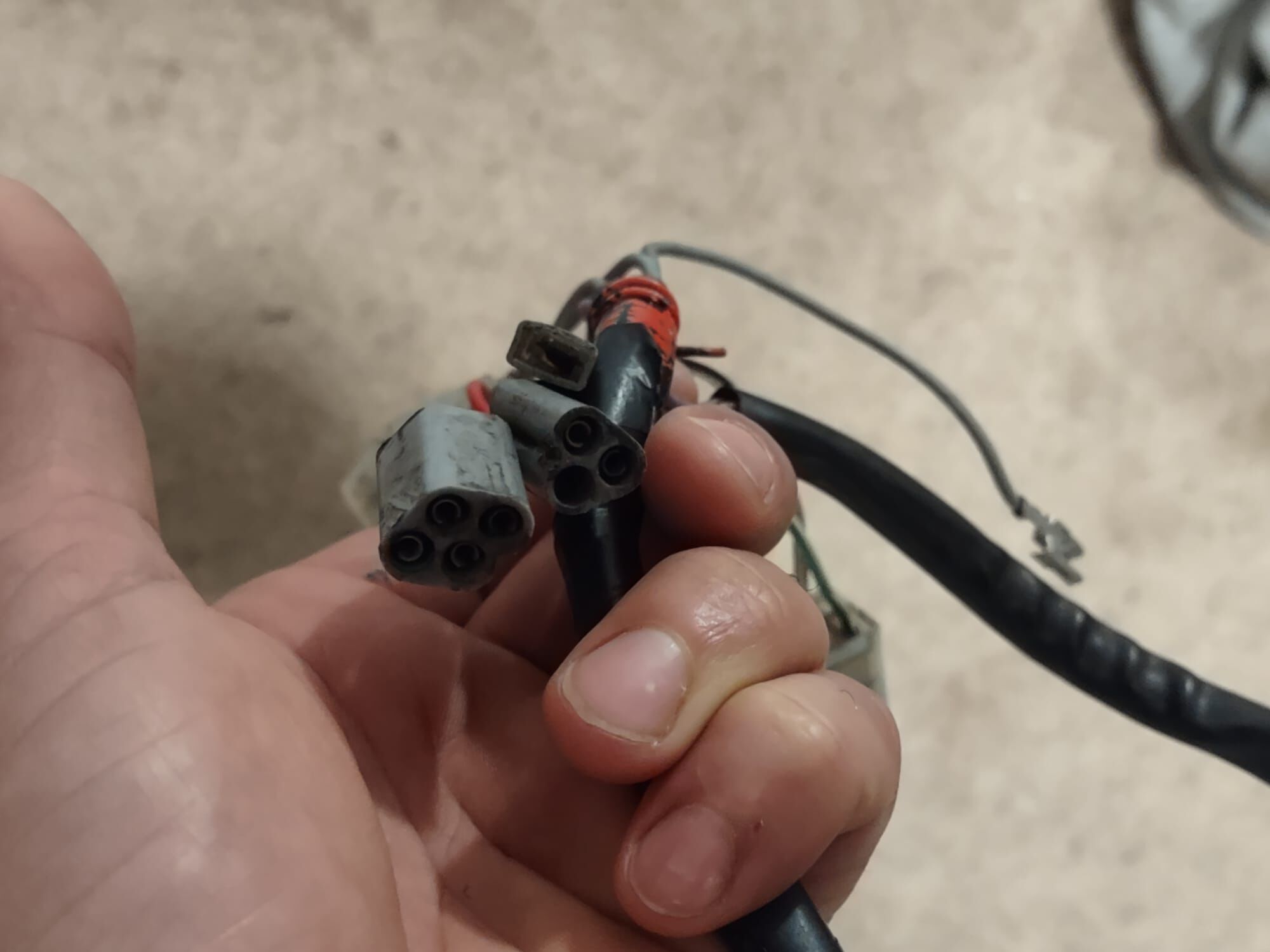

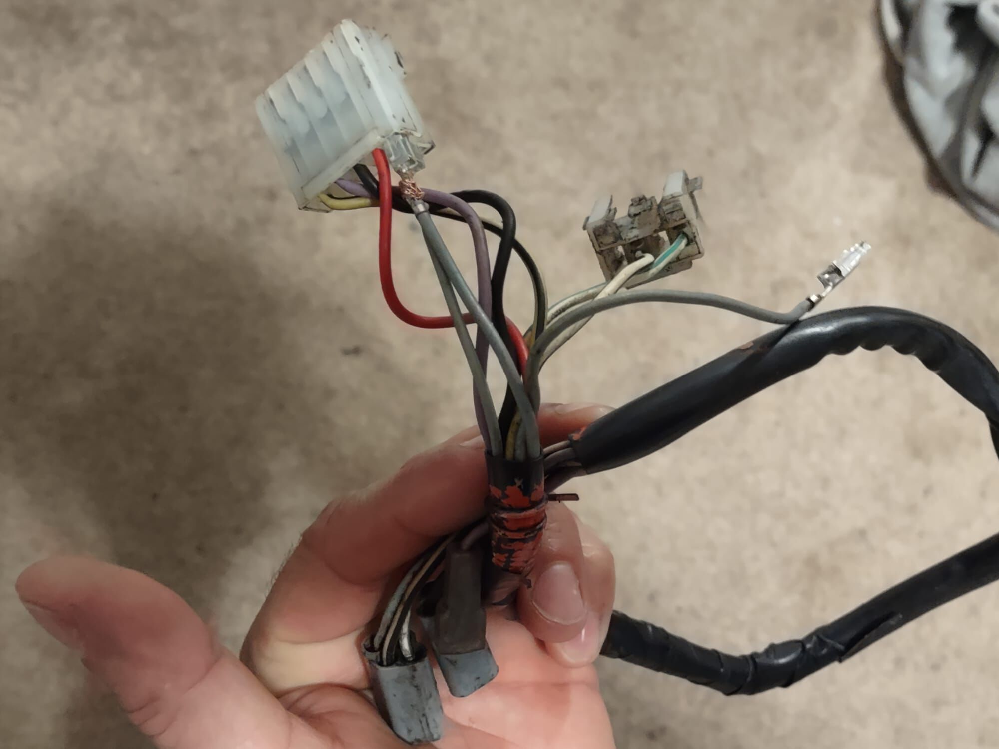

Hey all,
I have a friend who is graciously refurbishing my T5 speedo wiring harness. The original one was significantly damaged and I managed to find one from a scooterist who has parting out his T5. Once I Recieved the new harness it was noted that it needed to be cleaned up and somewhat re wired.
Below are two questions he asks when attempting to refurbish the harness.
The question is:
#1
Does the 5-pin harness have a Double Grey? (grey/grey to one of the outside provisions)
Or does the 4-pin harness with 1 empty provision, get one of those double greys?
#2
Where does the longer Grey Contact go, on the 4-pin harness?
See pictures attached.
Thanks for all of your input. If you require further clarification of the questions, please let me know and I'll ask my friend.
Thanks again. Much appreciated.

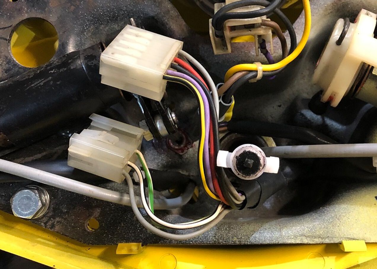

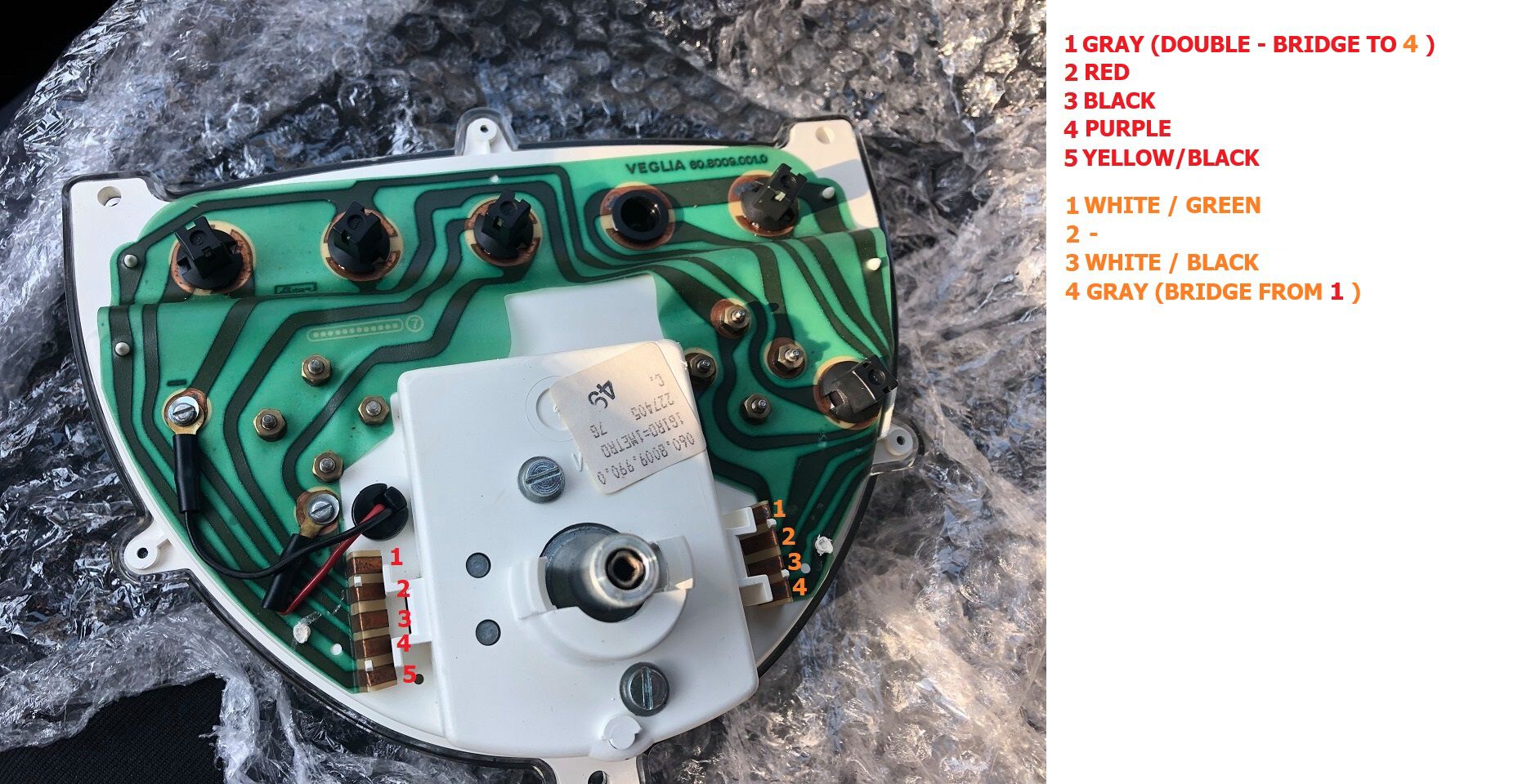

@safis avatar
Posts: 5298
@safis avatar
Posts: 5298
Hope that helps. Don't have any photos from the bottom plugs though...
