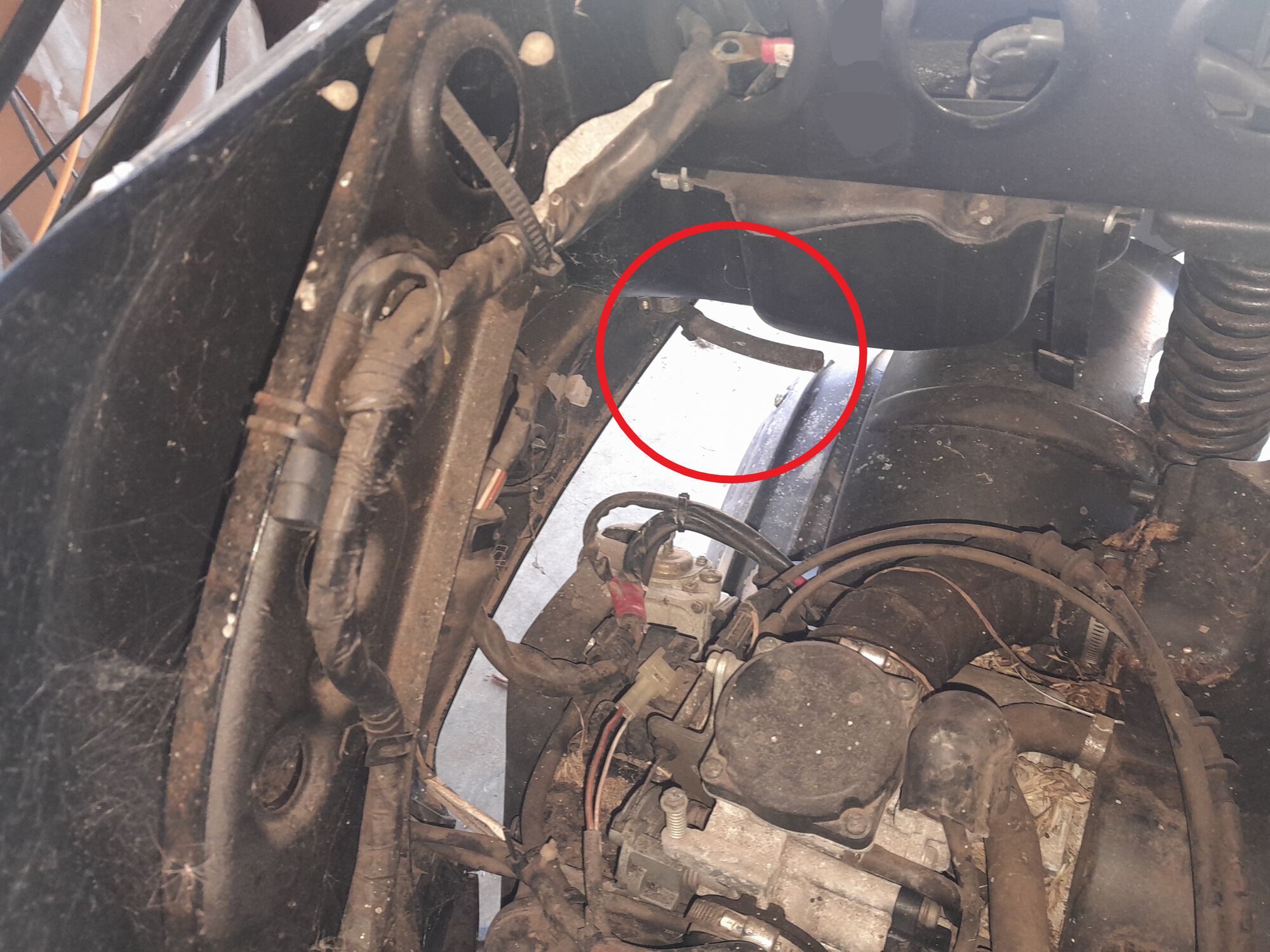

I'm currently trying to get it up and going again but worried about a 2 things - an electrical cable and the (broken off) fuel line (cream coloured hose) leading to what I think is maybe a fuel pump or roll-over valve. I couldn't find any canister so I'm pretty sure the Vespa was sold without or partially without the EVAP system. I was just wondering what this component is.

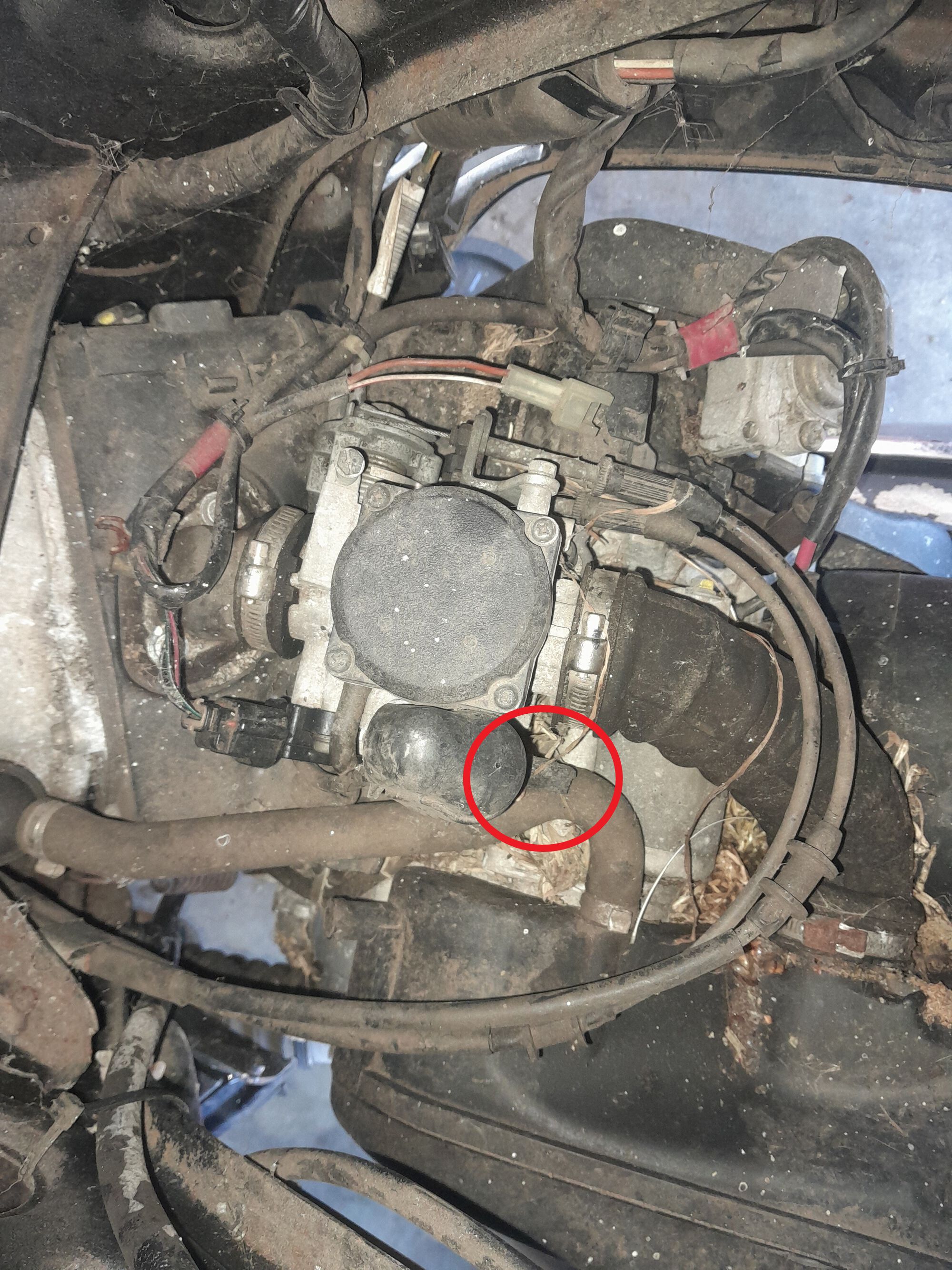

The fuel hose/line leads from the fuel tank to this component I'm unsure of, and then a (broken off) blue hose leads from the mystery component to the carburetor. All is pictured below.

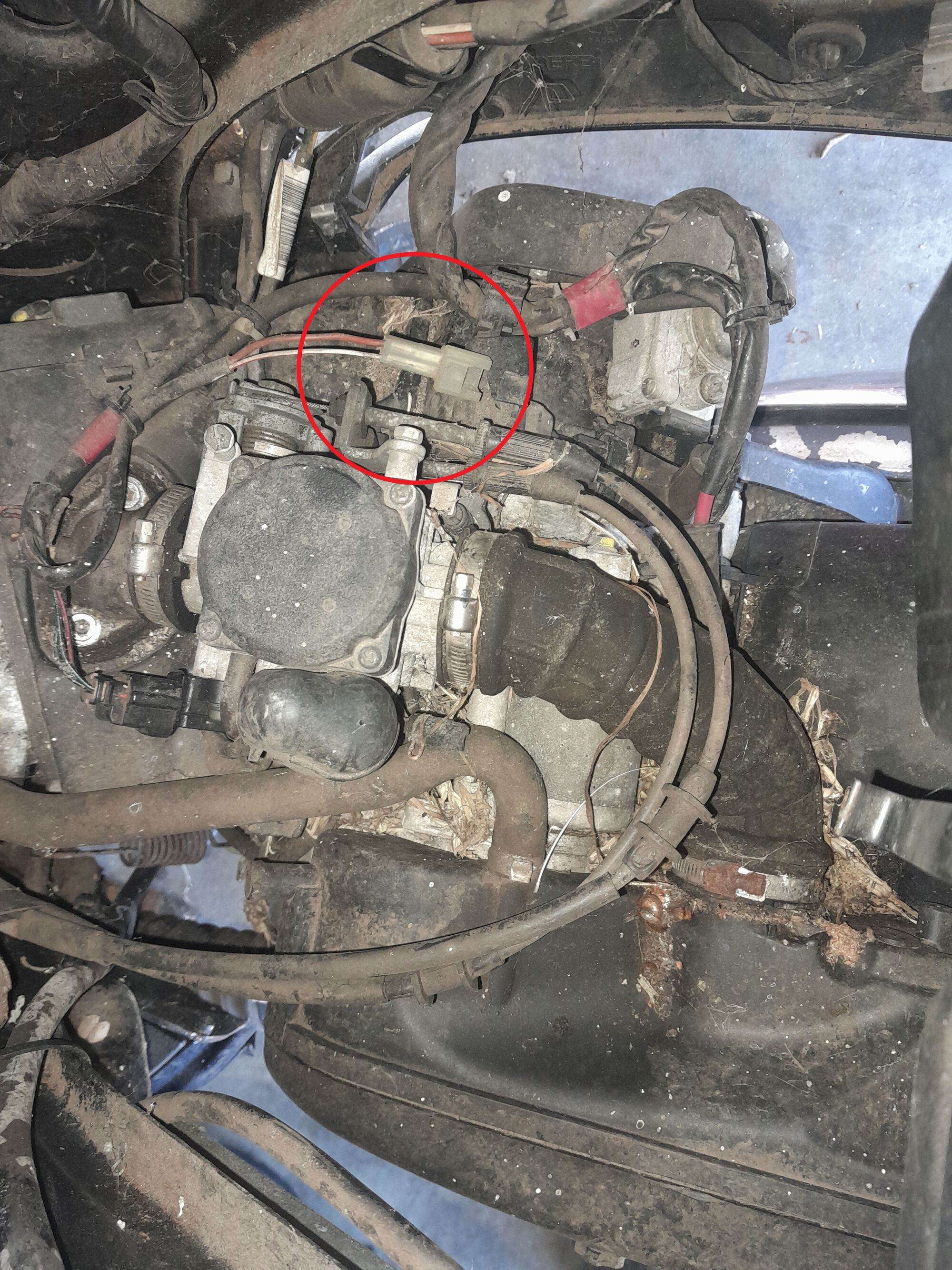

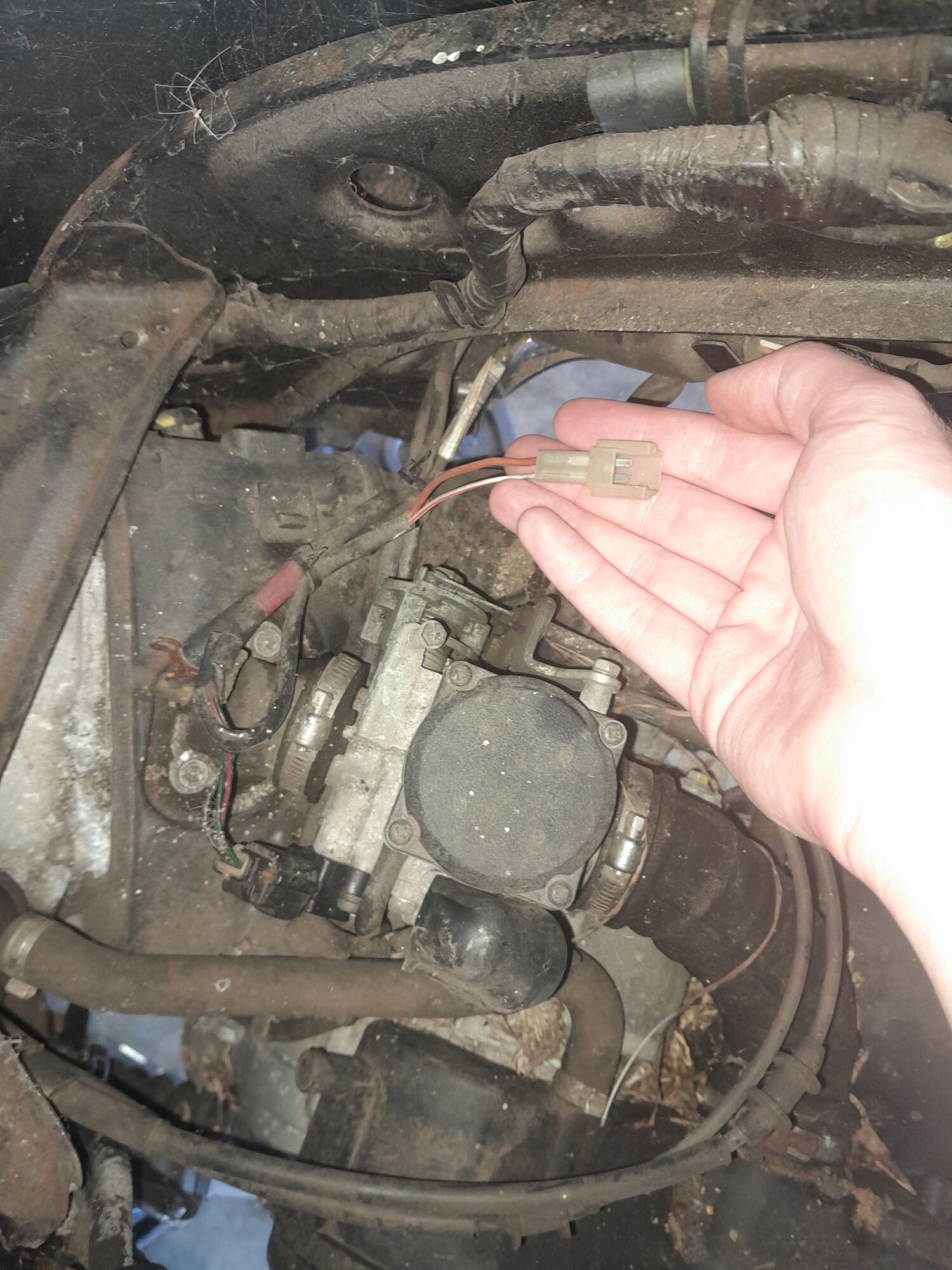

I'm not sure what this cable is for and whether something is meant to plug into it (I haven't been able to find anything that can be plugged into it)
Here is the cable circled (it's a very dirty engine, I know :()
Here is the broken off fuel hose

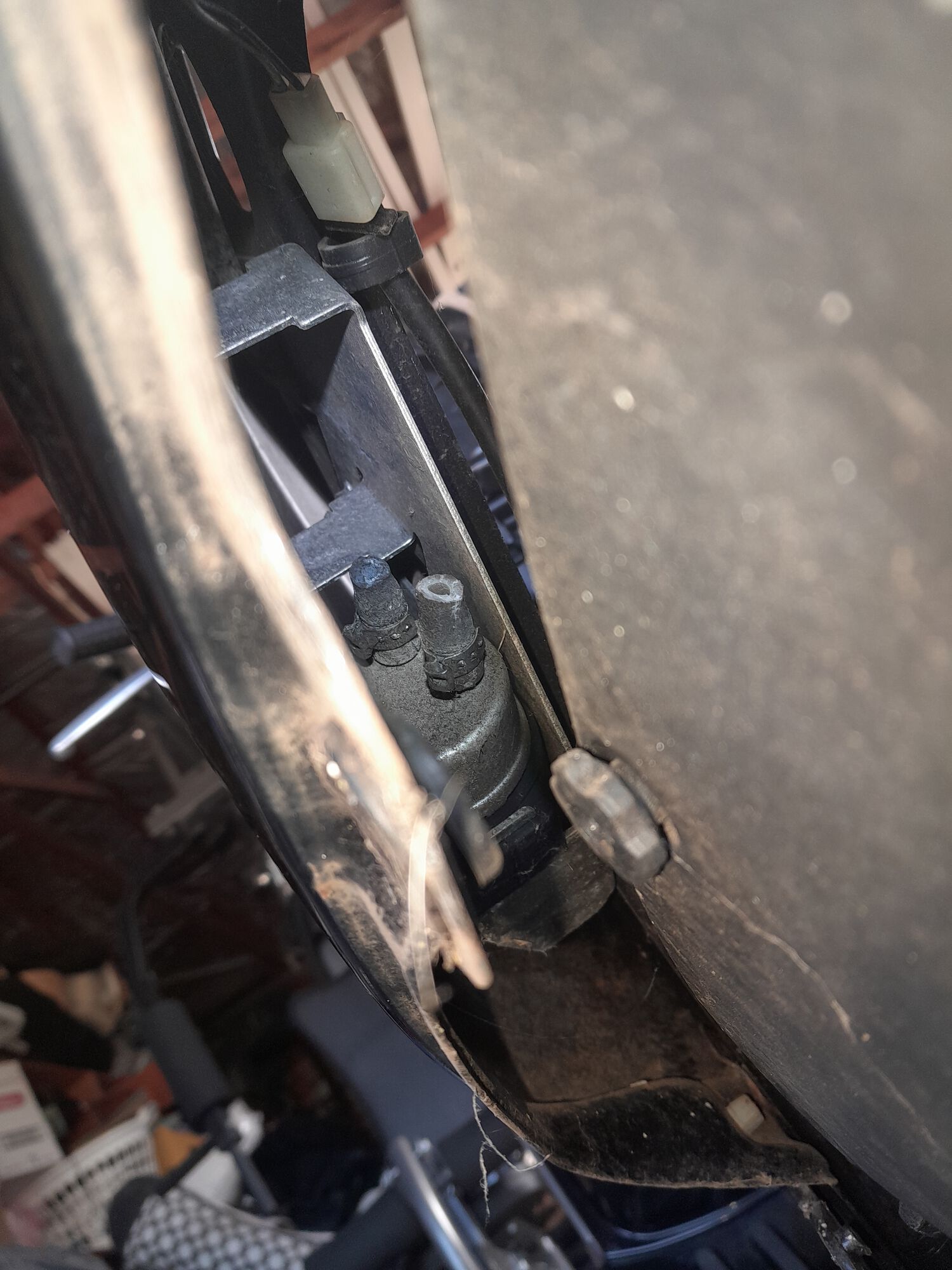

Here is the component that I'm unsure about, the cream coloured hose comes from the fuel tank, the blue coloured hose leads to the carburetor. The component is on the left side of the Vespa.
This is where the blue hose leads to on the carburetor

the electrical connection you are asking about is the autochoke.
the canister with the two fuel lines is the fuel pump
replace the two fuel hoses, then wash the bike/engine with a garden hose. Let it sit to dry for a few hours (likely water in the sparkplug cap).

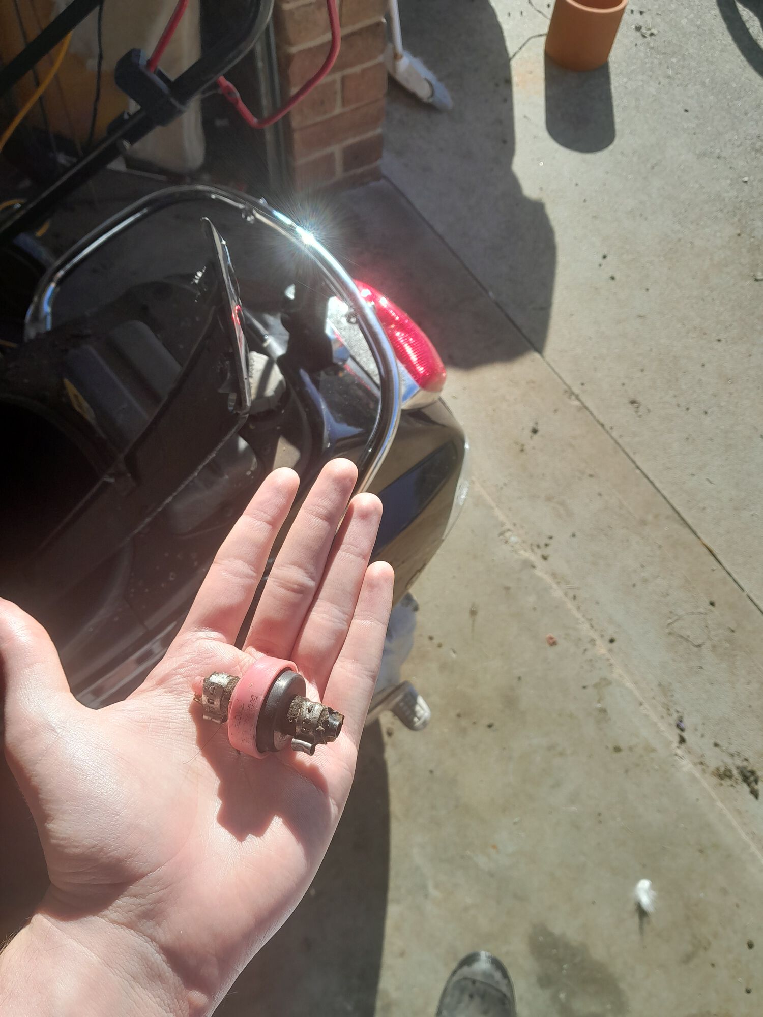

Great, thanks for the reply. I also had just one more question about what this piece is that was found in underneath the Vespa when I moved it. It's pictured below:

Looks like a filter of sorts. Perhaps it went in the vacuum circuit between the carburetor and the fuel tap?
tank overflow/vent valve.
hose from tank near the filler neck -> that valve -> hose that hangs down near the bottom of the bike
