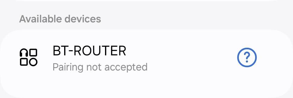

Hi all,
Just picked up a Supertech but I'm having trouble connecting it via Bluetooth.
My phone can see the BT-Router, but it just won't connect. Has anyone else had this issue?
Here's what I've tried so far:
Reset the pairing on the bike
Restarted the phone and attempted to connect again
I believe the TFT display should show something like "Ready to Pair," but nothing comes up.
I've also contacted Vespa – they gave me an email address, but I've sent three messages over a month with no replies. I called my local Vespa dealer, but they seemed to think I was doing something wrong. They charge £90 an hour to look at it and have a four-week wait.
Could the Bluetooth module be faulty?
Thanks

Some progress....
I disconnected and reconnected the battery. I am know can connect to the app and see all the live data from the bike but I still can't connect to BT Router.
I also get a notification in the app saying that navigation is not supported by my bike. There is also no phone icon on the bike.
It seems happy to send data but not receive it

What do you mean by BT Router?
Apparently it's the name of the device in the app. See the screenshot in the first post.
… or it isn't? Could it not be the Vespa but another device that's in Bluetooth range?
In this generation (2nd) of bluetooth in vespas the bluetooth name of the bike is BT-ROUTER . stupid name don't expect quality.
first gen was called PMP and current generation (3rd) its called PMP3:1234 (numbers vary per bike).
so why is router part of the name? because bluetooth helmets can be directly paired with the bike. then audio (music/phonecalls) can be sent from the phone to the bike and then the bike sends to the helmet. think this is so the joystick on the bike can directly contol the phonecall/music without needing the app running. ie the joystick can act like the buttons on a classic set of bluetooth head phones

Just an update for you all, had a bit of back and forth with Vespa, I even pointed them to this forum but they have come back with this...
"Apparently the BT module installed on your vehicle is not the correct one for the specific vehicle.
Sadly it's not possible to reflash it with correct one without unlocking the diagnostic tool.
At the same time, accessing the unit for replacement is quite time consuming for the dealer.
Please let me know your reference dealer and I'll check if we can arrange a guided procedure for forcing reprogram and organize a session when you bring the vehicle there.
