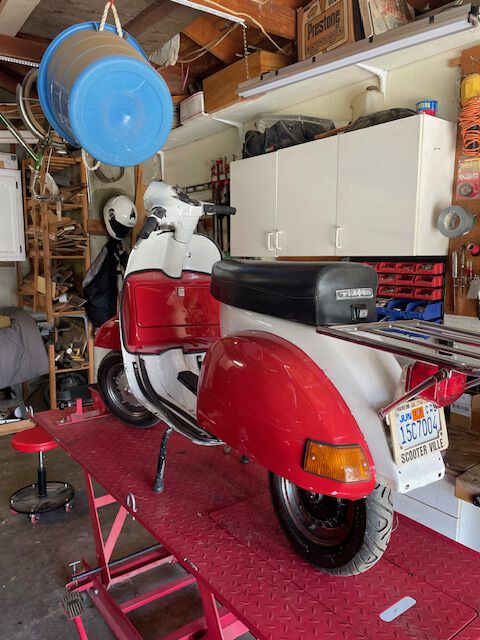

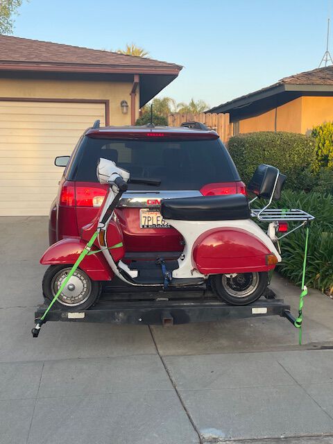

That's what my wife is calling me now that I found yet another project scooter. She might be right since I'm discovering a lot more issues than I anticipated when I saw the ad for this 1981 P200… or maybe a 1980, depending on who you ask. The $1300 asking price was within my budget but when I found out that CA DMV wanted $800 in back fees, I told the seller that I was going to pass, but he countered by offering to GIVE it to me just to get rid of it. I told him that I couldn't do that to a fellow Vespa Guy so I gave him $500 cash instead. I might have been a little too generous.
I've decided that I am going to make this two separate projects starting with the Engine and tackling the Frame later on. Actually, it will be three separate projects with the third, and the most difficult, being dealing with the DMV. Wish me luck.
Home from Sacramento
Looks OK
Looks OK
Now the work begins
Now the work begins
Posts: 10338
Posts: 10338
If That's got a 200 motor in it. I'd pay $500 for it all day every day. Hopefully the DMV won't be too big of a headache. Congrats..

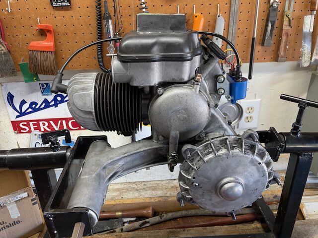

This scooter looks like it's going to be a real beast to work on so I was thinking about calling it Quasimodo, but since it's the 4th scooter in my garage, I'm calling it QUADsimodo. It seems to fit.
Posts: 10106
Posts: 10106
Popcorn emoticon
tap tap tapping my fingers, waiting to see if this mighty P200 engine will run. I wouldn't be able to wait long for at least a quick initial diagnosis. First I'd wanna just kick it over a few times w/ the key off and get a feel for how the compression is doing.
Then probably pull the plug to see what it looks like and next kick it over some more and faster, listening for any unhappy noise. Now maybe try the gears rolling it around while onboard, again listening for bad sounds or rough shifting. I'm roughly testing the clutch as well.
Now to check for spark as long as the plug is out. If it passes all these tests I might wanna see if it might even fire up. I'll worry about the carb later, just a spoonful of gas down the venturi should get me where I wanna go - IF I haven't screwed up! I get such a thrill when something once dead can roar back to life even when there's still much work to be done.
But it's your bike so you do it your way,
Popcorn emoticon
and good luck w/ the DMV.
Also, I don't mind the paint job at all. Maybe somebody even paid a pro.

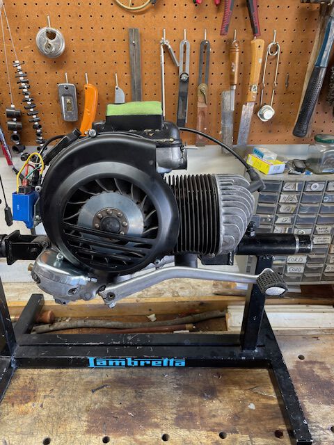

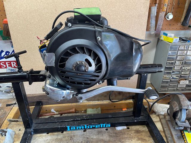

Yes, I ve finished rebuilding the engine (almost) and I think I'll post it for sale later today…. But for two days only.
I'm going to be in Pasadena this Friday and Saturday and if someone in SoCal wants to buy it then without my having to ship it from Fresno, I'll do a deal. I'm missing the bracket that holds the CDI and if I don't sell it this weekend, I'll order one and then repost it but adding shipping from Fresno…. Which will probably be pretty expensive
Rebuild includes seals, cruciform, carb, and truing crank
I'll be posting it for $1500

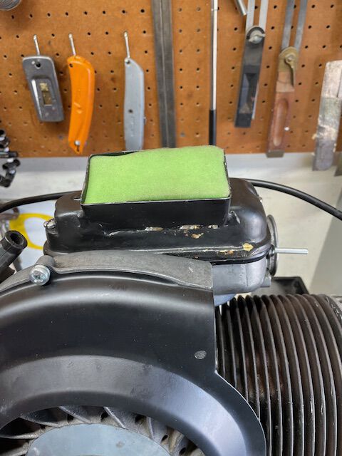

I'm missing a carb box rubber, the spark plug wire and the CDI bracket but I'm going to take the engine with me when I visit family this Friday and Saturday in Pasadena. If someone wants to buy it "unfinished" they will save shipping from Fresno. I'm thinking there are more potential buyers in SoCal than in Fresno
I've posted it on Scootnet2 for $1500

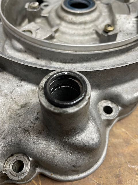

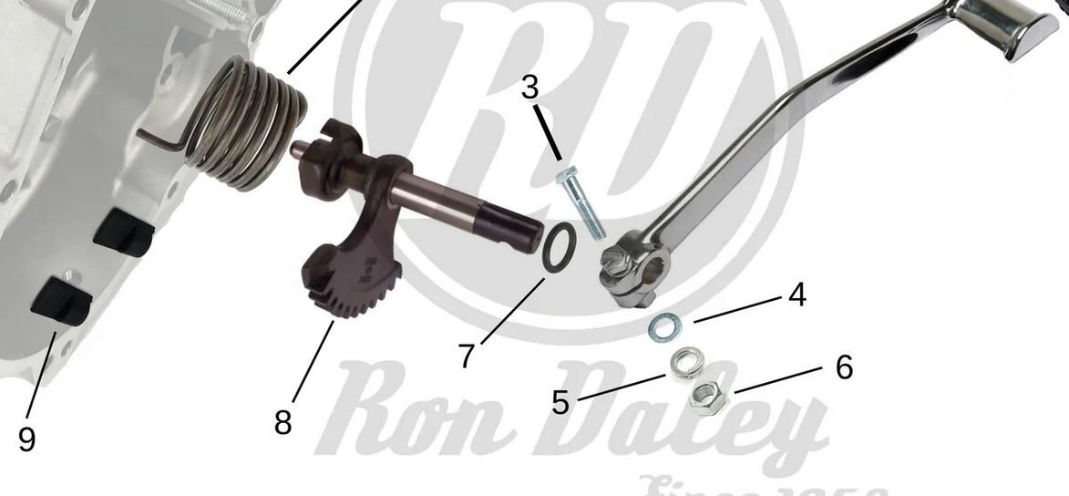

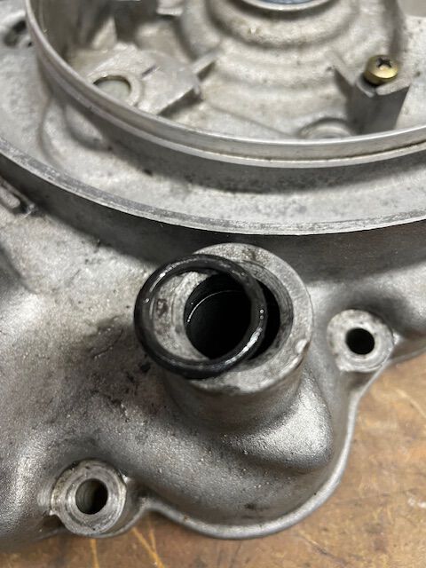

Is there a trick to this??
I need to replace the O-Ring that is in the hole for the kickstart quadrant... #7 in the diagram?
I bought a new one and I can't figure out how to get it into the slot. I'm assuming it it the correct size although it looks big to me.
Can someone help please?

Pinch it together, get one side started in the notch it sits in with a small flat screwdriver, then work both sides around until it's in the notch all the way around, if you go too far come at it from the other side.
@chandlerman avatar
Innovator
Posts: 12638
Location: Nashville
189 Days Since Last Explosion
Innovator
@chandlerman avatar
Posts: 12638
Location: Nashville
This.
The real fun will come when you're trying to get the kickstart return spring back onto the quadrant.

I finally got all the various miscellaneous pieces I needed to finish rebuilding the P200 engine out of Quadsimoto and now I'm ready to sell it. The rebuild includes new seals, cruciform, rings, CDI and brakes plus various bits and pieces including a bracket, rubber and nuts & bolts. The carb has been rebuilt and Hotrod Al trued up the crank for me. The only non-stock item is the carb box cover which has been modified to accept a Hotrod Al Vortex carb. That's not included but I have one around someplace if anyone is interested. (I also found a spare crankshaft if anyone is interested in that.) I'm going to list the engine on Shootnet2, on Craigslist and here on the Forum for $1500 and see what happens. That will be the price for pickup in Fresno. Otherwise shipping and/or delivery will have to be negotiated.
I also have the shroud but forgot to put it on before I took the pics.
Text me at 559-240-6562 if interested.
Weird carb box modified to accept Vortex Carb.

Can you start it on the stand?
@fatbear5 avatar
1977 P200, 1980 P200
Posts: 1457
Location: Fresno, CA
@fatbear5 avatar
Posts: 1457
I have spark but No, I'm not able to start it on the stand. I'm not set up for that.
