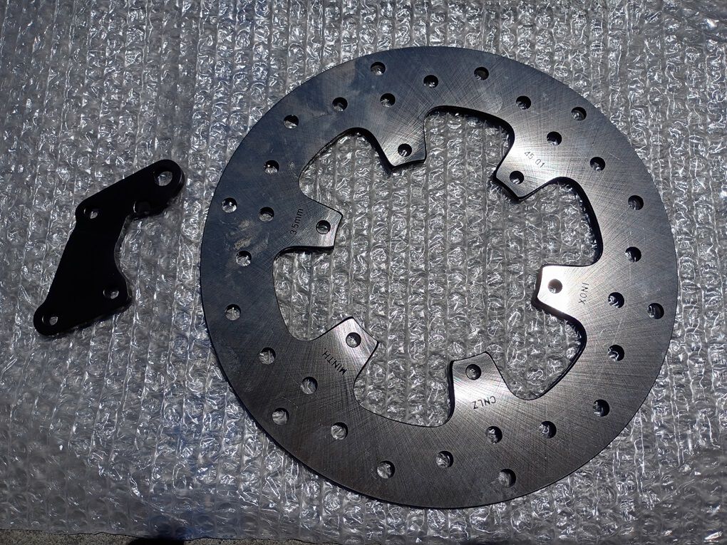

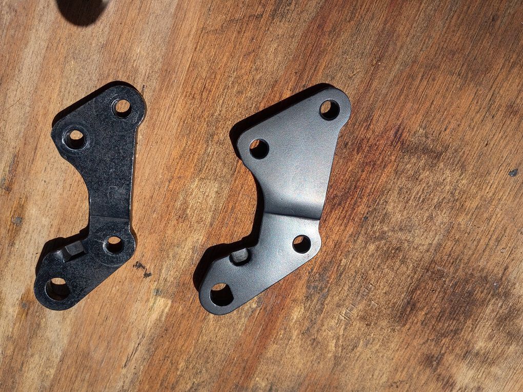

Reference thread: GT/GTS Brake Upgrade
MP3 240mm rotor and extended caliper bracket. Cut and welded 2 factory brackets for 10mm more length.

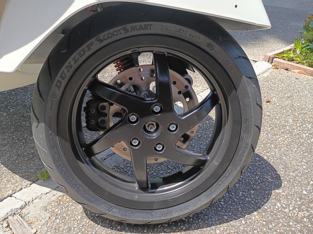

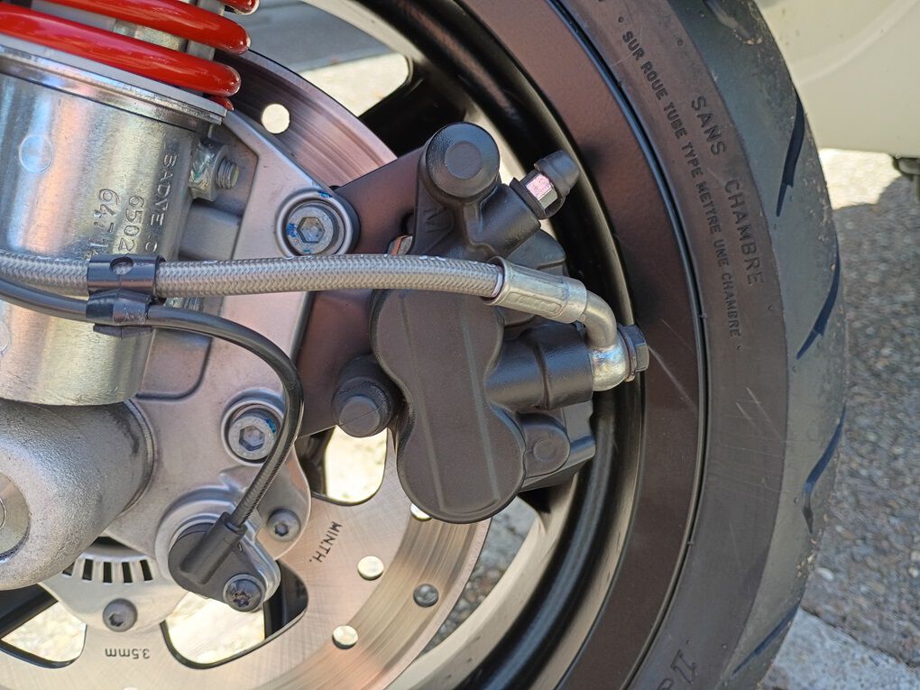

Installed pics.
Went 13 inch wheels and the 220mm rotors look tiny with the 13s, definitely more braking power too. Could be done with 12s but would have to machine the back of the caliper for clearance.
MP3 rotor is bolt on and simply swap the 10mm extended bracket for the factory one.

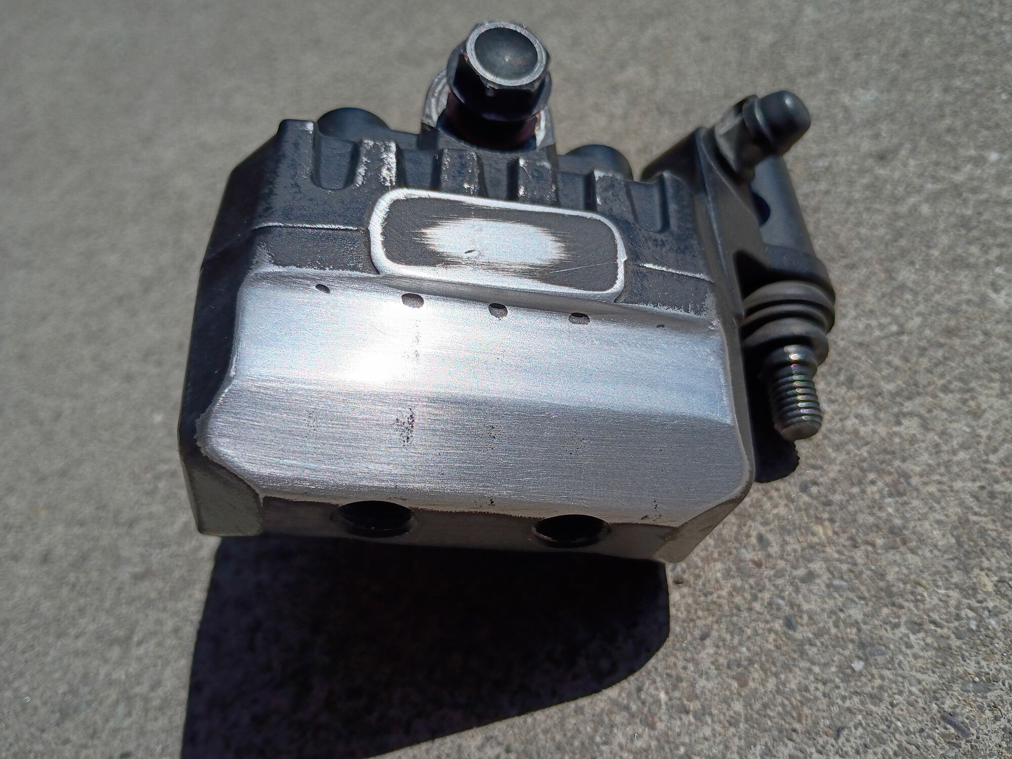

Doable with 12 inch wheels.
Have a couple spare calipers leftover from the bracket mod, thought I would show what it takes to do this with 12 inch wheels. Technically would only need to shave the corners but I think this gives a cleaner look.
With sintered pads stopping power approaches sportbike levels.
