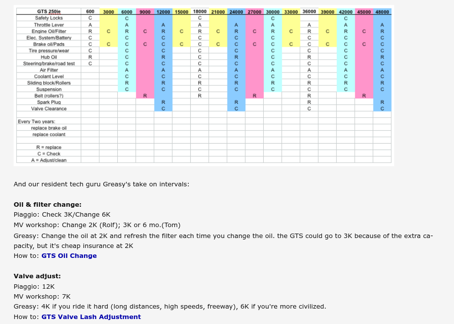

What noise do you get from an exhaust valve that is too tight?
Good point! I'll have to add this to my list of tasks during this service. Thank you for that chart, it is very helpful as I do not have a book that came with the Vespa. GTS Valve Lash Adjustment

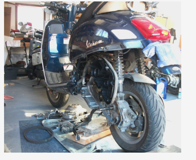

Double up scrap 2X12s under your center stand. Use another scrap 2x6 under the rear wheel. Undo the top shock nuts, and use the 2x6 under the rear tire to drop the whole assembly. Be careful of your coil wire while you are doing this. You should undo the plug wire first.
