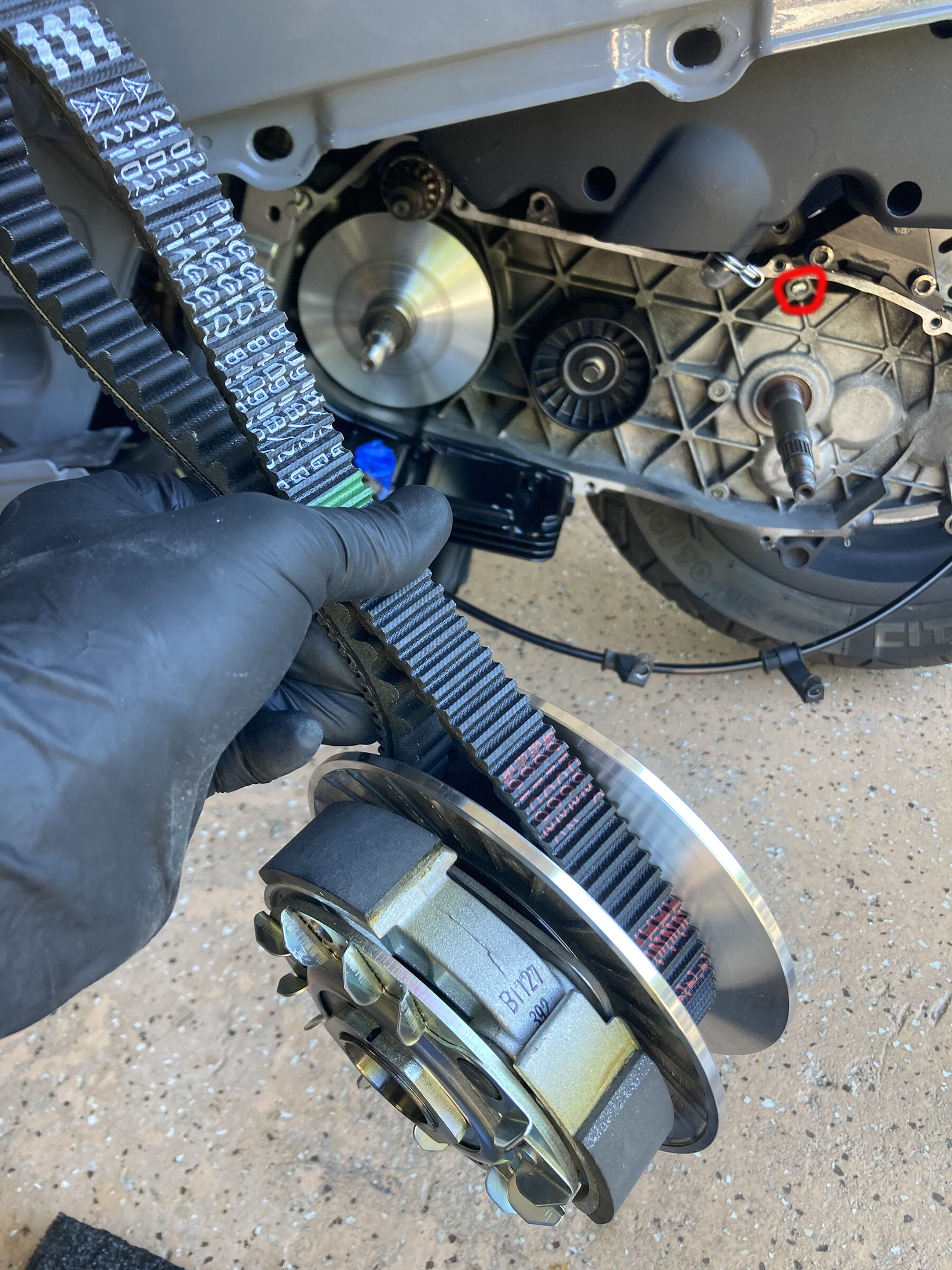

Hello,
I recently inherited a running but severely neglected GT200 with 12k on the motor. After replacing a lot of components, I finally put her together today, installed a brand new Piaggio clutch, belt and Malossi variator. Ensured the belt was half way into the clutch pulley, variator was properly assembled (with 10g rollers), torqued the nuts to spec, started the motor and I'm getting no power to the rear. Took it off the stand, added the throttle and it does not engage.
What am I missing ? Please help.
Thank you !

A clear case of an operator error.
Upon closer examination I realized that when servicing the final gear, I mistakenly installed the 45mm bolt in the upper part of the cover, instead of the 40mm one, which then protruded far enough out of the transmission case and stopped the clutch pulley from rotating. How I missed that I don't know.
I had her in pieces for the last 3 months and probably hurrying to close her up was not the best approach.
Thank you all for coming to my rescue !
