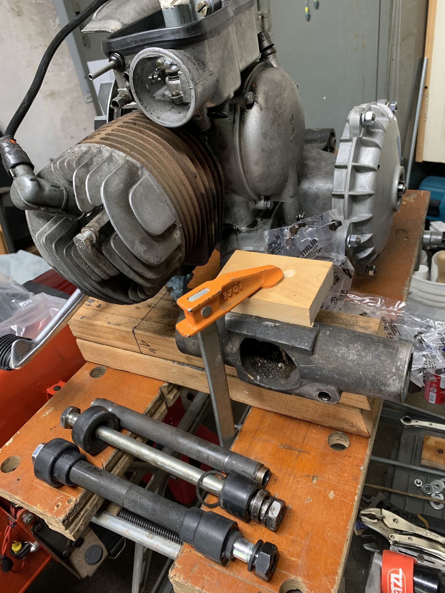

Another question.
I've removed the engine to thoroughly clean it and replace the rubber engine buffers in the swing arm.
It's got the original full length tube, two rubber buffers, and peened-on end washers. All removed just fine. There was one large inner washer on the left that the rubber seated onto. Not one on the right, which according to parts diagrams there isn't one.
I have newer style two-piece buffer replacements with tubes that meet in the middle. I do plan on taking some additional frame and old assembly measurements but is the large left inner washer needed with the new two-piece style? And I assume the old peened end washers are not needed, correct?
Thanks in advance.
Old and new engine buffers.

[With the new bushings you have all you need.
Some aftermarket need no additional washers and the old ones should all be removed.
BGM provide washers for there own and you just use theirs NOT the original ones
Zooming in on your new ones, as long as you removed all washers, install as is
Thanks for the input. Haven't found much info about the installation.
