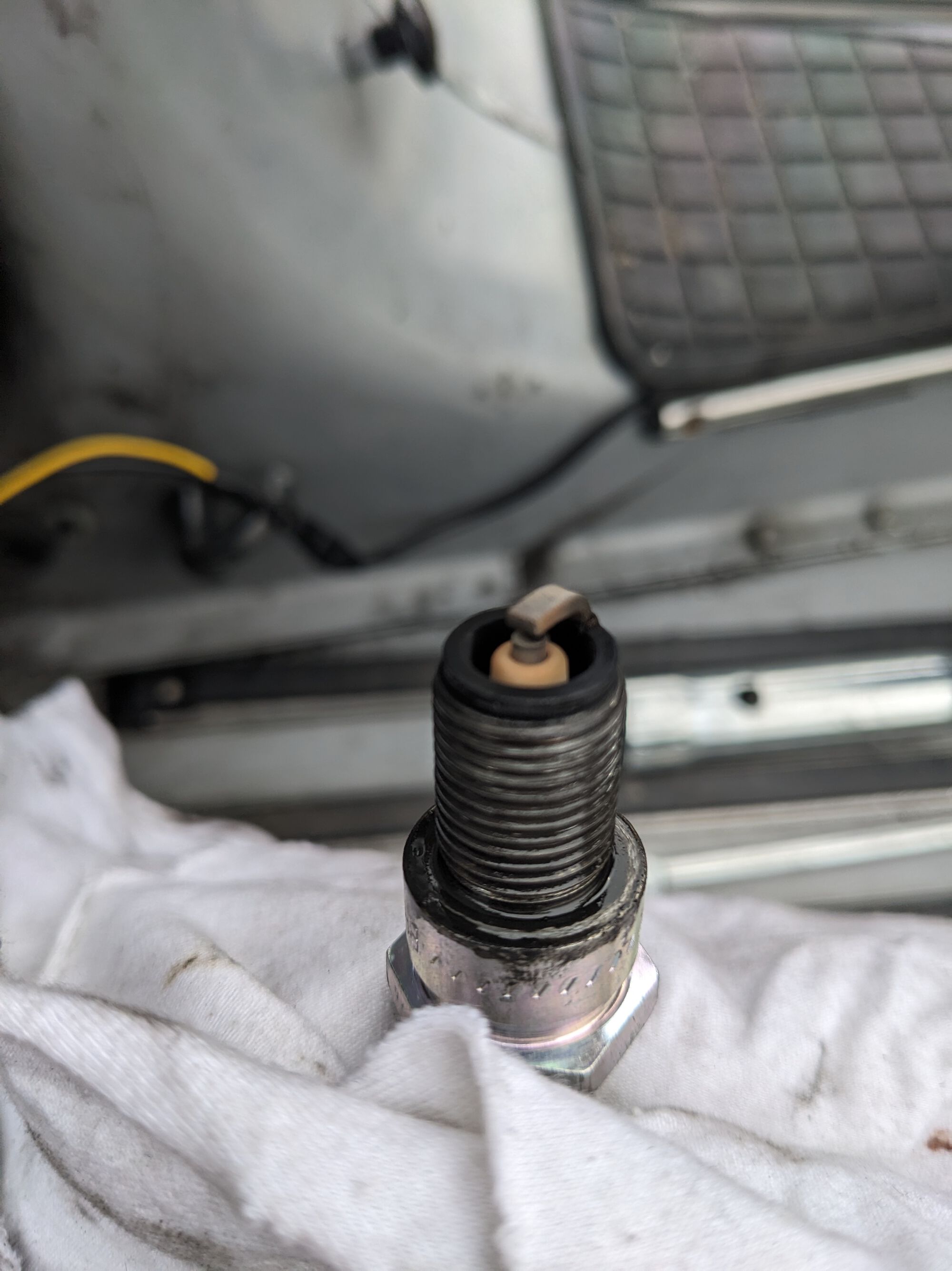

What spark plug are you using? To my eye, the one in your photo reads a little hot.

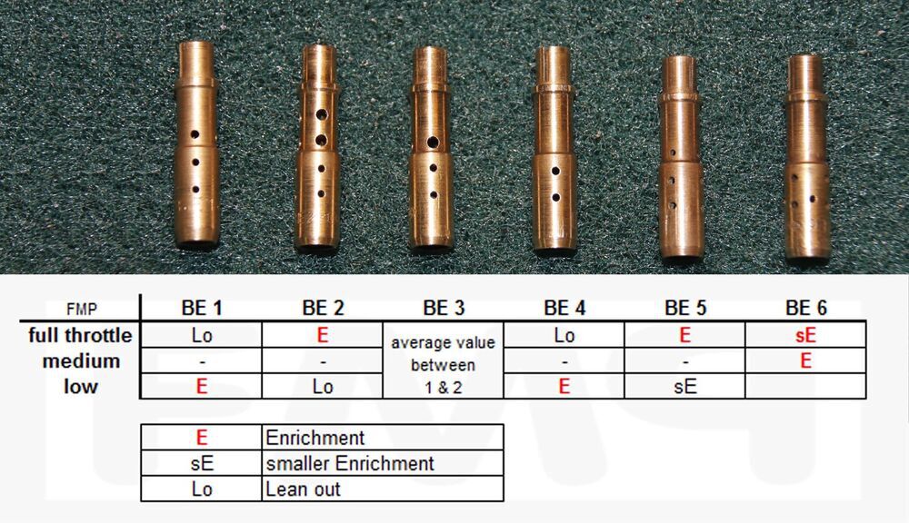

Maybe it is worth to try BE3 ?

Plug is a BR8ES. Just changed my main to 115. So currently running 120/BE4/115. Cruised right along at WOT, no surging/bogging. Never even hit 250f.

That is the correct plug.
I am surprised the AC120/MJ115 combo is not too rich. Are you doing the WOT splutter test in 2nd gear? Because of wind resistance, you won't reach max rpm in 4th, and possibly not in 3rd either.

Its definitely rich. After I start her up for the first time of the day, It splutters quite a bit though the gears until it warms up. If I remember correctly, I think they give you a 105mj, and a 115mj in the kit. Im guessing the answer is somewhere between the 2.
Edit: Just did a plug chop with 120/be4/115, and brought the plug to the scooter shop. Slightly lean. Went back up to 118.
