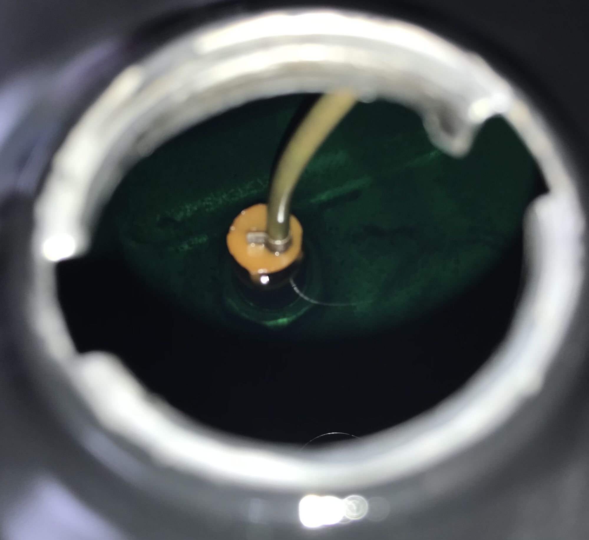

I didn't think about fuel level when i did the exercises yesterday. I took a look today and saw that the fuel rests just above the filter screen housing. Could this level affect the results?

Here is a pic of the fuel level i had.

FWIW.... I just set up a small tank and ran gas through the needle seat in an SI bowl cap and got 500ML in 2 minutes ten seconds. One liter /four minutes 20 seconds. Through this restriction, that is about half as fast (twice as slow) as your stated rates. I don't see the tap as your problem. Blow some air back through it in the tank if you like.
I could see a situation where the level in the tank is just about at the top of the "run" tube as in your picture and maybe intermittently supplying fuel and how turning it to reserve would take care of that. But just riding around and making the motor run livelier by switching to reserve makes no sense to me. "R" for "Race"?
One thing that bugged me when I did my SS is that the bottom of the tank is just about level with the fuel banjo on the carb. Checked with a laser. The SS/Rally tank is taller but not any deeper.

Moto64.
I might try blowing air back into the tank to see if it dislodges anything?
It seems like you stated, the bottom of the ss tank sits around the bango, isn't that where it should be?
I didn't measure with a laser (I eyeballed with a measuring tape) the height of the p200 tank and it's about the same as the ss tank. Like you said, the ss tank is a little taller on the top side, but same at the bottom. I'm debating weather to try out the ss tank to see if it flows better...

Update...
I proceeded to blow some air up the gas line while switching the lever from off to reserve and back. There were air bubbles coming up from the screen filter (note, the gas level was still the same as before). It seemed that there were more bubbles coming up when it was in Reserve position.
I then added about 4L of fuel to the tank and proceeded to retest the flow. This time it seemed better:
.5L @ 35 seconds flat
Also, when i opened the valve, i could rear some "gargling" sound from inside the tank.
Does this seem better?
Fab

It's better yes
BUT
Whatever you blew out as a blockage will be sat behind the filter and would eventually work it's way back to cause a blockage all over again.
You appear to have proved the blockage was evident in that area at least
