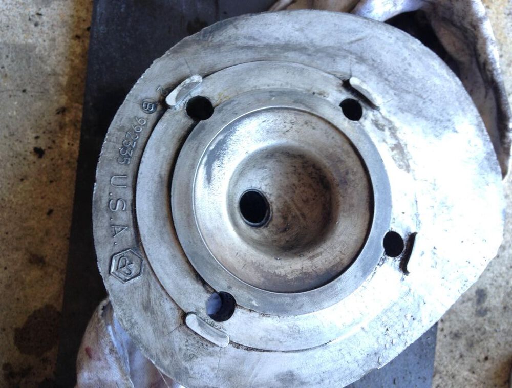

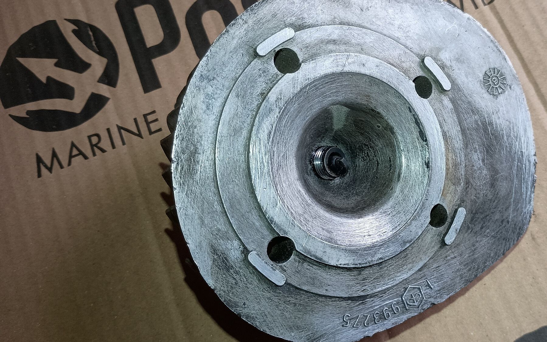

Nelluch125 wrote:
I read that some US market p2s were designed with "emissions" in mind so that they sold them with a larger squish band and a 20mm carb.
A little off topic maybe, but I don't think 3.2mm actually counts as squish! Not squishy enough from what I've read.
Seems to be 2 different 200 heads. Not sure about compression differences as no one measured the volume in the thread, but the raised portion is quite different in these two photos (from here P200 'USA' cylinder head mystery

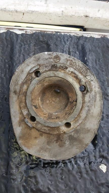

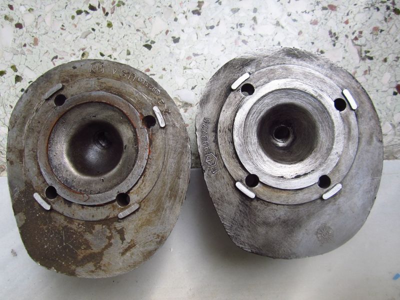

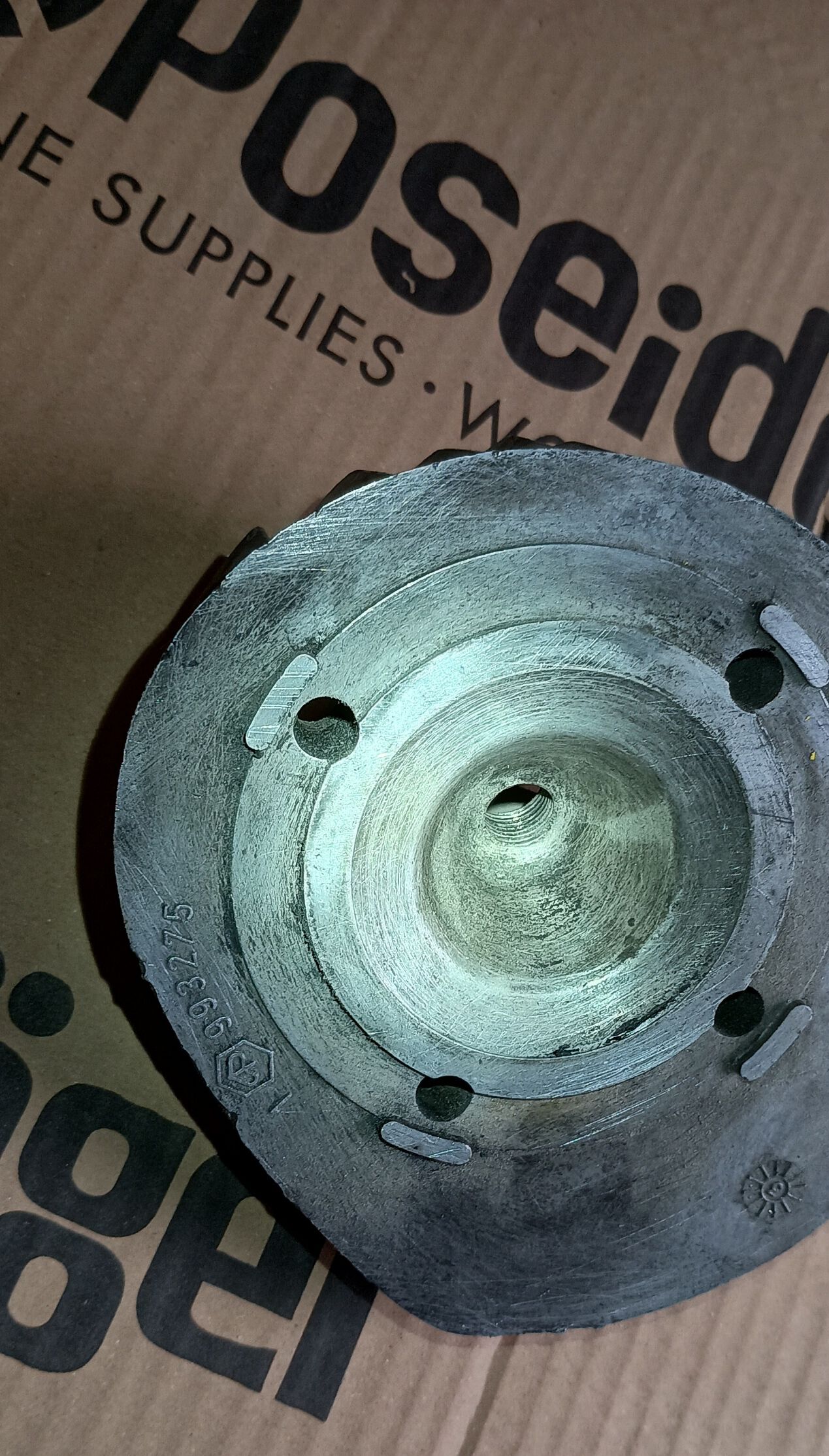

The mystery deepens w/ another look at that head that came on top of their exclusive Cosa II nicasil lined aluminum cylinder. Can somebody please try to explain???
V oodoo wrote:
This is strange, but out of 4 stock P200 motors I've dealt with here in Greece, I think 3 of them had the 'USA' heads as well. I pulled the head off of the Cosa II motor I have here and it has no 'USA' on it and you can see the main difference seems to be the location of the spark plug.
Cosa head is on the right
another view, see anything strange?
It takes the SHORT plug, like a 150! Here is a long plug installed.
