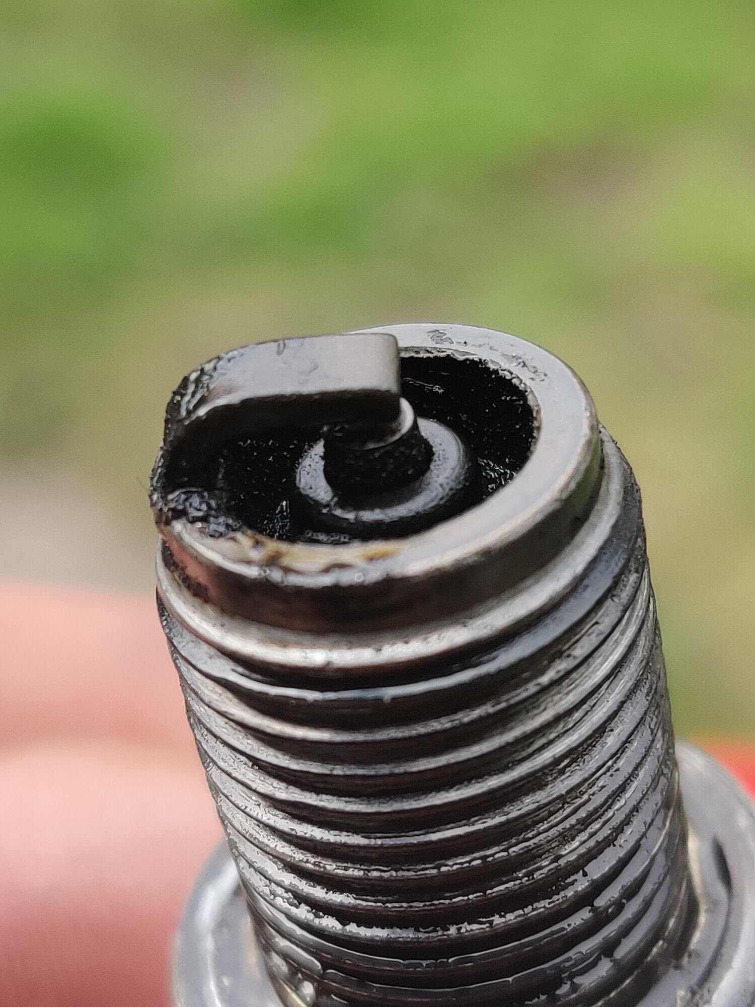

The spark plug is B9ES. I attached a photo of how it looks. It's not a plug chop.
Oh dear, look at that. If the engine is not damaged, put the jetting as Safis said. Plug 8. Timing 16. And then it will start to run correctly.

16 degrees is very safe. I run my t5 at 18 degrees and that's with a 54mm crank and MMW head. I had a hunch you had the timing too low.
As stated by others, use a B8 plug and get rid of that idle jet for a stock one. That plug is so fouled I'm surprised it runs at all.
