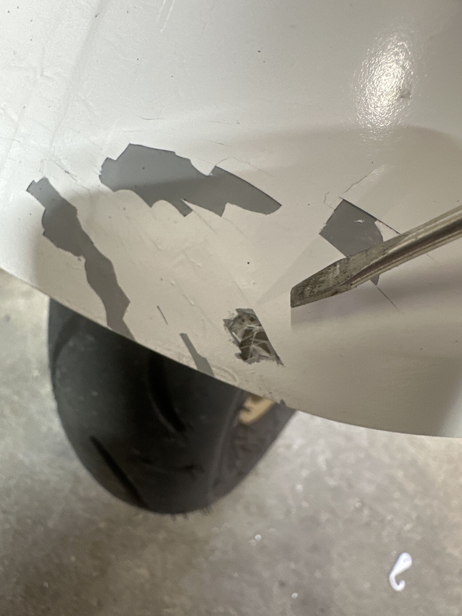

The fiberglass at the back is coming apart. The paint just stared chipping off about the same time.
Also have a crack at the top that formed about a year ago. But that might just be the paint.

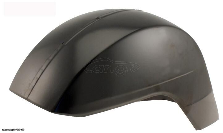

Shame you are not in Europe where there are a lot more PKs and parts for them. The older PKs had steel fenders before they switched to plastic on the XL2s. Here's a new one for only 38 euros at https://georgakopoulos-moto.car.gr/parts/view/11415165. You could also try Kyle in Texas, he has some old PKs and may be parting one out. Your disk brake setup could be an issue. Got some pics? You sure it's not a PX fork?

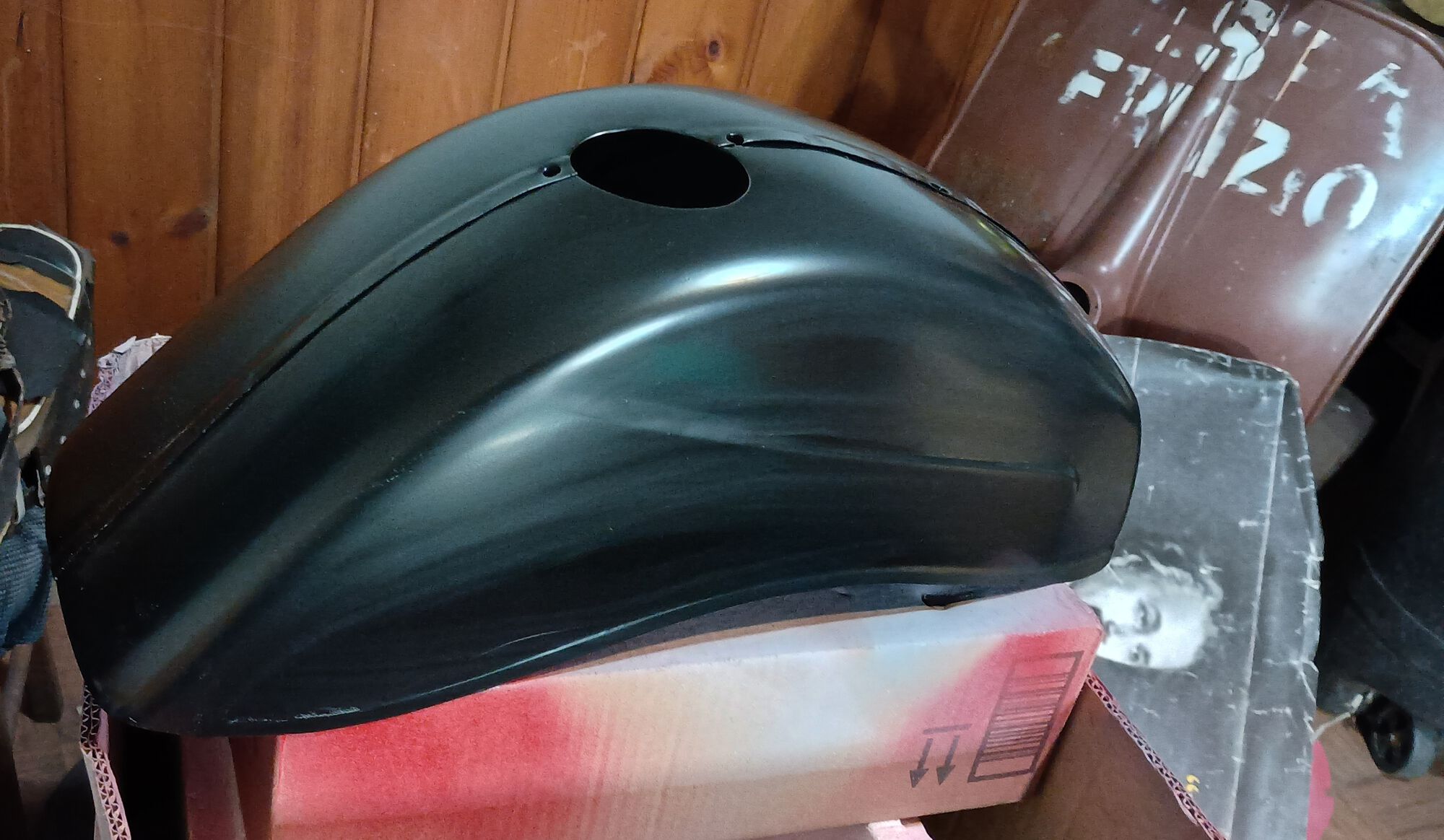

You could try a Super fender from Mercado but no plug & play obviously. Looks like this - no smears on the side, those are reflections. https://www.scootermercato.com/Scooter-Parts/Fenders/100820
And it does fit a 10" tire nicely.
