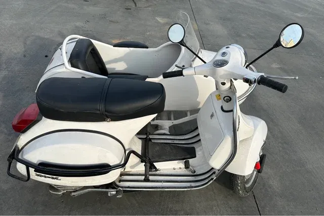

The total width of the PX200 combination is only 1.39 m. which is less than twice my P200E so easily within parking space of two Vespas.
Track width 1.045 m.
