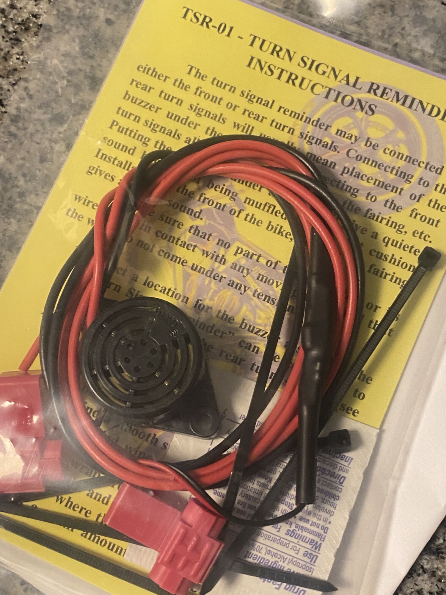

I got this in the mail. Thanks for the suggestion. I'll post more when I get the nerve to install it.
