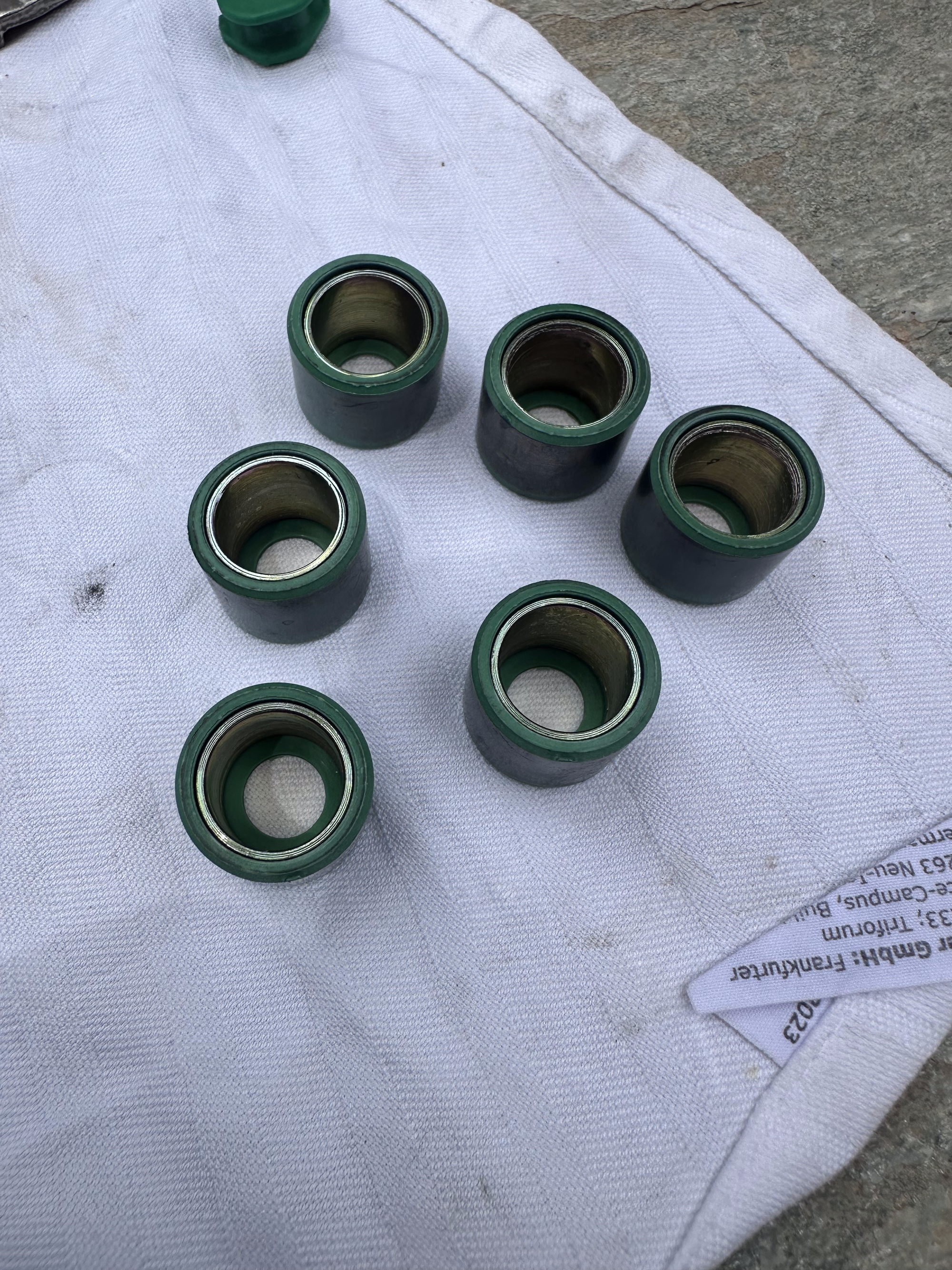

At the same time, I would like to share some observations with you, to see if helps at all. First of all, the new rollers that came with the variator, are completely open on side, as opposed to the old ones, with one side plastic, the other side metal. Could this be a "characteristic" of these new rollers?

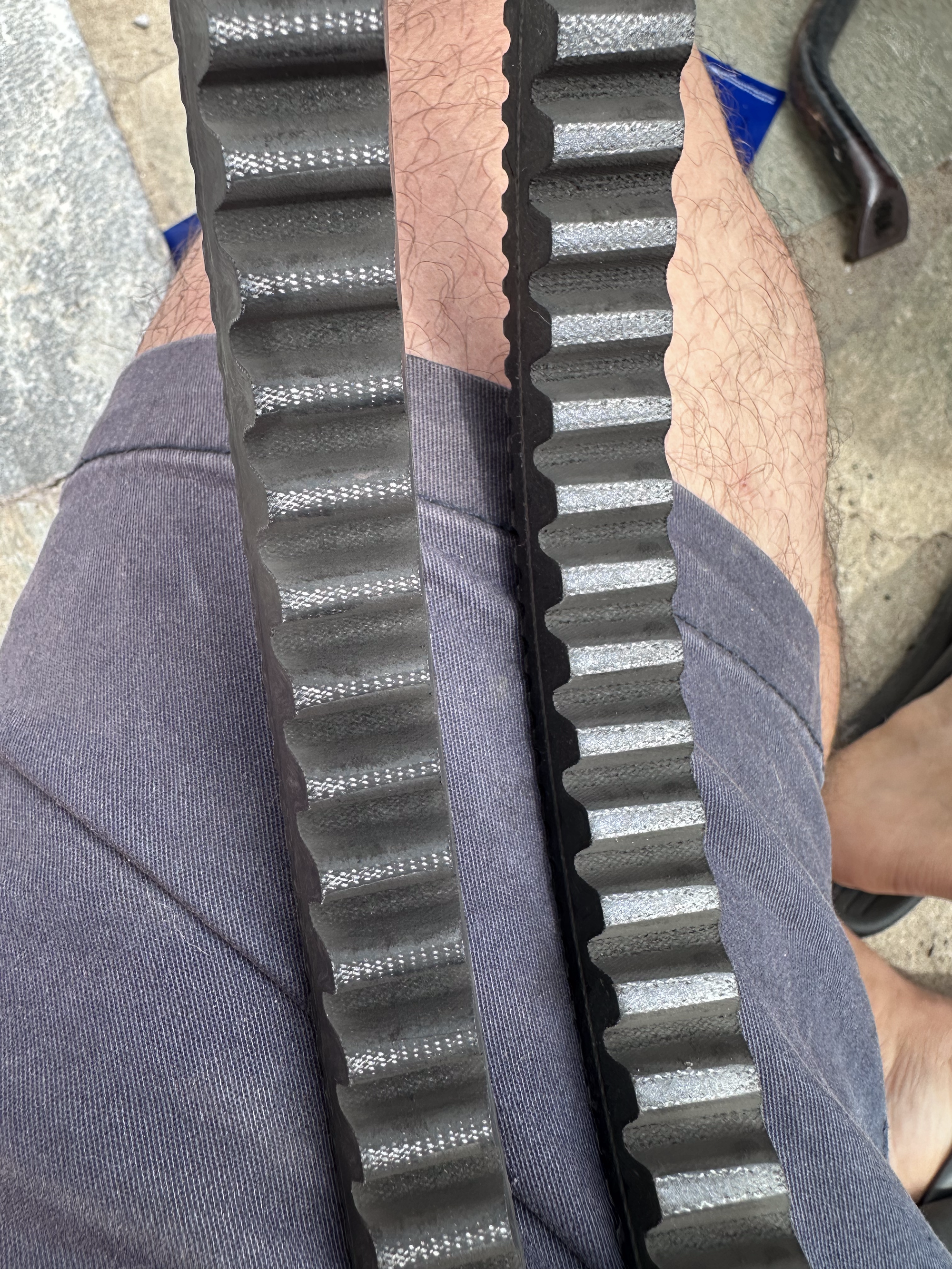

The picture of the belts, the on the right is the new stock Piaggio belt and the one on the right is the Mitsubishi one that nearly ran 20000kms and still going,. The new belt on the left is only approximately 250kms old and I felt that there was so much wear on the tips of the threads. Could this be caused by any faulty part of mistake from my side in installing? I feel I might have a bit over torqued the variator, so would it cause problems like this?

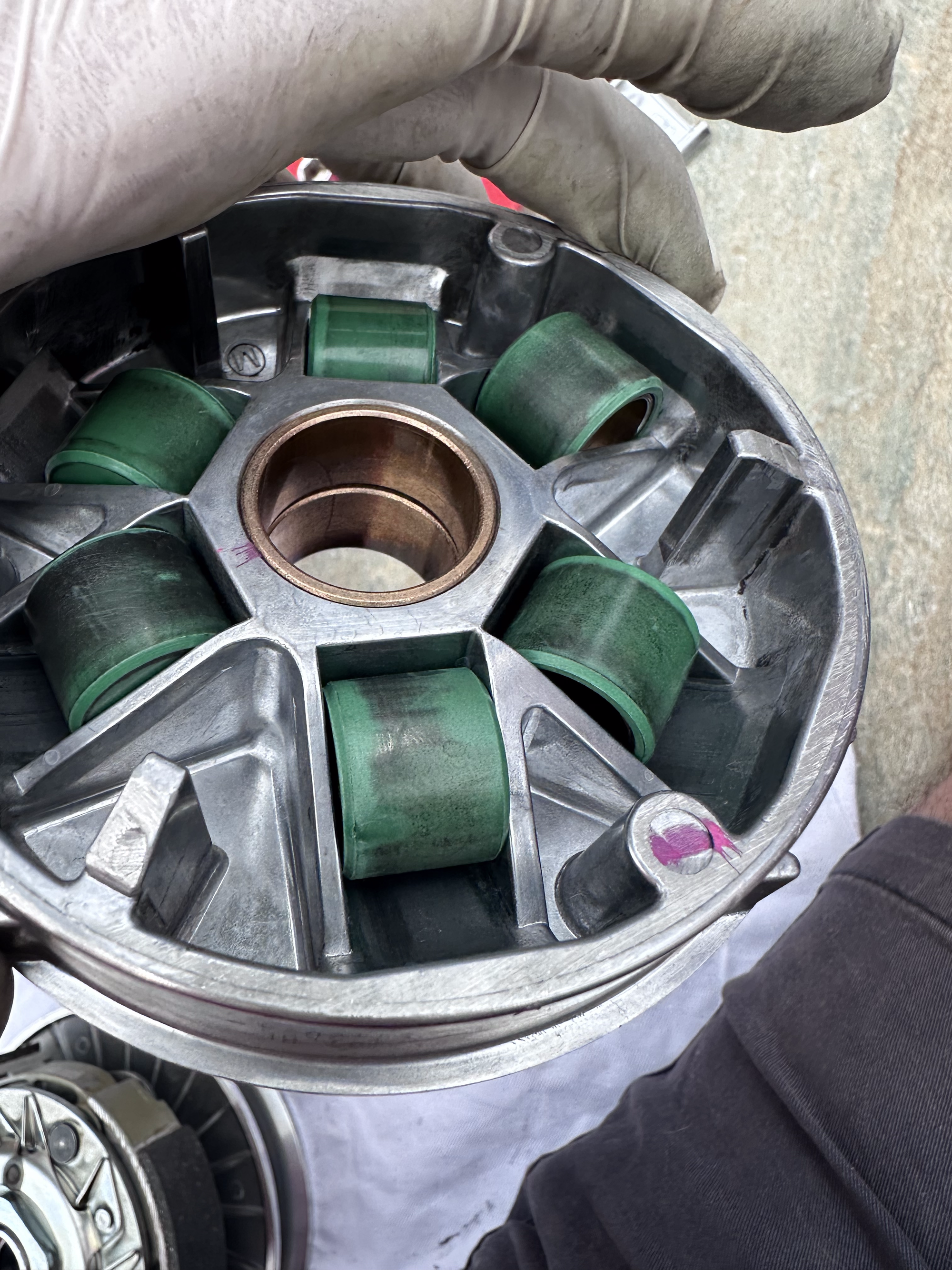

I added a picture of the variator with the weights, just to be sure, I installed them correctly, now that the spec is changed, I was very confused about the direction of the rollers.

The new stock Piaggio belt on the left, only after 250kms with excessive wear? The one on the right is the Mitsubishi, nearly 20000kms.
The new stock rollers with one side completely open.
The new variator and the direction of the weights. Hope it's correct :)

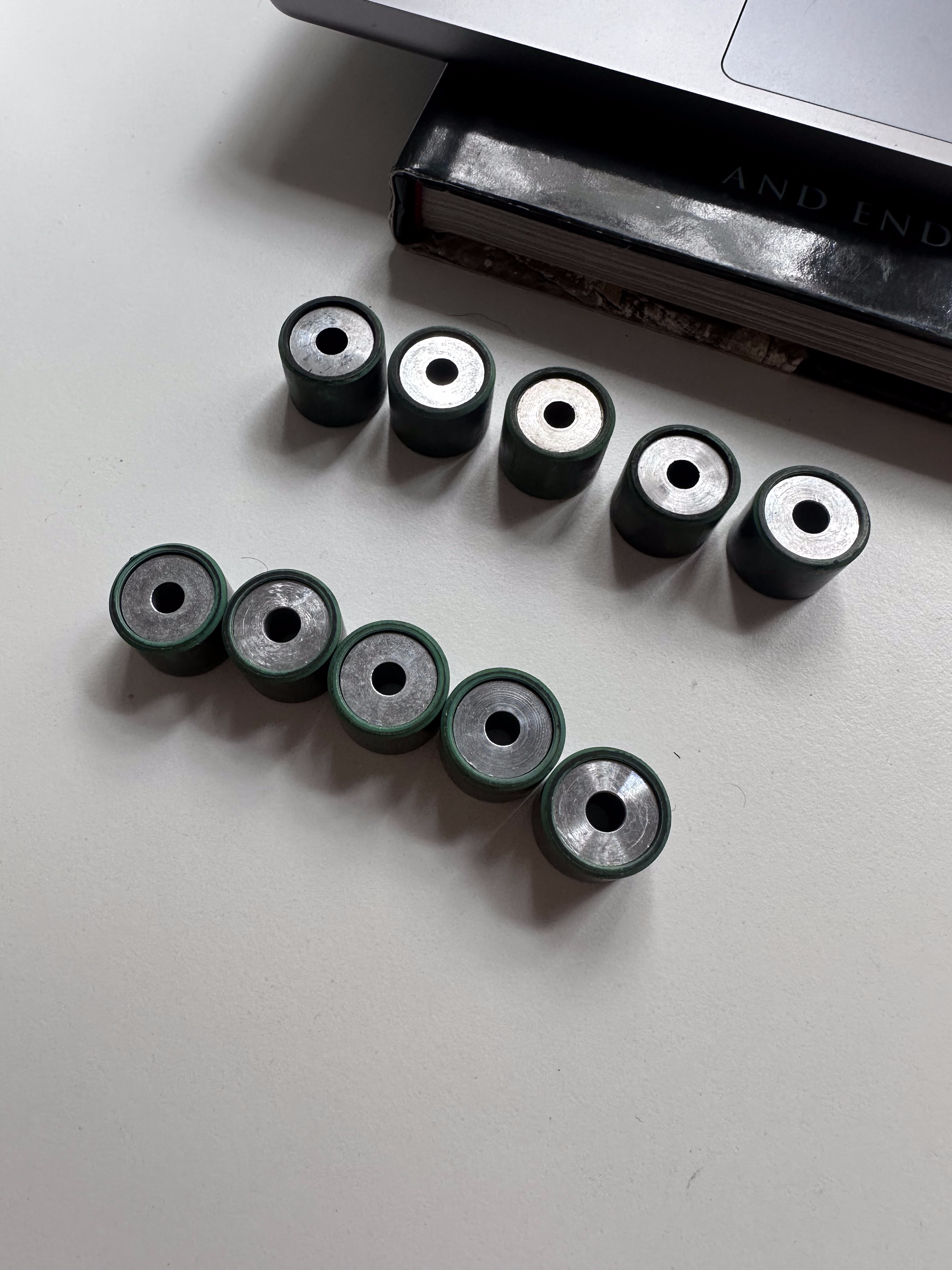

The old rollers
The old rollers

The direction of the rollers of the variator is correct. The weight of the rollers is the same as the old one?

Geia sou Xristos, the rollers are 11grs, with +/- 0.1gr variations, but never less than 11.
This I know, because I have three sets of rollers, 1 set very old, 1 set one year old and one year brand new. I measured them all with my coffee scale, to see if the wear / mileage actually makes a difference in weight, but I don't think so.
Have you had any luck figuring this out?
The belt wears along the v-sides. So I don't think the ridge tips wearing would be anything related to variator torque.
Does your bike have an idler pulley? Is that in good shape? Rotating freely? It's the only part I can think of that might contact the belt tips

The internal Ridge tips do wear off from normal use.
