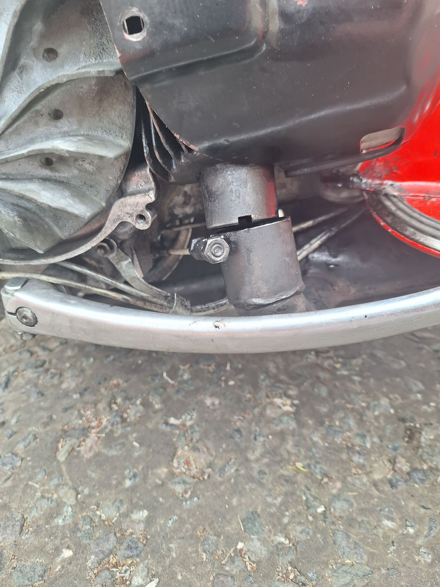

But sorry for the stupid question, what's the best way of getting this exhaust back on?!? I have tried pulling it back, tapping it, etc etc. Can I loosen the whole exhaust under the body somewhere? If so where and how?

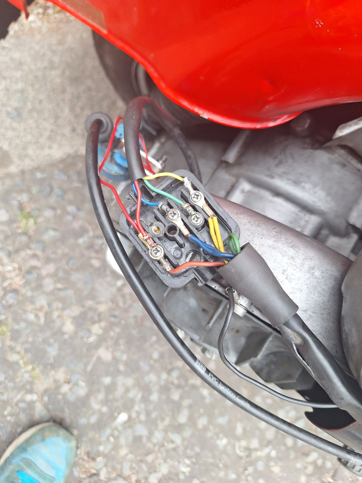

Next issue is odd. Bike running OK, connected red, yellow and blue wires. Have working lights, all good. Kill switch works, brake light works.
But...
When I connect the green wire the bike starts sputtering and dies, all lights fail.
I'm leaving the green wire (horn I believe) disconnected for now. Something in the horn circuit is earthing to the body when it shouldn't?
Any guidance welcome. Thanks!

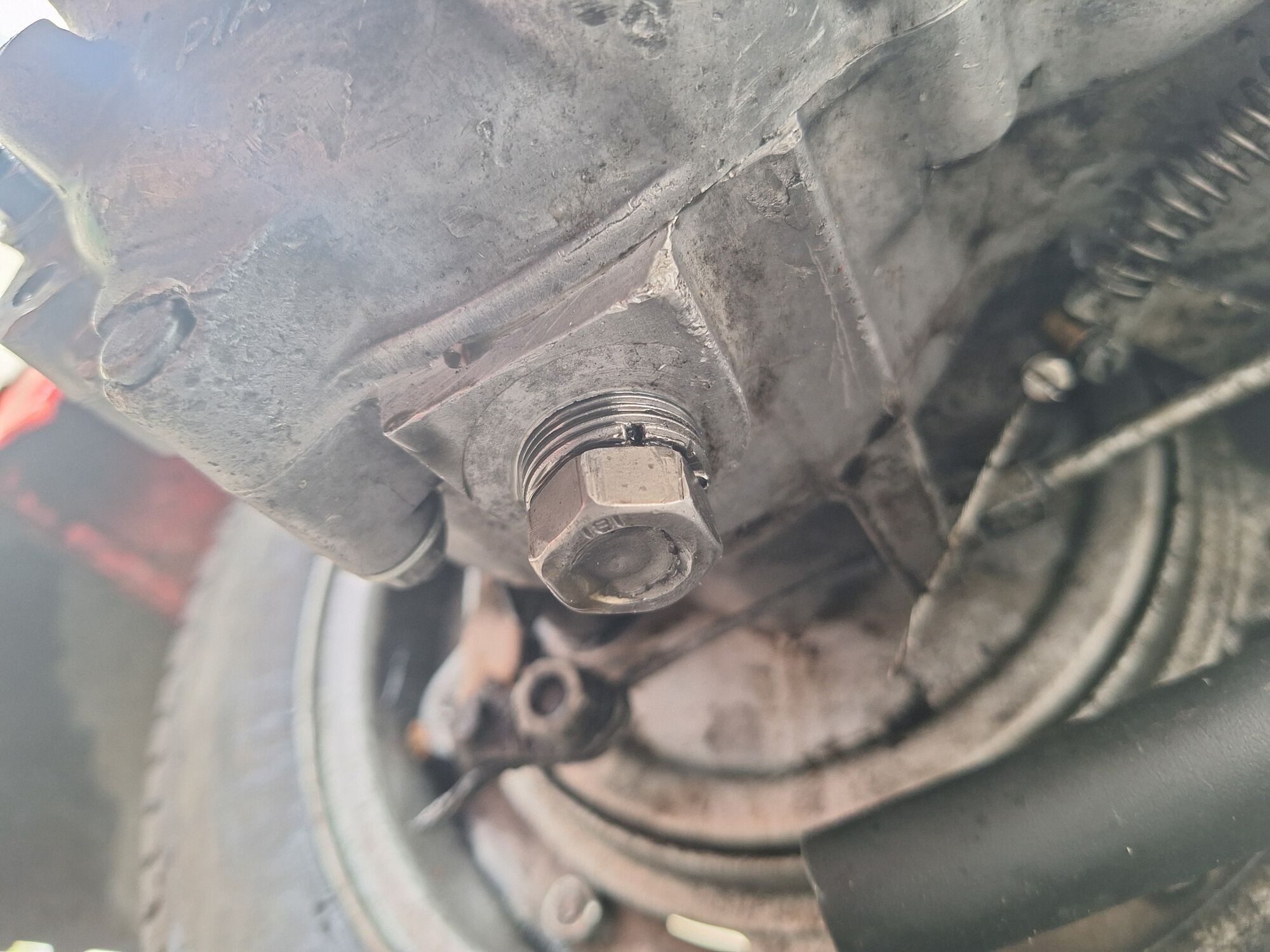

Final question for now, is there a washer or other item to seal the 19mm drain bolt at the bottom of the SS180 engine? Think mine leaks.
That is a tapered pipe plug and seals when tightened. Not too much, though. You could put a but of appropriate sealant on the threads but should not be necessary.

Thanks. Have tightened it and will keep an eye on it.
Slide the pipe up onto the manifold before attaching it at the bracket.

Definitely can't do that - obviously that is how it supposed to happen. Been pulling, lifting and shoving it. Can't get it lined up enough to get it on. How do I detach it under the bike? From the spare wheel side?
Remove the spare. There is a bolt going through a bracket and through the swing arm right in front of the rear tire. The tire interferes with the bolt going in and out. I have let the air out of the tire to be able to press it in so the bolt will clear. Or loosen the wheel so you can push it out of the way. It goes through the swing arm and into a nut that is captured in a cage on the front side. When replacing the bolt, the nut cocks andthe bolt will not thread into it. Be sure you don't cross thread it. Sometimes it threads right in and other times it's quite annoying. To say the least...

Nice one, thanks. Will do this tomorrow morning.

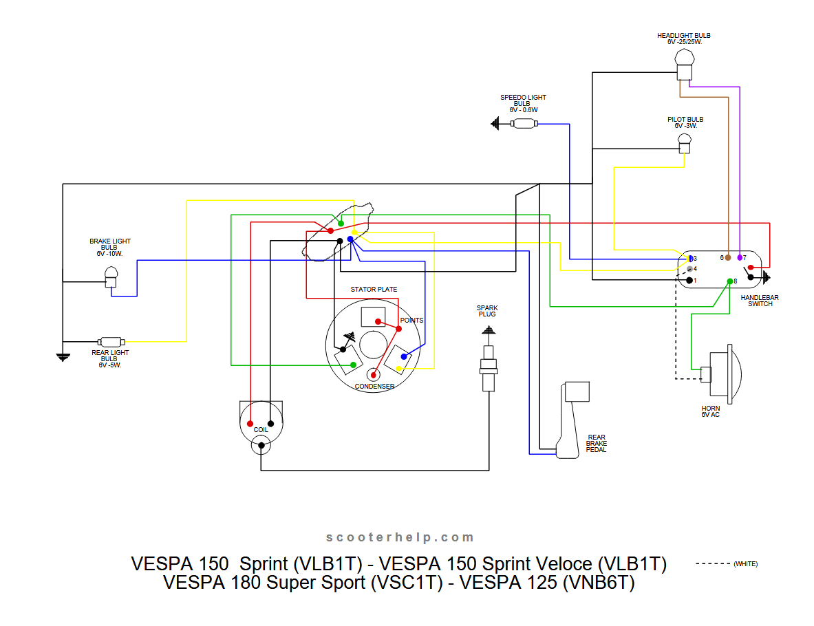

"When I connect the green wire the bike starts sputtering and dies, all lights fail. "
Green wire is engine kill
Search "green wire" in NSM.
https://modernvespa.com/forum/xsearch.php?search_results
@moto64 avatar
Posts: 2460
Location: NYS
@moto64 avatar
Posts: 2460
Location: NYS

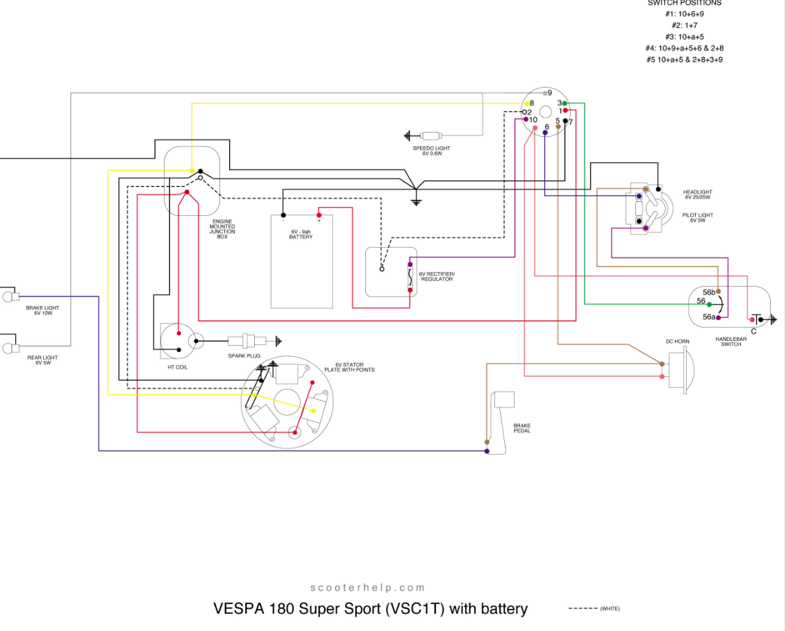

On the non-battery model, the green powers the horn and red is kill. On the battery model there is no green at the junction box and the red is also killed at the switch.
Your pic of the JB looks non-battery to me. The ignition is powered by its own coil and shouldn't be affected by the horn circuit. But... I had a bike with two coils ( ignition / lights and horn ) that would die if the lights were turned on and I never figured it out.
