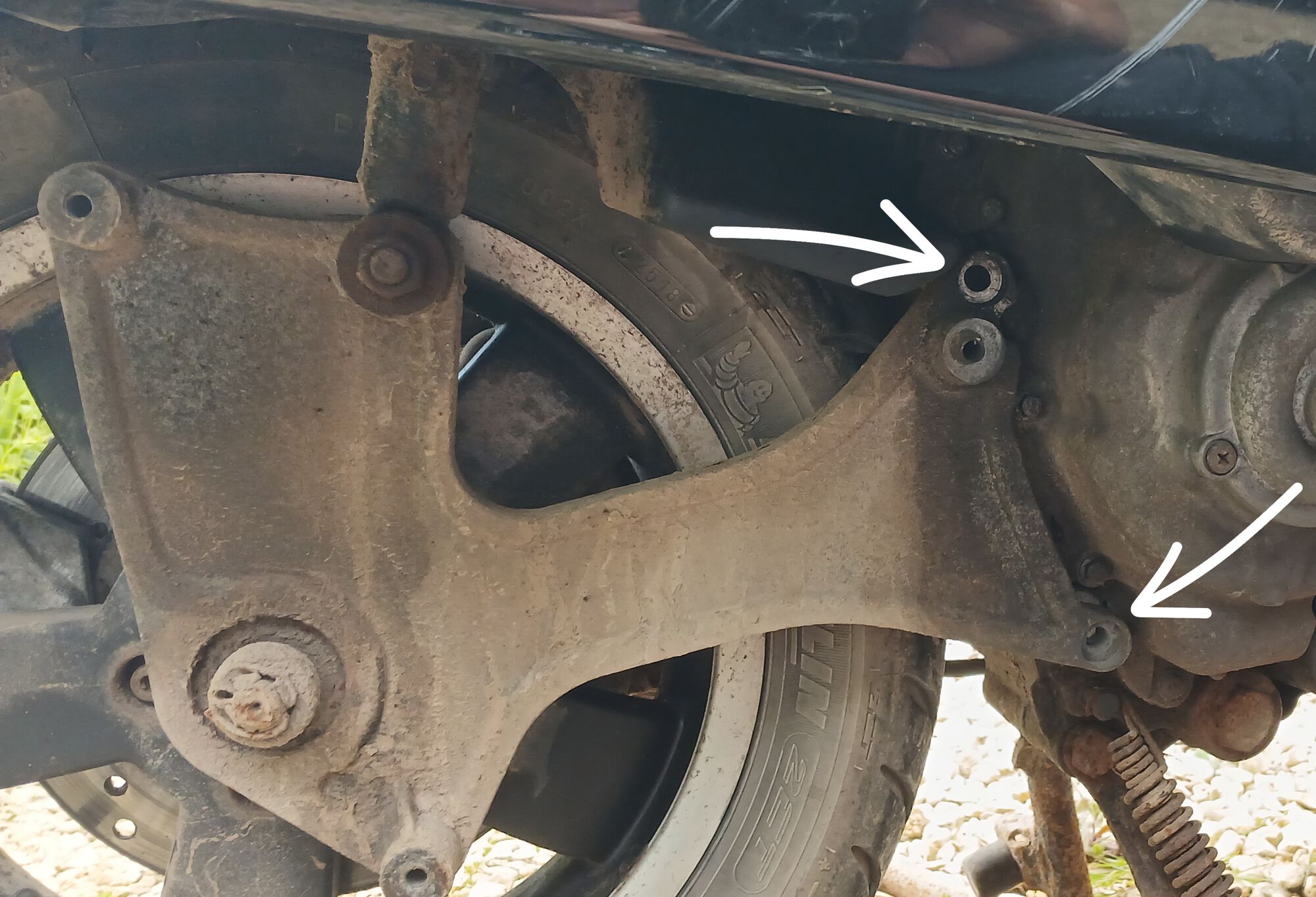

I have just discovered that the bolts holding the exhaust bracket are missing - the top one has snapped off leaving the threaded bit inside, and the lower one has clearly rattled and wiggled free and just fallen out along the way.
I am prepared for the ordeal of getting the snapped one out, but I just can't seem to find the spec of the bolts i would need to buy to replace them.
Can anyone point me to a shop link (UK preferably) or just let me know the spec so i at least know what to look for?
Image below to show which ones i am talking about...
Many thanks for your help!

You need M8 x 35.

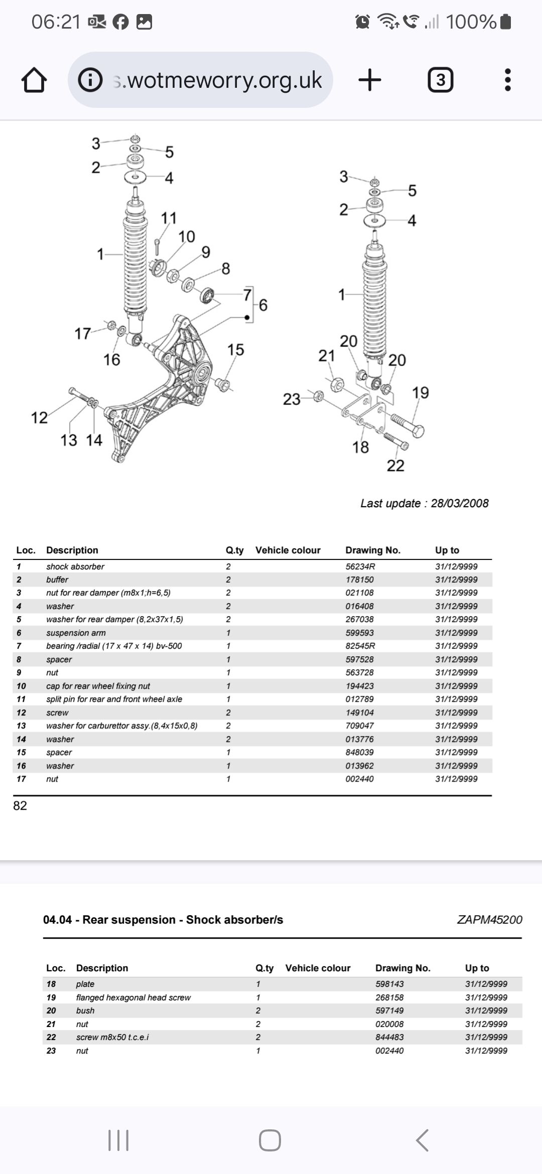

Parts list here:
https://manuals.wotmeworry.org.uk/Vespa/GTS300%20Super/

Thank you for this! I will be saving that link!!
I had found the diagrams whilst searching but not with the part numbers listed below!
