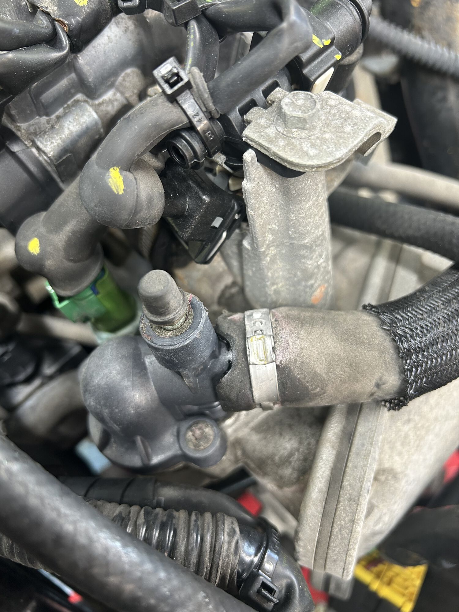

hose is leaking at thermostat. I may be able to have enough slack in hose to trim the end off and keep the existing hose.
Hose leaking
Hose leaking

If the hose is not cut try to replace the hose clamp first

Ya, like said above remove the factory clamp and clean both the housing and hose. Put back together with a smear of silicone grease and a good quality clamp. If that doesn't fix it, I'd go for a butt connector with a short piece of new hose before I would replace the whole thing.

That is the loosest fitting coolant system connection on the BV350. XRISTOS and Abner_Bjorn are correct.
