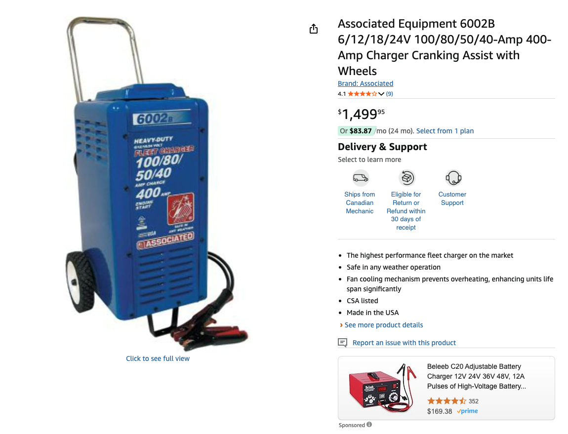

Assuming the huge charging device was a 12V one it should have been no problem - it's the voltage (and polarity!) that's important, NOT the current delivery capability.

Thanks for that. I always assumed it would draw the current it needs... regardless of how much it can supply.
I can't be 100% certain but the unit he used looked something like this,
Which does have a 24V mode. I did hear a pop, but that could have just been the battery arcing as it connected.
