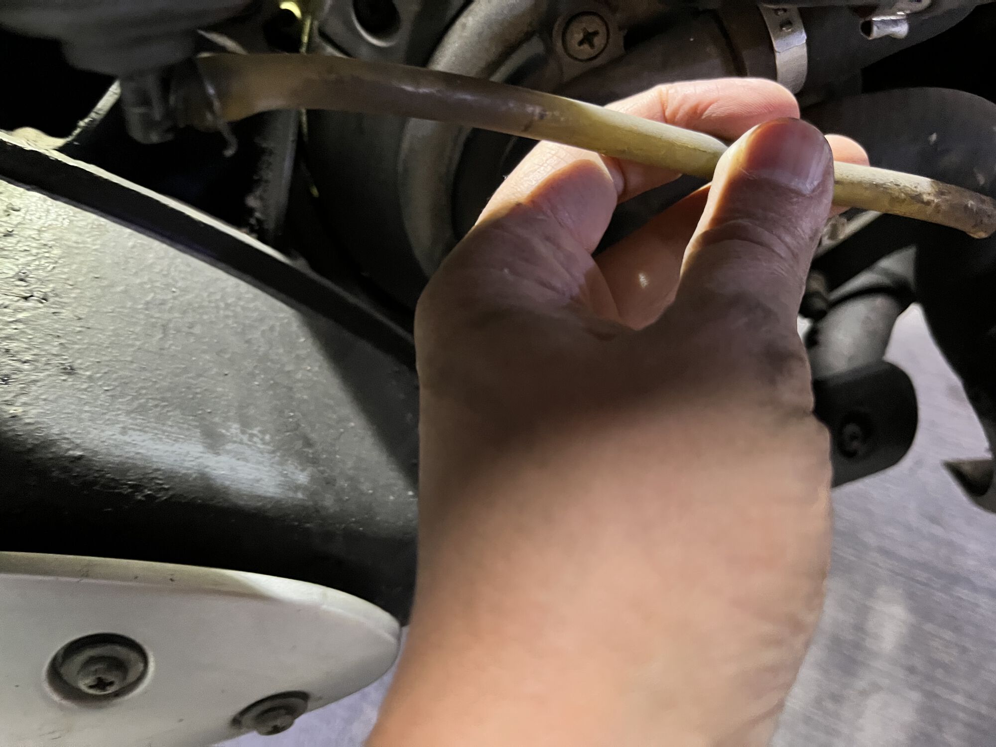

jimc, you were absolutely correct about vacuum line. It had broken off completely due to age. Seems a simple enough repair. Very much appreciate your sharp ears and experience -- saved me time and effort as I probably would've started looking at other things first.
(btw, the fuel lines had been replaced a three years ago by a tech when my sister saw a pool of fuel underneath the scooter one day. So the lines, at least, should be good for awhile.)

vacuum line -- not the best photo, but the line ends at the edge of the photo...

Well, I got a chance to replace the vacuum line, and after a miraculous 10 seconds or so of trying, it started:
