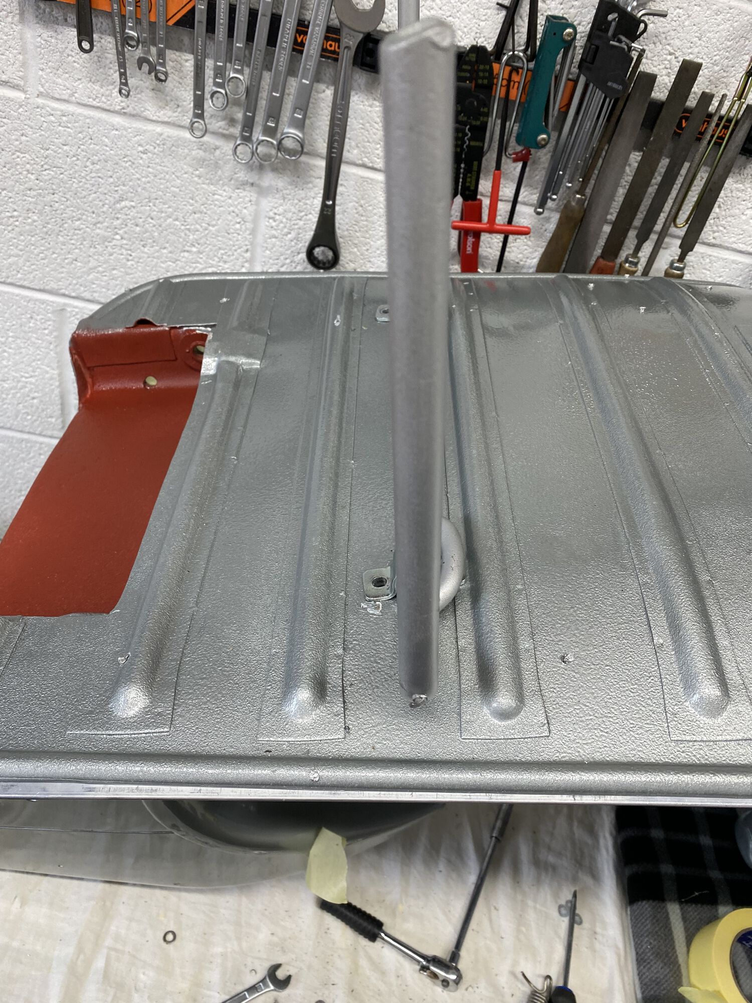

Hi guys, I'm fitting my stand and it won't go past 90 degrees because the stand hits the bracket bolt, am I missing something?

My GS150 has flush head bolts so the stand works. The thread of the bolt sticks though the floor. Maybe use screws with tapered heads.

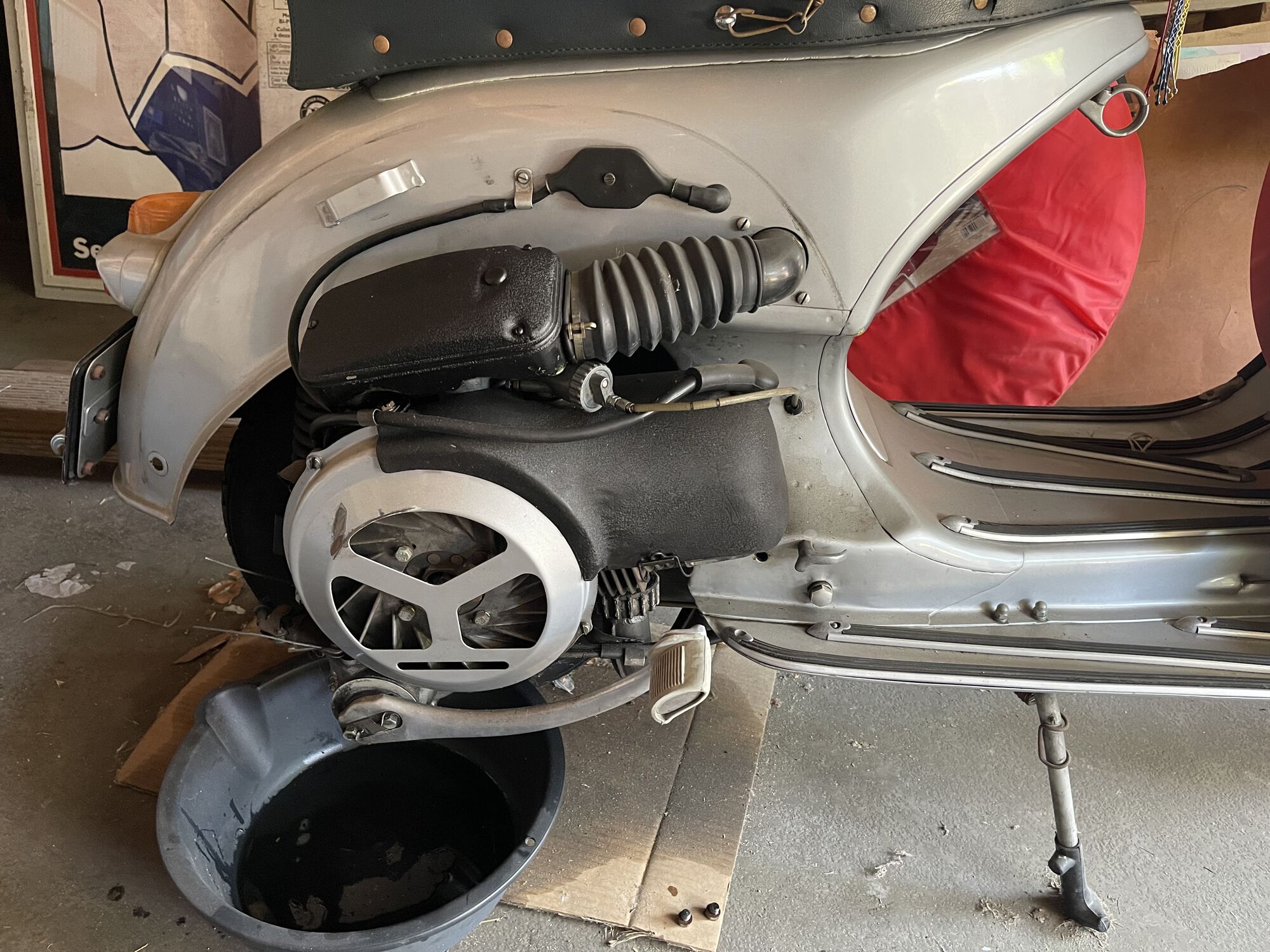

The bolts on mine go from the bottom with an acorn nut on top
