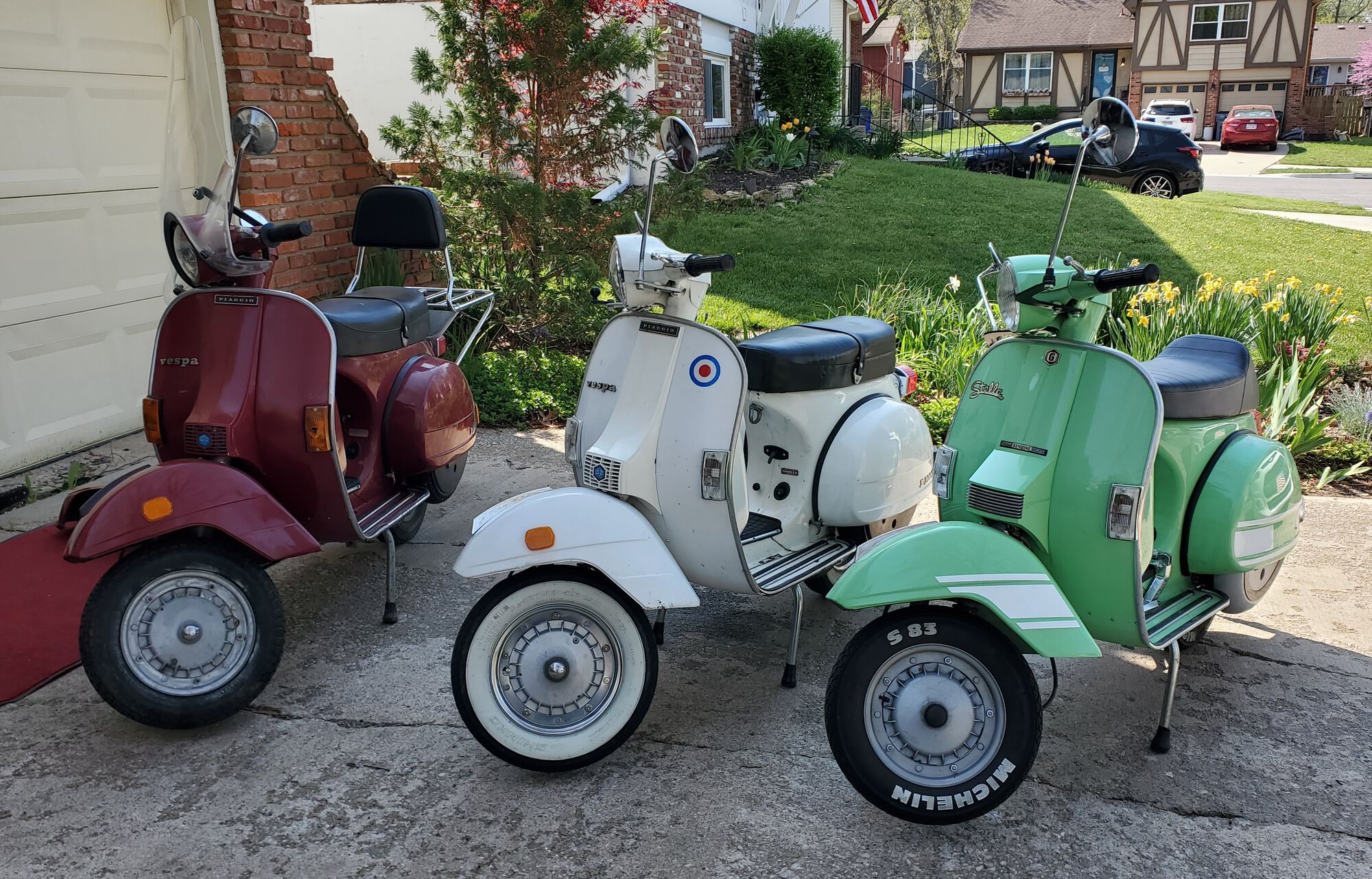

1980 P200e 2003 Stella 1979 P200e
Posts: 47
Location: ....near Kansas City
Posts: 47
Sip Road 2.0 transformed my 03 Stella.
Be3
110
160
55-160
It is a little boggy/spluttery in upper revs in 1st and 2nd when cold, but clean pulling in 3rd and 4th. I'll be doing reeds in the next month or two.
I only had 2 months of twist shift 2T scoot experience on a P200 when I bought my Stella. Was disappointed in the performance of it. I mean, 50cc difference, sure. There should be. But I just felt it should run better. And it did, once I did the exhaust and rejet.
