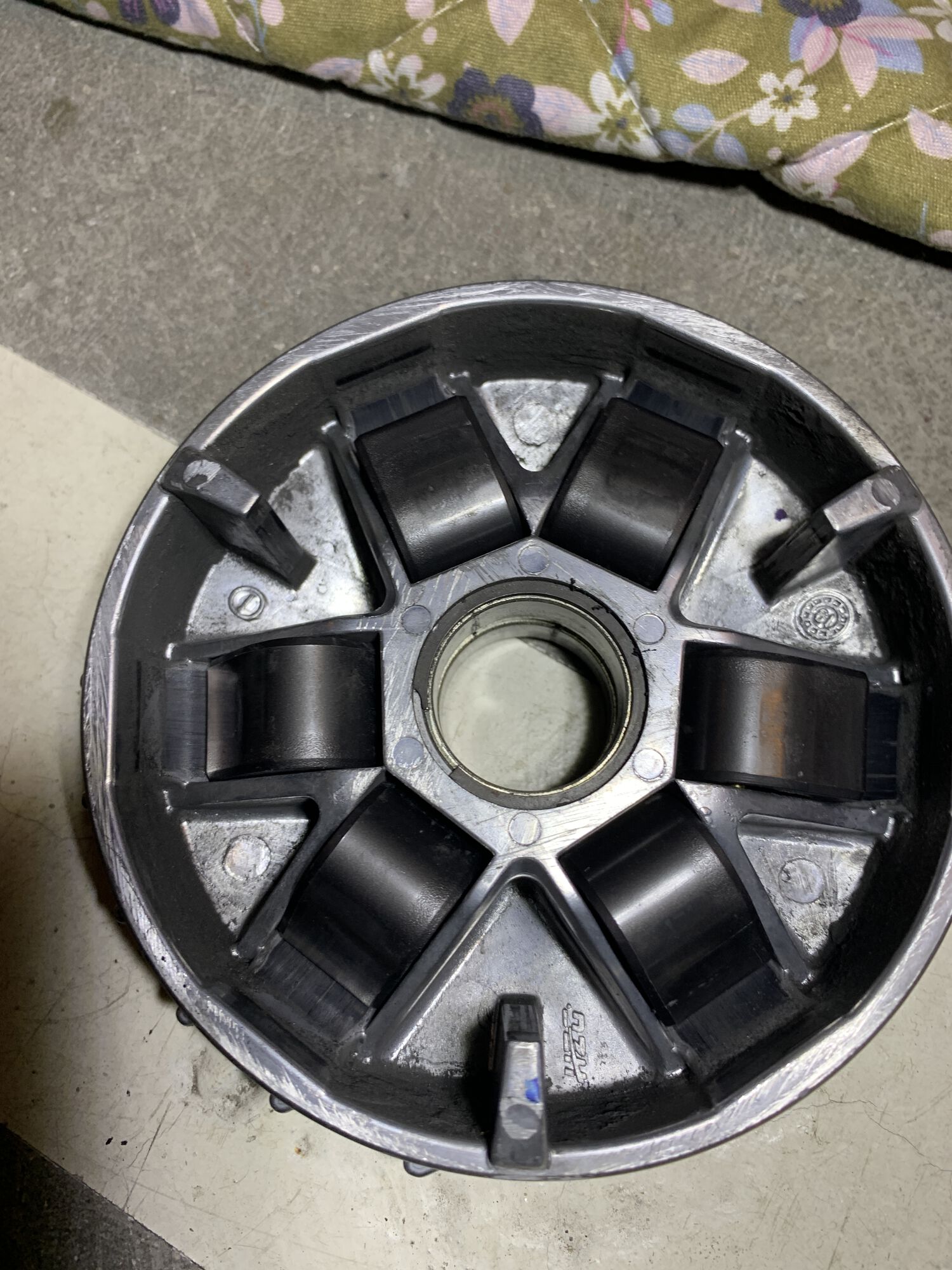

If you're not confident about the orientation of the Dr P 'rollers', open up and check again. It's very, very easy for one or more of them to topple over when inserting the backing plate and variator. This would probably result in your experienced symptoms.

OK, I think I installed them upside down. I found a nice video from Mitch's Scooter Stuff showing how to install Dr Pulley Sliders. I am quite sure I installed the round side up when I placed them.
I will open it up on the weekend and try again.

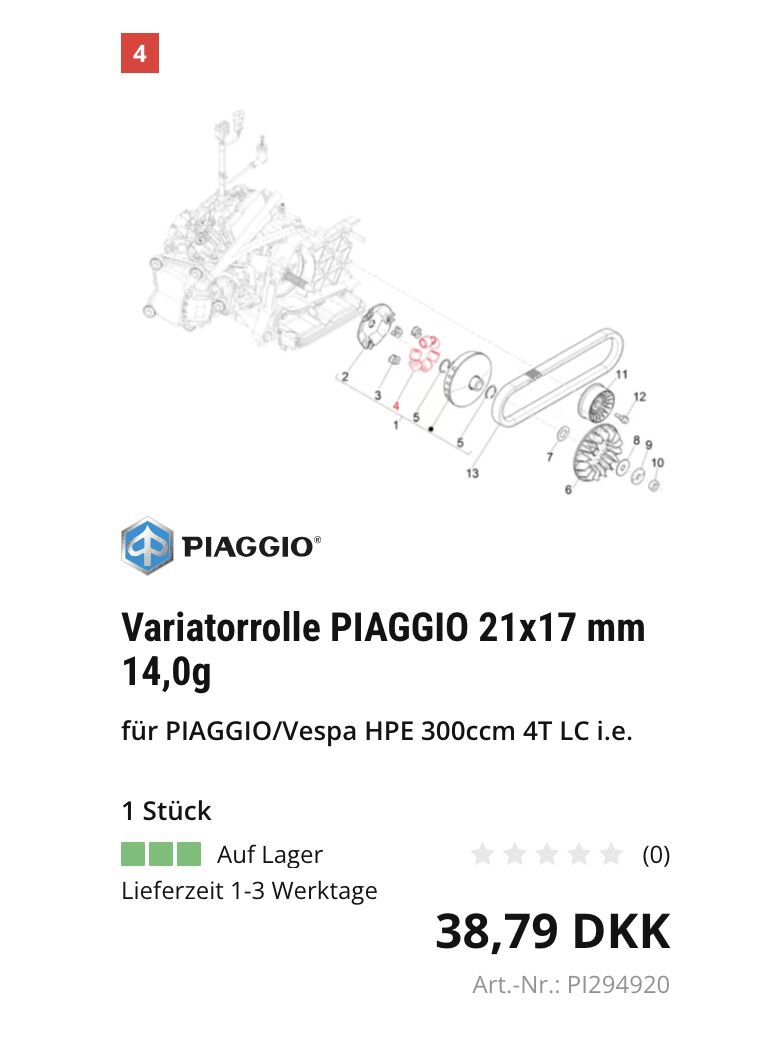

I would like to understand why there was a question as to why I used 14g rollers/sliders and that they seem too heavy.
I have attached SIP's part description showing 14gr.
This is why I ordered this weight.
If I should replace them, what weight should I choose for my 300 HPE?
Even though I now understand the viator a bit more, I am not sure I get what the weight impacts. Maybe that the lower weight causes higher revs before gear change ?

If your sliders are in backwards that can cause the symptoms you are experiencing. I-2 oz lighter than round rollers are generally where most folks find sliders perform best from reports I've seen.

Hello all,
Thanks again for the help.
Over the weekend I opened up and I can confirm that I placed the sliders incorrectly. I have attached the photo showing how they were in.
Possibility of oil sump gasket freaked me out, so I placed the original rollers back in.
It drives as before now.

If I order the 13.5 G Dr Pulley sliders, I am not sure precisely where to put the 1mm washer. I do not know where 'the centre bushing' is exactly.
In the attached Piaggio drawing, should it be added to where the #5 washer is, or on the other side of #2?
Can you please help me with the precise location in the drawing where the additional washer should be placed?

A lot has been written here about the so-called "fuzzy washers" but this is the wiki page.
Fuzzy Washer Performance Mod Explained
