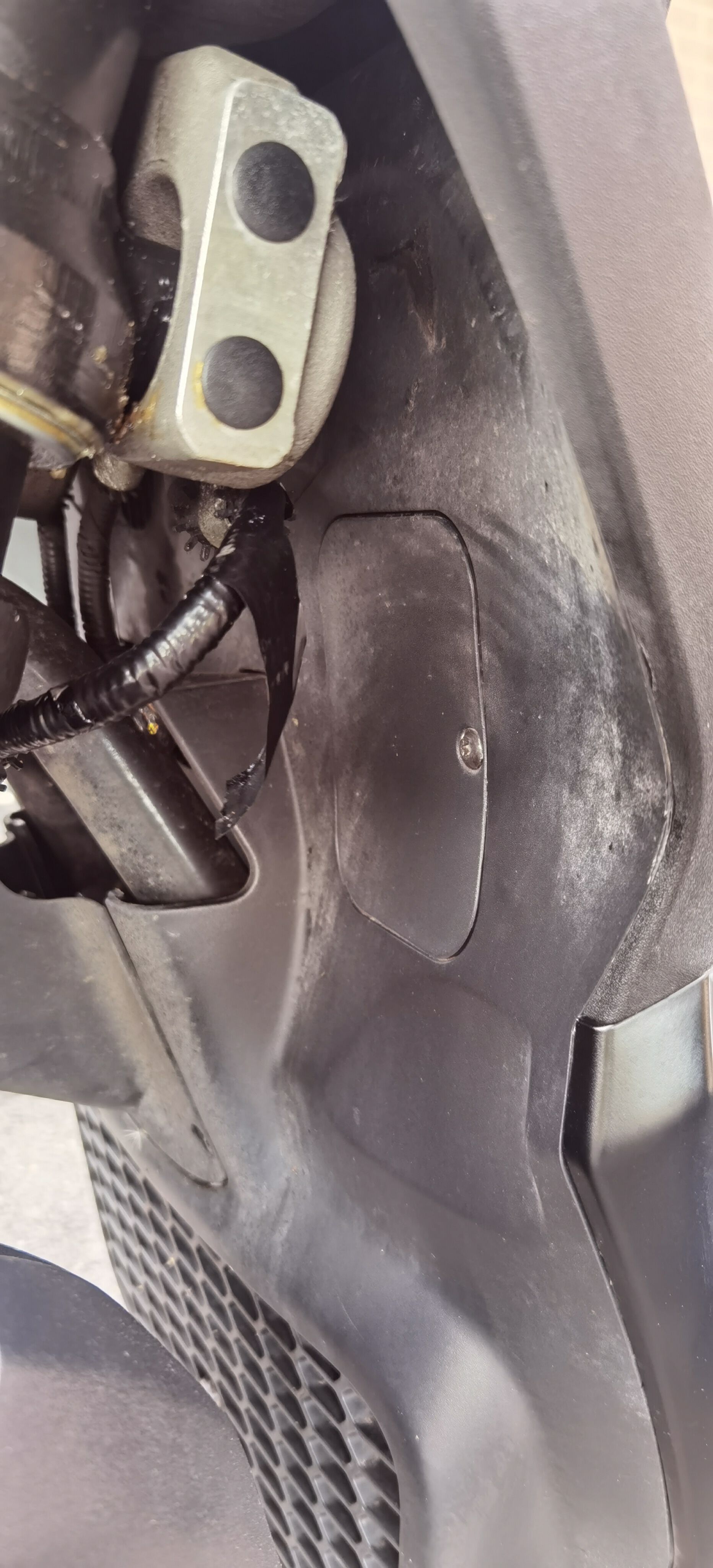

Also check if its got another brake fluid reservoir, as I found on on my yourban that was behind a cover above one of the front wheels.
I had to ask on here to what it was as initially had no idea.
Should be in the manual
