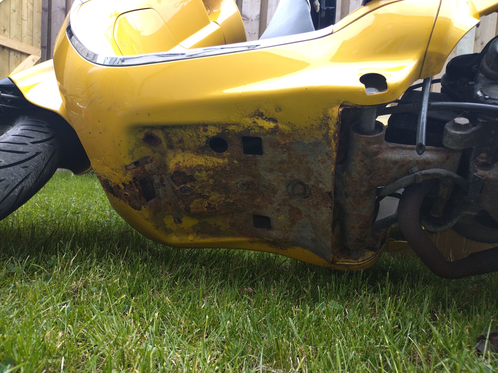

hmmm, the more I clean off the more I see,

Now attacking with wirebrush and hand sander ( black n decker )
have bought some zip rust converter, and some spray paint.
Managed to clean and hammerite the exhaust anyway
It looks like mostly light rust, but still a bit concerning. There is a bit of heavier rust after looking at your pic more closely.
After you've painted it, you might consider some clear spray-on bed liner to help protect even more.
