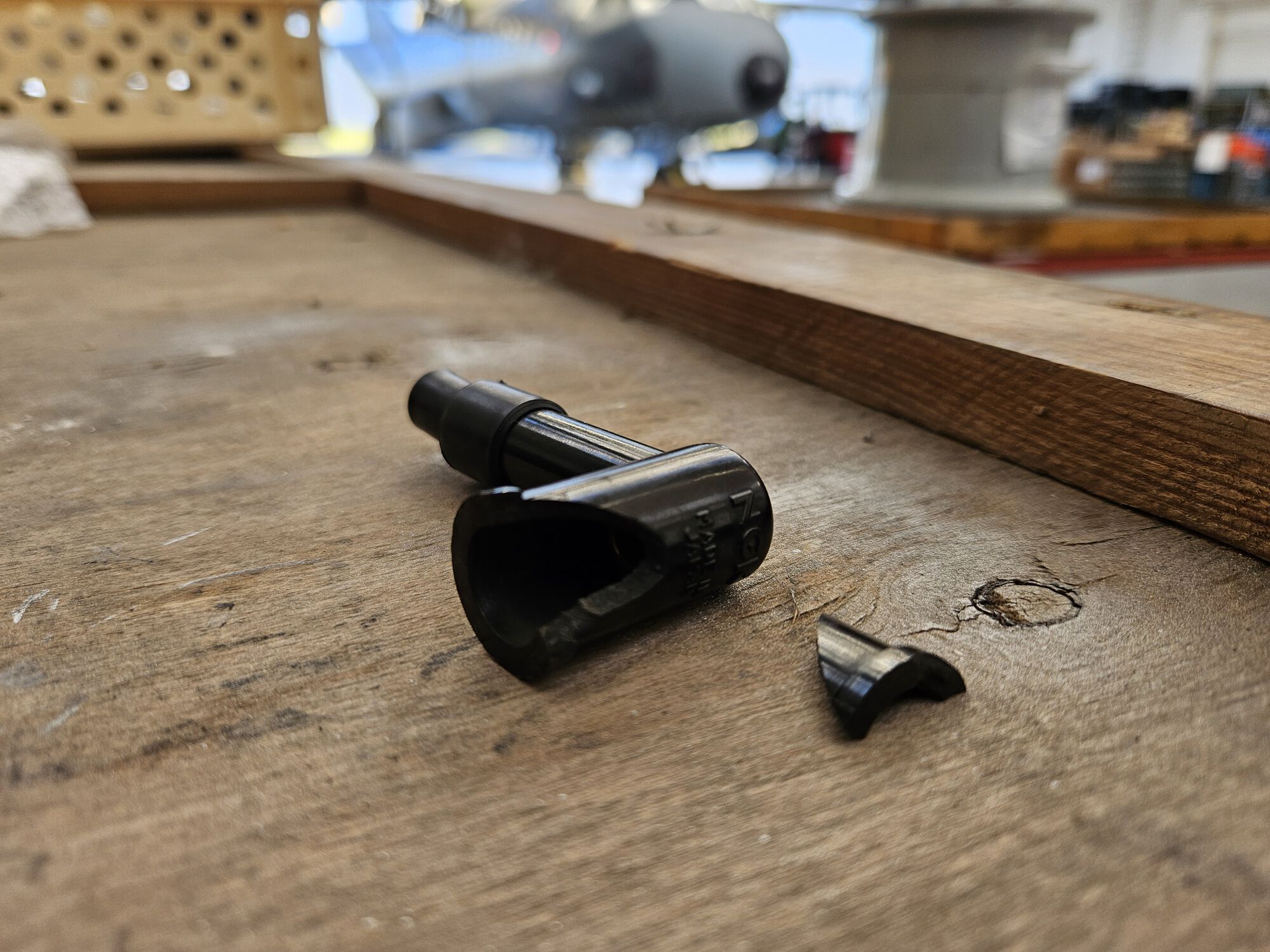

I have a problem with my Beverly 350ST (2014), 33,000 km (20,000 miles) on the clock. I try to service it regularly, but about 200 km after changing the spark plug, the engine started to hesitate at full throttle, and within a few days, I reached a point where, after starting, it shuts off within about 15 seconds and the idle is unstable. And I cant ride anywhere bcs with throtthle it immediately shuts off.
I had a similiar problem about 3 years ago, when the mixture was too rich and the bike would also shut off-the solution was replacing the ECU, and everything was fine until now.
Currently, there are no error codes (the check engine light is off), I tried putting the old spark plug back in, and finally I ordered diagnostics and found a guide here on the forum on how to connect to it, in case something shows up (it just seems to be a mixture issue).
The fuel pump can be heard when turning the key. Could it be a clogged fuel filter? Or has anyone had a similar experience? Thanks for any advice.

New spark plug and no difference with the old one, electronic ignition system is very reliable, so I don't think anything wrong with spark.
You hear the fuel pump, so that is working.
But it sounds like you have a fuel problem.
The problem first started at full throttle, so I expect not enough fuel.
Could be a clogged fuel filter.
Maybe good to start there.

The old cracked spark plug cap trick.

I found a broken cap so In a few days I will have a new one and hopefully I will be so lucky and everything will be solved 😀
It was aftermarket according to PN (LB05EZ) and also it wasnt tightened well.
Thank you and I'll let you know

Were you able to find a spark plug cap? I could not find one and they seem to be replaced by LB05EA. This replacement is a different dimension and the HT is too short for the new cap.
Also, it does not appear that the wire can be disconnected from the plug that goes into the HT connection. So was unable to lengthen wire.

So I changed the cap, cleaned the throttle body and sprayed every plug I found with contact spray and Im back on the road!
To be honest I dont where was the problem but thats not relevant anymore.
