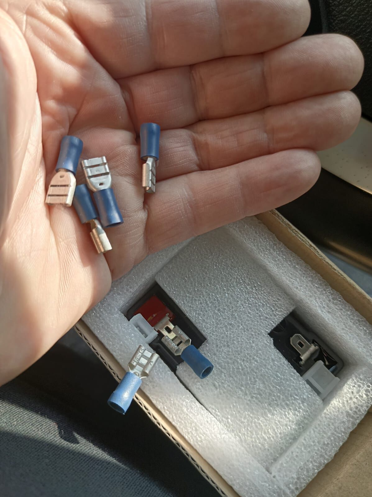

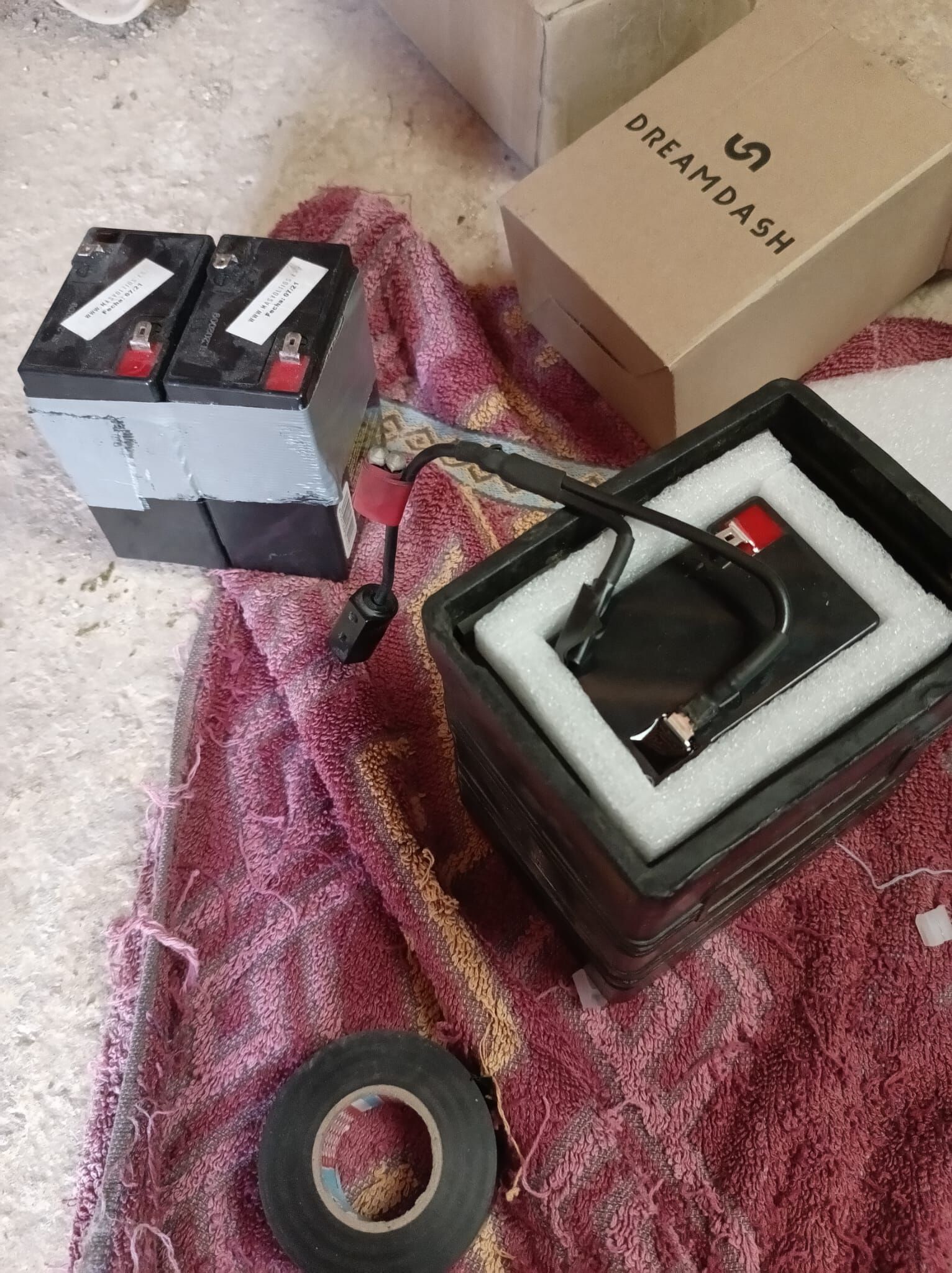

Have had the Nimbus battery on a charger but close to 10 years old it was just not holding charge apparently. Refused to start because of no juice in the battery.
Since the original bakelite housings are lóng since obsolete I have two small 6V lead-acid cells in parallel inside an emptied original housing.
Those cells are véry difficult to source so looked at LiFePO4 just in case see above.
The connectors are obviously low amperage only but the Nimbus is pedal start only so that is aok and the twin cells have the same spade connectors.

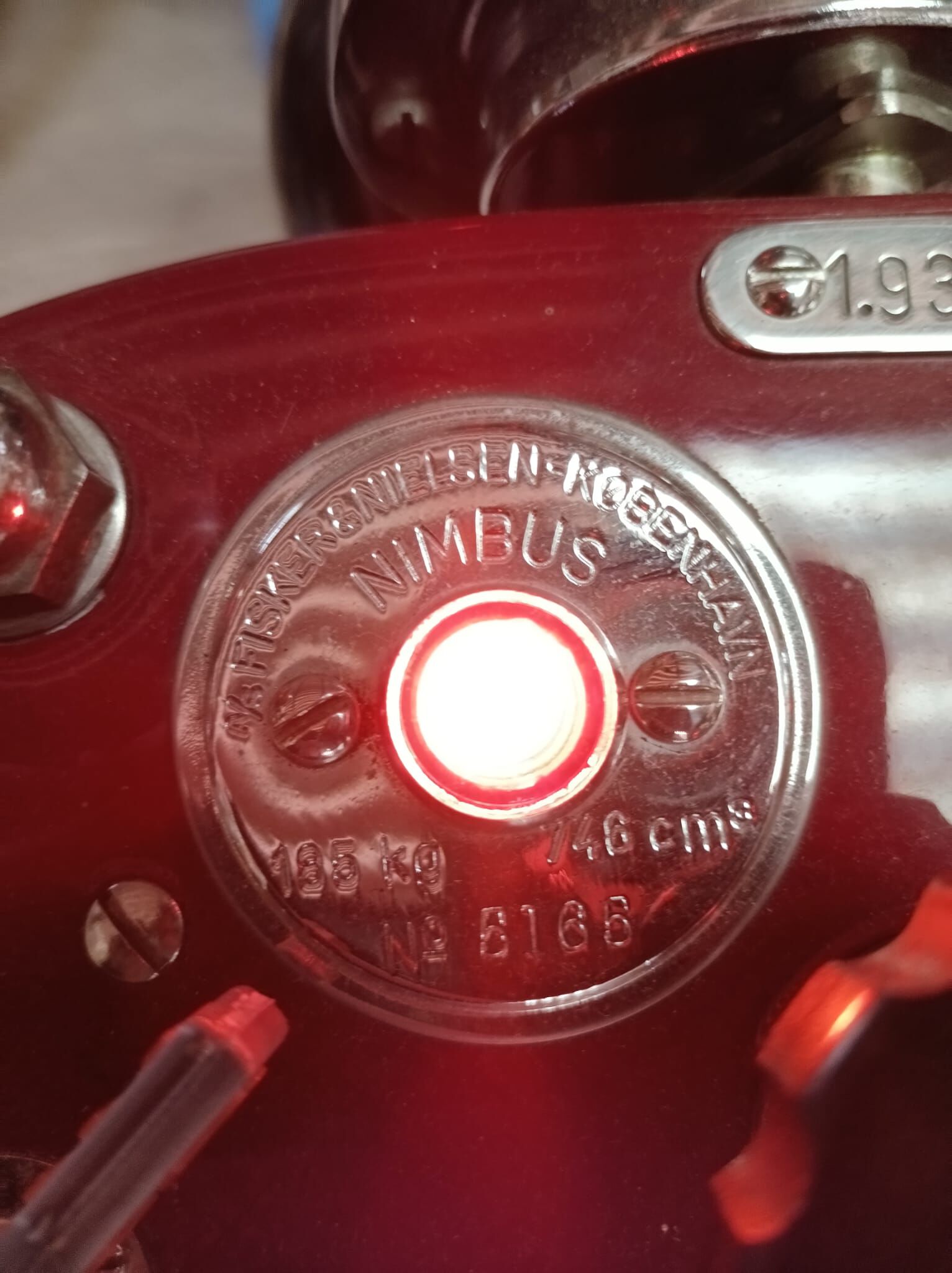

Just pushed the button:
@petrus avatar
P200E DN 1982
Posts: 1269
@petrus avatar
P200E DN 1982
Posts: 1269
The LiFePO4 is réal lightweight
Not all that much smaller, a bit higher even, than the old lead/acid and with more capacity.
With the packaging material was an easy fit.
Has voltage, the one and only fuse stayed put, no sparks/smells.
Don´t know how to share videos but the engine starts.
