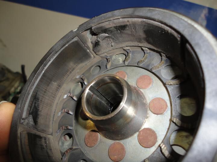

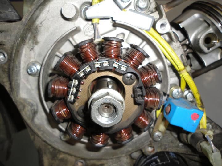

Yeah, after doing more diagnostics, I'm leaning towards the stator. I'm getting 0L resistance between all combinations of the 3 pins.
Do you mean open circuit or very low resistance? Very low is fine - open circuit not fine.
But a bad stator can be just the magnets broken up and graunching around the coils - doing possible damage in the meantime.

Meter didn't move off of 0L testing 1/2 1/3 2/3
Basically I wasn't getting any readings. In any case, I think my next step is to pull it apart and take a look.
