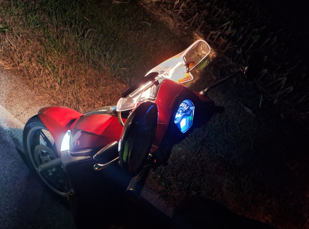

My 400 mile on the odometer 2024 Liberty 150 has stalled twice since my last gas fill-up (premium fuel always). I did overfill it accidentally so not sure if that is causing an issue. Both times it stalled was from a cold start - stalled after giving it some throttle. Restarted and ran fine once warmed up.
Any ideas what is going on? It is still under warranty but hopefully do not need to go down that path. I changed the oil at 300 miles, have not adjusted the valves yet (was going to wait for 600 miles).
Should add: engine oil light comes on when it stalls (goes away after restart).

So the issue seems to come and go. Today for the first time it stalled while still moving (was rolling to a stop). Very annoying. I'm still on the same tank of gas, so thinking it might be a bad tank of gas? Some days it is fine and other days it stalls….
