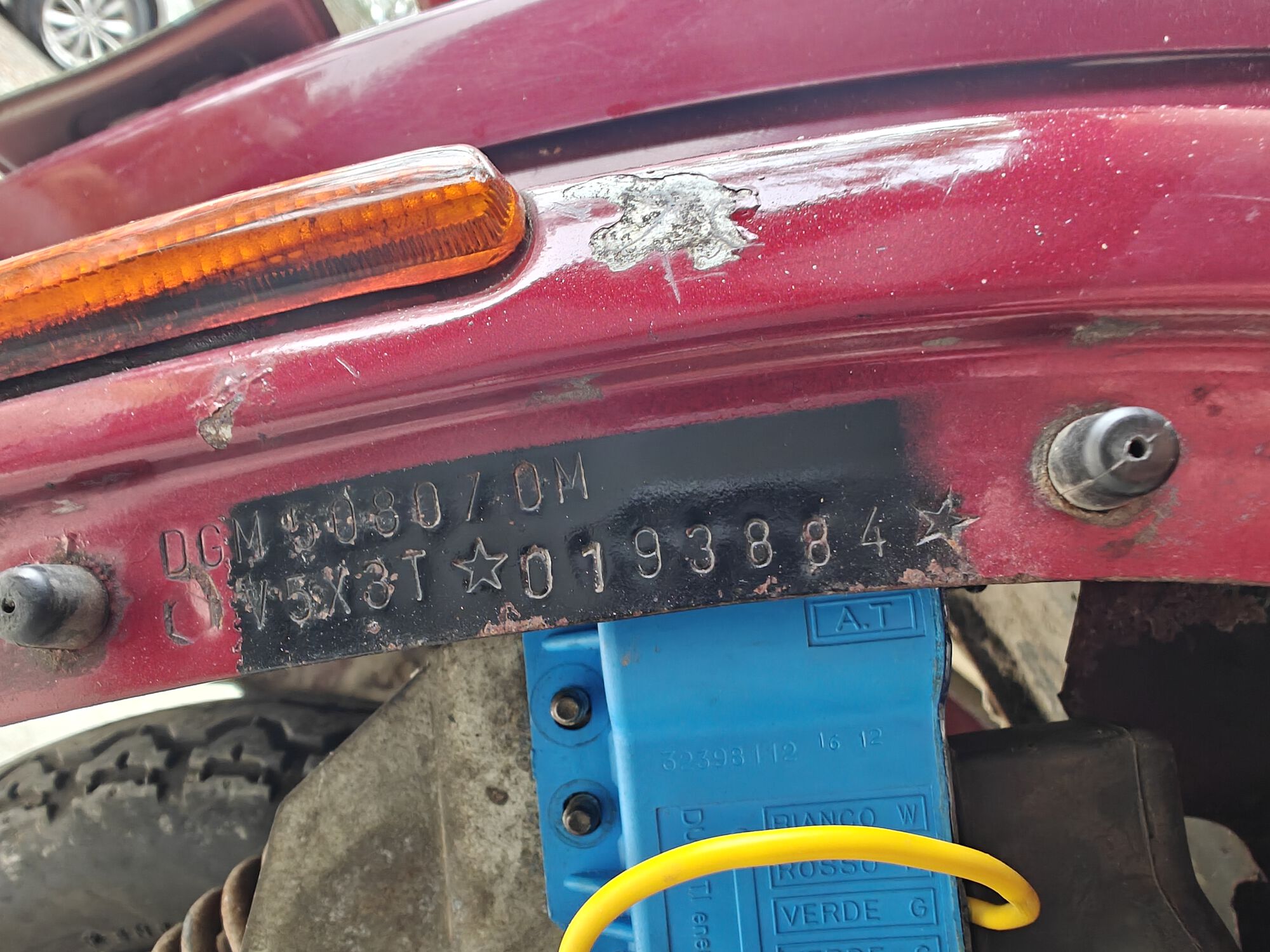

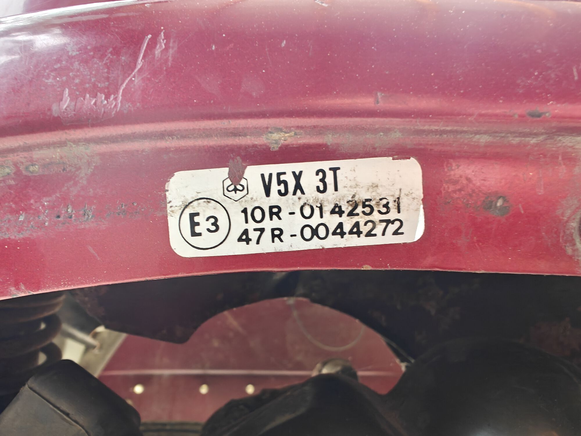

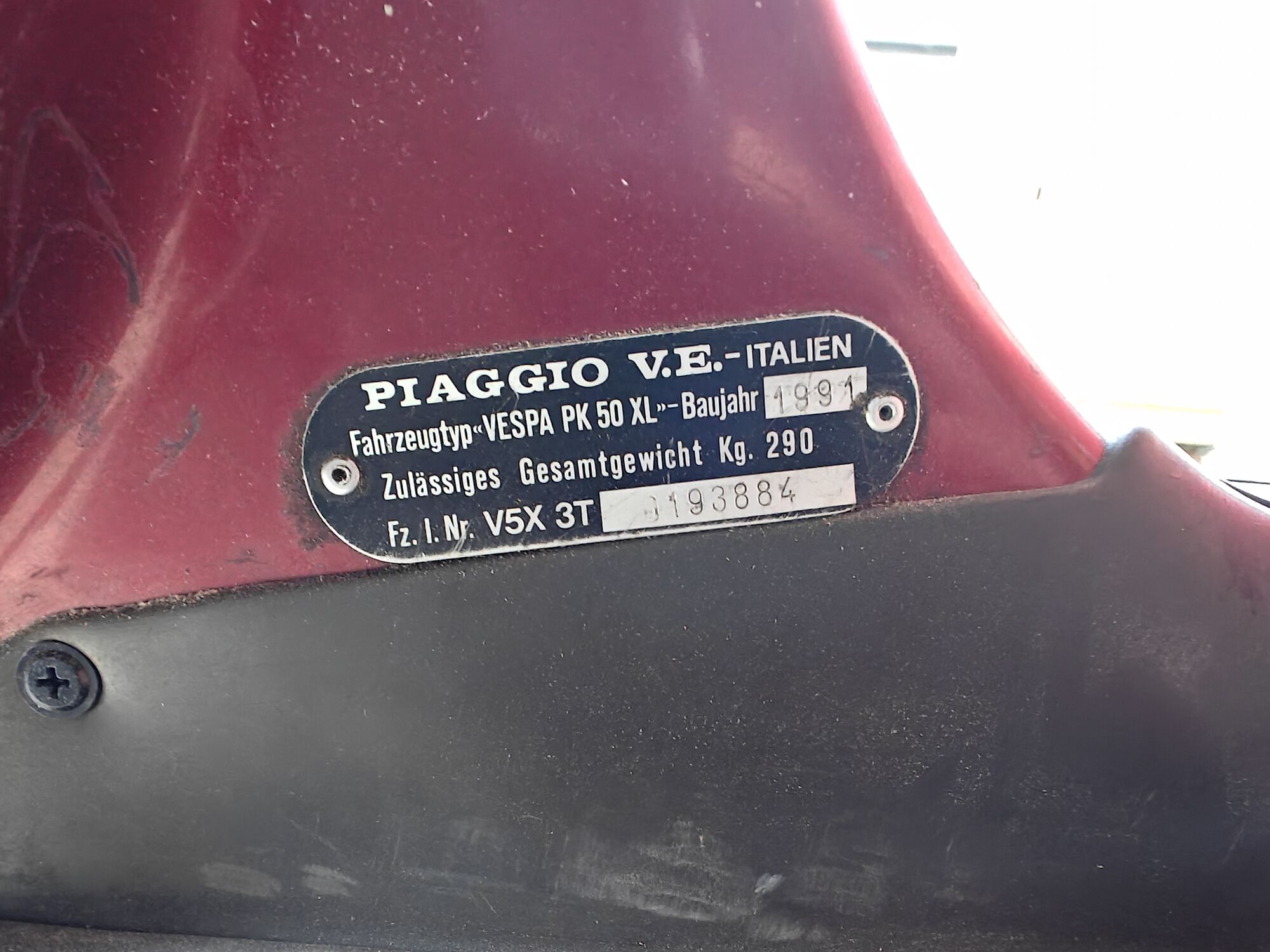

I am restoring a PK 50 XL (V5X 3T).
At least that's what is says on the manufacturers plate. It's a German market version.
After looking more into it I have started to doubt - is it actually an PK 50 XL. The series was discontinued in 1990. Mine is 1991. Or can it be a XL2?
Can you tell the difference?
Also want to upgrade the engine to 125cc. And I want to be sure before buying.

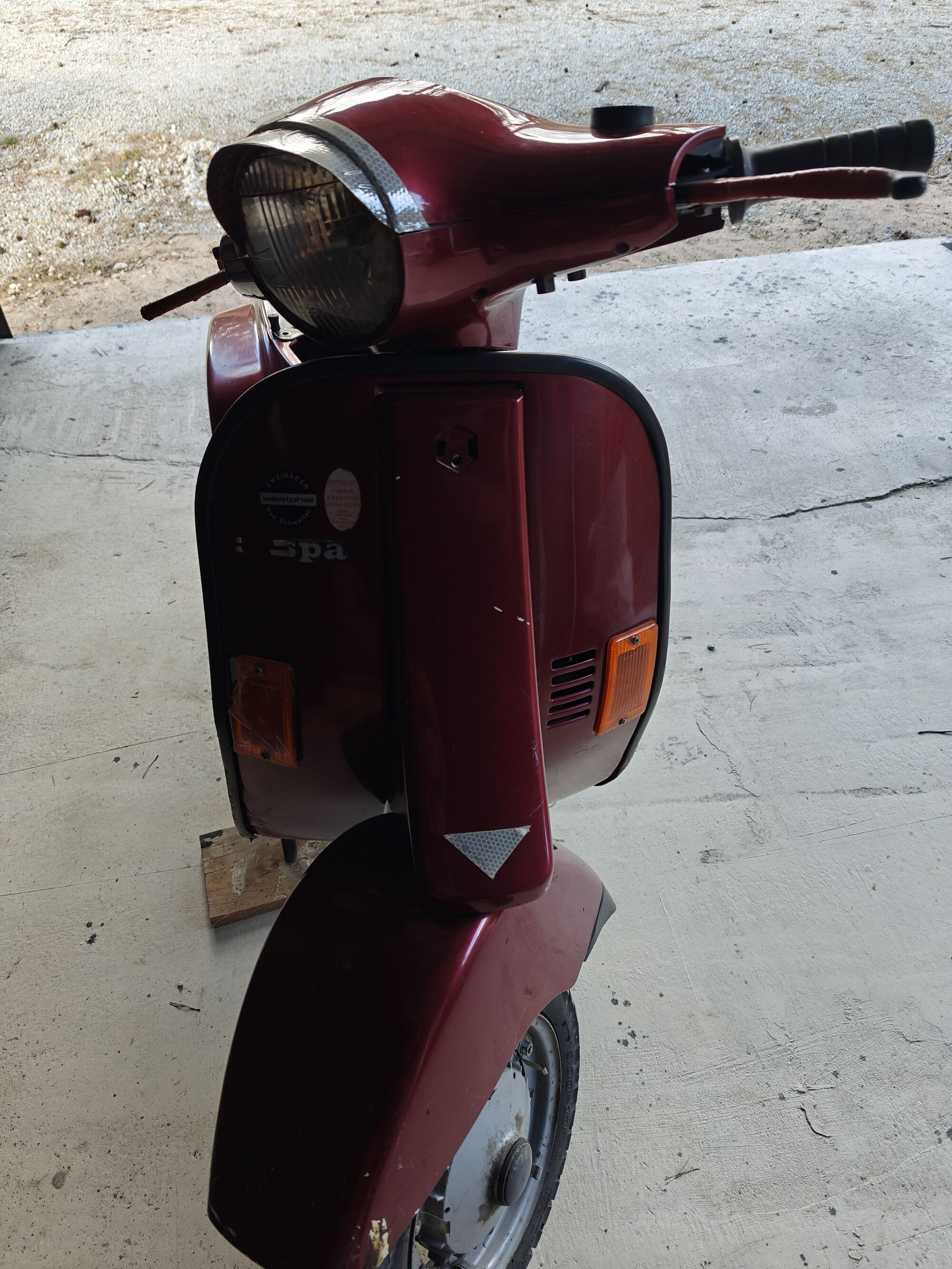

It is 100% XL2. IIRC in German market is was sold as XL.
Engine have gear selector with 1 cable and maybe XL2 type clutch.
XL2 also have unique:
- plastic front mudguard
- horncover
- glovebox
- floor mats
- seat
- rear plastic part where light mounted
- rear mudflap
- full handlebar with top and bottom plastic covers, tubes, levers, grips, speedo
- mirrors
- choke lever on the handlebar
Also all XL2(and similar) have PK 125 XL fork and front brakes.
