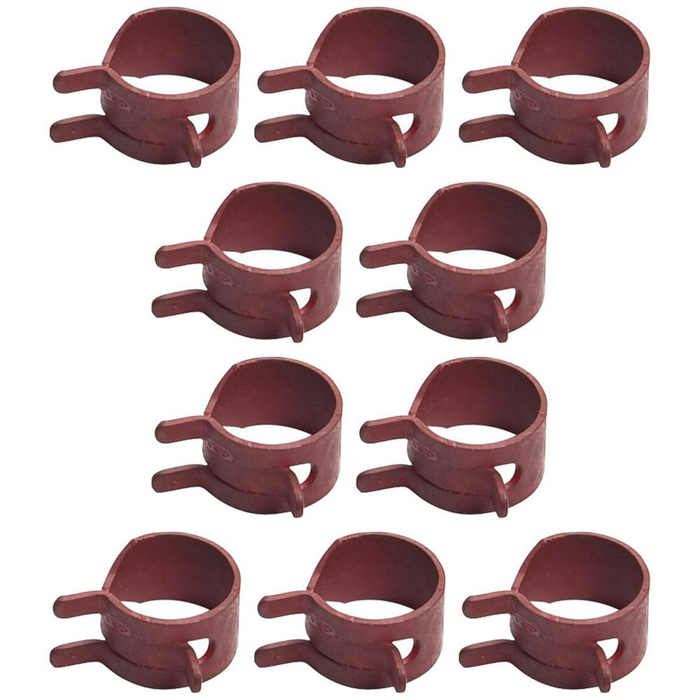

fledermaus wrote:
Thanks! Curious about what hose clamp you use. Of my bag of metal screw clamps collected over the years, my smallest didn't work, and the hardware store's answer was bigger than mine! I've had fairly good luck with the smallest zip ties....
I found a couple of these pinch-type clamps at a local hardware store. For 1/4 or 5/16 inch, I believe.
They probably have them at my ACE store. Love supporting the place, but man, help isn't like it used to be. One of their clerks a while back was reeking of alcohol..... They've got some good people too...just not always easy to get them.
Maybe I should copy your photo....
