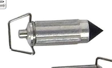

Check your float needle. It's likely not seating allowing more fuel than can be used into the carb. Did you confirm the new petcock is doing it's job? Unhook the fuel line going into the carb and see if it is shut down when not running.
